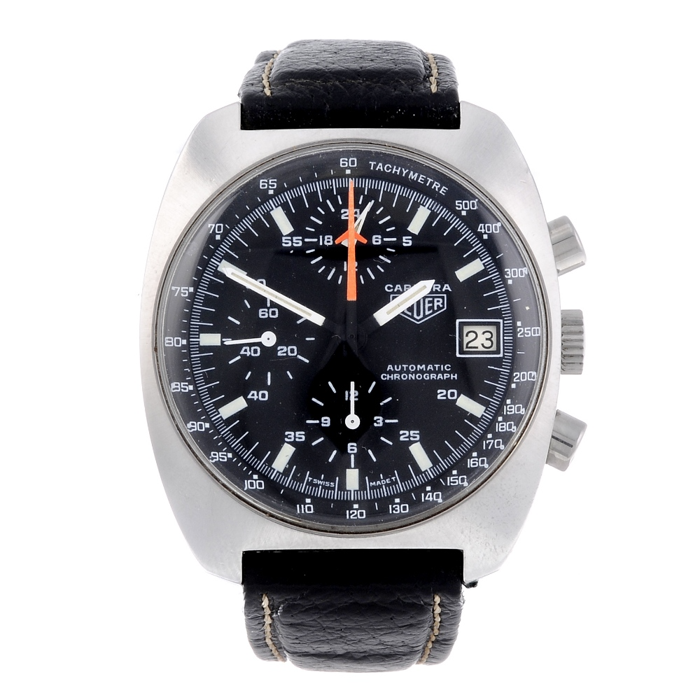

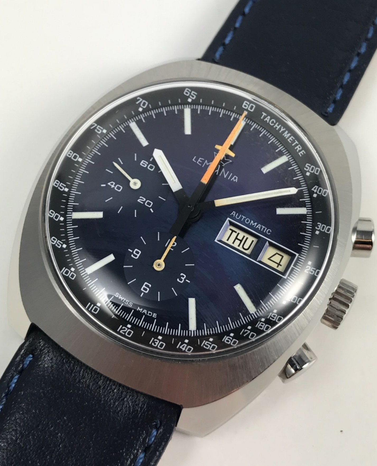

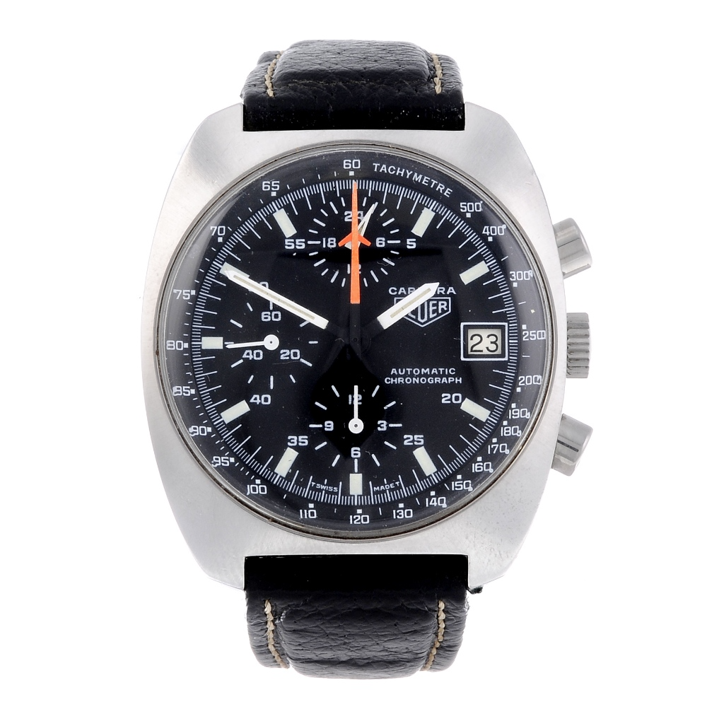

An indicator of this thesis is found if one compares the bezel ring (not the dial itself) between this (Lemania ref 11001) 5100 Heuer Carrera, and my BBC Lemania ref 12001 watch. Coincidence? Perhaps, but I don't really think so.馃嵖
Another similarity perhaps?!
The pictured Heuer Carrera has case ref 11001. Lemania 12001.
The shapes are very similar?

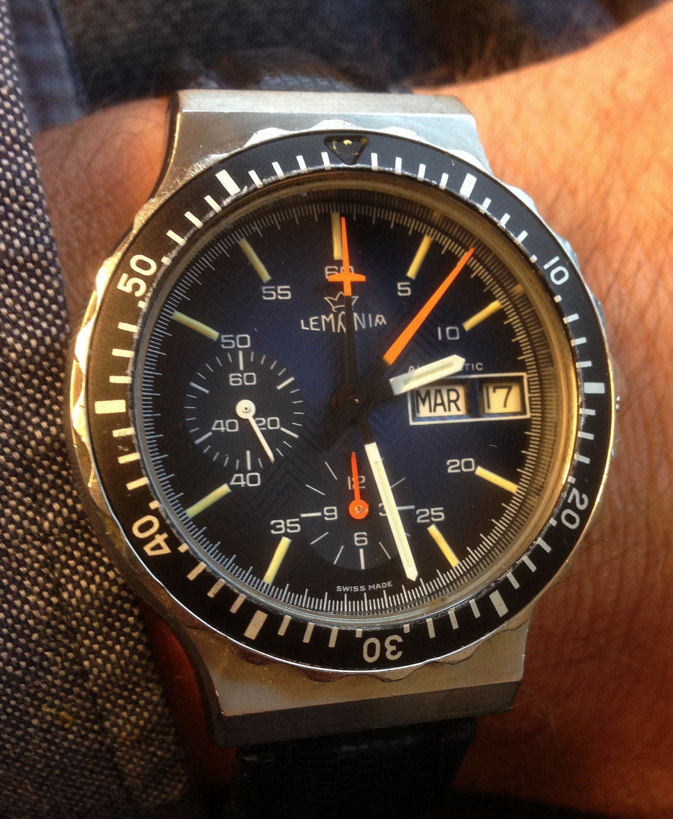

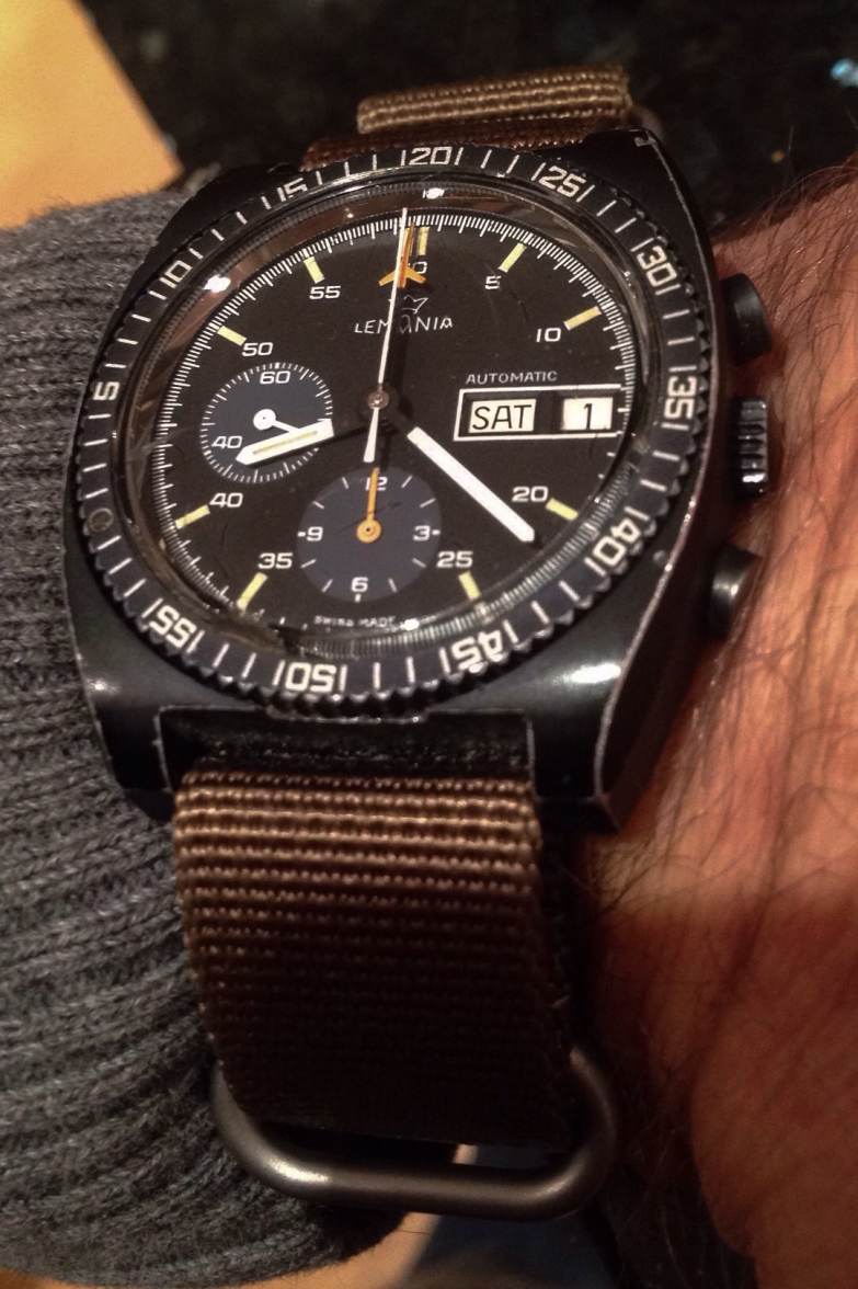

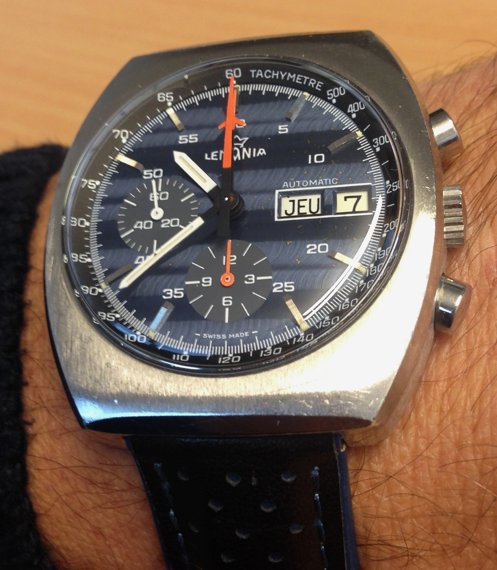

There are some "relations" that can be established in Lemania later chronograph ref. numbers.
96xx: Cal 134x
97xx: Cal 387x
98xx: Cal 134x
110xx: Cal 5100/5012
11000
(not mine).
11001
(also not mine).
11002
11003
11004
(not mine).
11010
(from @marturx)
11019
11022
(not mine).
Then there is the World timer and SAAF versions and a few more I have yet to categorize......
