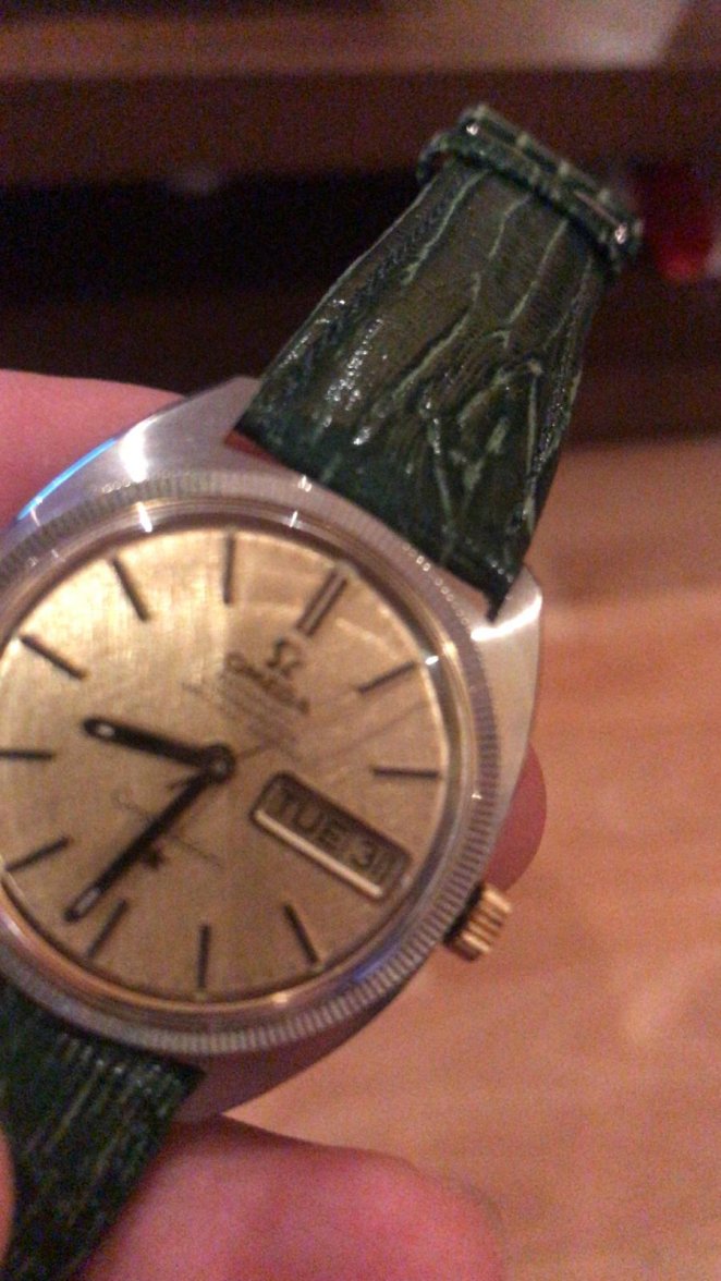

This time I want to buy a new constellation which seems to be a bit pricey, but it will worth the price of 1000 euros? The seller has only those pics...

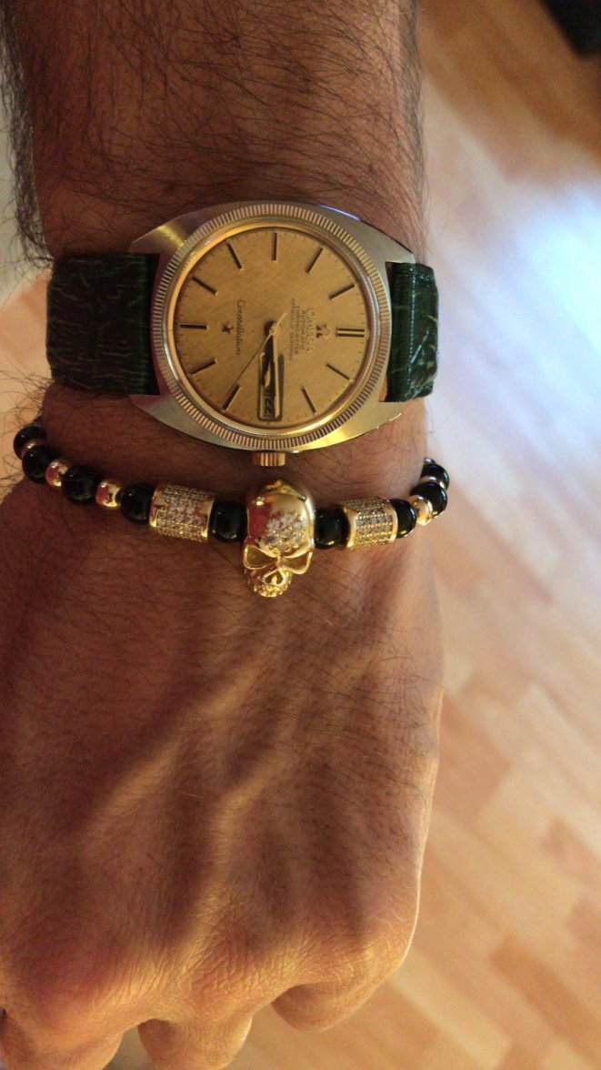

It’s difficult to say from those photos and I’m no expert but I bought a nicer looking one than that for about 350 quid from someone on here (albeit no gold content)

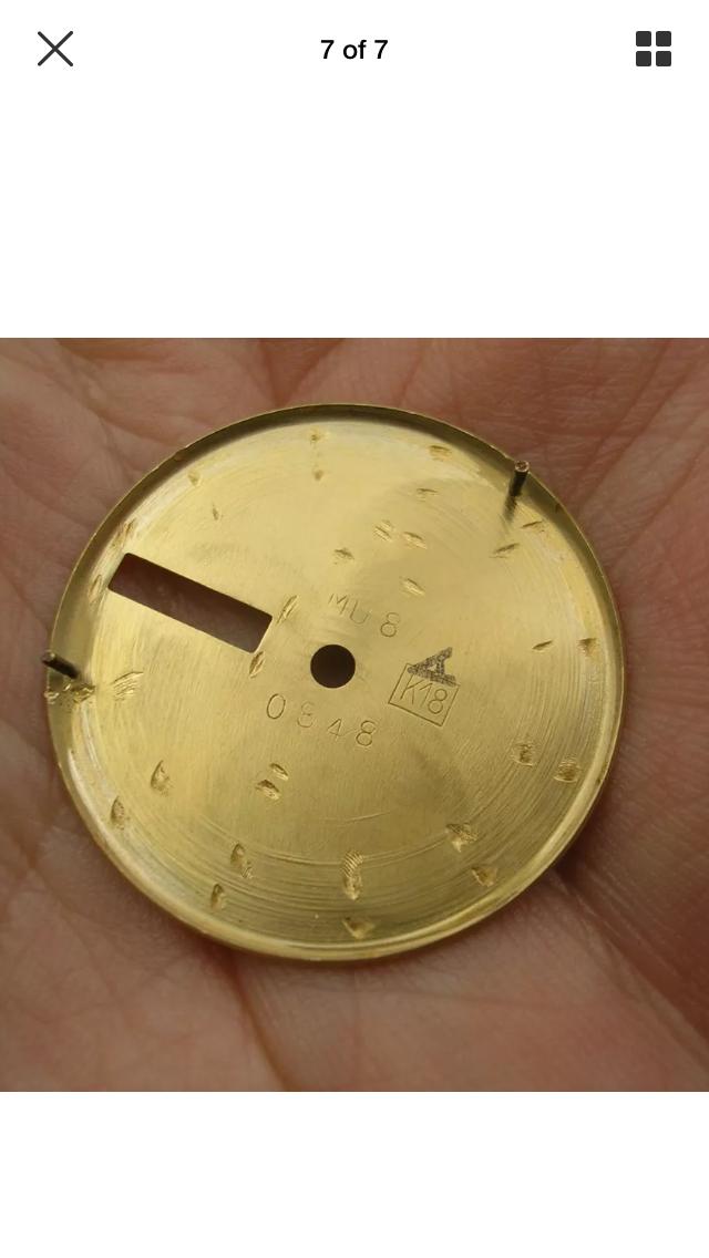

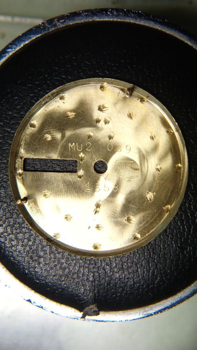

You can just make out the OM Swiss Made OM on the bottom of the dial which means it’s a solid gold dial.
However an 18k solid gold dial doesn’t belong in a stainless steel case, so unfortunately it’s a Franken parts watch.
The dial does have some value but at €1000 it would be a miss from me.

Its a bit tricky, I could not find more related details about this model but it's not the first one I see with gold dial on the web...

Got an extra one? 😀)
2,891
11,962
If I hadn’t sold it you could have had it. Nice watches. Bit small for me however
