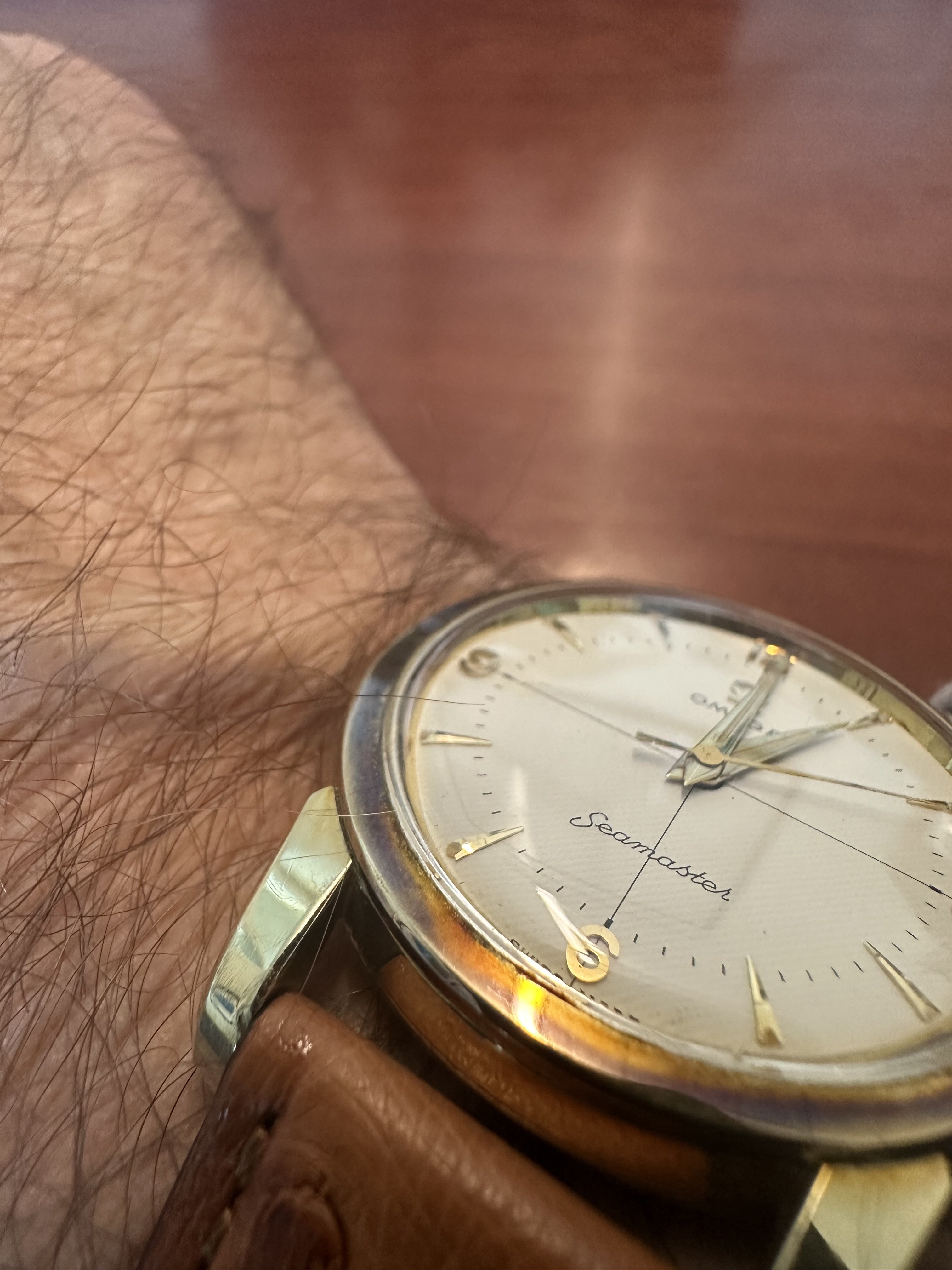

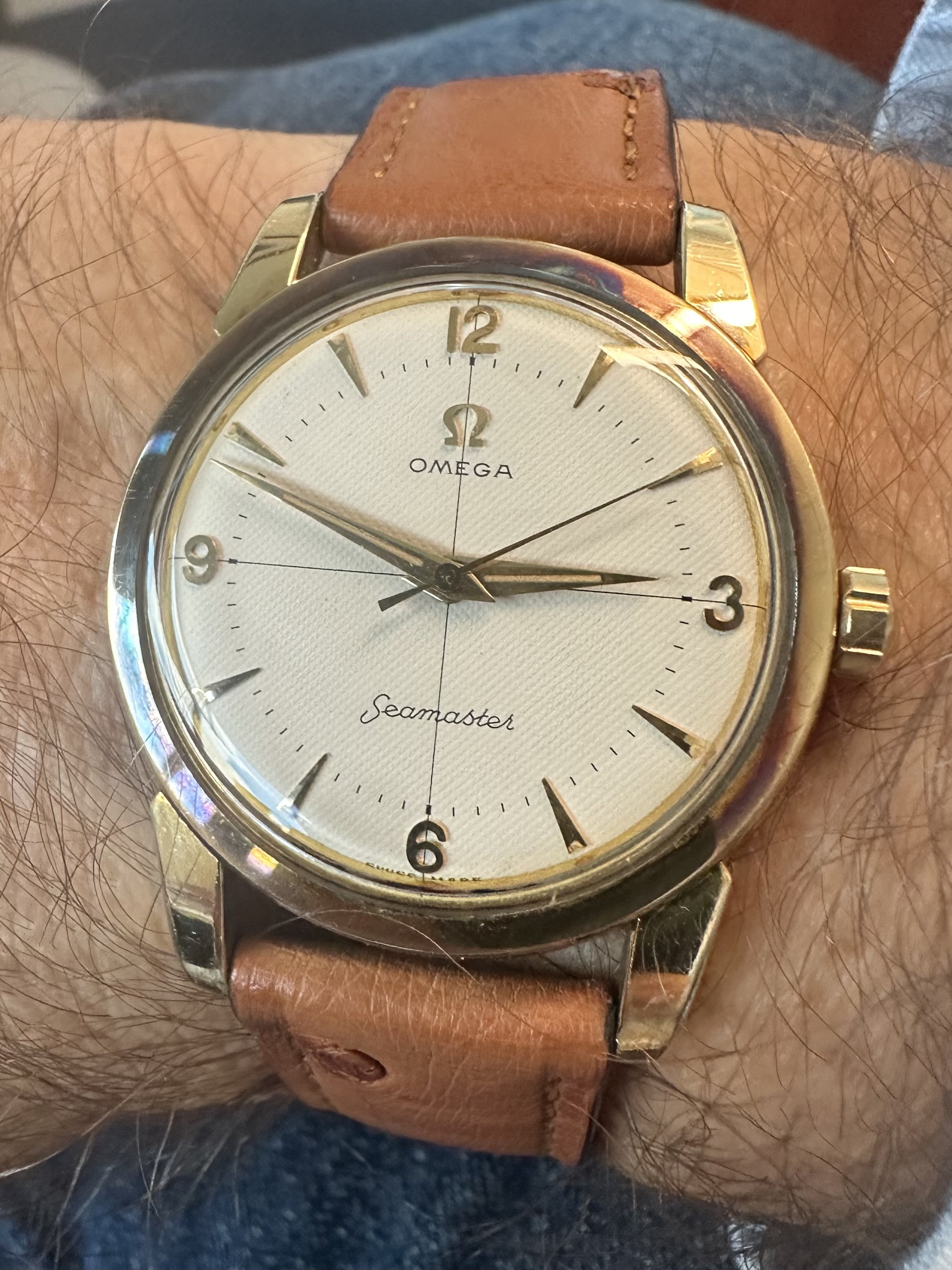

10,125
57,957
Ok, here’s a pic for the tarnish fans (you guys have issues by the way 😁).

10,125
57,957
I hate the tarnish, but just look at that PERFECT honeycomb dial and hand set. Even the radium lume dots are all there. From 1956! 🥰🥰🥰

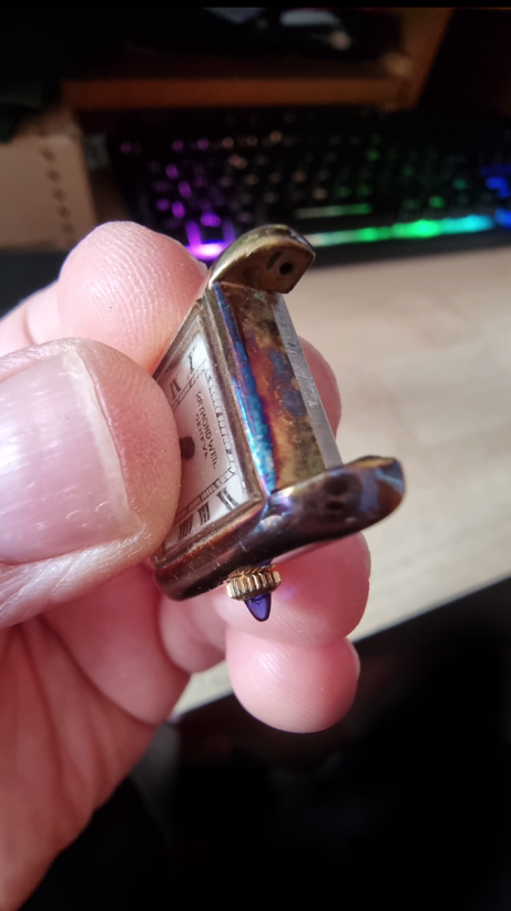

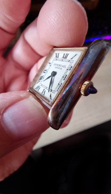

18,326
27,697

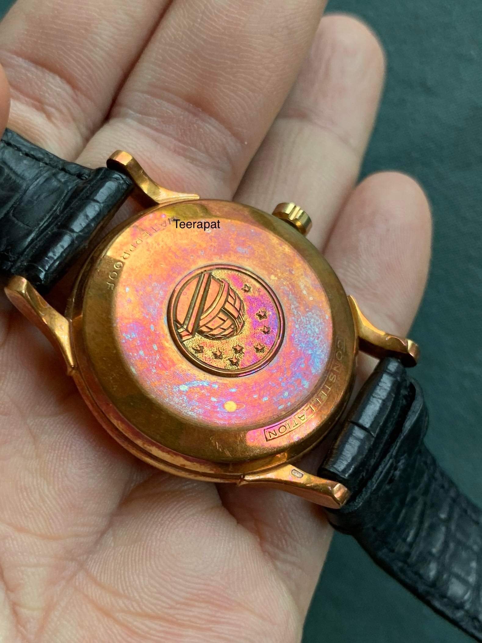

Personally I like the tarnish. Much more common to see this on rose gold, due to its copper content.
Got any recommendations for a rose gold capped that is heavily tarnished?
3,678
8,008
A bit longer to get to Teerapat level but im in the tarnish camp
