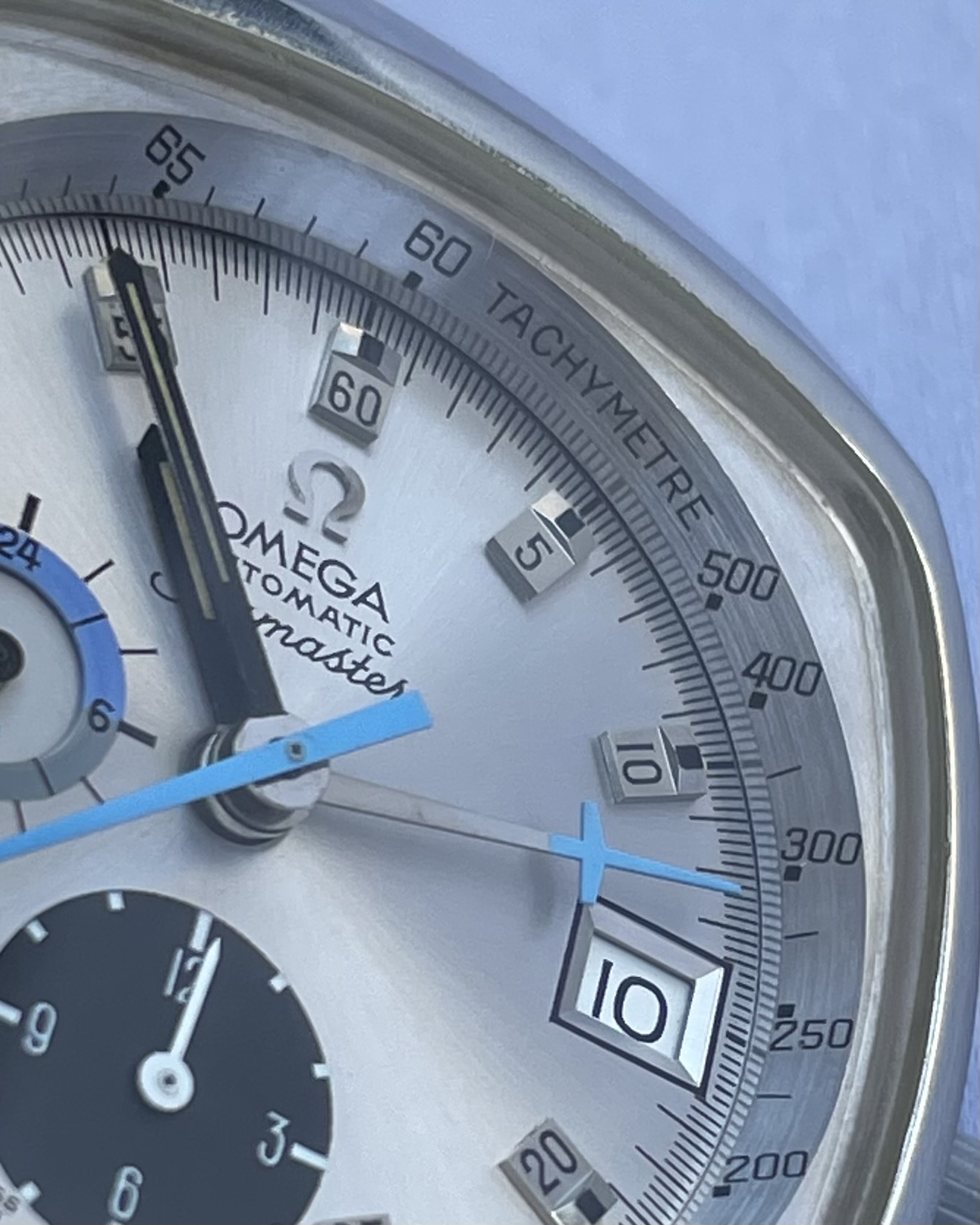

Could I ask that you guys help me compile a list of practical uses for the tachymètre bezel with descriptions.
I'd like to keep editing this post and put together a long list.
1. Speed with Fixed Distance
Knowing the distance between A & B as 1 Mile or 1 KM. Start the chrono at point A and stop at point B.
The speed will be represented.
For example 45 seconds would be 80 Miles per hour or 80 KM per hour.
With any of these if it's doubled like A & B is a 2 mile mark then you need to multiple by 2.
So 2 miles at 45 seconds reads 80 MPH multiple by 2 gets you 160 MPH
If the time for 1 mile is over 60 seconds then you need to divide by times around the dial +1.
So if it's 1:45 you get 80 then you divide by 2 since it went past the 60 seconds mark once.
It shows 80 divide by 2 is 40 miles an hour.
2. Distance with Fixed Speed
Driving 65 MPH start the chrono and when the hand reaches your speed (65 MPH) you have now gone 1 mile.
This can be done with KM as well.
3. Production Per Hour
If it takes under a minute to create something like in a factory you start the chronograph and stop when finished.
If it takes 45 seconds to paint a product then you can make 80 an hour.
From my understanding if it takes 2 minutes + 45 seconds, you need to divide by times around the dial +1.
So you would need to divide by 3. So it would be roughly 26.6 painted per hour.
Any more to add to the list. I could actually see myself using number 2 on the highway if I need to find an exit or number 3 If I'm doing something and want to figure out how long it will take.

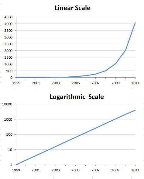

@Hands90
to explain miles per hour easier...
on most freeways there are mile markers. Start the chrono when you pass one and stop when you pass another. If it’s been 60 seconds then 60 miles per hour. As 60 seconds in an hour. If it takes 30 seconds your going 120. Or 2 miles a minute. It’s a logarithmic scale. Hence 15 seconds is 240 miles an hour.
5,537
9,475
@Hands90
...It’s a logarithmic scale....
*tosses all my old college math textbooks in the trash can*
"Whelp, I best be dropping out of engineering now 'cause I've been doin' math wrong for the last 35 years. I hope that bridge doesn't fall down anytime soon."
(hint -- it's a linear equation)
3,997
9,030
Aww sh*t somebody ‘bout to ask a bystander to “hold my nerd glasses so they don’t get broke”
Here:
18,326
27,695
the scale is not the same and represents a value that is getting increasingly higher over a uniform distance, while it’s growth rate is not the same over distance.
What else do you call it.
change years to seconds and the tachy value to the vertical scale.
