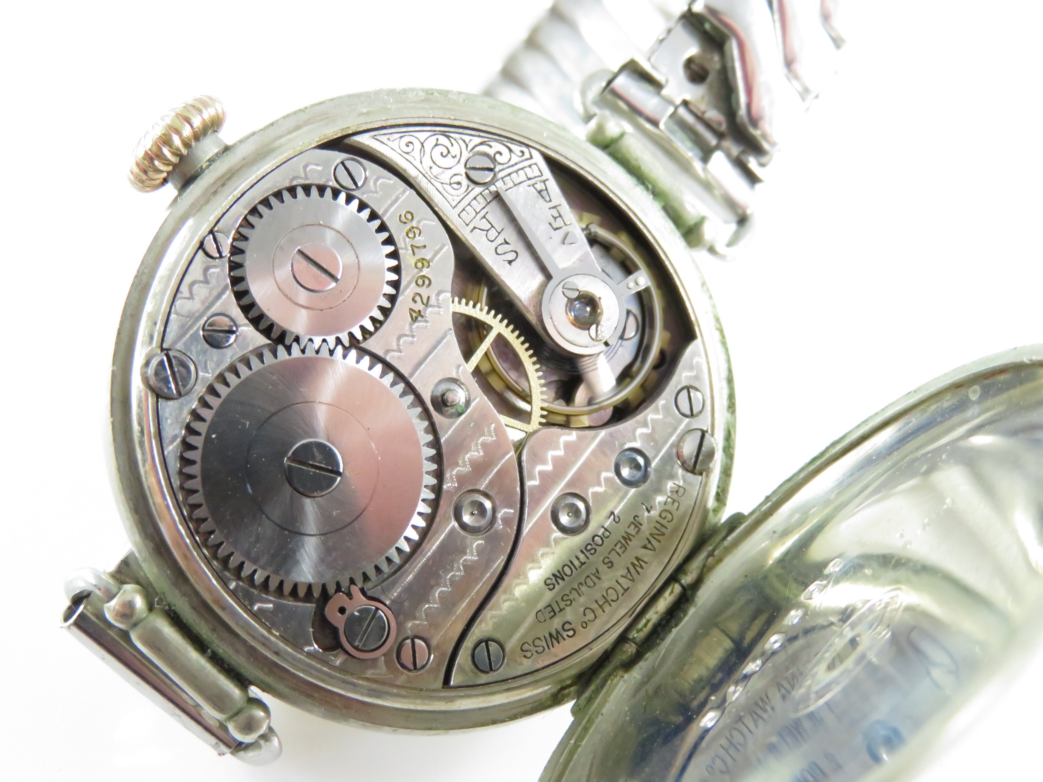

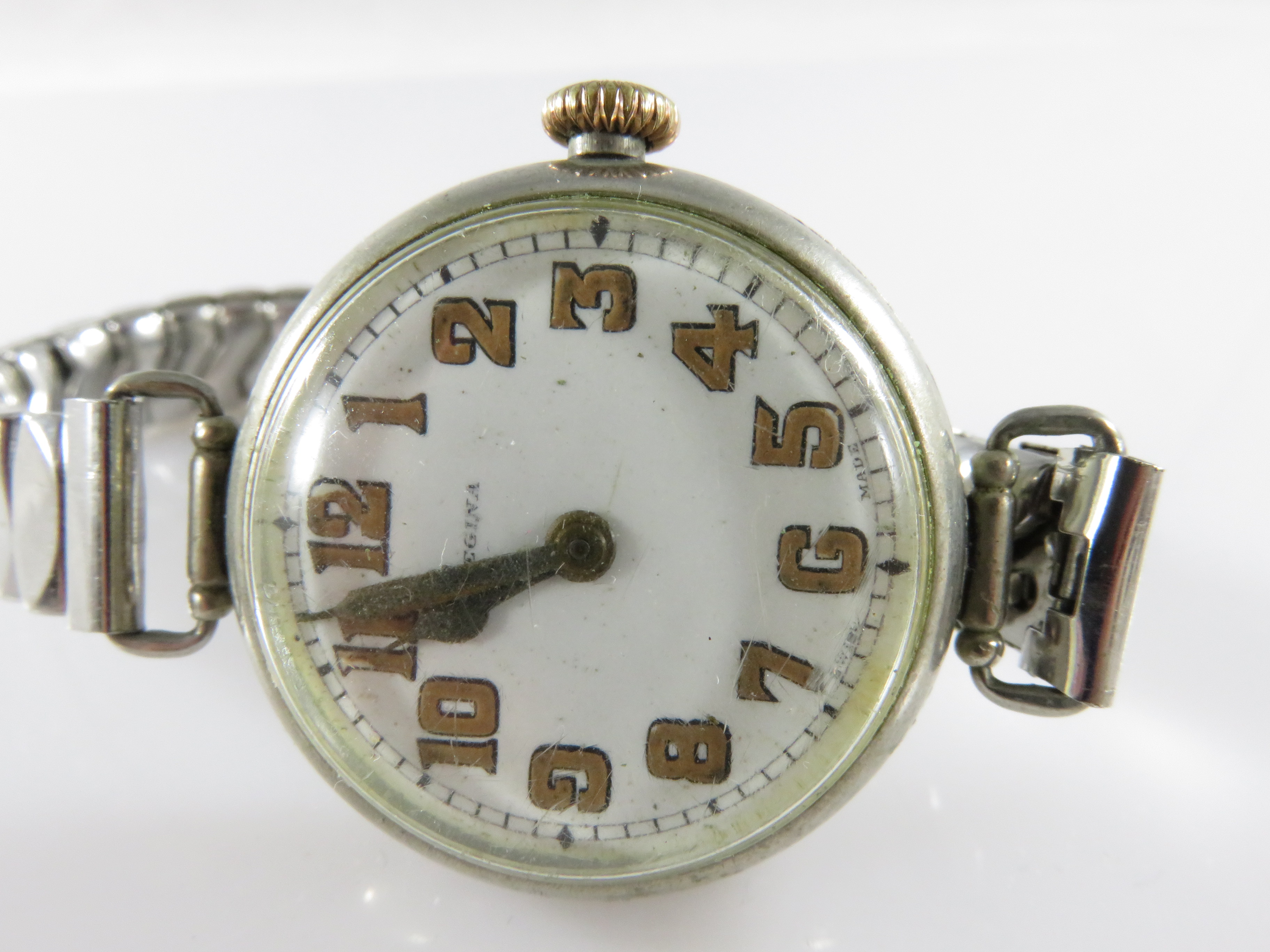

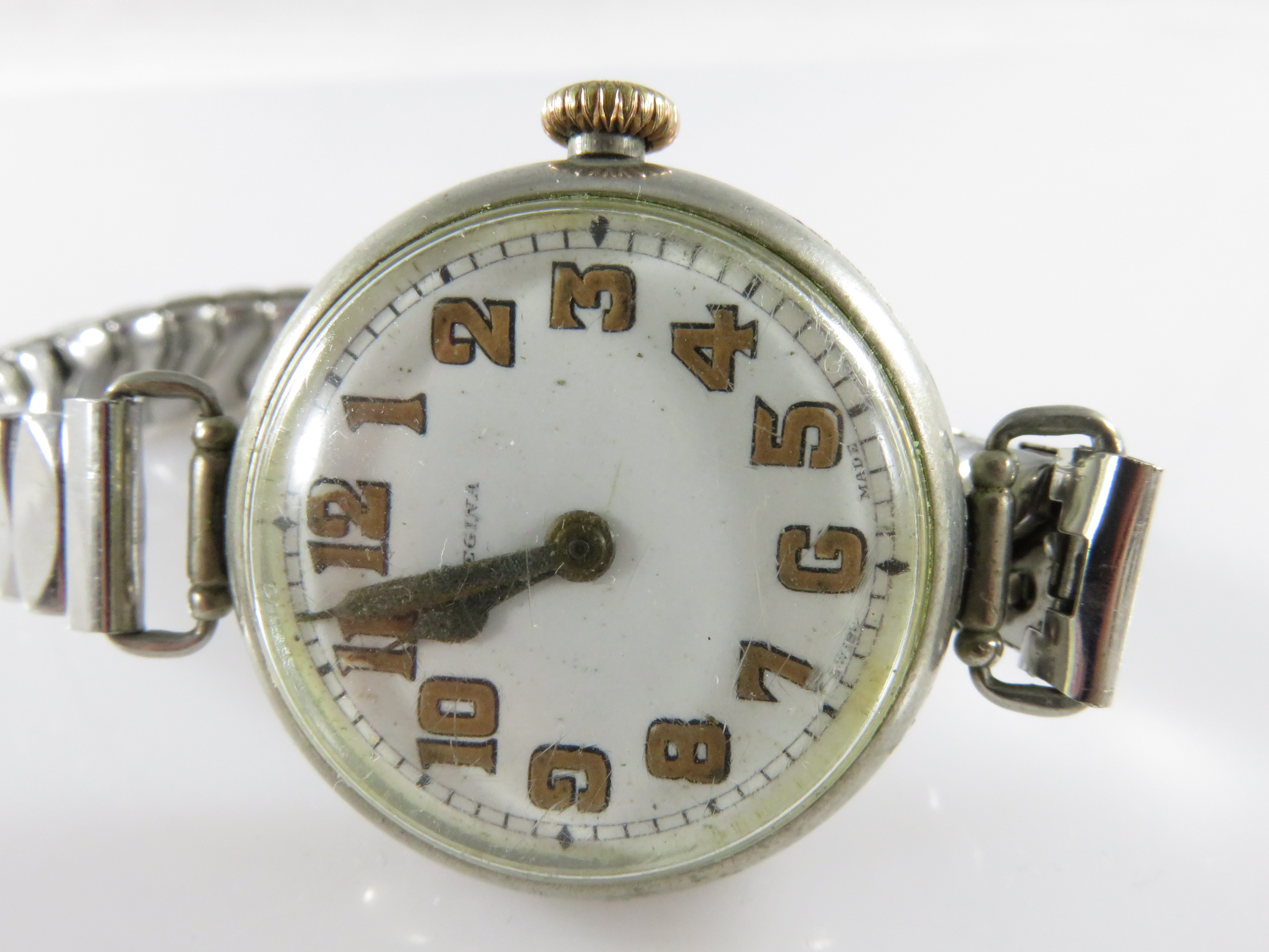

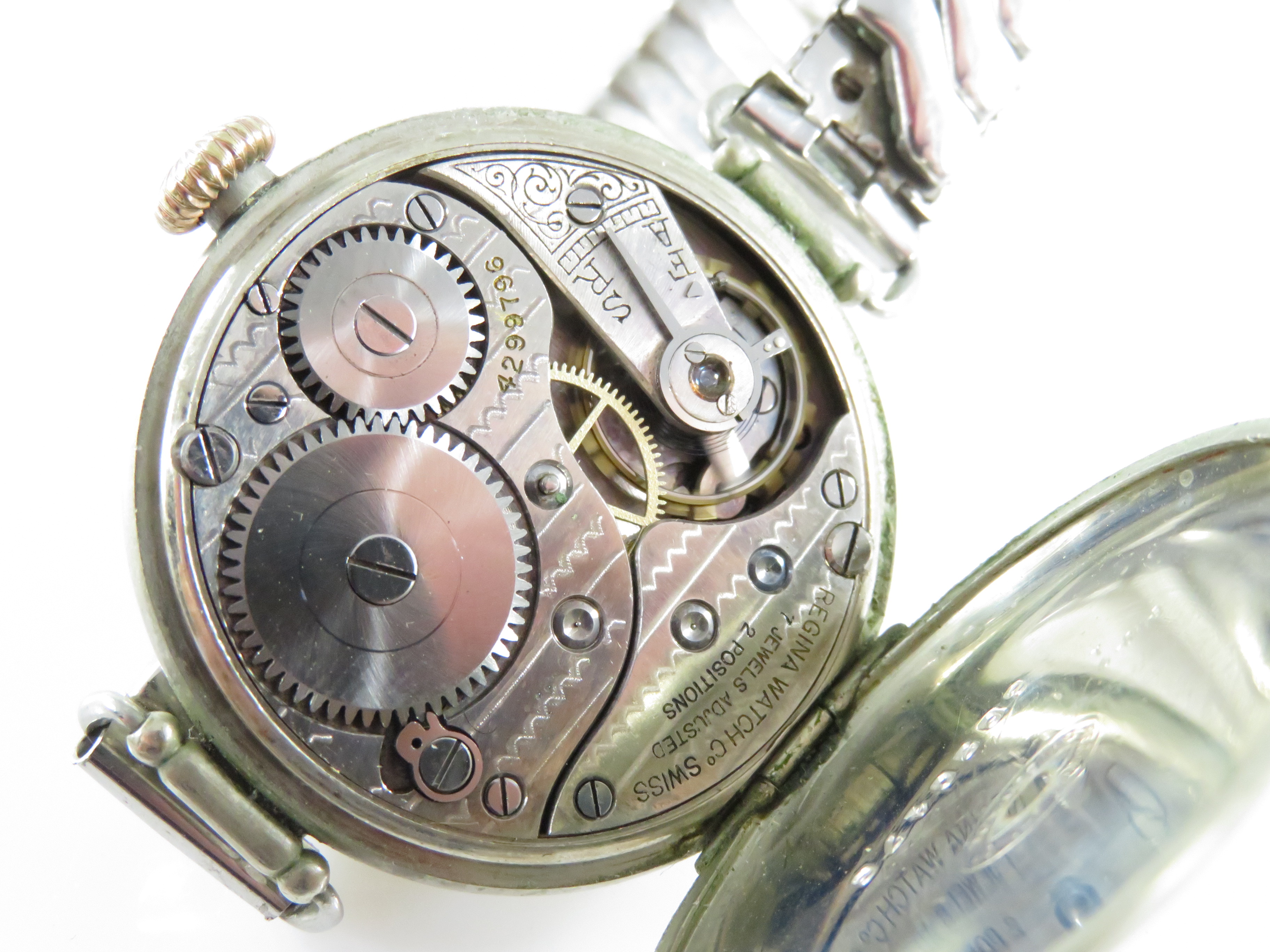

So, I picked this watch up earlier this month based upon some older threads in this community and was hoping to get some assistance or clarity in what I actually managed to acquire. It is hard to say what I actually paid for it as it was part of a larger lot of diverse items. My out the door cost on the entire lot was $120.00. Many of the items in the grouping date properly to the expected time period of the watch. If I were to cost average it with the wholesale value of the other items I can reasonably expect to retail in the grouping, I probably paid in the neighborhood of $15.00 for it.

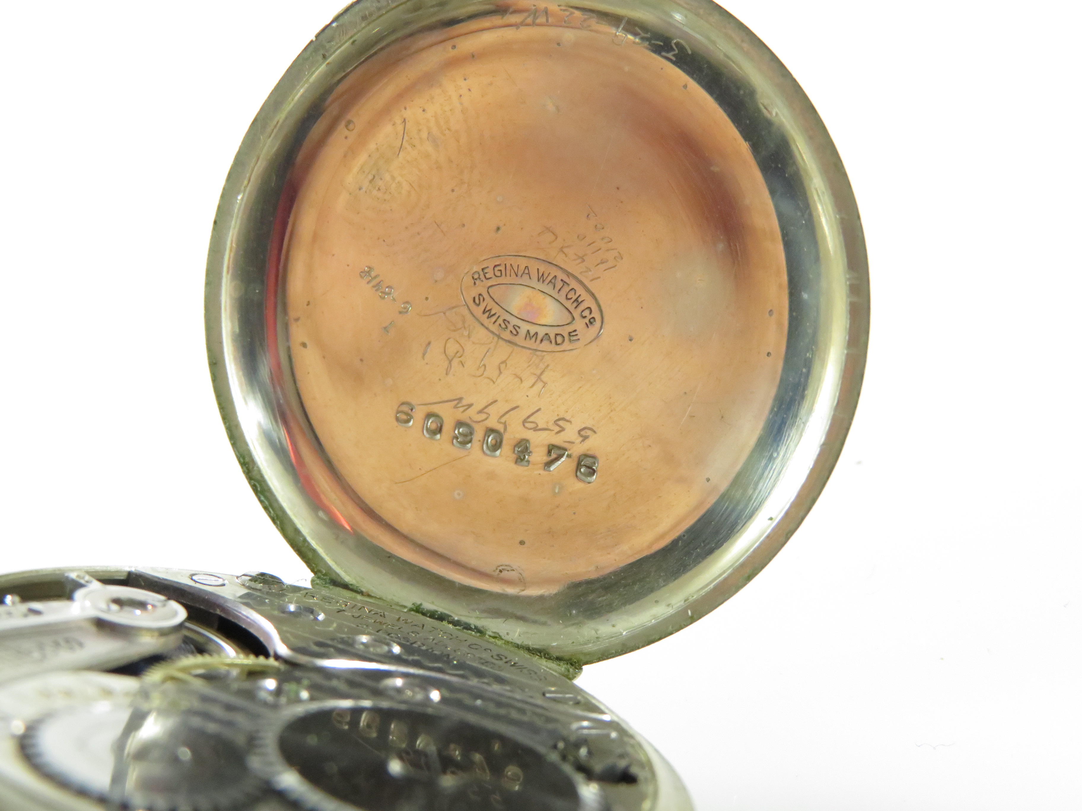

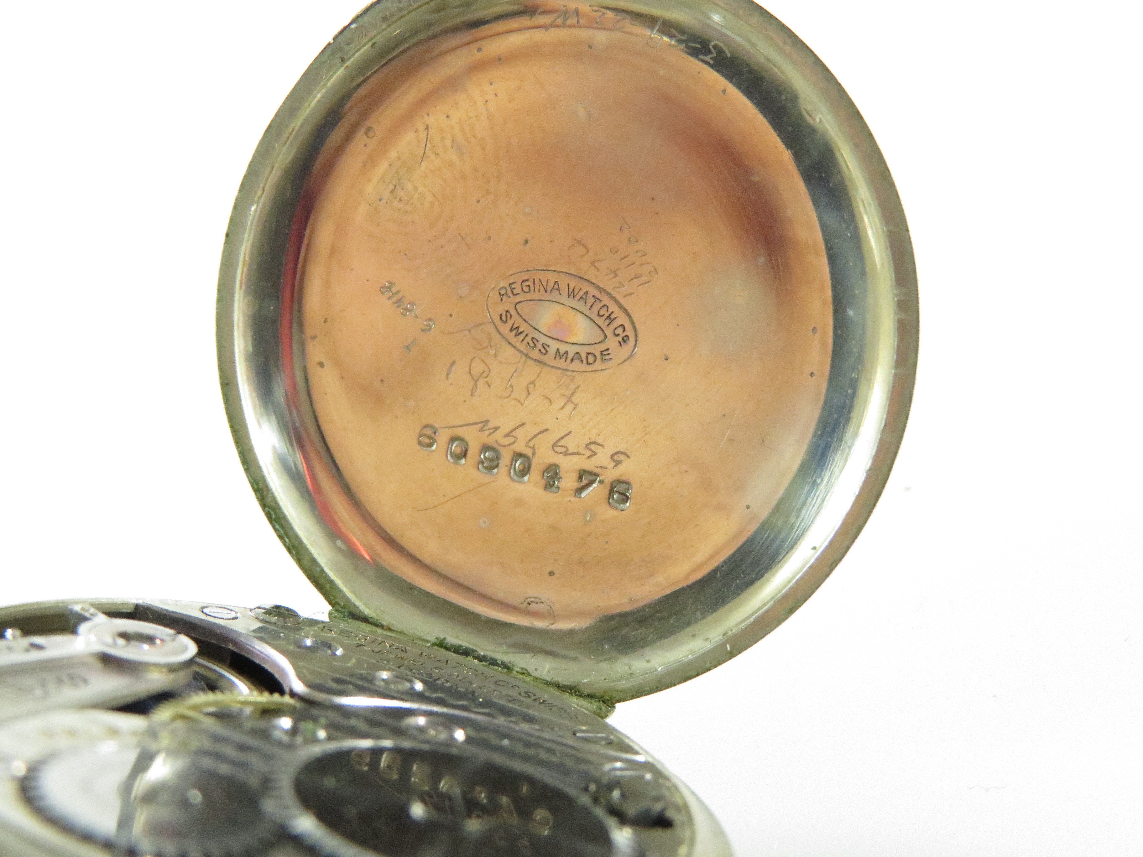

Works serial number 4299796. Watch is a 7 jewels adjusted, 2 positions. Watch works are running about 1 minute fast every 24 hours. Winds and runs without issue. Top of the case is screw on, though I cannot unscrew it which is just as well given the dial materials used. Crystal appears to be a plastic material. Case measures 35.92mm across with the crown and about 37.05 lug mount to mount with a rise off the wrist of 11.69mm. Case is a swiss made nickel. Case serial number 6090476 and marked Regina Watch Co. If you need or want additional information, please don't hesitate to ask, I'll do my best to provide it.
I guess my questions are really; is this an "Omega" or "Omega Related" watch; if yes, what model works is it running; if yes, is it rare; in either case is it considered a WW1 trench watch; and what would your opinion be as to the kind of retail value something like this might enjoy in an as-is as found condition (if forum rules allow this information)?
Thanks for any assistance you can provide
16,008
48,188
To ask what something is “worth”, assumes there is such a thing as a “market value” for a particular item. A liter or gallon of gas has a “market value”, because a lot of gas is sold in a particular market. The value for your Regina could be either your assessment of value as the owner, or the assessment of the value ascribed by someone who might buy it. But let me say that a 7 jewel, standard grade Regina watch in a silver case offered for sale would not likely attract a lot of attention. Regina watches were the little sister to Omega, and not highly sought after. Rare? I know of no reference that would list how many were made. But easily tens of thousands, to hundreds of thousands. So not rare. In short, since you are the most recent purchaser of a watch like this, it is worth what you paid in your market. Put it on eBay with no reserve, and you’ll find out what the market says it is worth!

In think that Regina was a registered trademark of Louis Brandt & Freres as well as the brands Patria, Champ, Civic, Critic, Eagle, Ethic, Himalaya, Meric and Valdez. Brands used to supply with inexpensive models retailers who were not part of Omega's official distribution network

Thank you Bubba, that was helpful information!

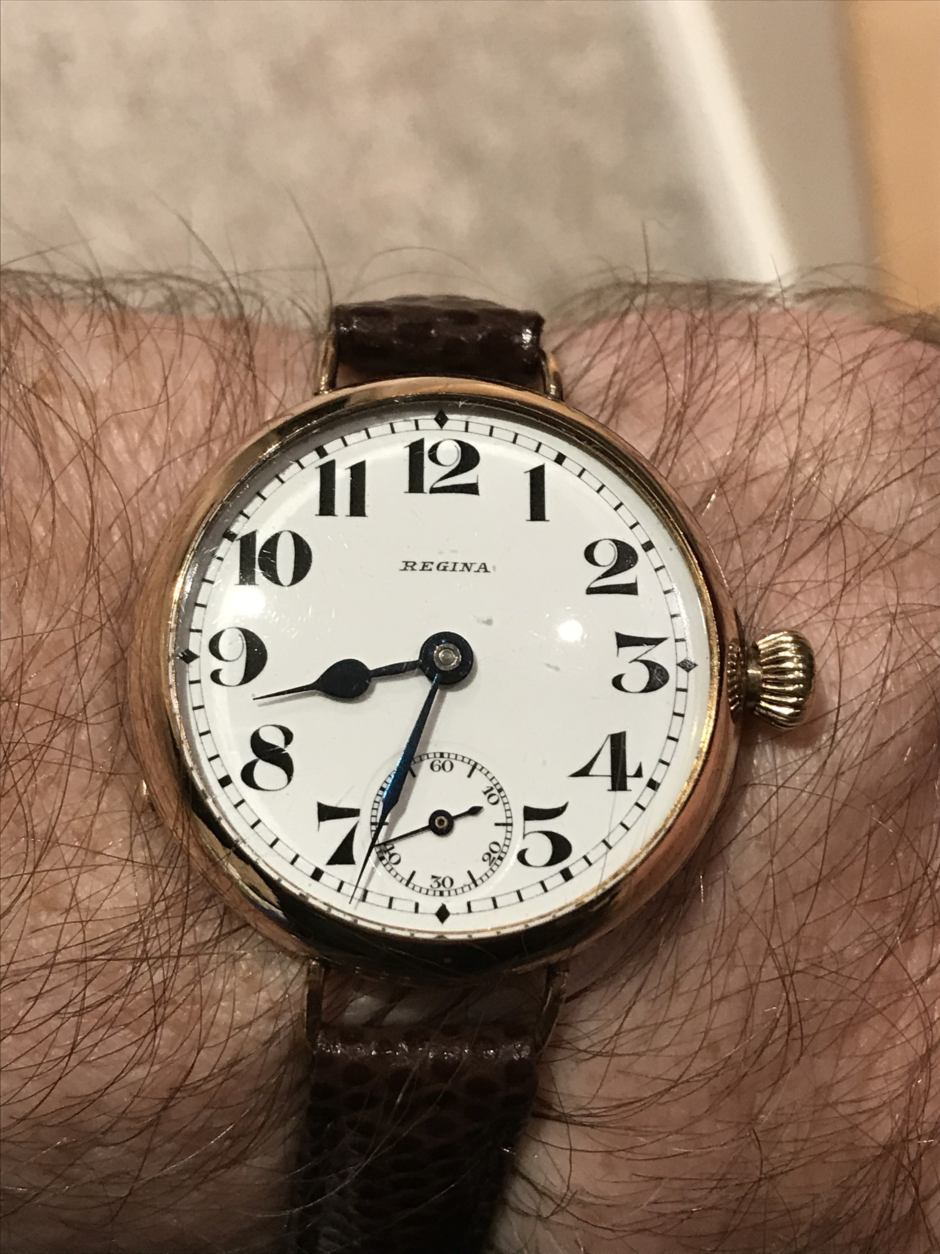

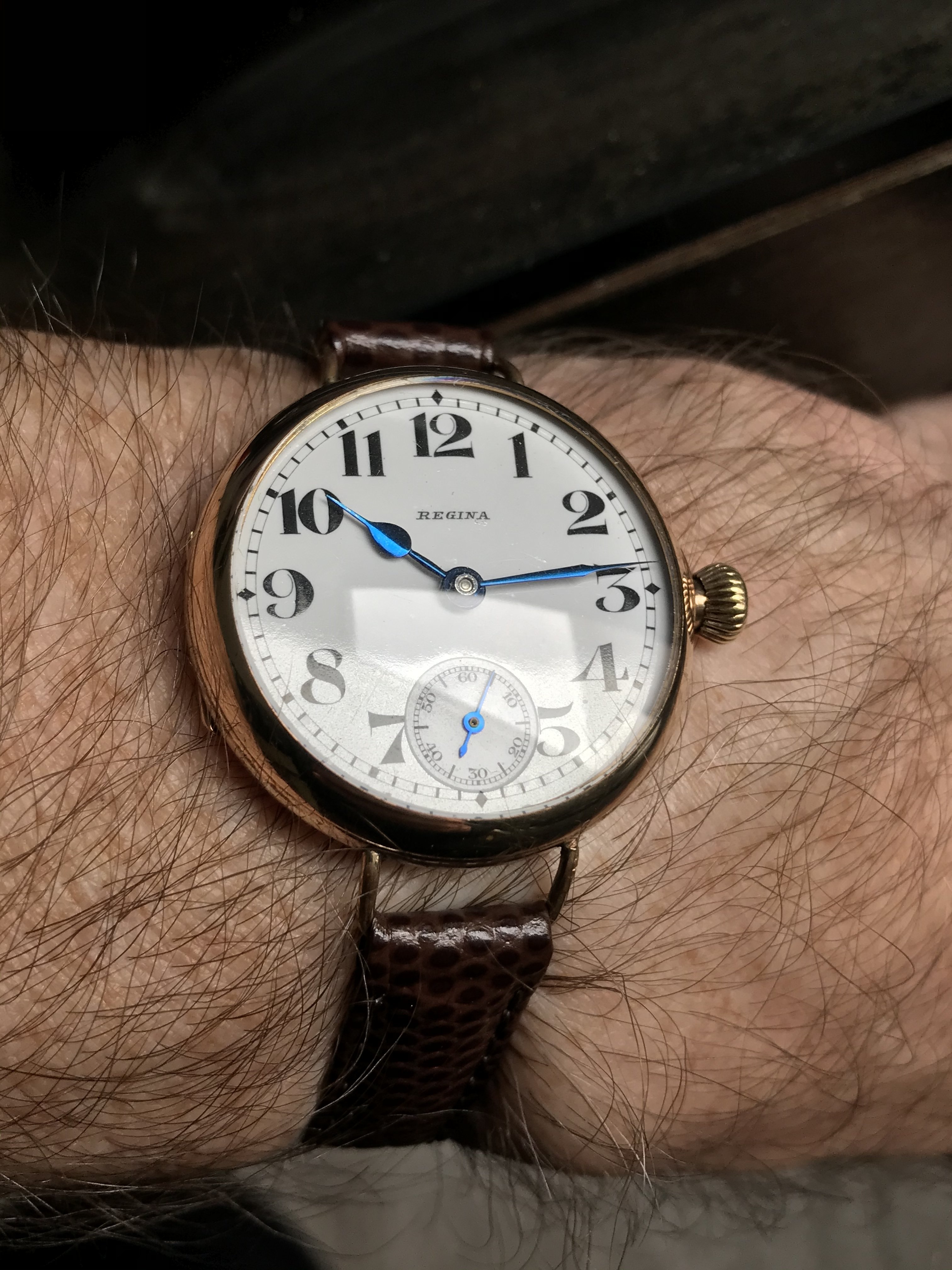

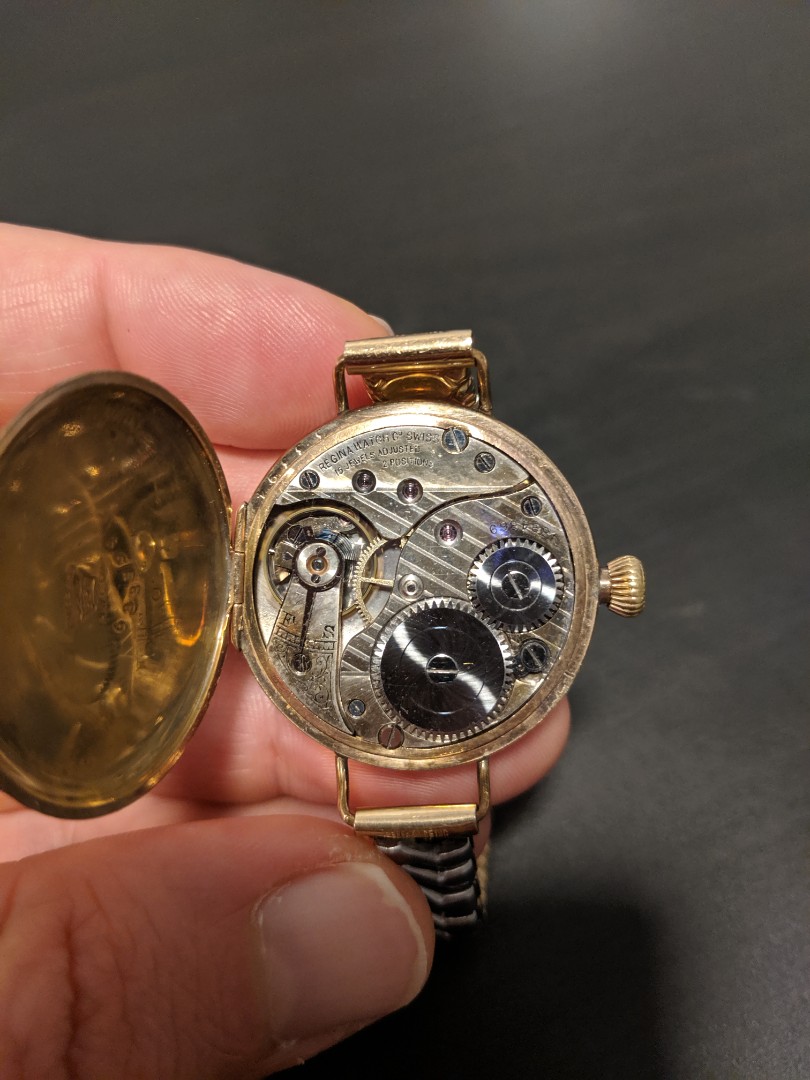

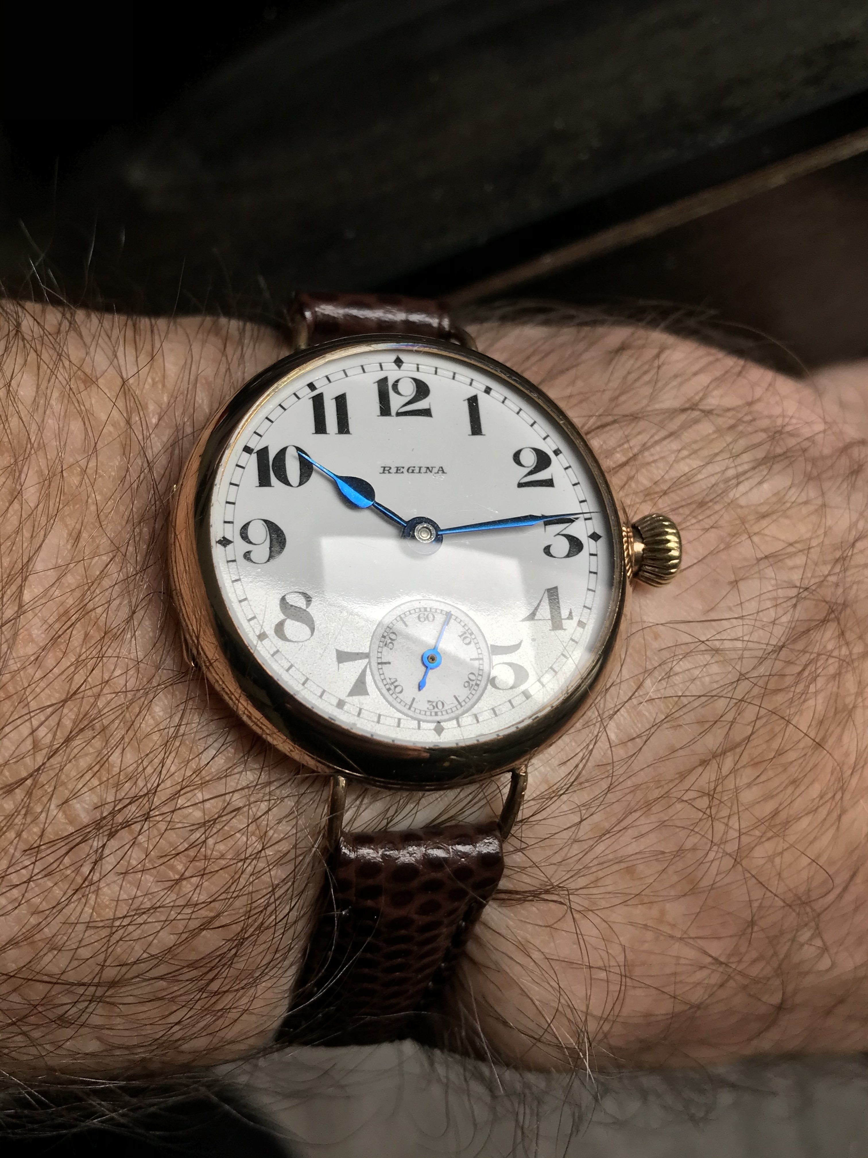

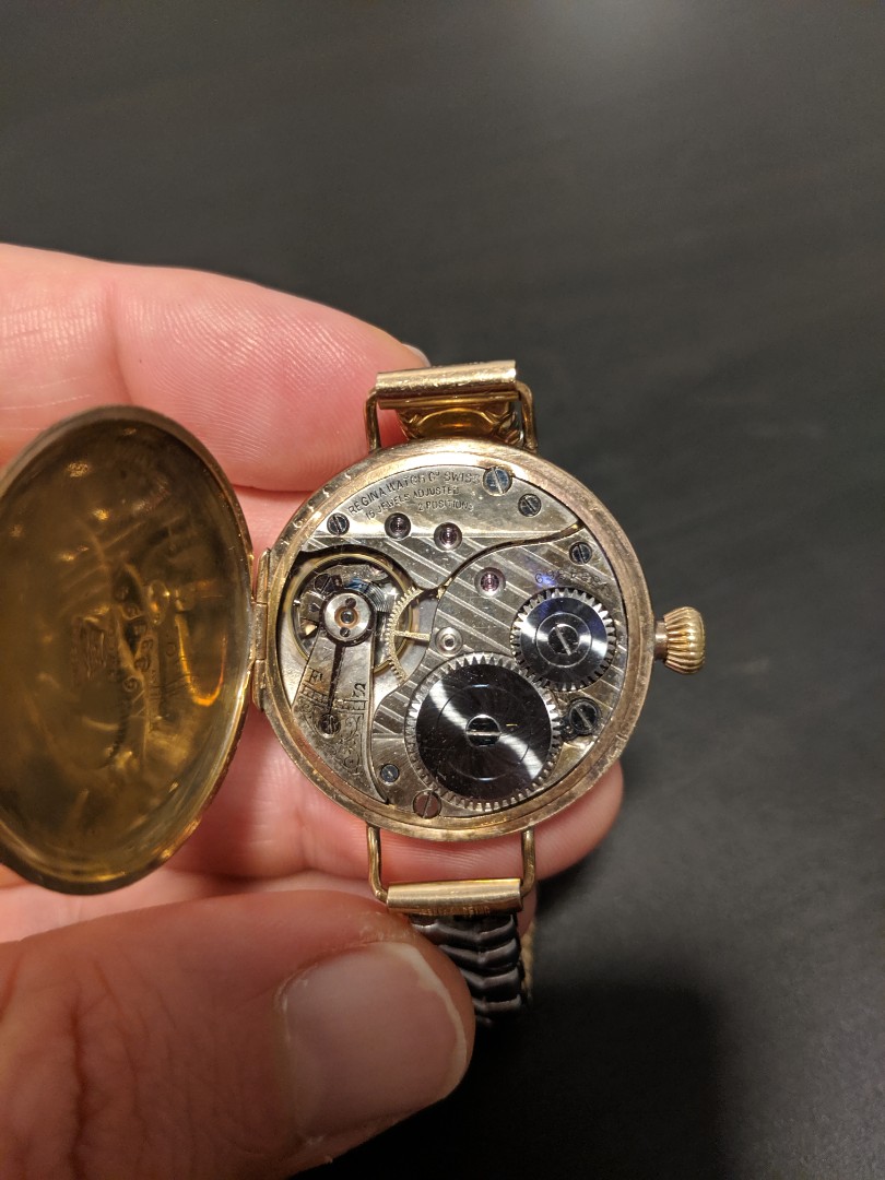

Cool Regina trench. I also have one, with Canadian provenance; likely went overseas with a member of the Canadian Expeditionary Force in WWI. I also found a bit of information on Wiki, of all places. These are more than likely converted pocket watches (possibly smaller models meant for women?).
A few pics (not technically great!) and the info for you:

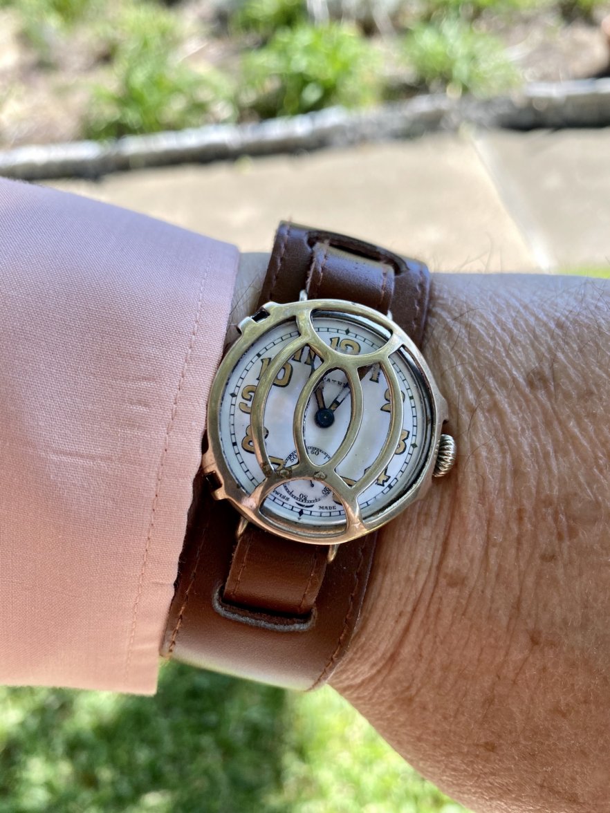

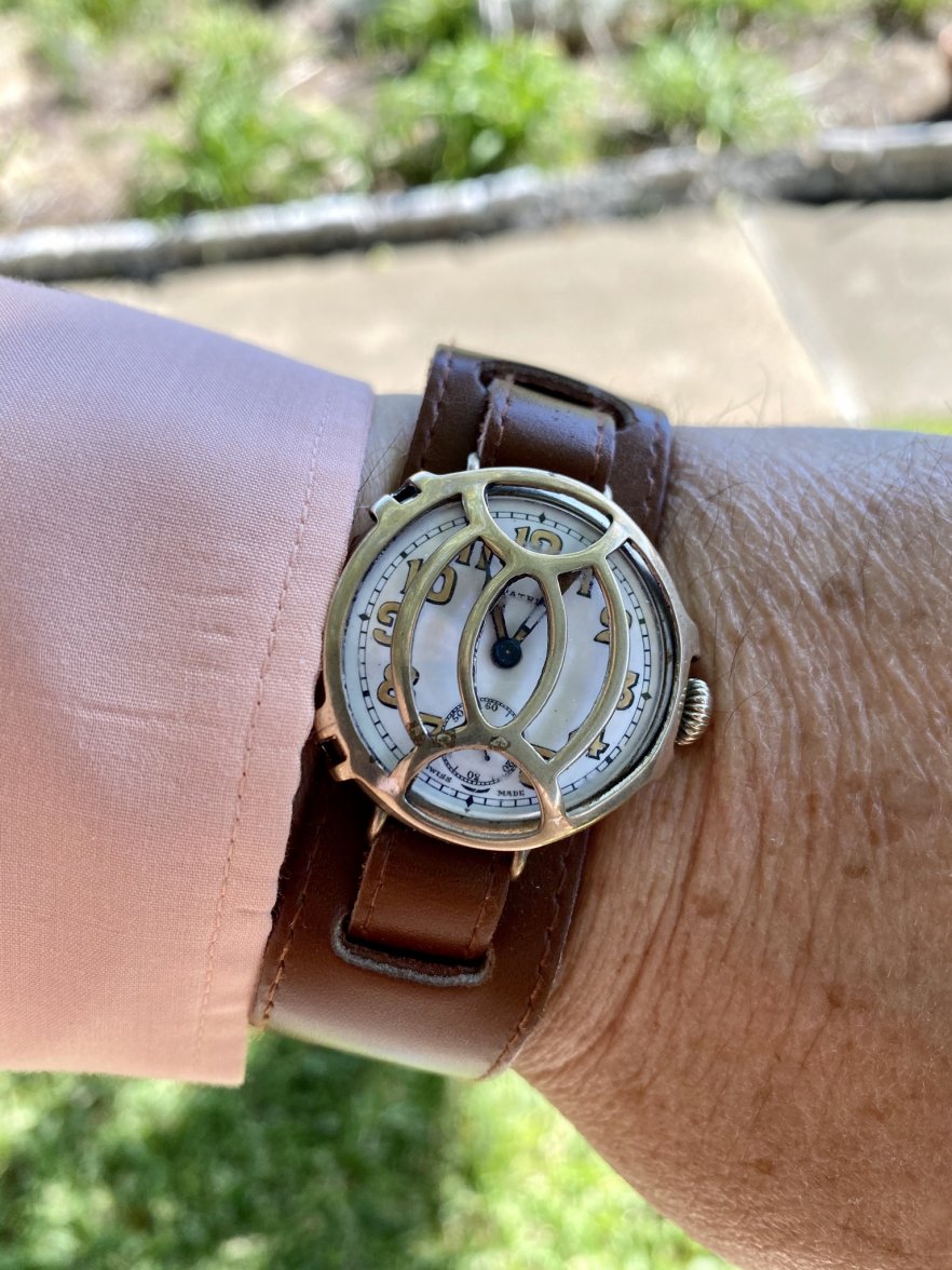

Patria with protective grill

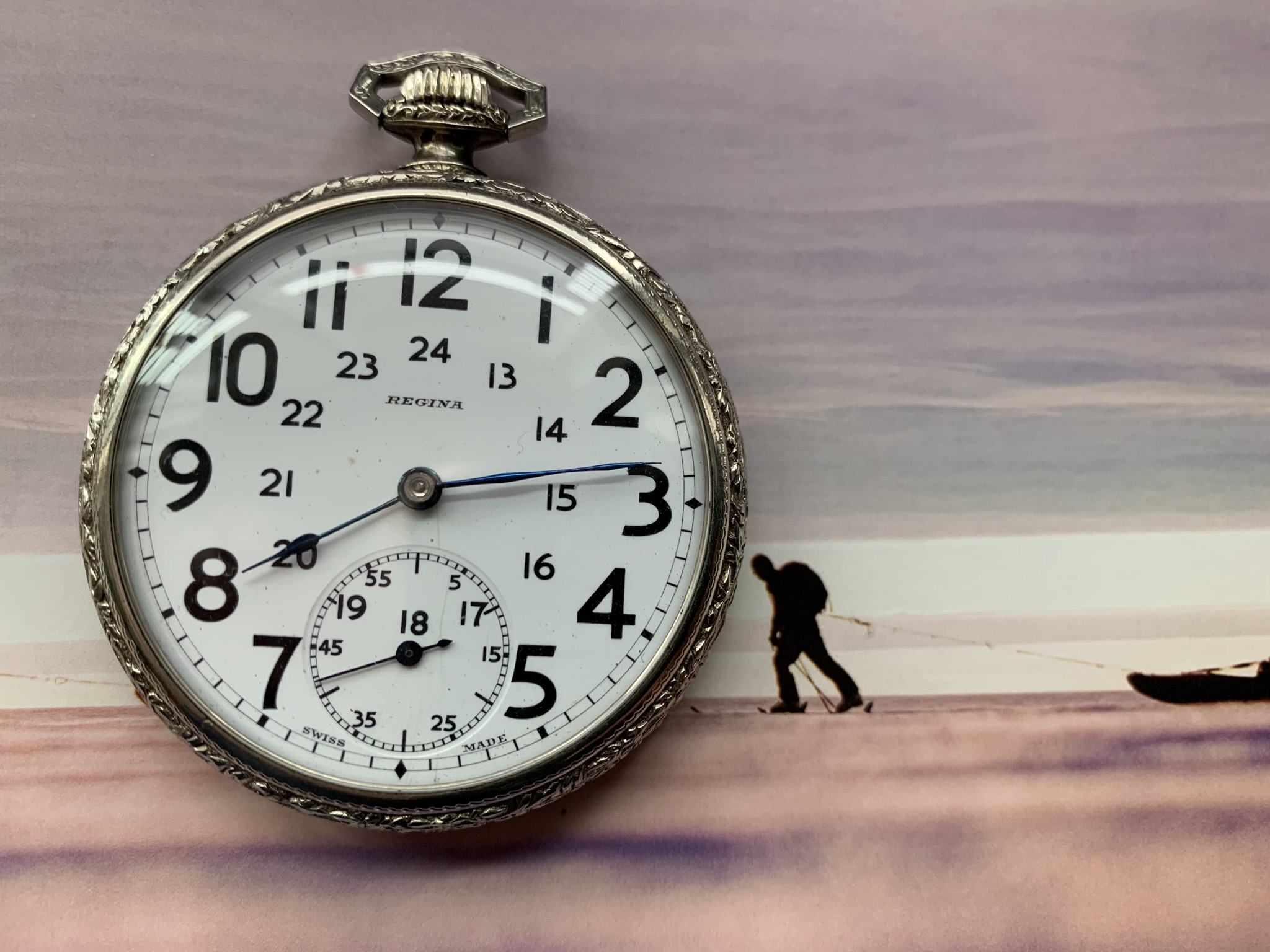

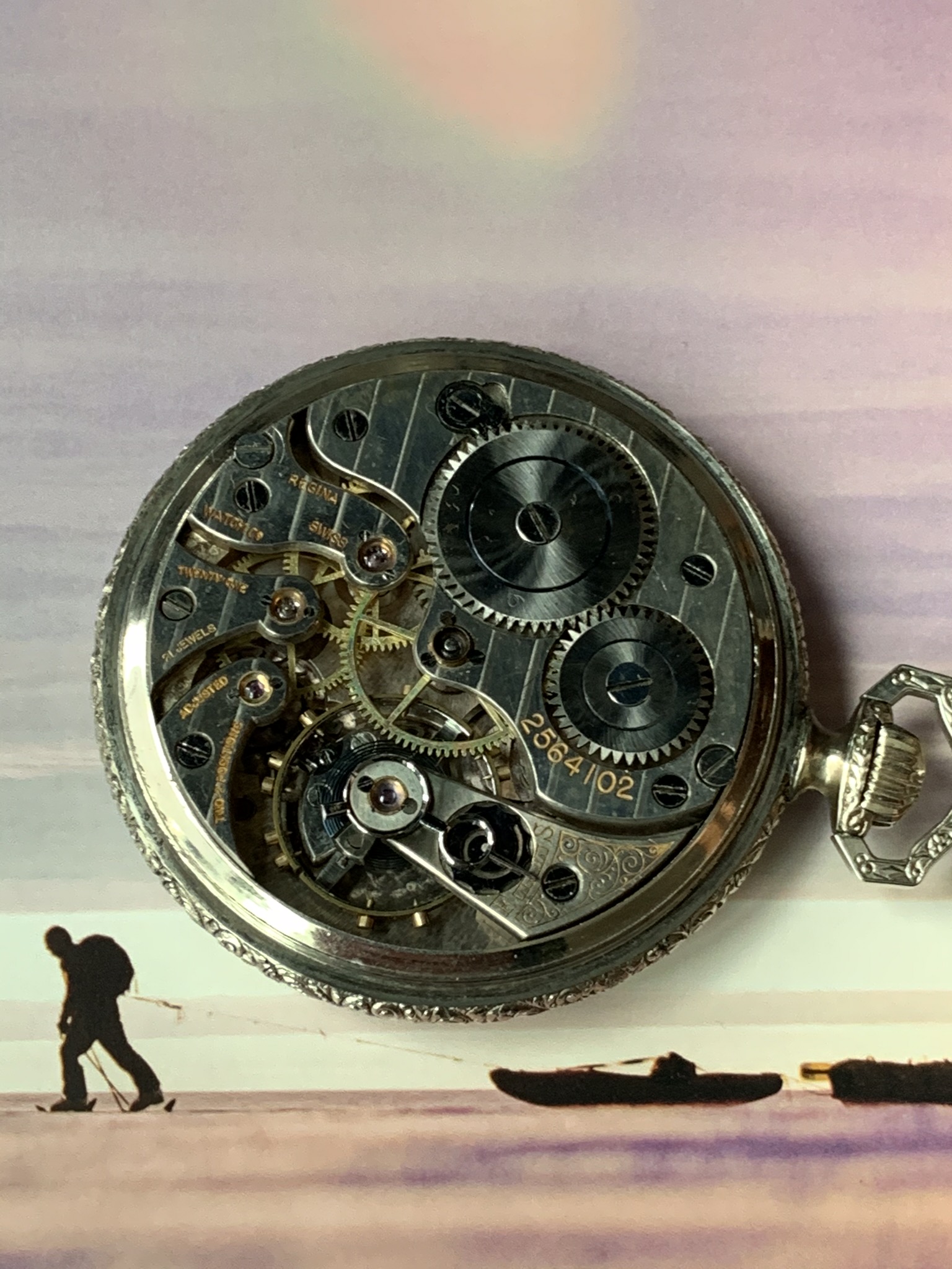

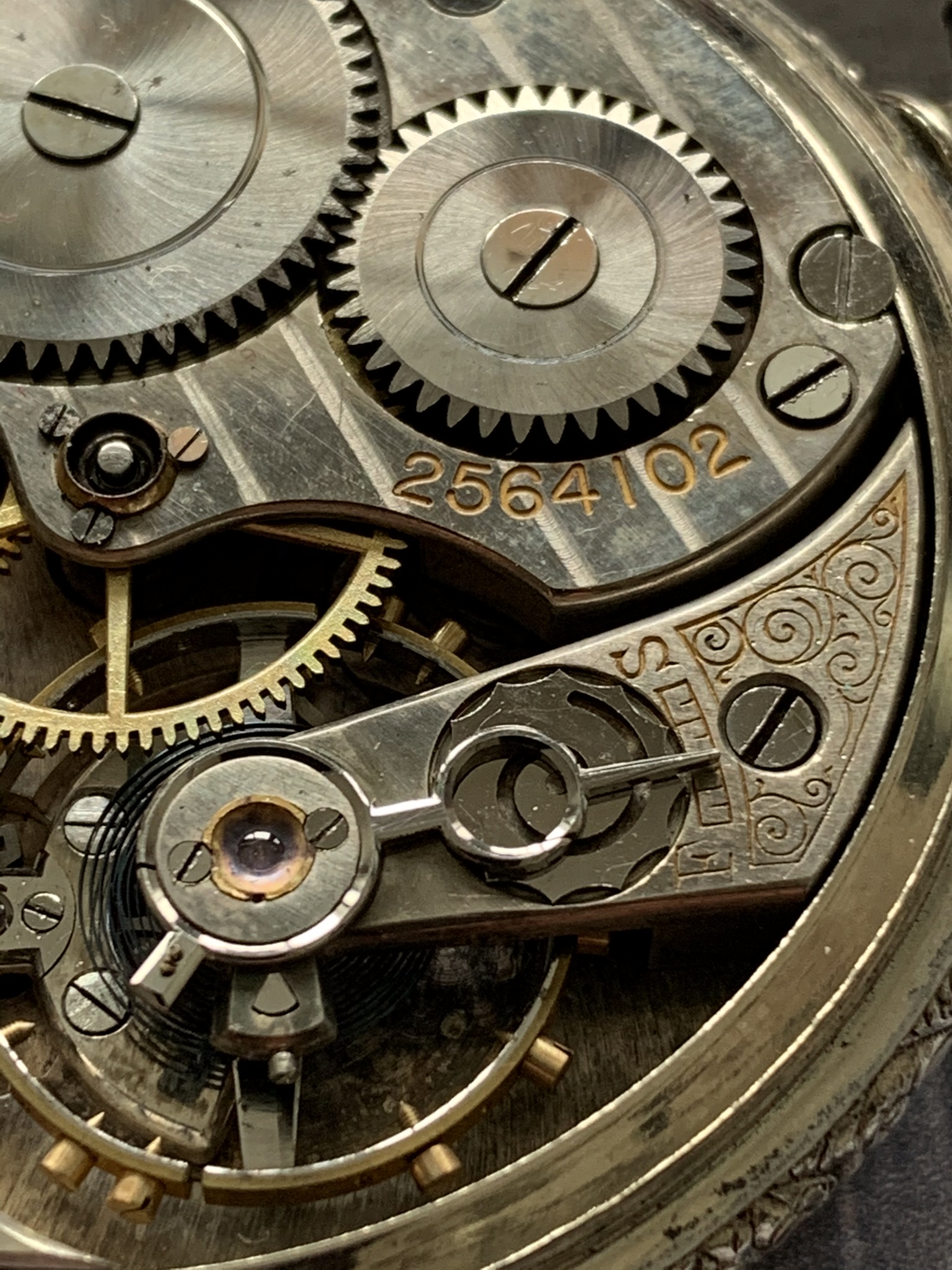

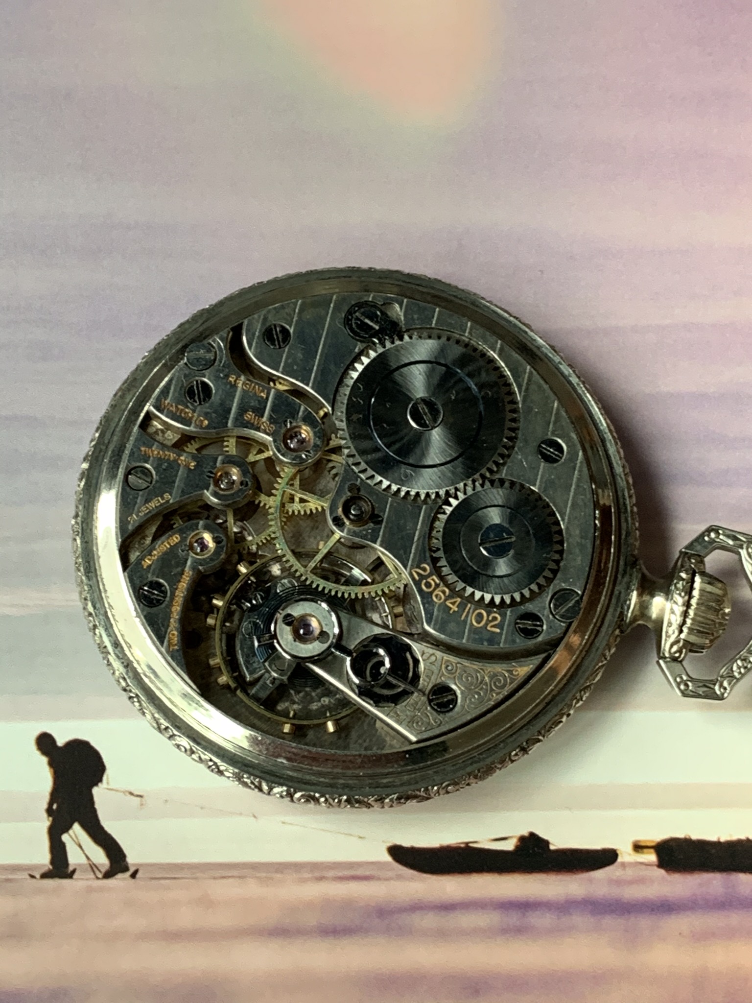

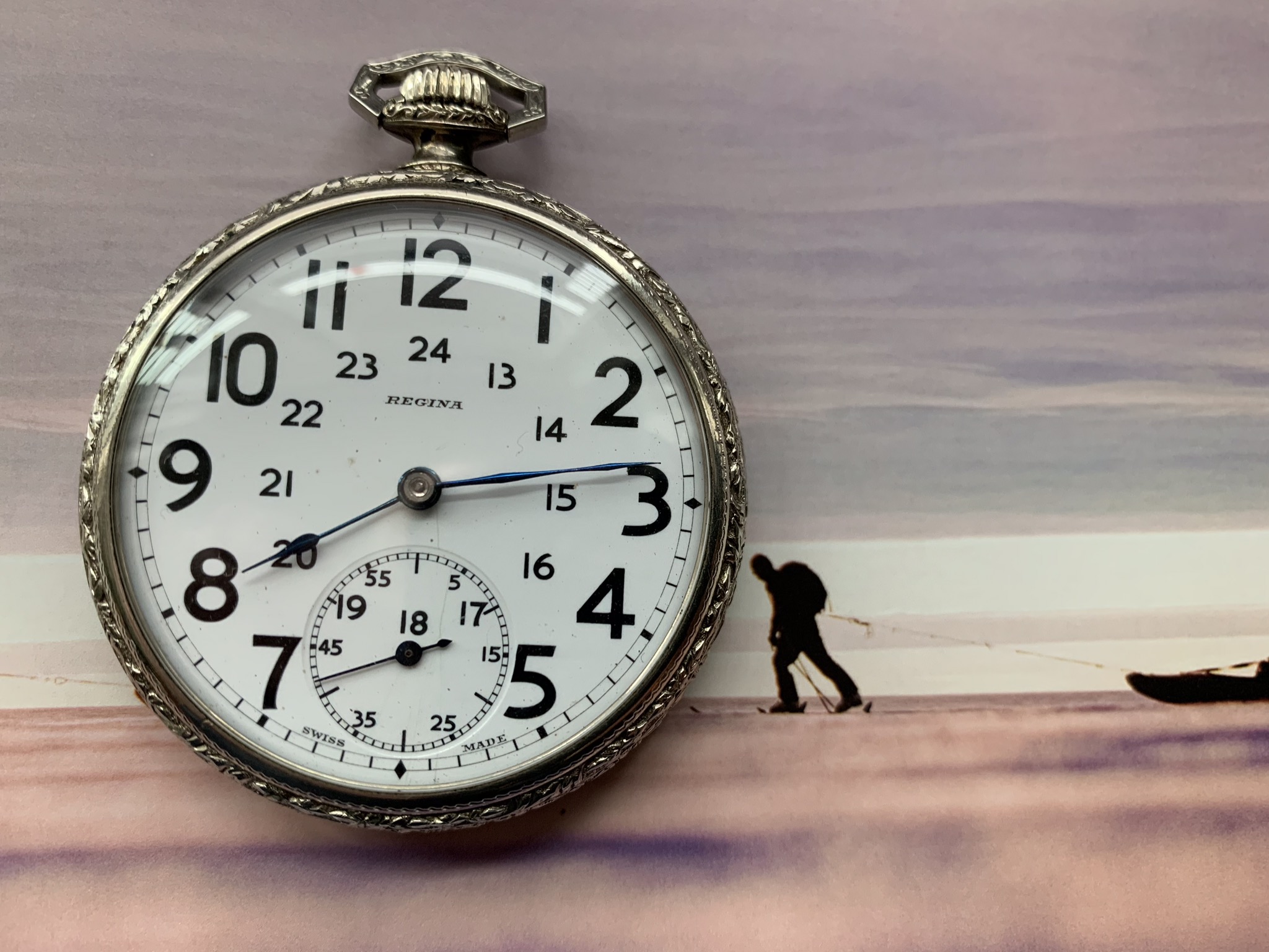

This was discussed elsewhere on the forum, but for this discussion here is my Regina (Omega) 24hr dial 21j adjusted pocket watch. Serial dates it to c1916-20. Cased in a 14k white gold-filled Illinois Watch Case Co Elgin “Tivoli” case c1924. So maybe it’s been recased, or maybe it sat unsold for a while. The confusing history of the casemaker is available here https://mb.nawcc.org/wiki/Illinois-Watch-Case-Co#Illinois-Watch-Case-Co--A-Brief-History (with thanks to @Canuck for the lead)
A typical “Canadian dial”, here it is shown during a typical Canadian summer
