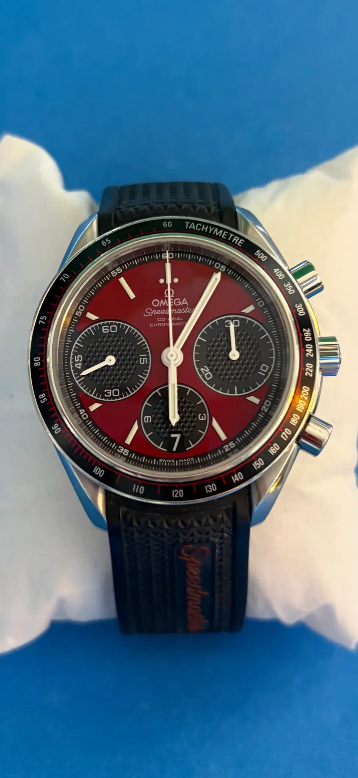

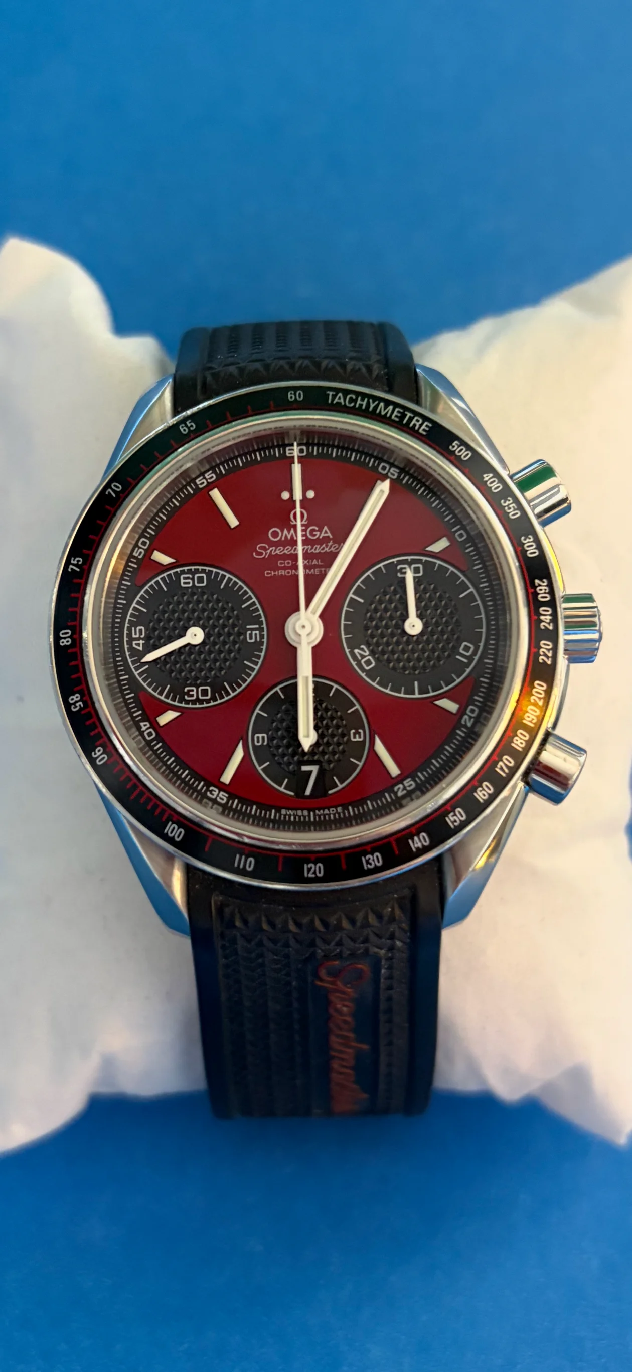

Davidt, Good morning, I am considering replacing the bezel on my Speedmaster racing red dial. Can I trouble you for some advice? I am searching for a reputable professional to replace it. Online source or another company. And also help locate a replacement bezel myself (see picture). I live in the US , in Florida. Thank you, Jim
