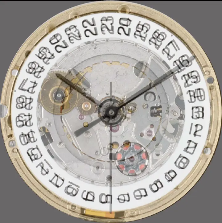

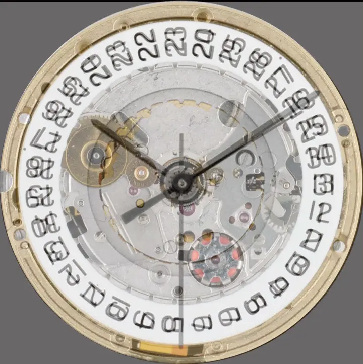

Since Omega's caliber 1400 (ETA 205.111) seems to have most of the disadvantages of a quartz movement with few of the advantages, my (dangerously) idle mind has begun to wonder about swapping that movement with a traditional quartz movement. For purposes of discussion, the ETA F06.115 seems like a good candidate. In addition to the items listed below, does anyone see other potential issues am I missing?

The technical guides that I've found for the 205.111 don't specify the date indicator position, so I can't confirm that it's compatible with the F06.115. But overlaying photographs of the two movements—F06.115 at reduced opacity on top—suggests that they're really quite close. The F06.115 has slightly larger numerals, so if the dial cutout for the 205.111 is really tight, it might not work. But I think it looks good enough to try.
