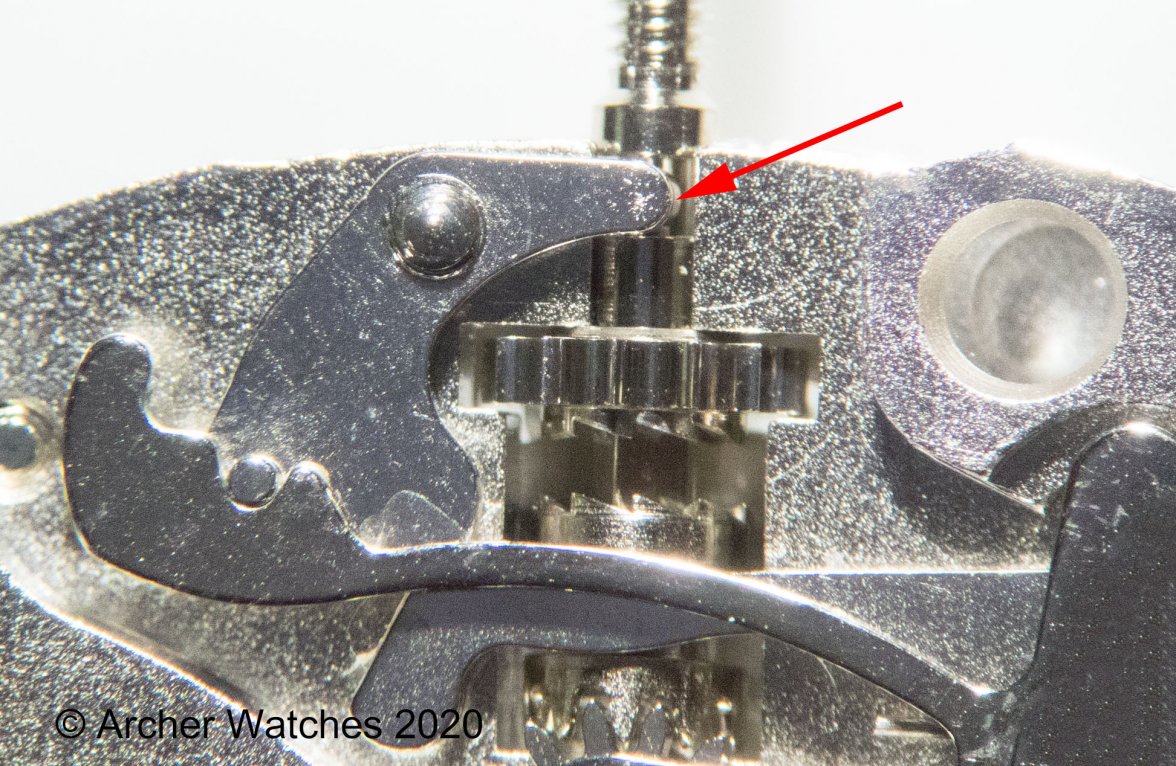

This is a very informative thread, mostly due to Al’s photos and explanations. An additional question, though: is this contact area between the set lever post and the slot in the stem typically lubricated?
Yes, essentially every surface of the stem that enters the movement is lubricated. Omega typically calls for oil (HP 1300), but many people use grease, myself included.

On watches that I service it is. I use a very very thin film of Mobius 9504 applied to the groove in the stem.

Here’s what prompts the question: I have a 105.003, recent full service, new crown and stem. I found an old 105.012 in my stash, doesn’t wind or run, mostly a parts watch. But, it had the correct, earlier flat-foot crown which I wanted to use.
So I brought both watches to a local guy, he pulled the earlier, flat-foot crown and stem and showed it to me: it looked to both of us that it’s showing it’s age (very minor corrosion), but he said it was good enough to use, and, he couldn’t remove the crown from the stem, thinking it was probably frozen. Which he said is not uncommon.
So he made the switch, and the old crown/stem combo winds, fits, and sets well in the 105.003. But…I can swear it is much more difficult to pull to the setting position now.
So I started to review the photos in this thread, and re-read what could provide resistance to moving from the wind to set position. And if the stem/crown was the only thing changed, than other than a gummy crown gasket, my layperson assessment tells me the only other spot that would now change and increase the resistance would be where the set lever post interfaces with the stem. I thought maybe it could use some lubricant there.
On the other hand: the point of contact/surface area of these to parts seems very small, thereby making me question whether a little surface corrosion here could really increase the resistance I’m feeling.
Bottom line: hopelessly stumped…
