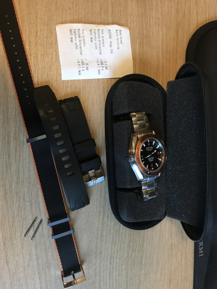

An update for anyone that cares. I picked up my watch today. They managed to remove the spring bars without marking the already scratches up lugs and without ruining the end links. I think like Archer suggested as it looks like the ends were gently removed. They are shiny so would suggest a diamond file?
Whoever butchered it before did in fact use the smaller bars which are correct (068ST2207). I measure the inner part and compared it to known good 2207 and 2208 I have.
I quickly fitted the NATO I have and the rubber with ease. I have a deployant and orange stitched rubber strap on its way.
They also did a 10 bar dry pressure test and put the watch in a little carry case. Couldn’t recommend them enough. Bond Street Watchmaking just outside Luton, Bedfordshire if anyone UK based is interested. Ex Patek guy and does Franck Muller etc. Omega and Rolex certified.

Glad you got it fixed. I saved the store details in my Favourites in case I may need them in the future.
