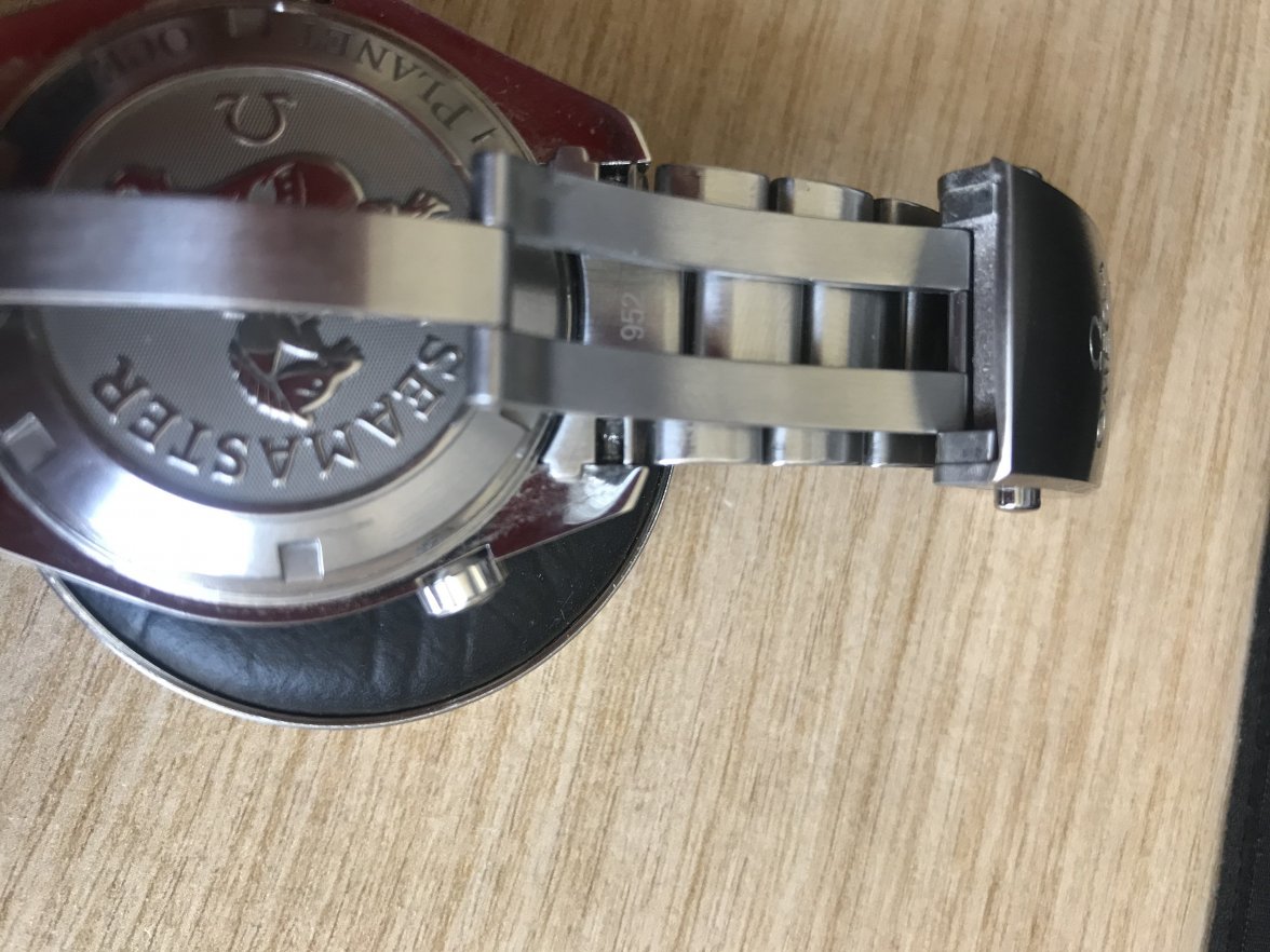

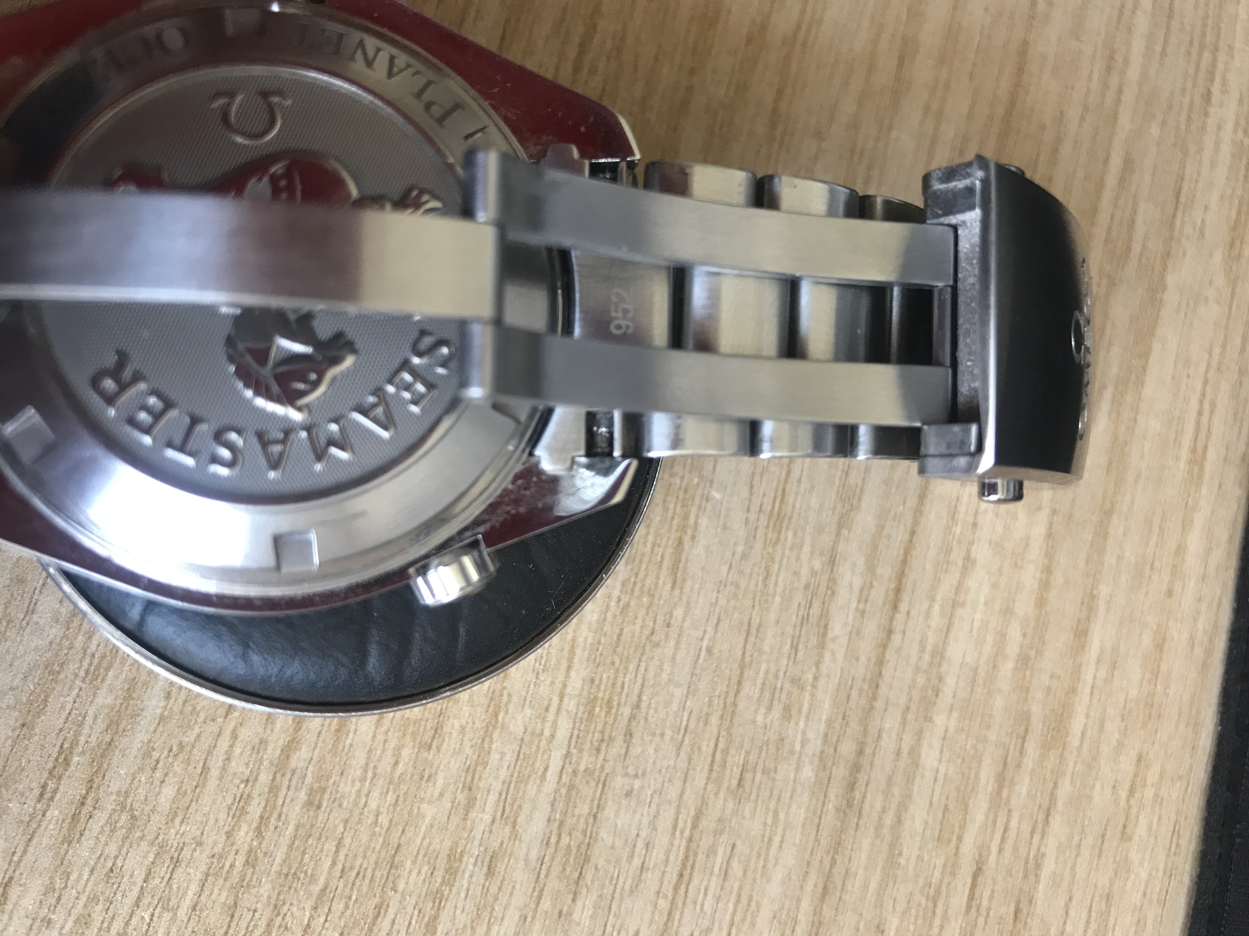

I have a 42mm 2500C PO. I bought it a couple of months ago after my last one was stolen in a burglary.
The spring bars have been mauled by somebody previously. So only one side of the spring bar compresses (the same on both spring bars) and because of the nice chunky endlinks I can't do a lot to remove them with the Omega tool that came with my speedy or my bergeon 6767F.
Any other suggestions before I take it to STS? The endlinks move around a bit where as my last one they were flush against the body and rigid so I would guess the wrong spring bar was used.
I cant get a very clear picture. I have spare original Omega bars ready to go in, but at this rate it will be a case of buying two more 952 end links and cutting through the end link with a small hack saw to remove it or to the Omega service centre as stated above. Both costly options no doubt for something that should be so trivial. The speedy has never caused me issues nor any of my other watches.
Any links to tools I could try from cousinsuk or similar?
Thanks in advance all.

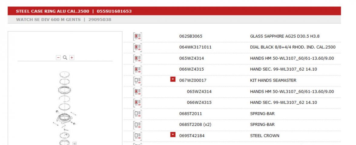

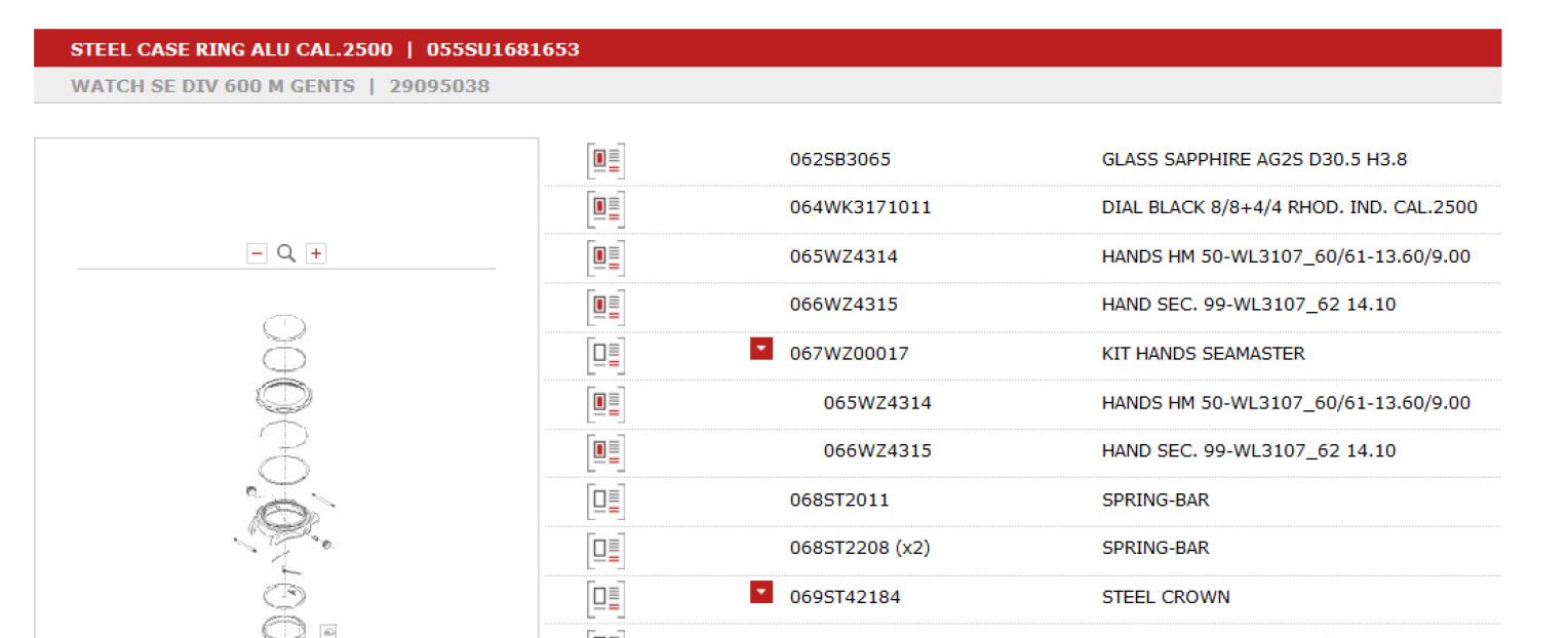

Oddly the Omega spec sheet says that 068ST2208 is the correct spring bar for this rather than the 068ST2207. They recommend 068ST2011 for a strap looking at the document.
