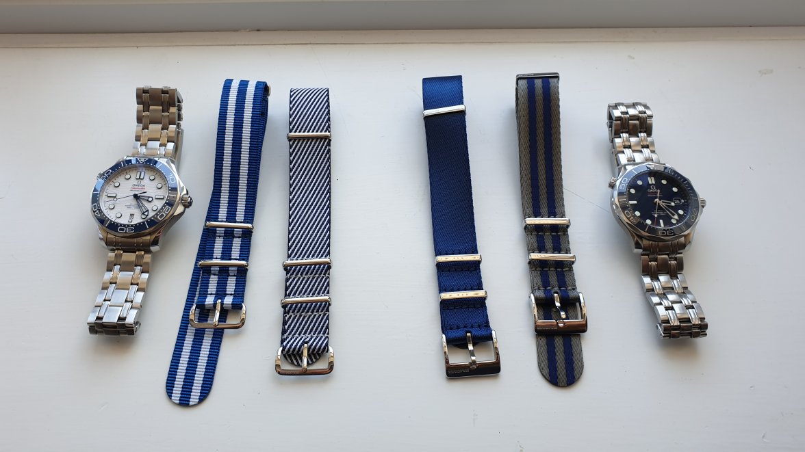

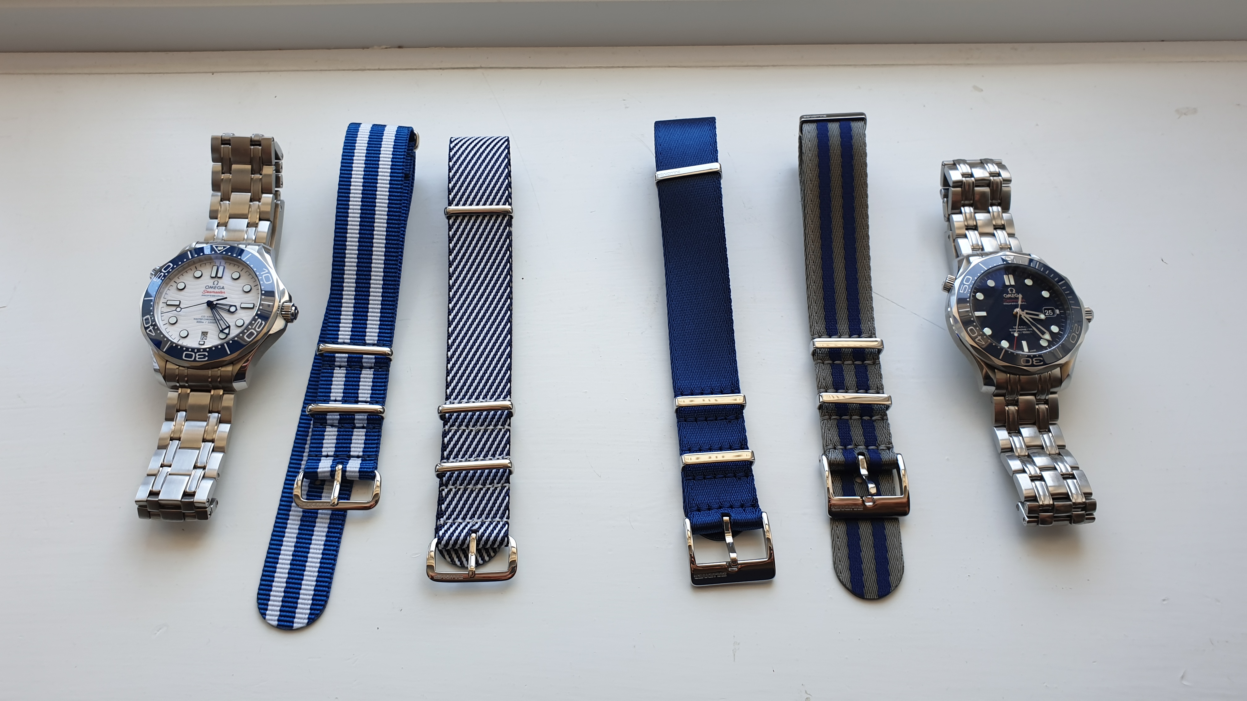

I am getting into NATO straps so this first time and i don't have any tools
Can someone please recommend decent quality one?
