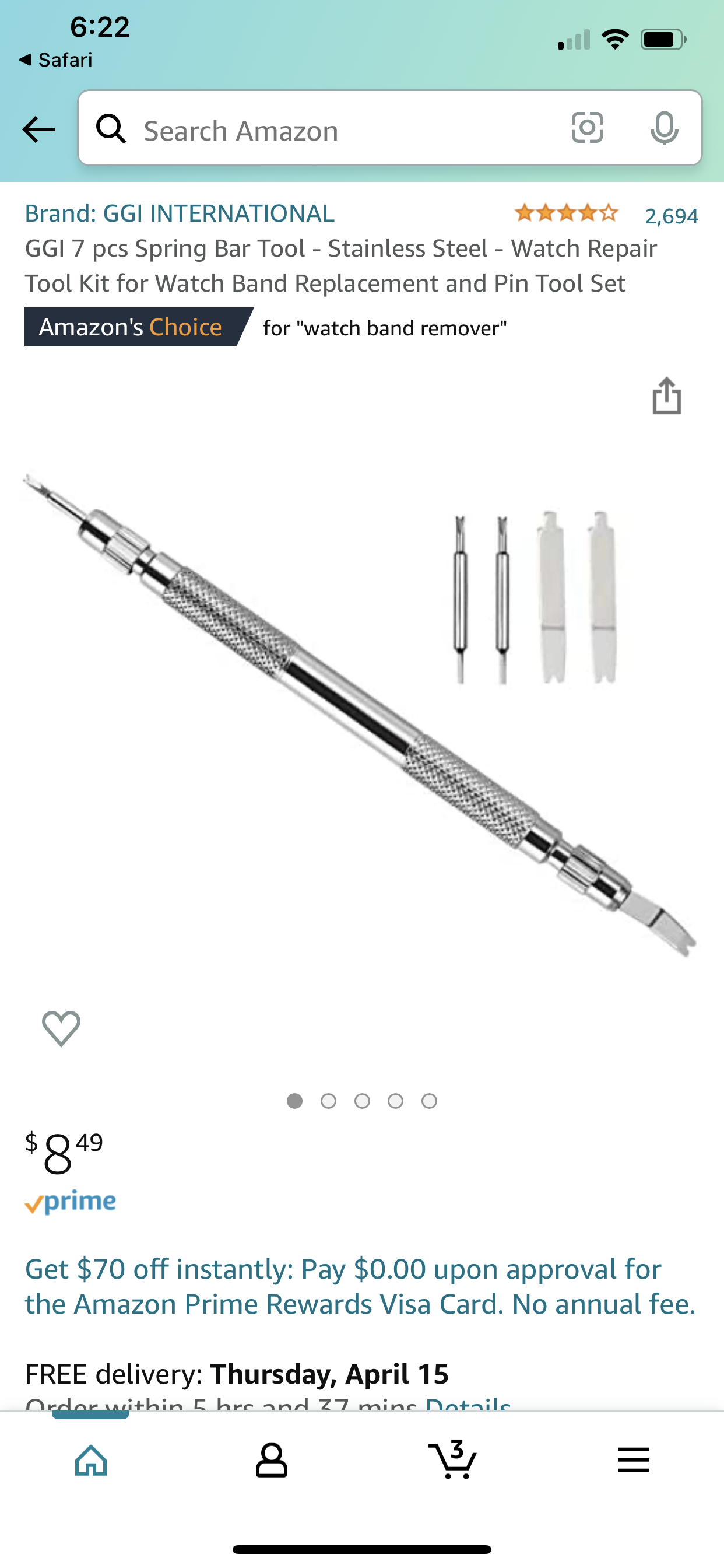

Hey guys,
I recently bought this spring bar from Amazon and haven’t used it yet because I wanted to get everyone’s opinion here first. It’s a cheapo tool that seems to be a replica of a higher end Bergeon and I intended to use it for my new Planet Ocean. Admittedly, I didn’t do my research before I bought it and likely would have sprung for the Bergeon if I had known better. I’ve read that the fork tips can bend after some use which I’m not really worried about. I’m more worried if this tool will cause damage to the case in any way, above and beyond scratches that usually come with strap changes. I’m fine with surface scratches.
I know that I’ll be careful when using this. Do I need to worry that this tool will mess up the watch case in any way or will it suffice for occasional strap and bracelet swaps? Anyone else use a cheapo Bergeon imitation spring bar tool and if so has it caused any issues to your watches?
Appreciate any feedback

That should work just fine. Might not last as long as a Bergeon, but shouldn't cause any damage by itself.

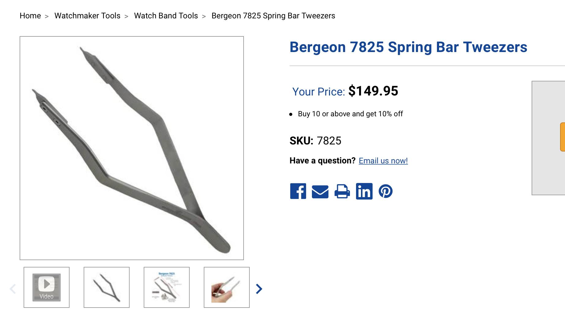

I also have the Bergeron version that looks similar. It is excellent.

The fake Bergeons have a habit of snapping the tips and rusting but beyond that they’ll do the job for a while

Are you removing/installing straps, or a bracelet? If it's just straps, then it shouldn't be an issue. Any damage will be more related to your skill and dexterity than the tool.
Removing some modern bracelets can be pretty tricky, however, because the end-links are so precisely manufactured to fit snugly between the lugs.

It would be used only for straps. Like I said, I know the Bergeon tips are strong. The main concern here was any damage that an imitation tool could do to the watch case itself. Seems not if used properly

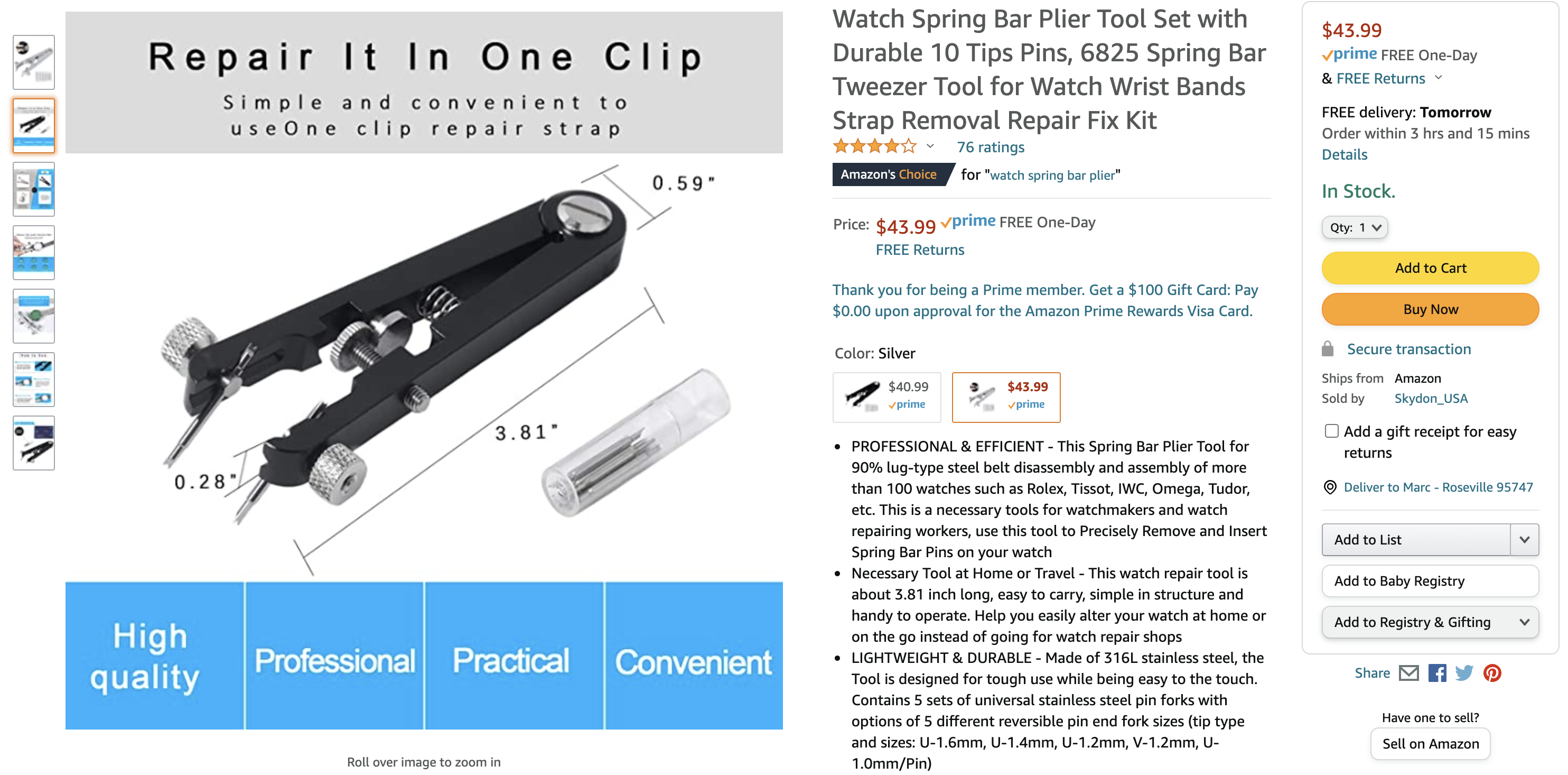

I've been using this one with very good results. Handy that it comes with various diameter tips, and while a bit fussy to set up each use, it works great. (My only note for others about to use this type for the first time, since you can adjust the resting width of the tool, set it to just a bare millimeter wider than where you'll be gripping the spring bars. If you do that, you can slide in, grab them, pinch, and it's almost magical how easily the removal or insertion happens.)
