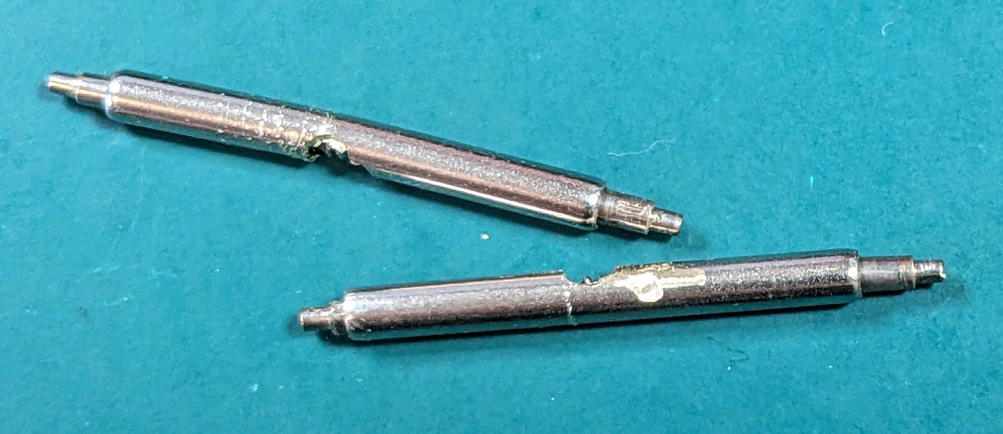

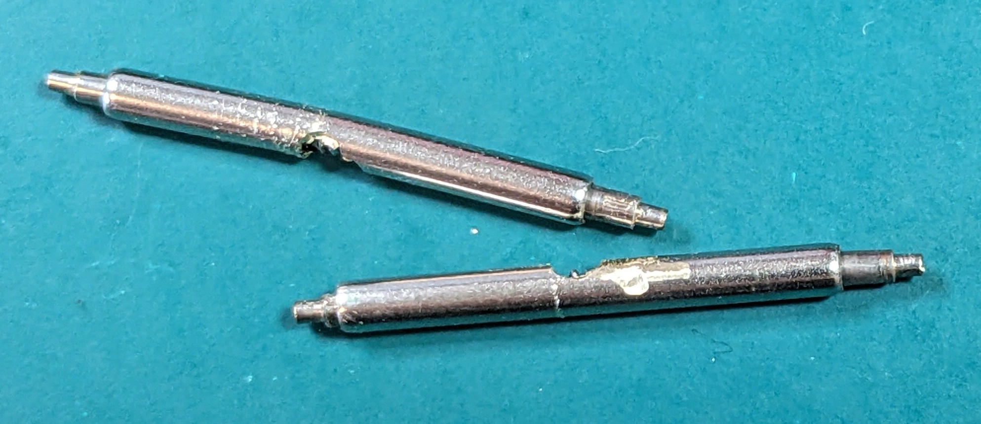

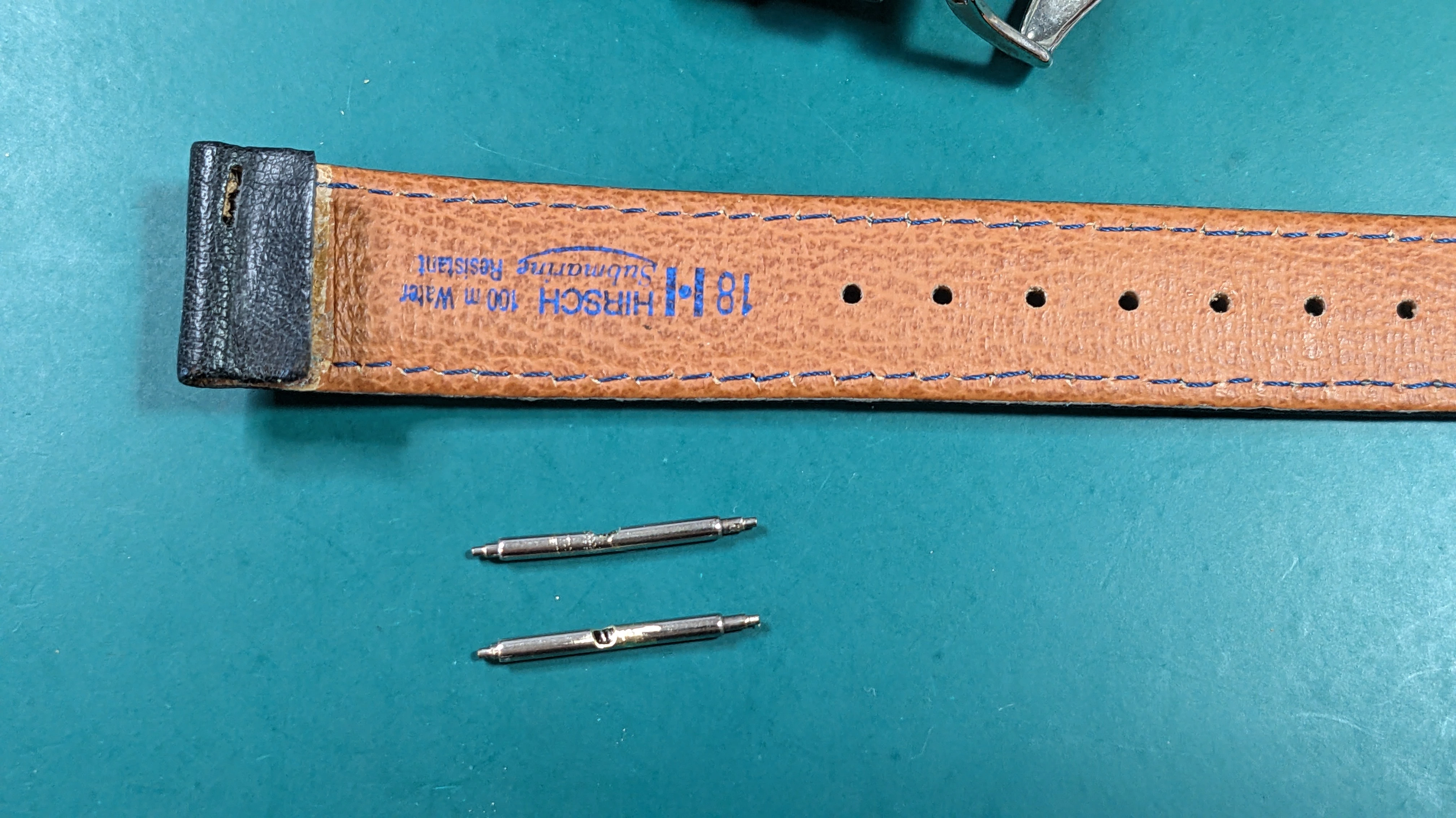

I just bought a vintage Omega and it came with spring bars with no ridges so I was unable to remove them using a spring bar tool no matter how hard I tried. I was able to remove the fold of the strap and will glue it back so that’s not a problem, but I ended up filing the spring bars so that I could remove them. I’m pretty sure these spring bars were intended for lugs with holes on the exterior. Did I make a mistake and for some reason Omega watches came with this kind of spring bar?

I suspect those are not Omega spring bars. Those are, as you suspected, for lugs with holes...

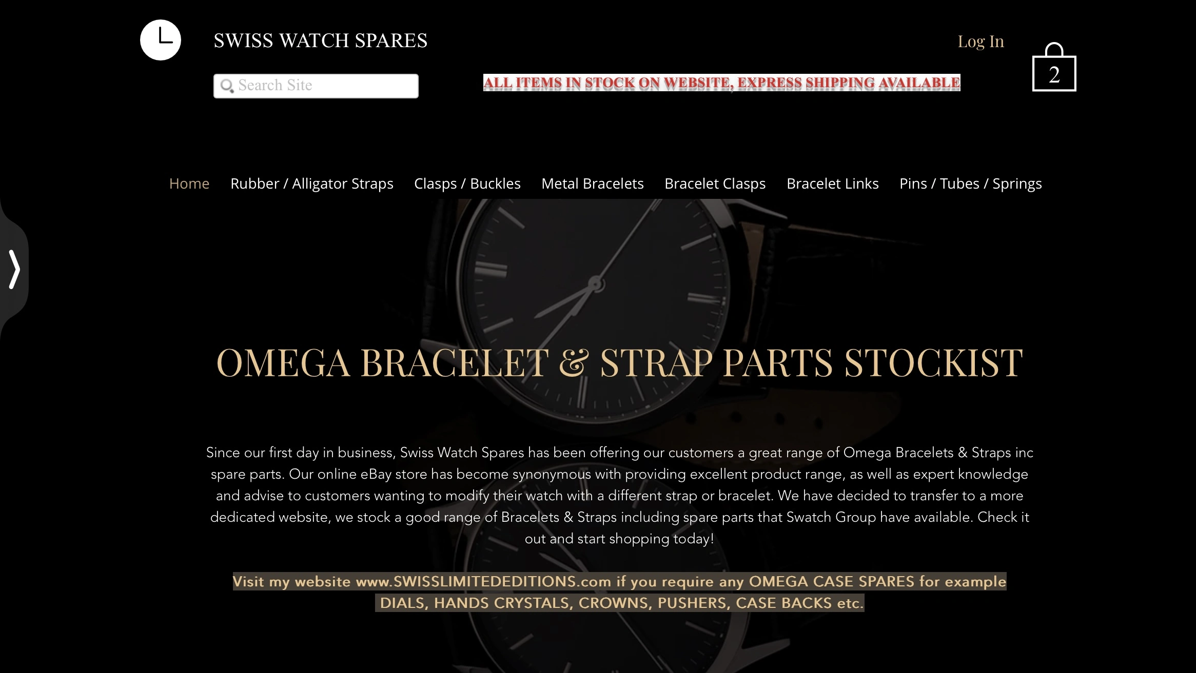

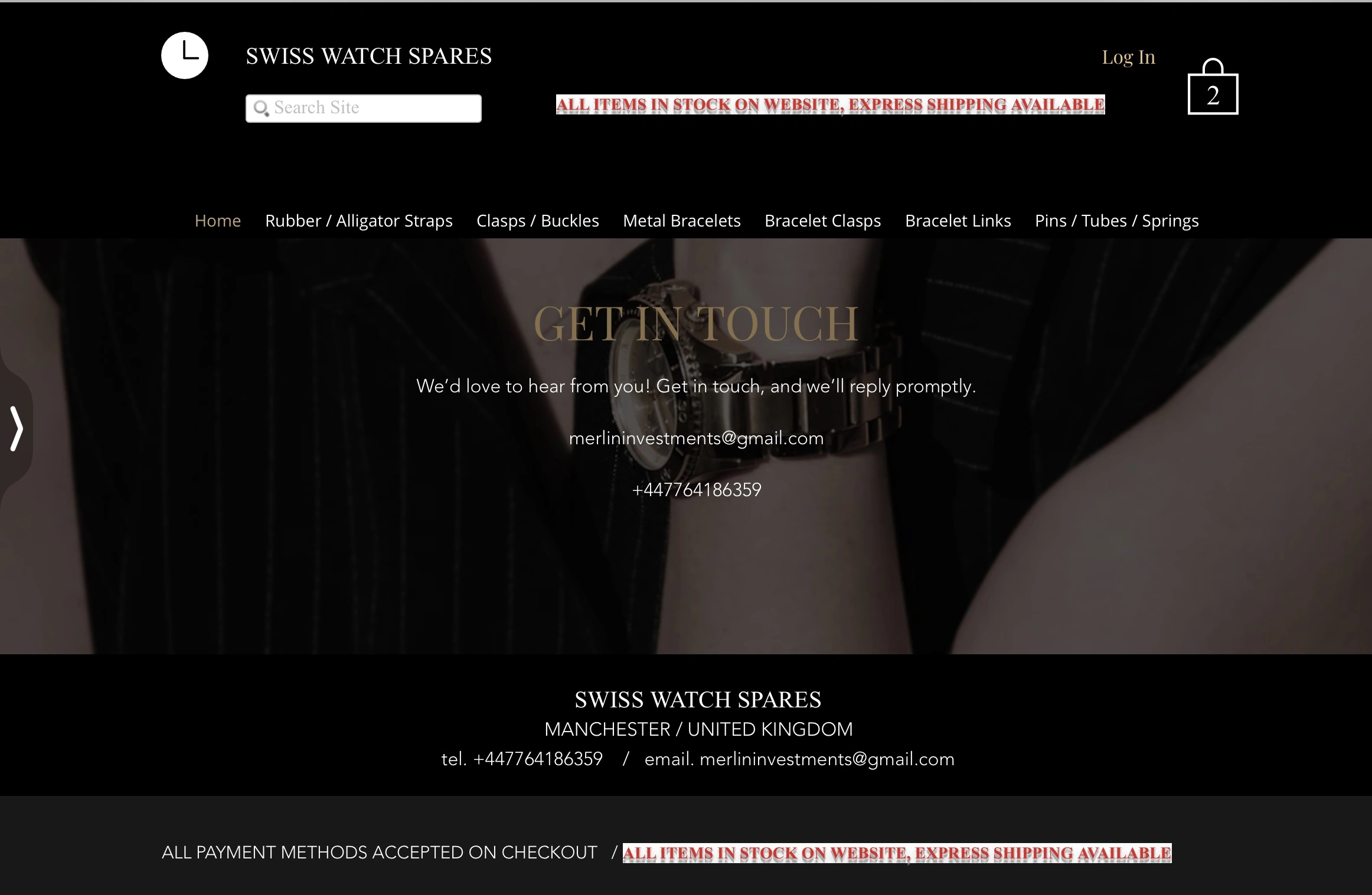

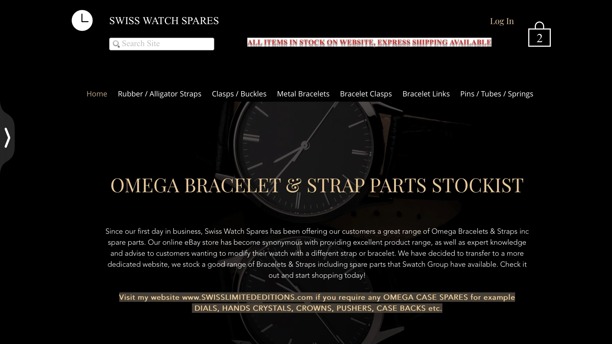

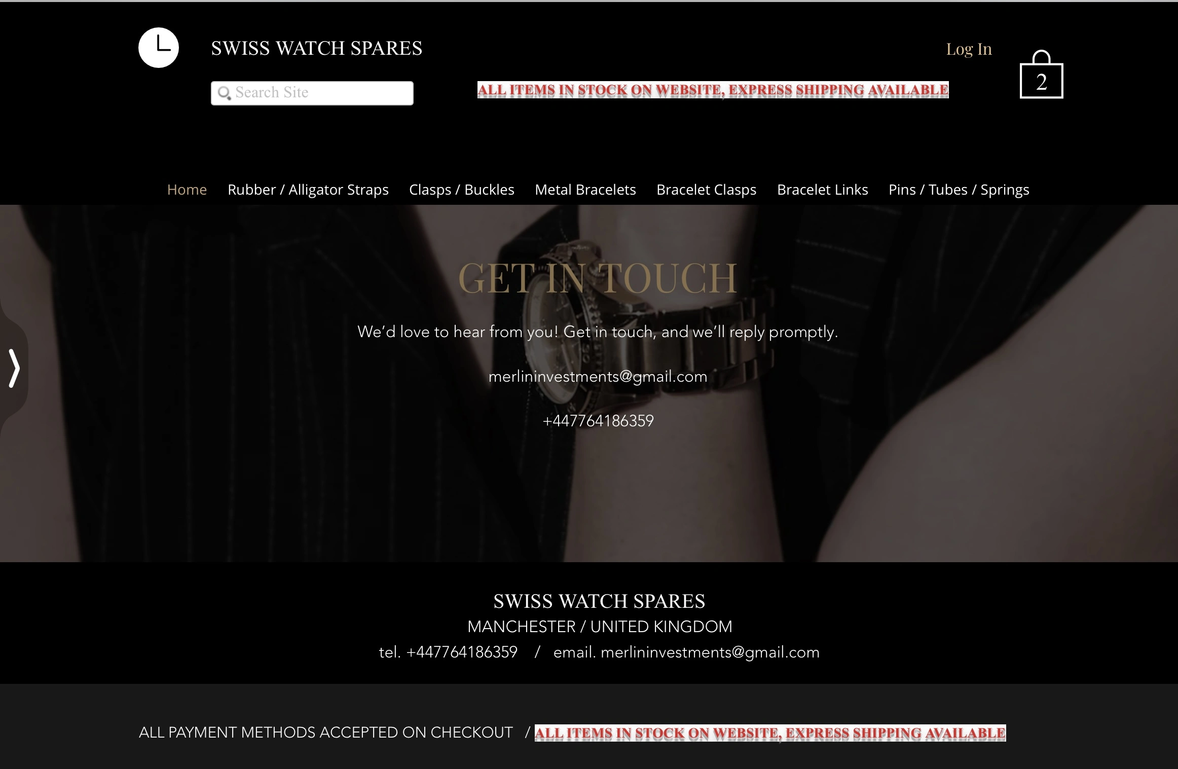

Have you tried John at swisswatchspares.com in the UK? In Manchester actually. He is really helpful and very knowledgeable on his genuine Omega parts. His website and email details below
