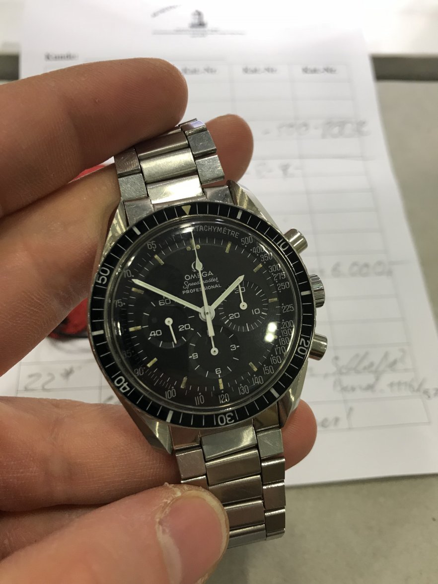

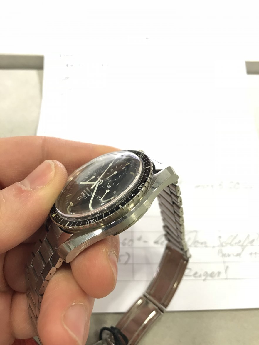

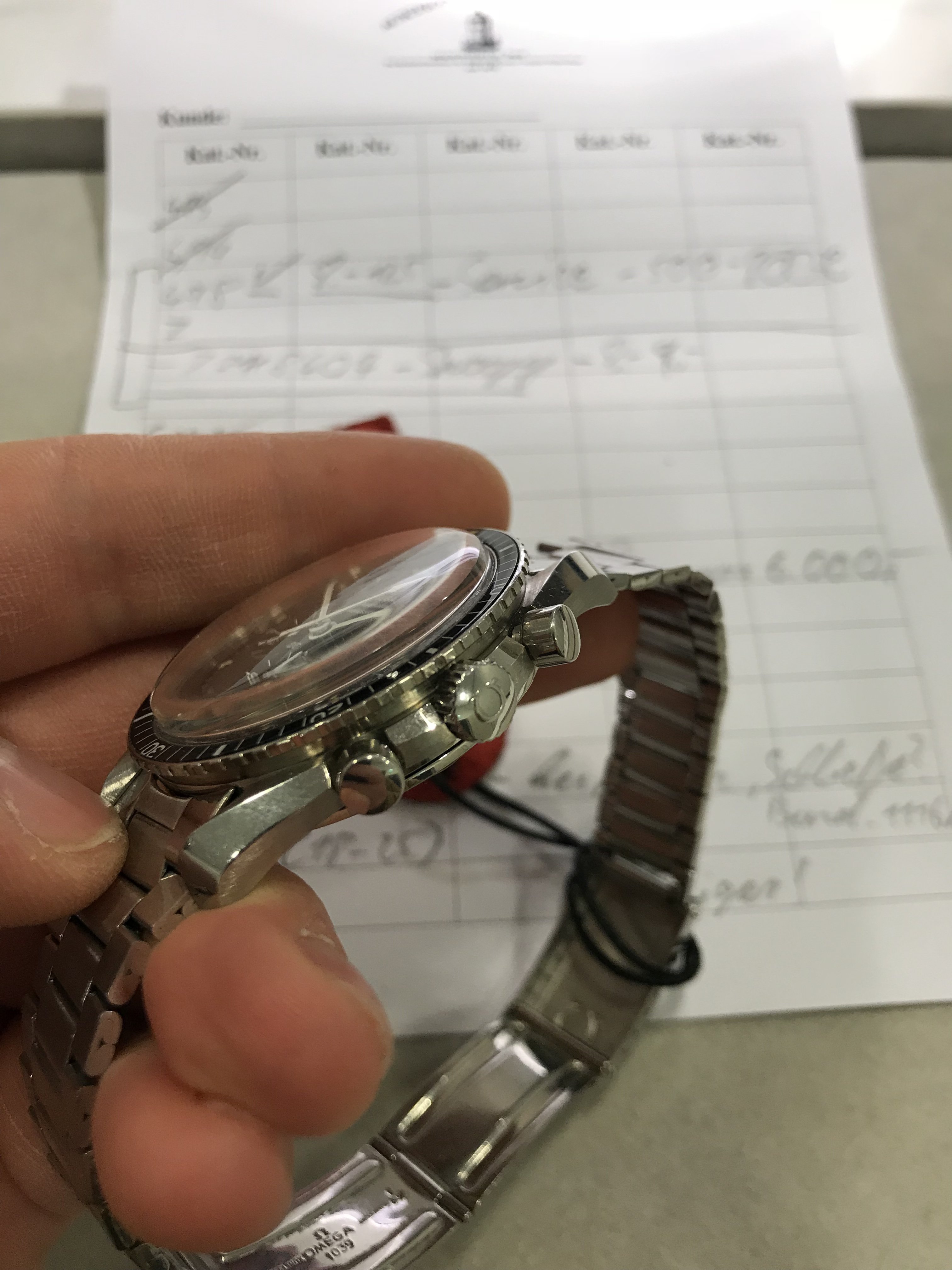

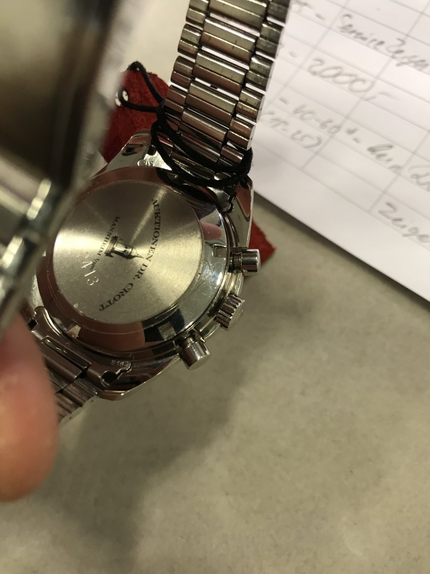

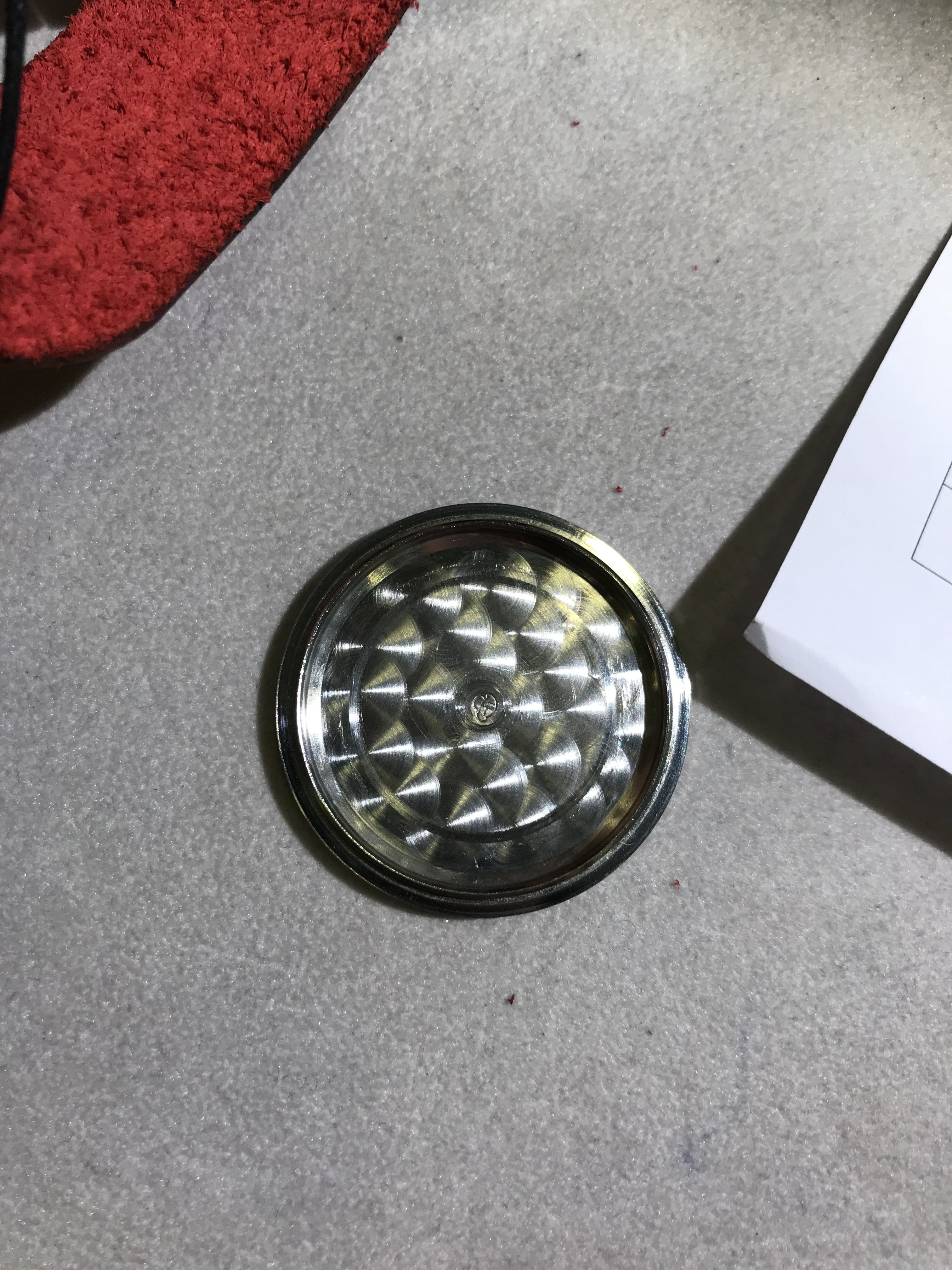

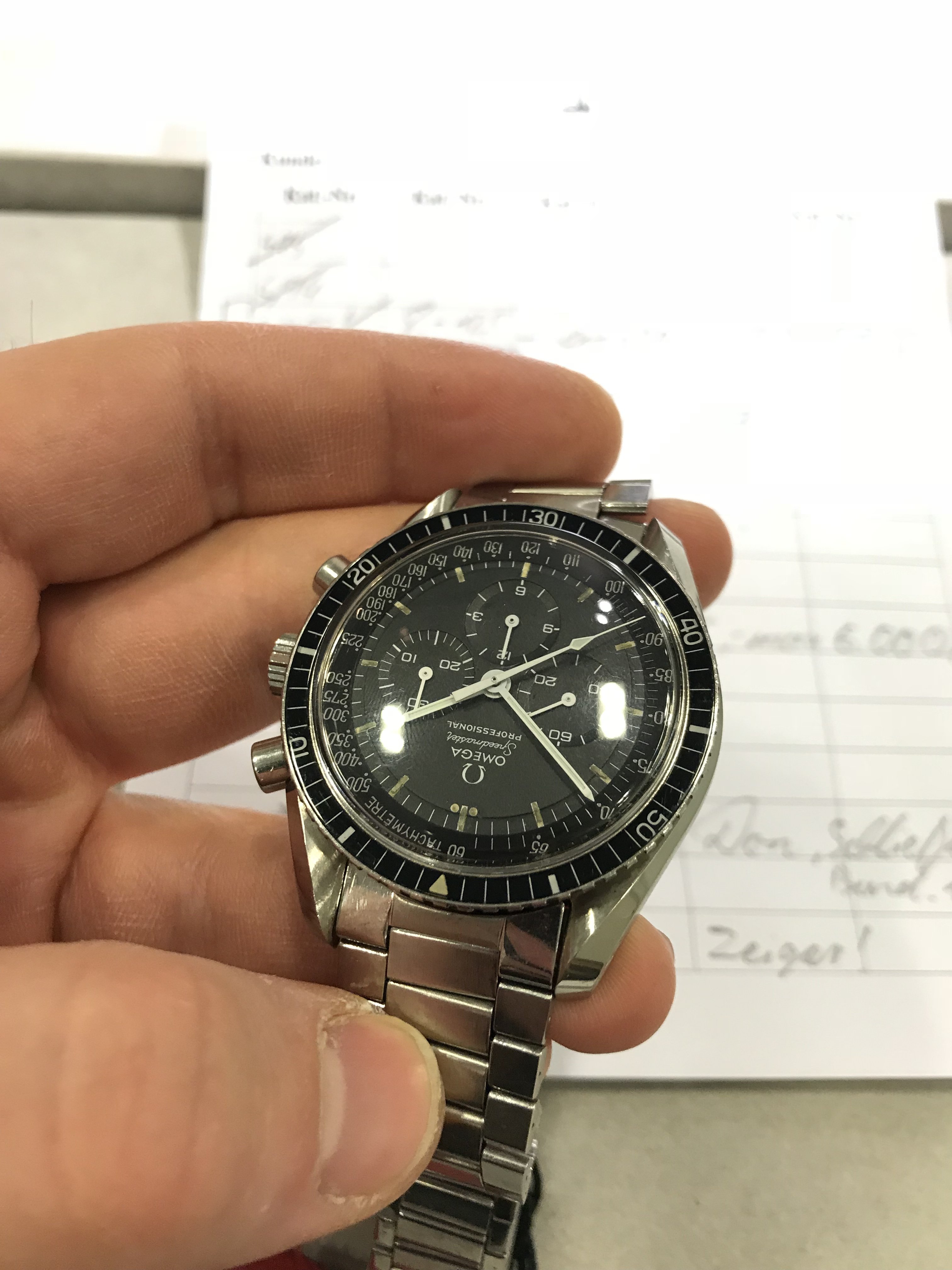

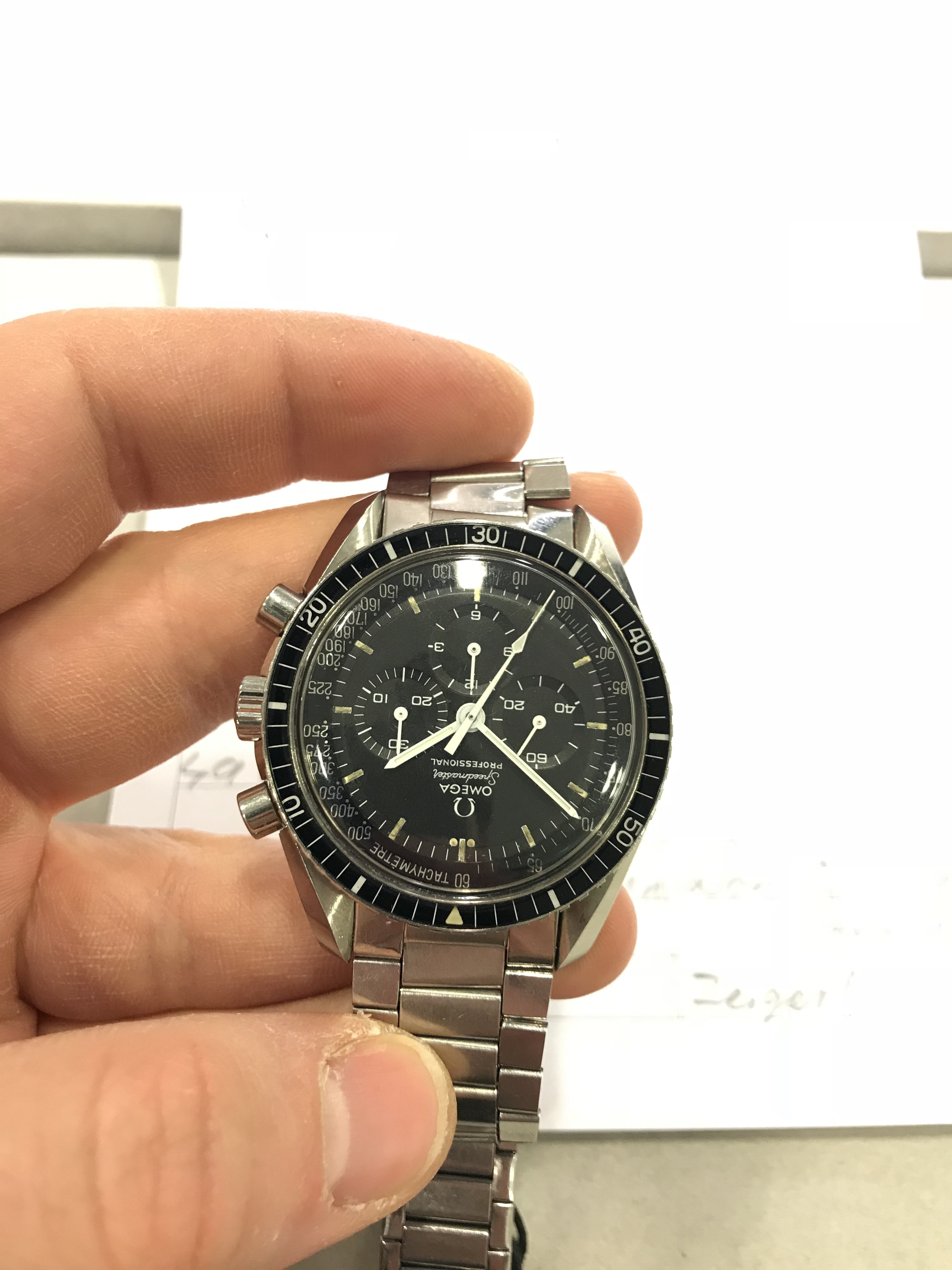

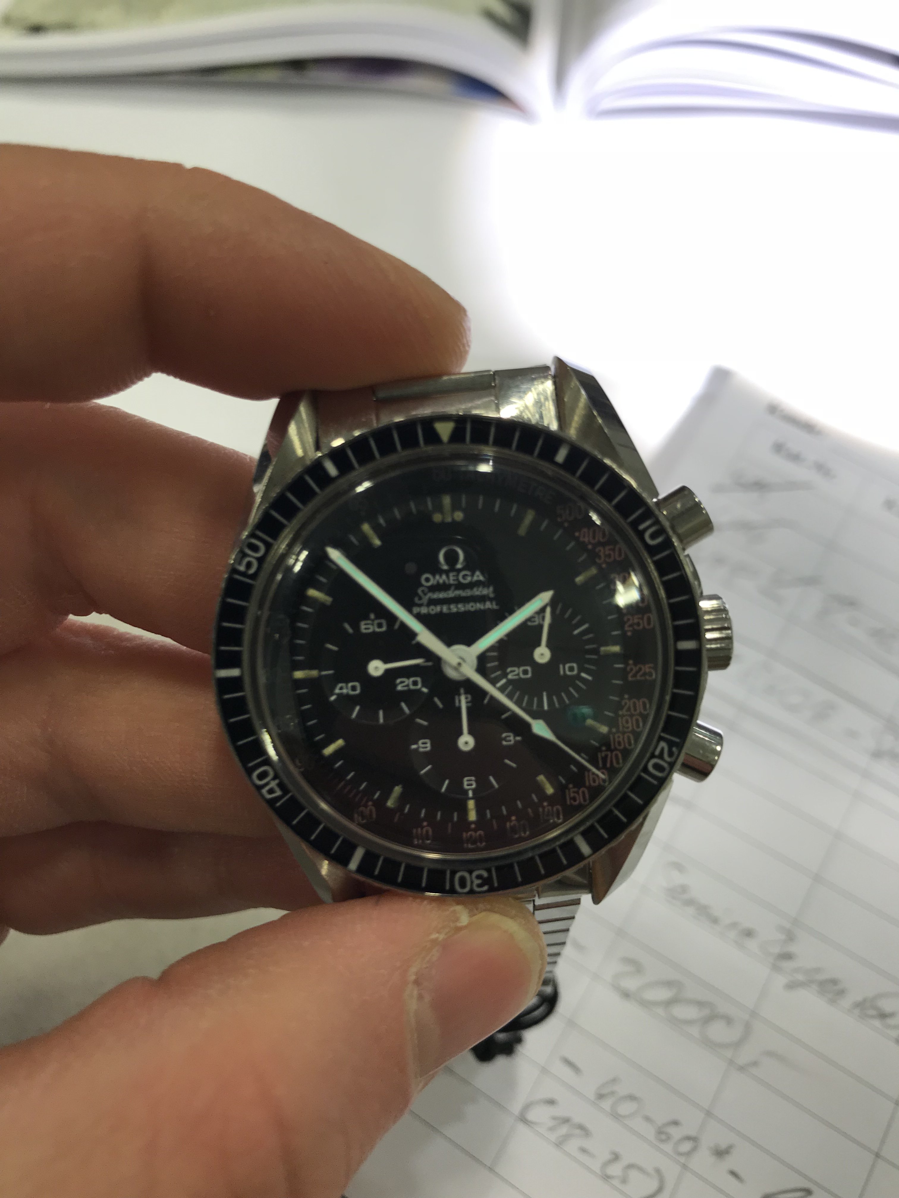

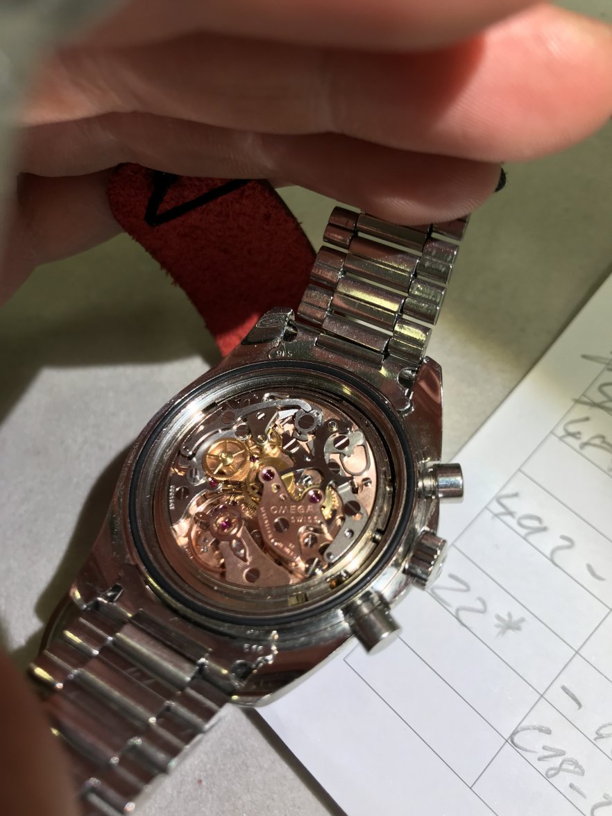

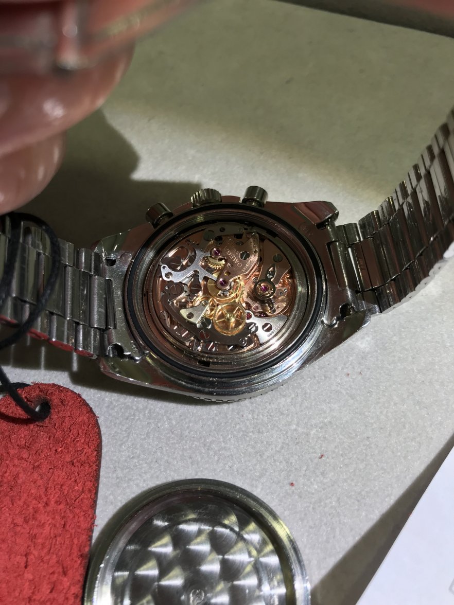

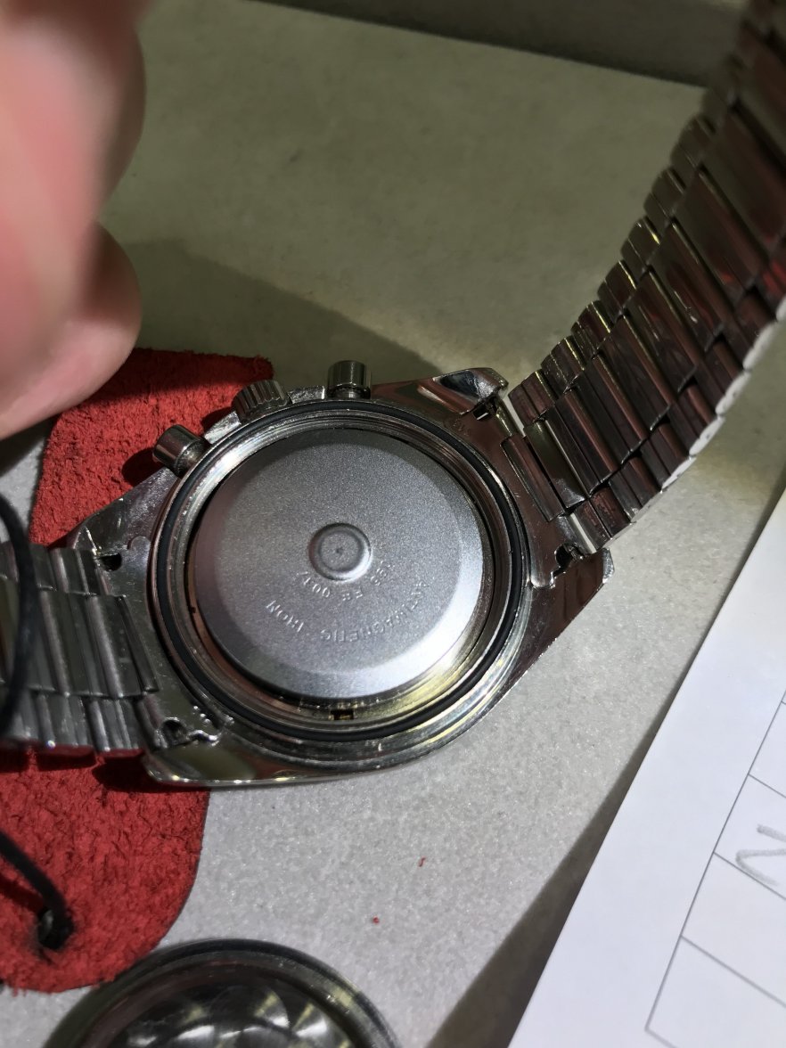

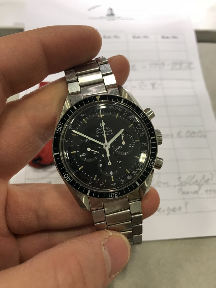

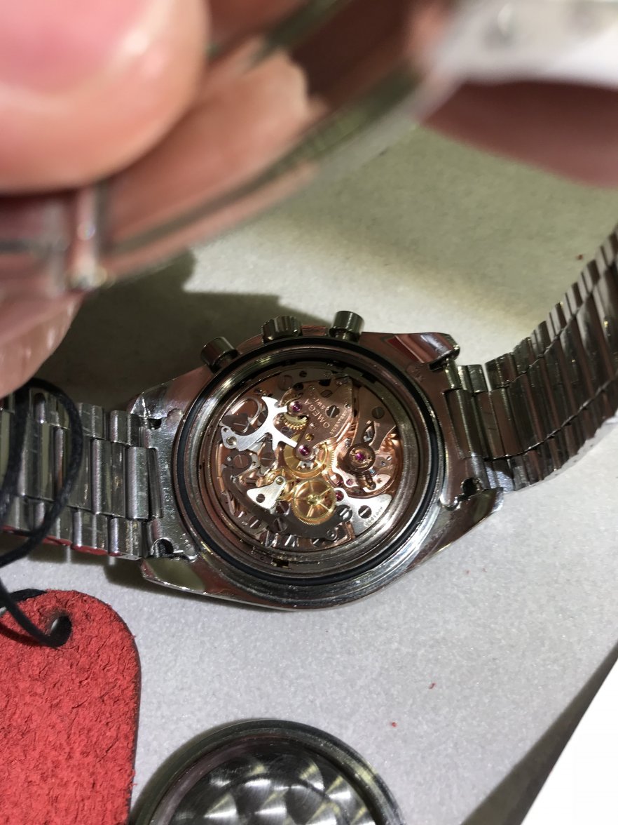

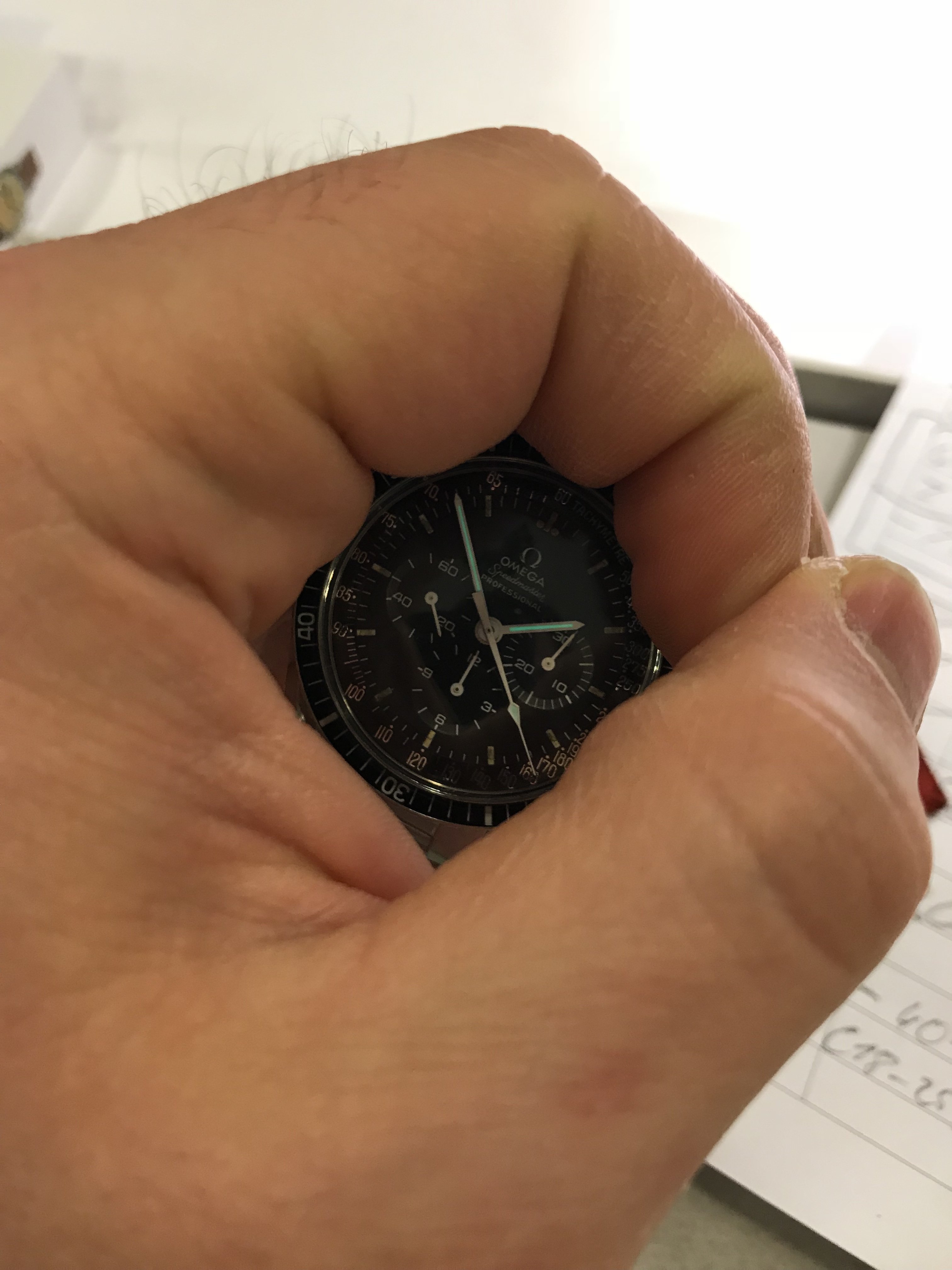

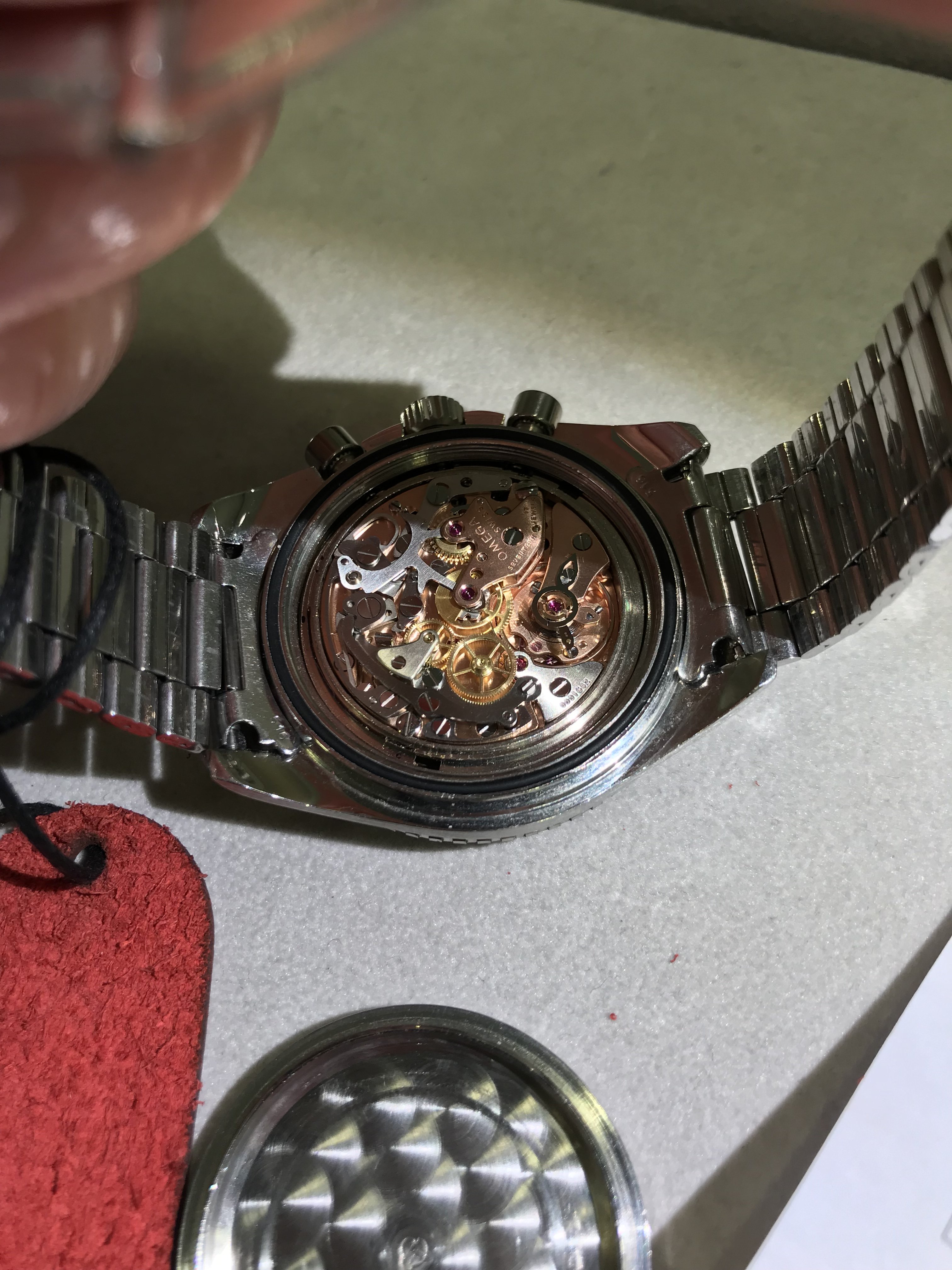

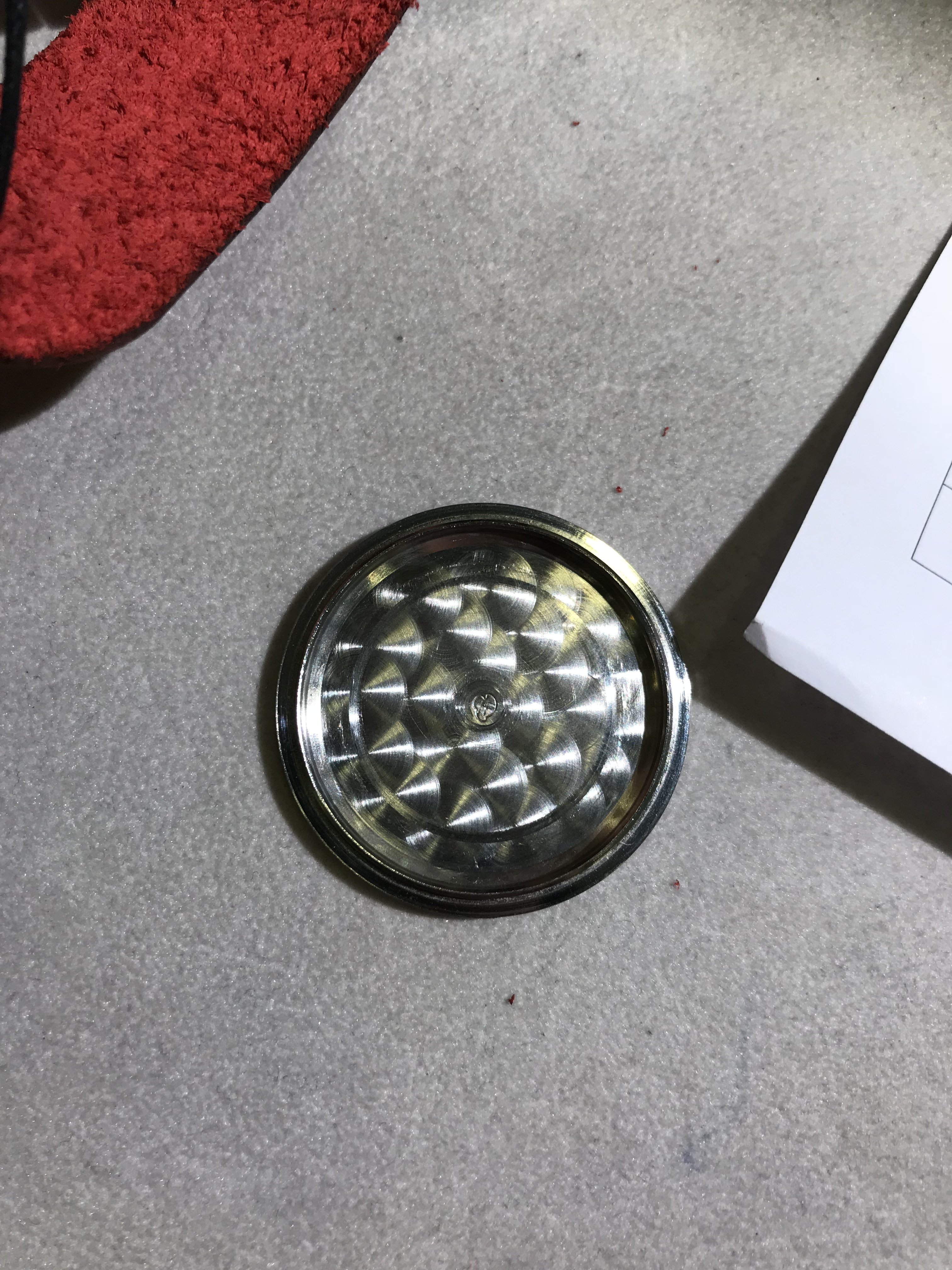

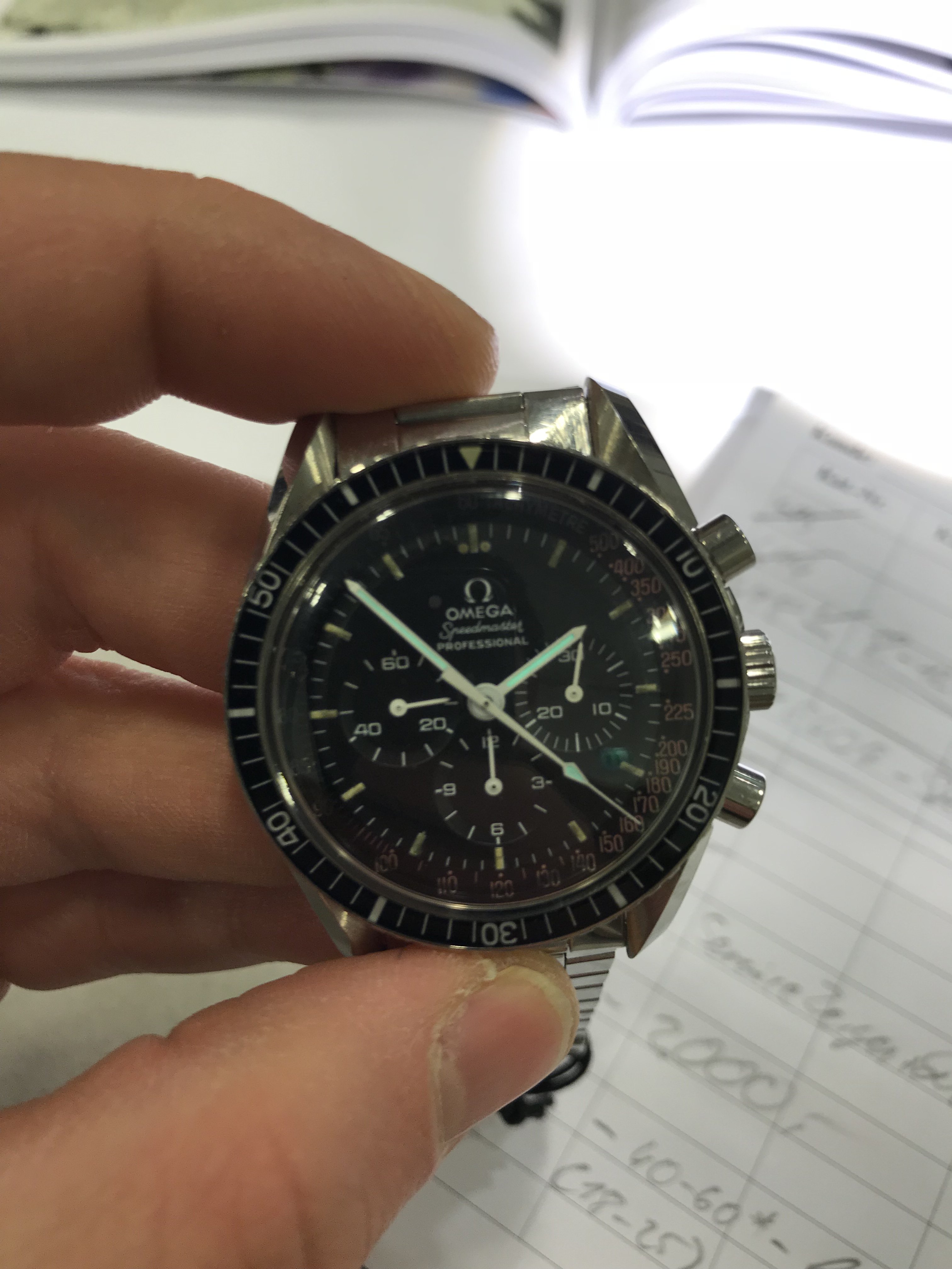

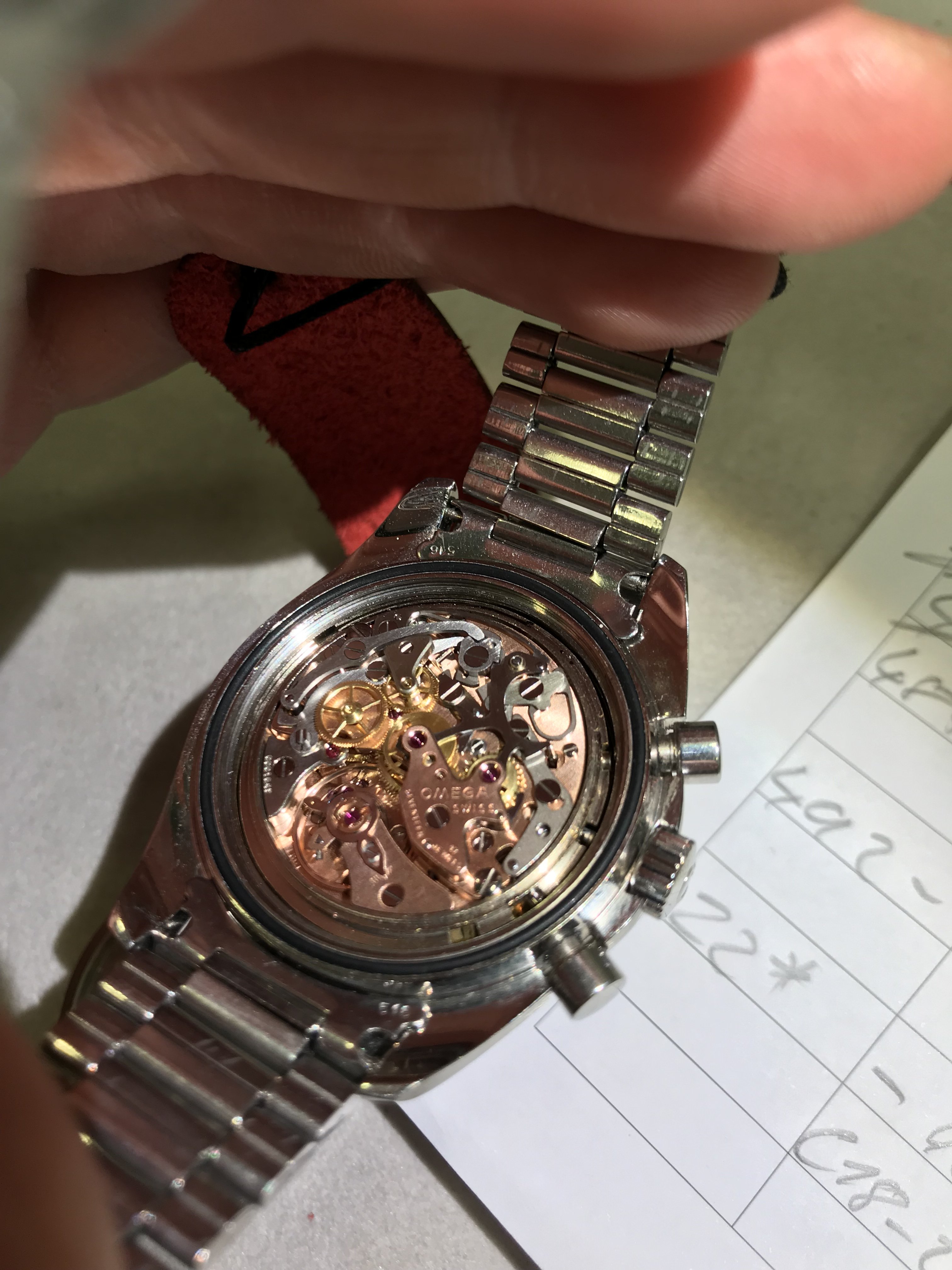

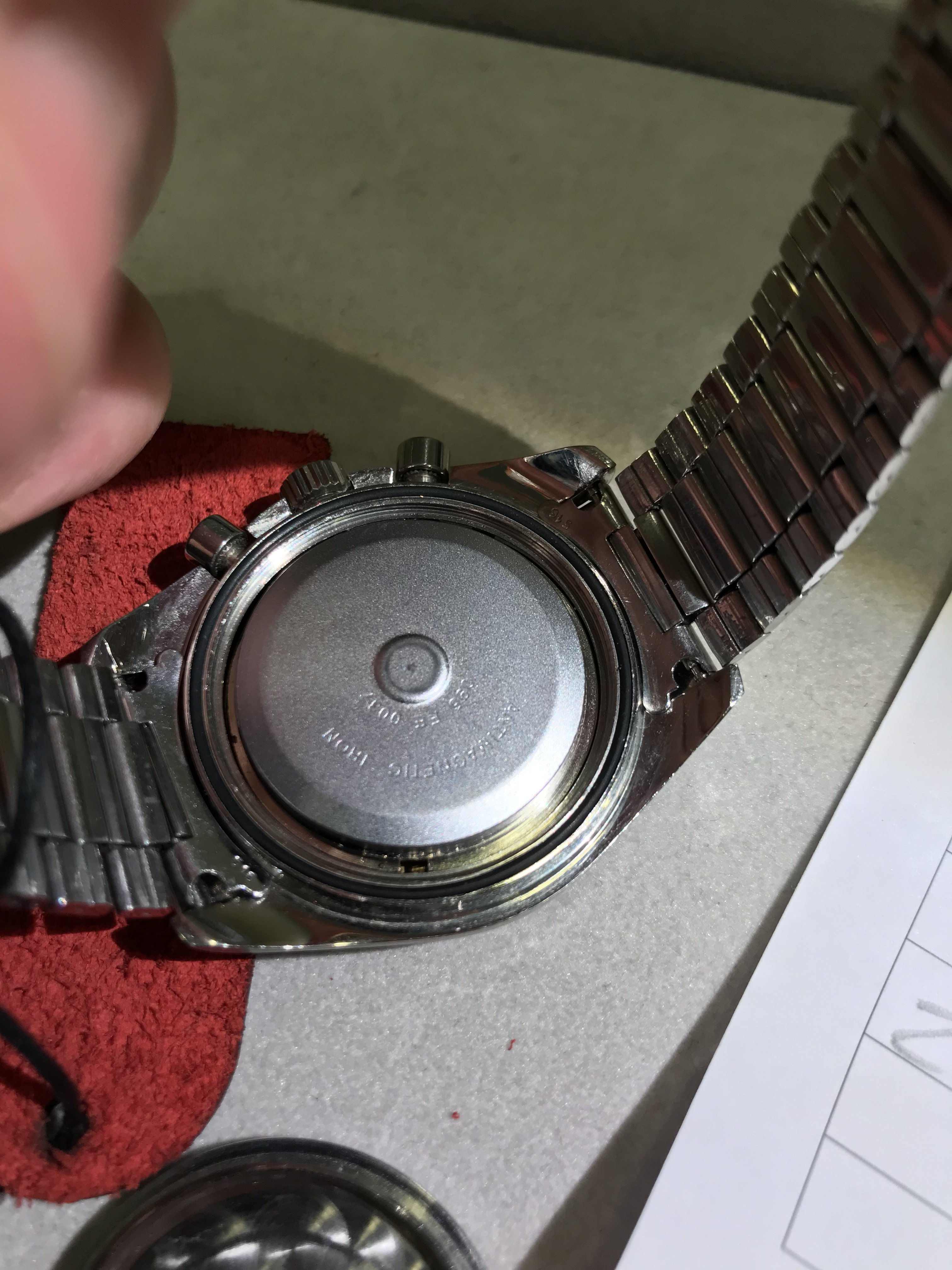

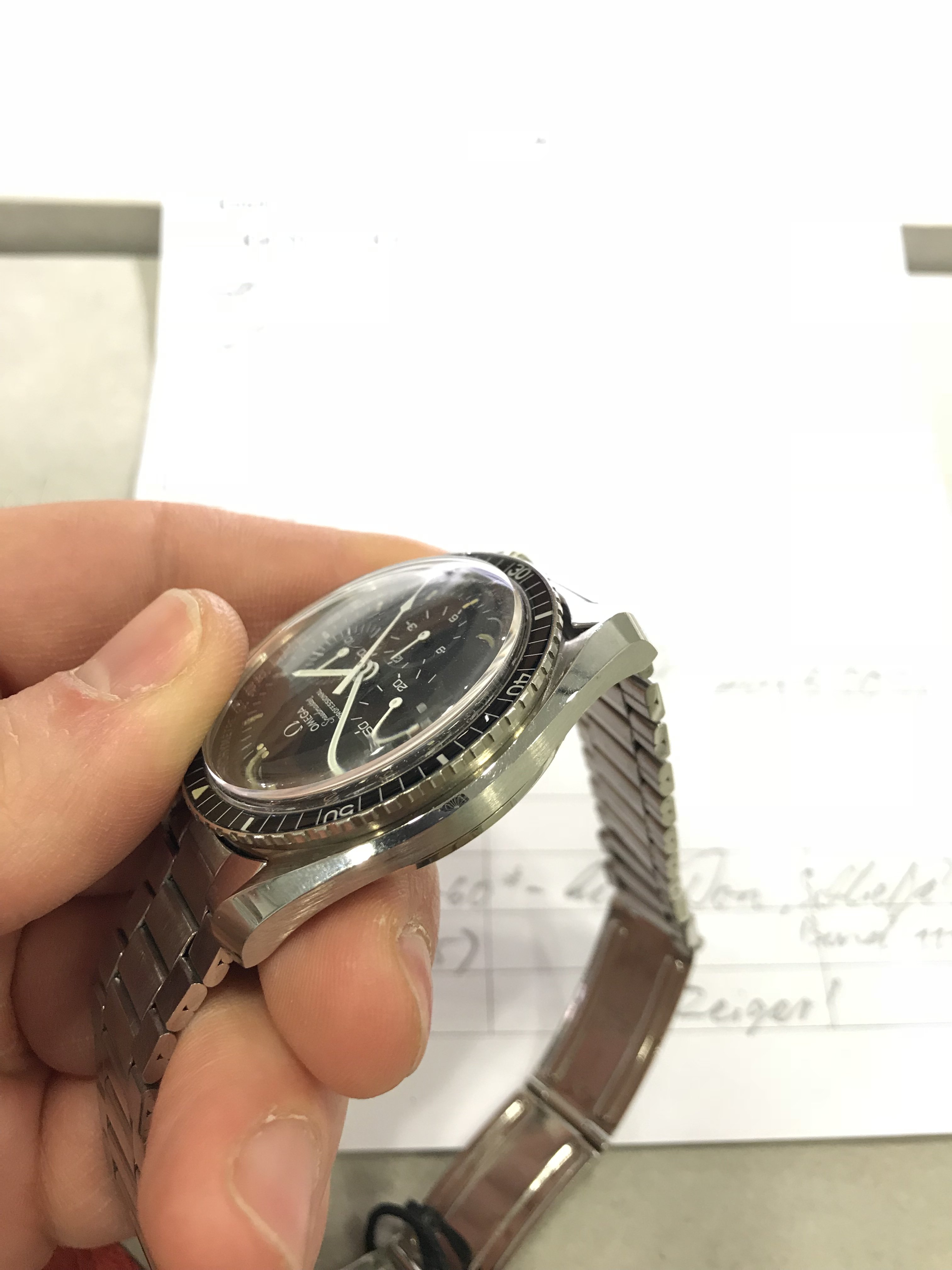

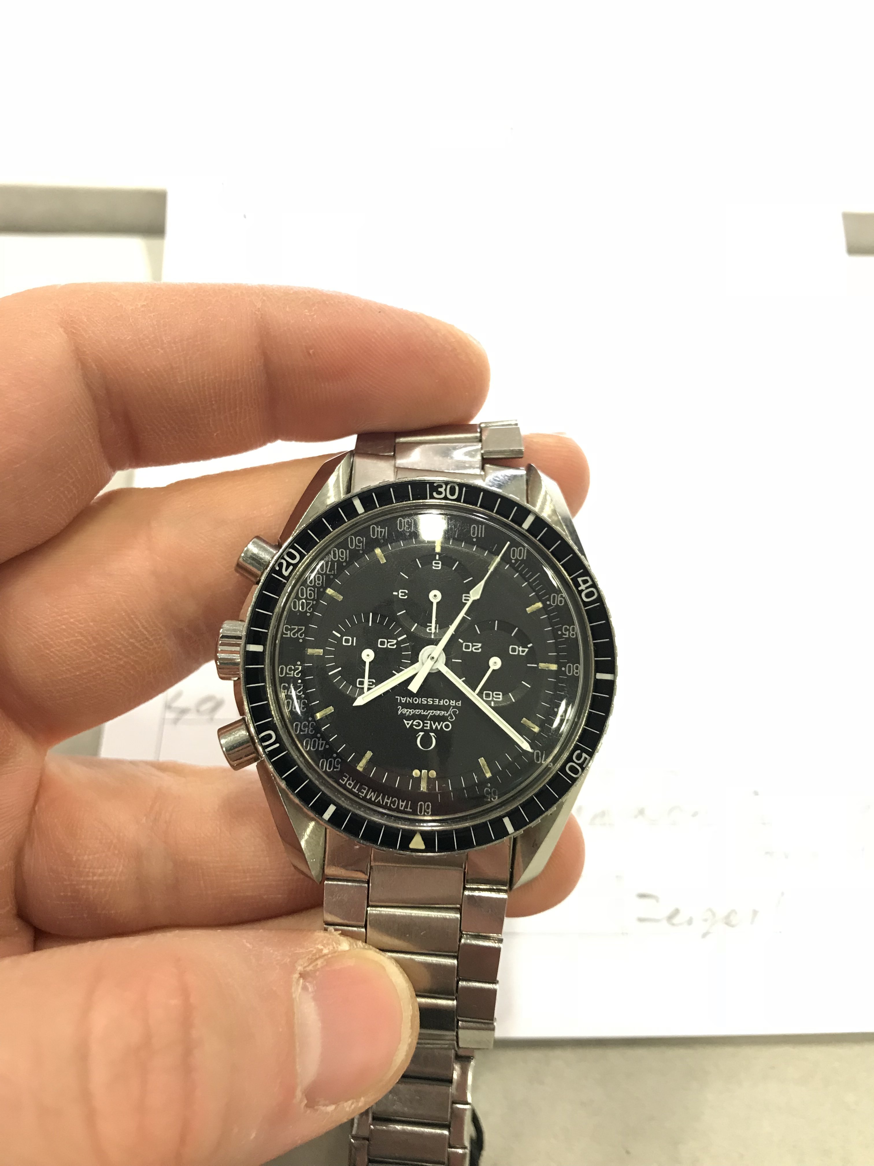

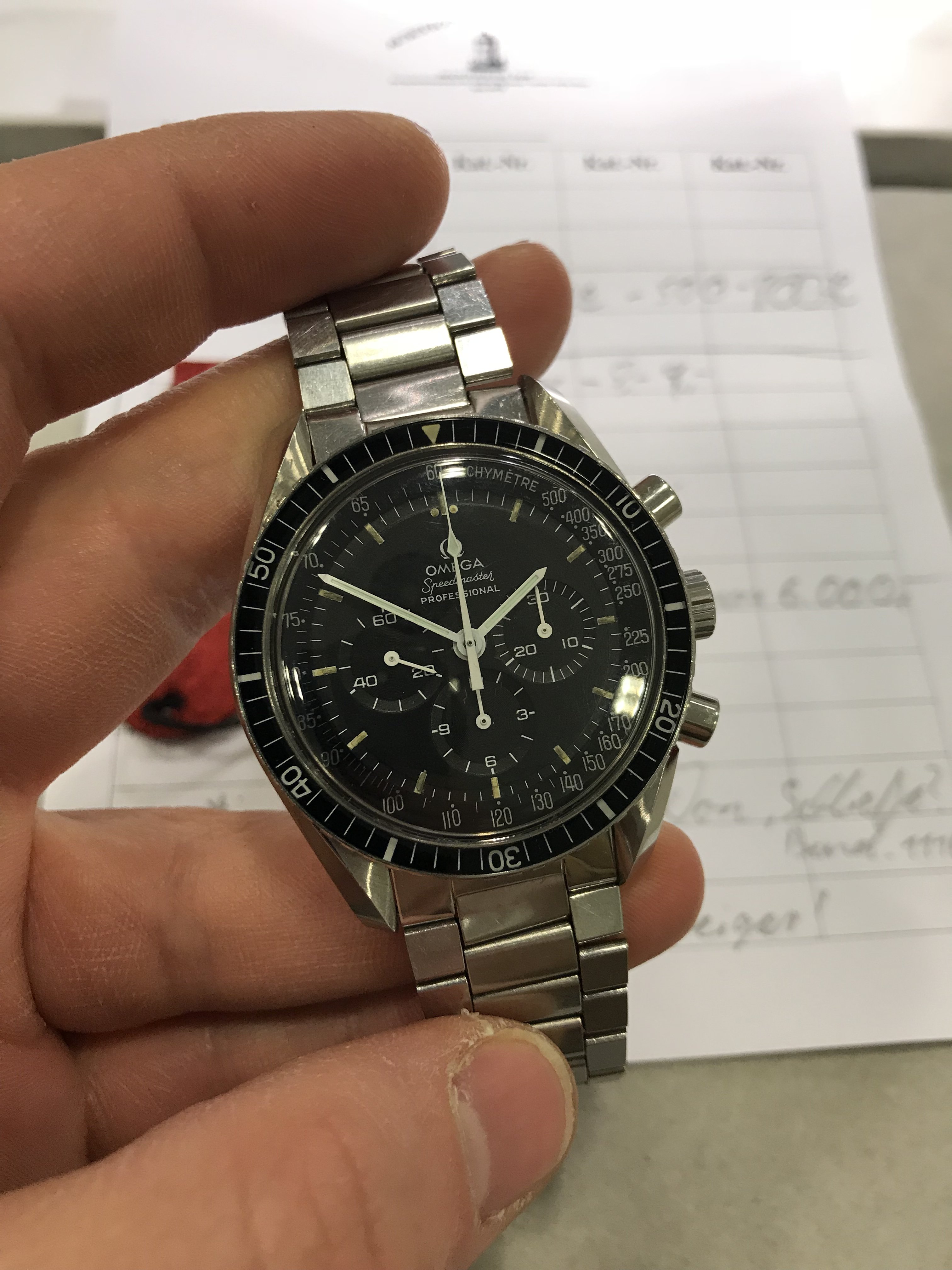

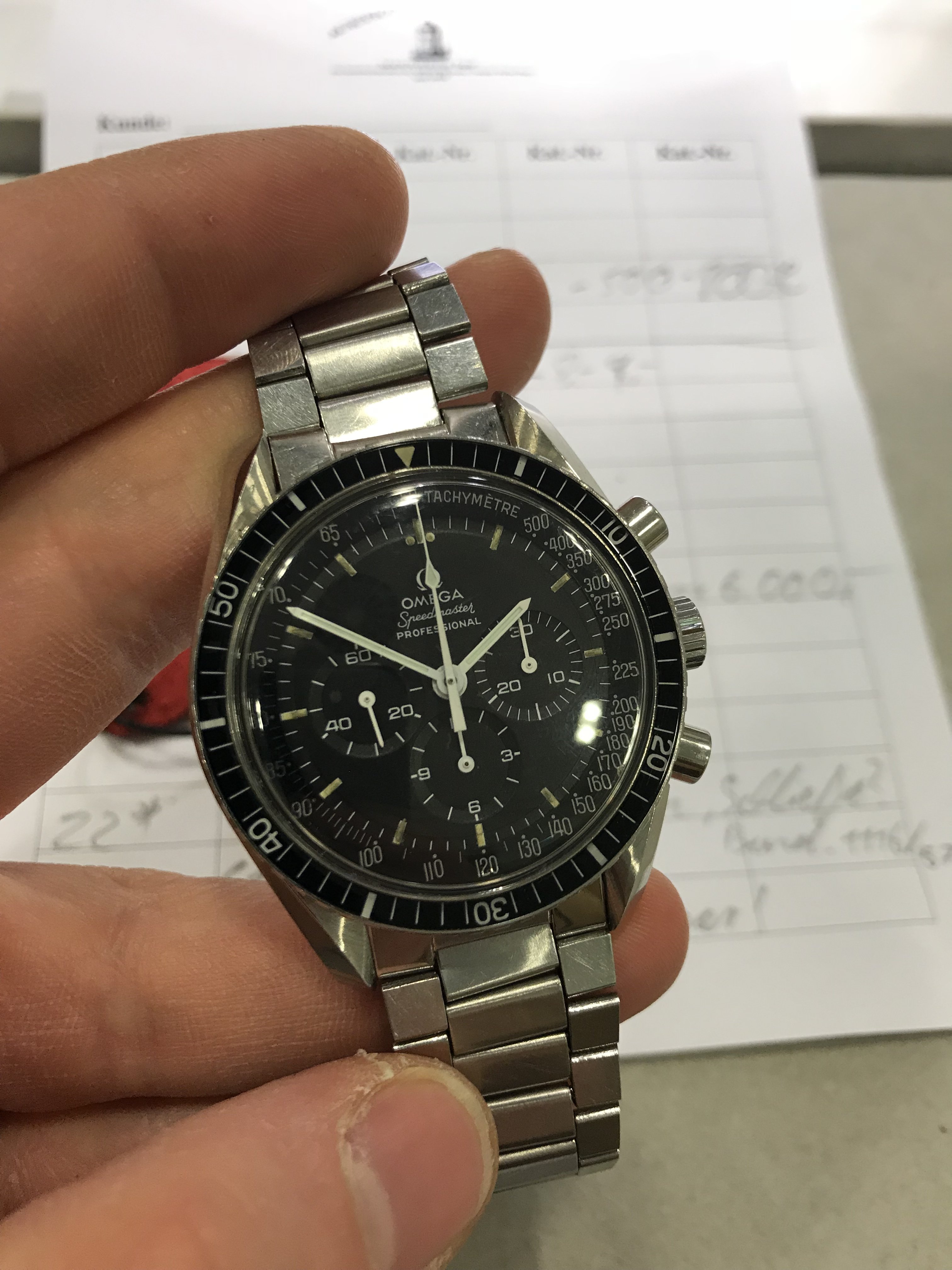

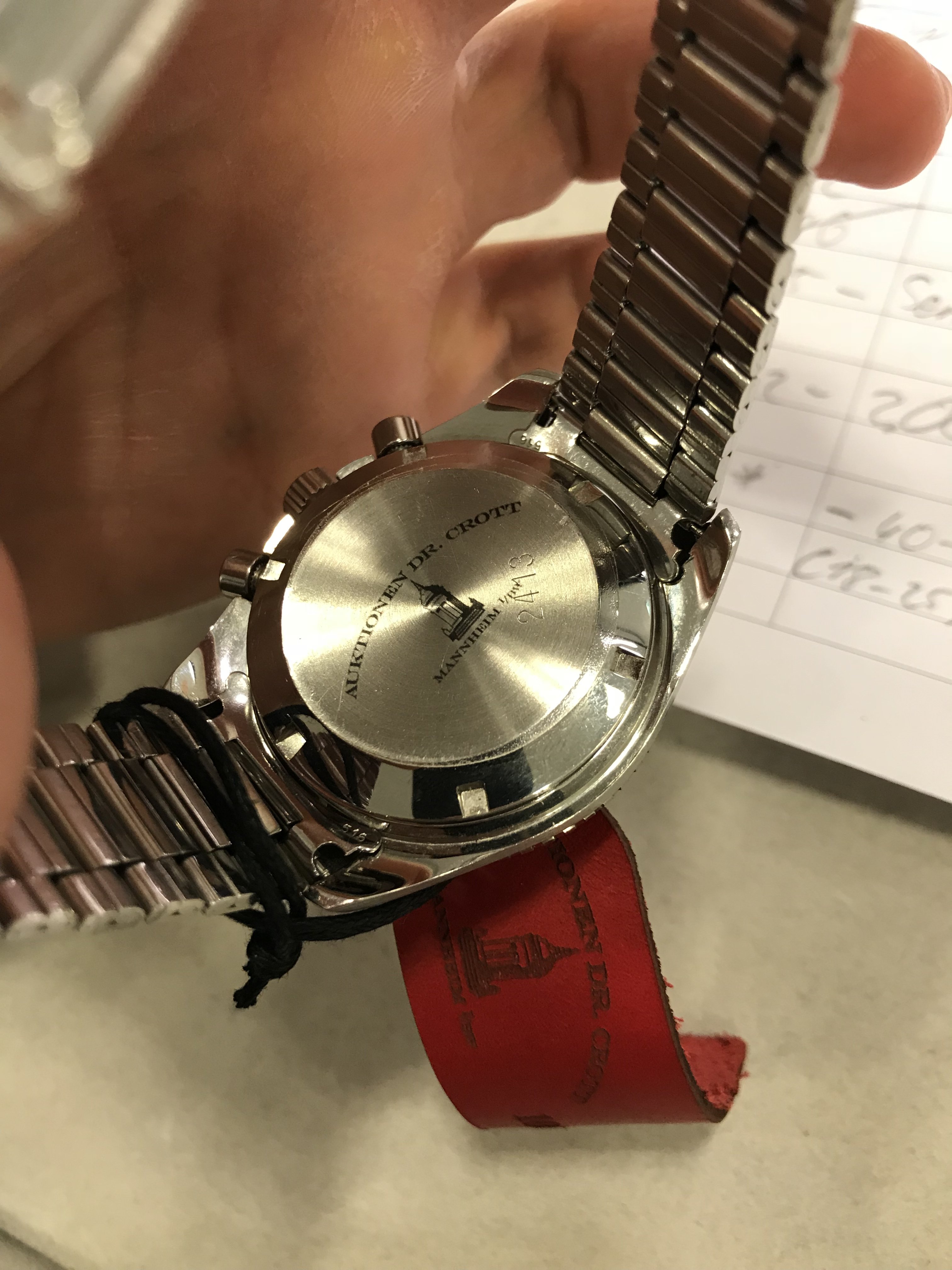

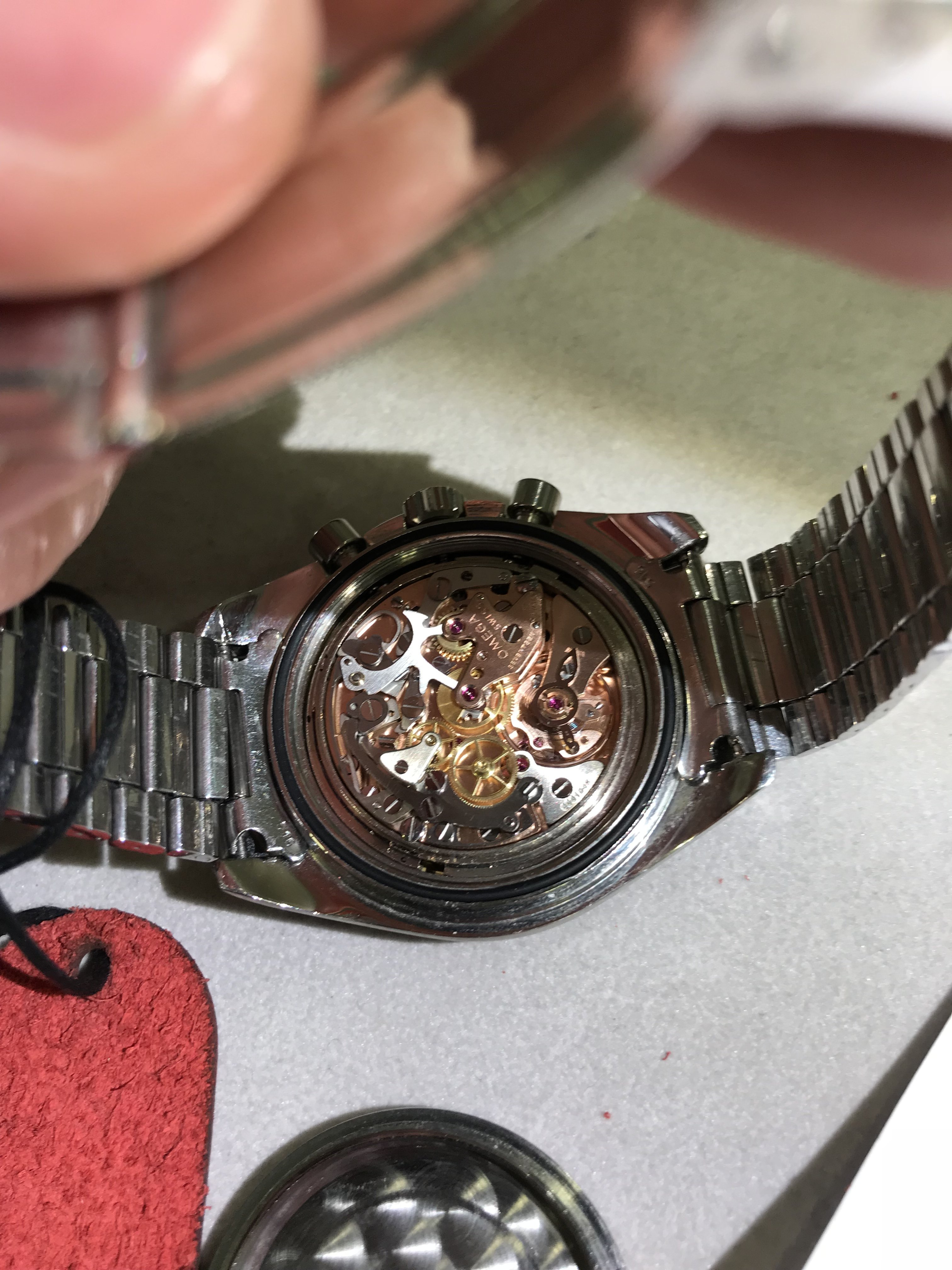

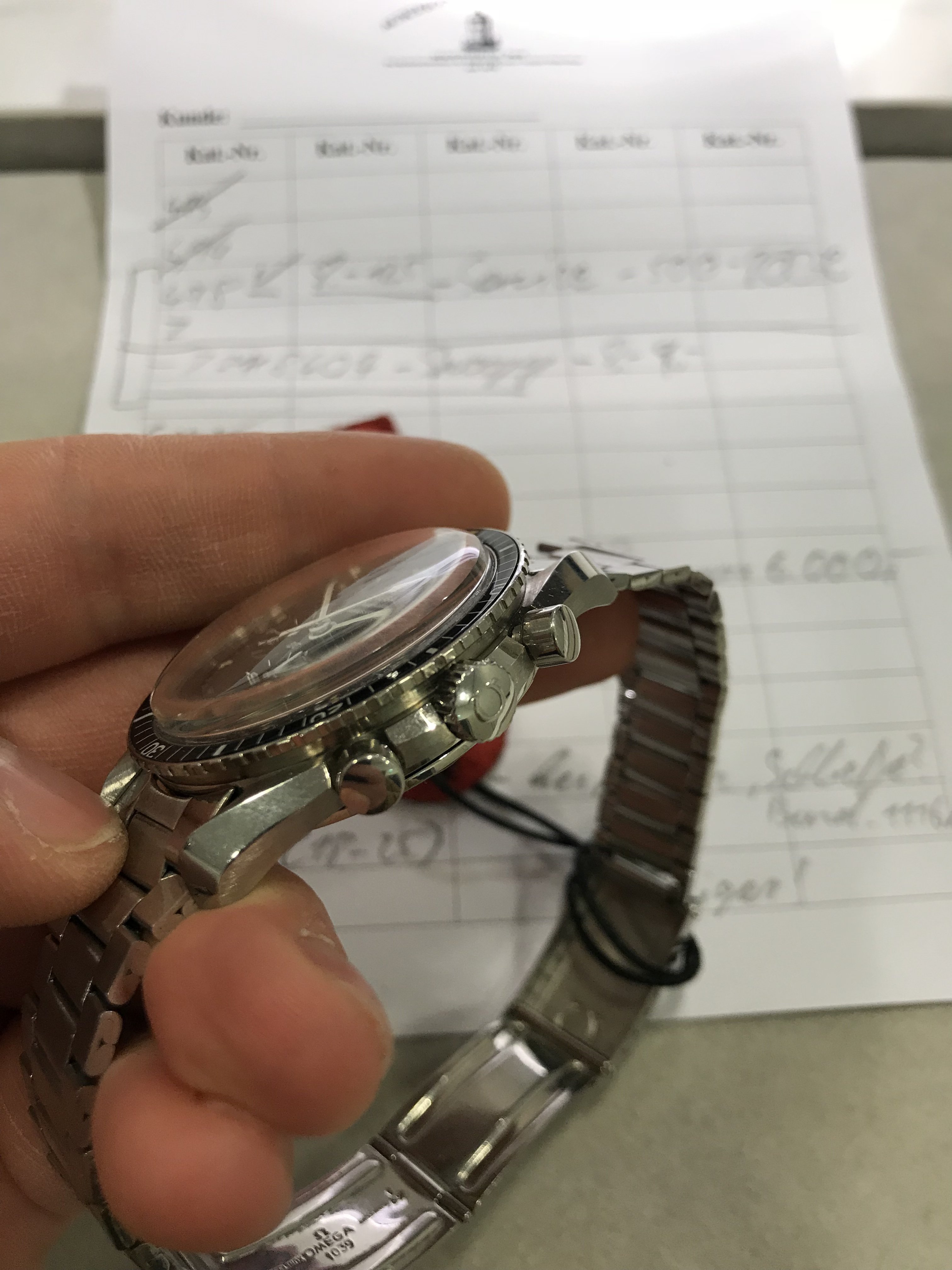

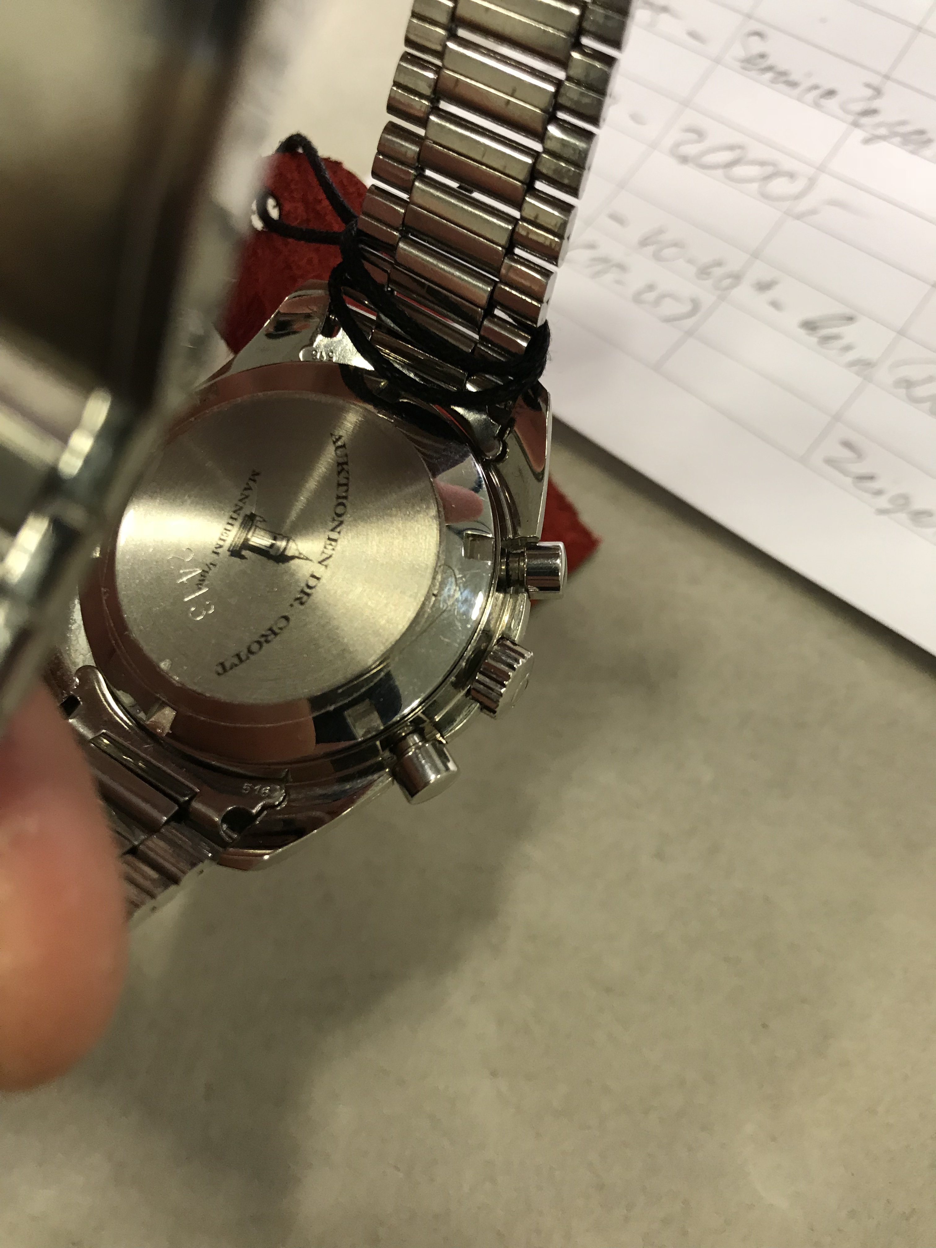

So, as promised I took a look at it and also spoke with Mr.Muser briefly about it.
He stands firmly on his position that the omega Museum told him via email (the one quoted above in French ) that the museum confirmed it is a prototype and further that they can not produce an extract because of the 000 serial number bridge. I had a native French speaker close by and she indeed translated the first sentence of the mail as „this is a prototype“ but this is nothing new as I assume that we have many native French speakers amongst our members. Why the museum would state that is a mystery to me and might be worth further investigation. Some of our members have deep ties to the heritage team, maybe they can find out why such a claim was made.

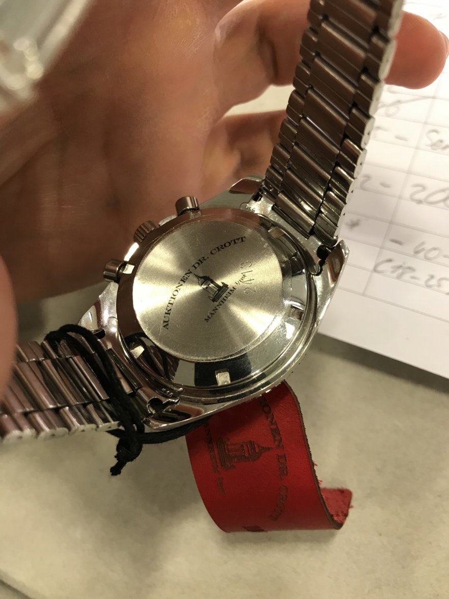

Not to defend anything here or take sides, just as an information, the auction house tries (and infact did on many of the other speedmasters in this auction and the one tomorrow) to get extracts on all speedmasters.
I‘m not versed enough with prototypes to give a concrete statement on that matter, but I, as many others here, believe by the evidence given and pictures shown, that this is not a legit prototype, but that’s just my personal opinion.

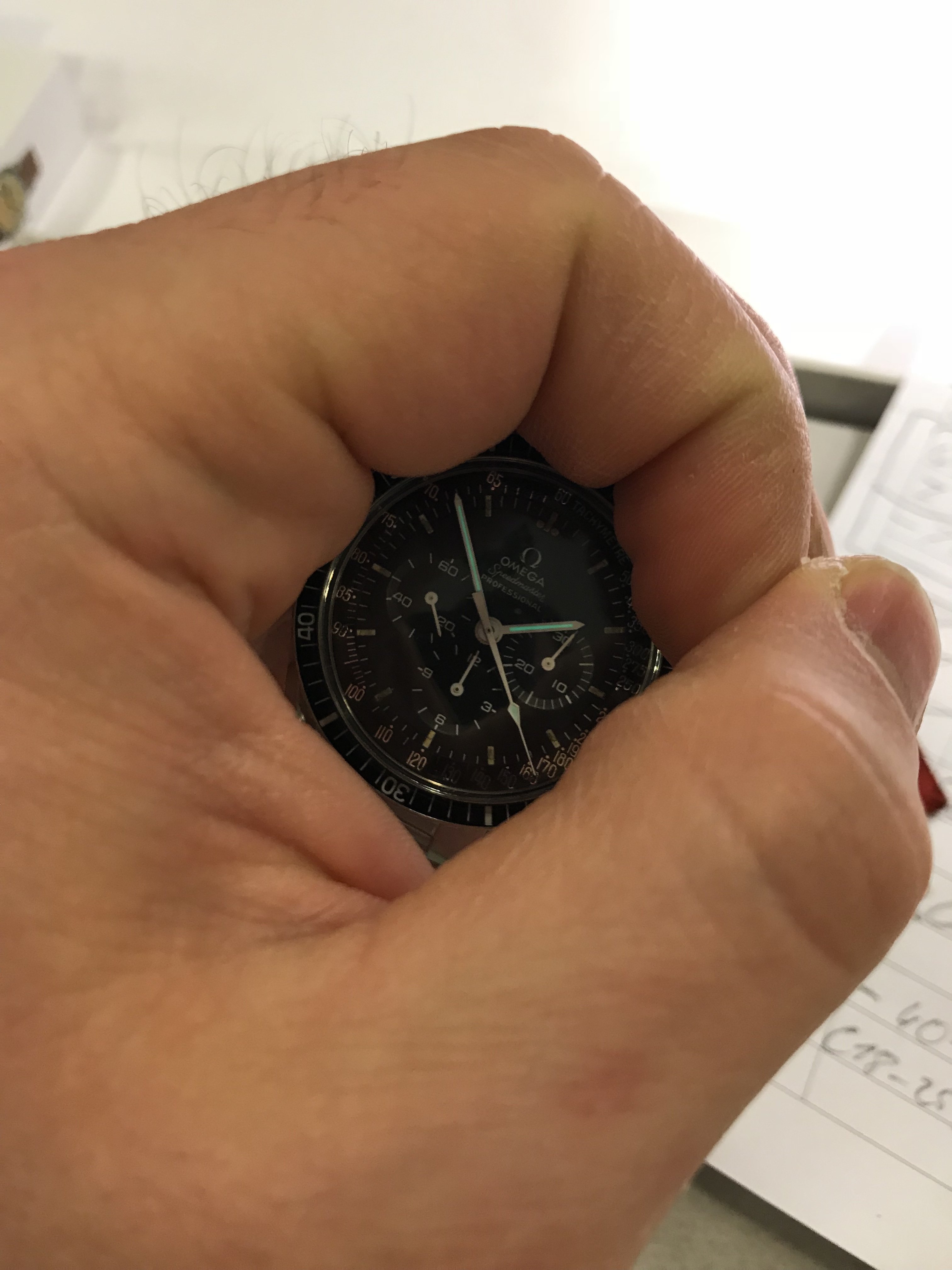

Here are the pics, as a noteworthy addition, by the reaction after a short stark light exposure, I believe the hands to be superluminova.
Cheers,
Max

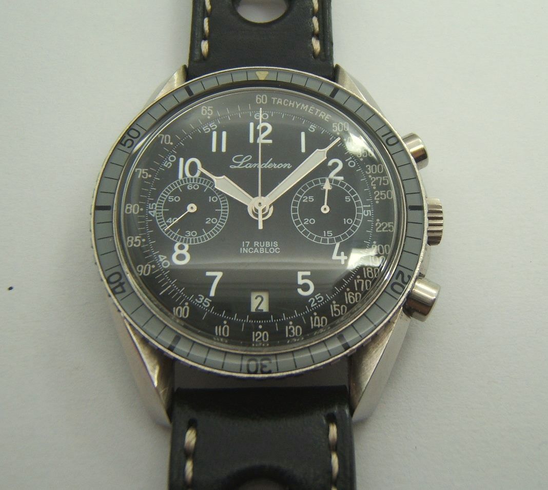

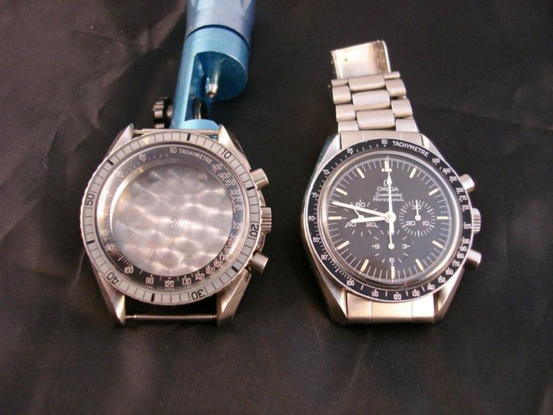

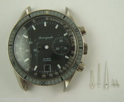

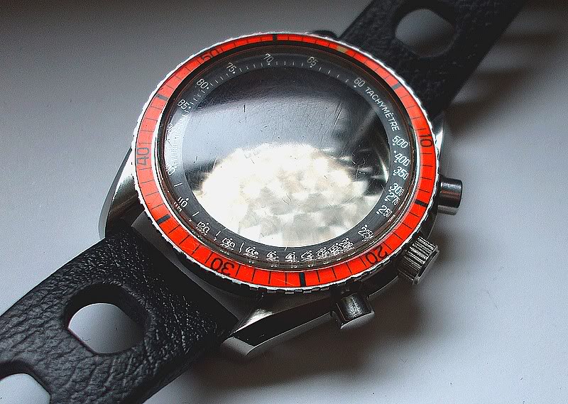

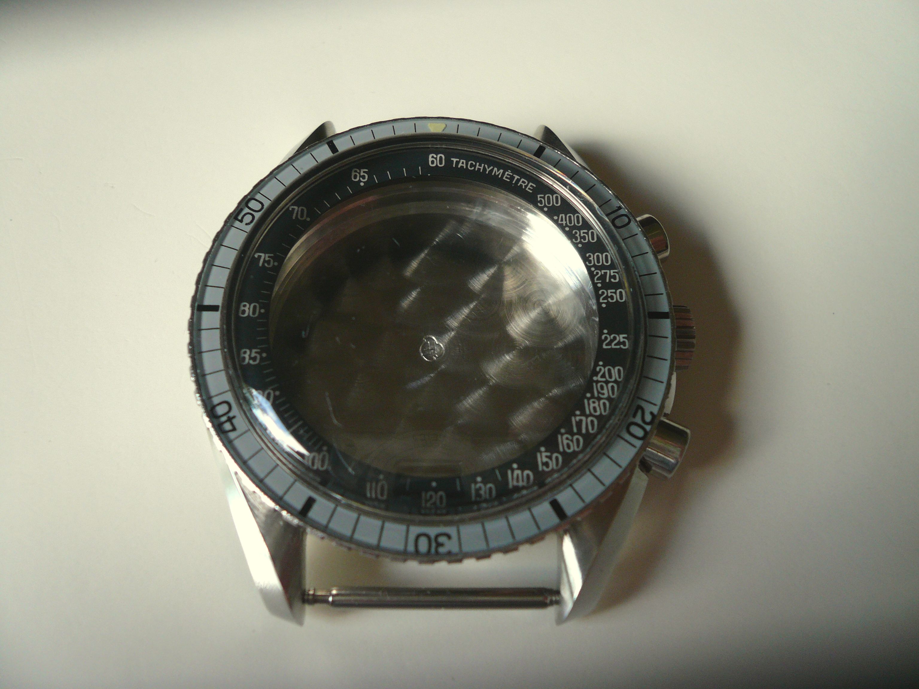

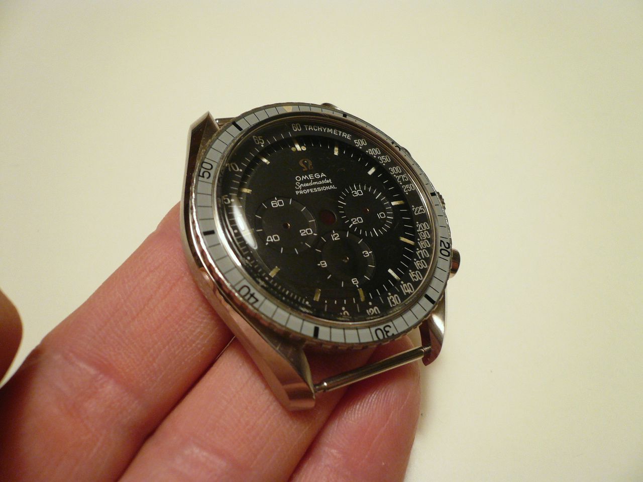

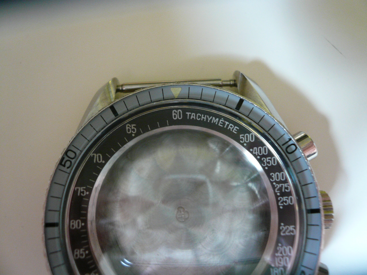

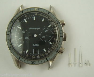

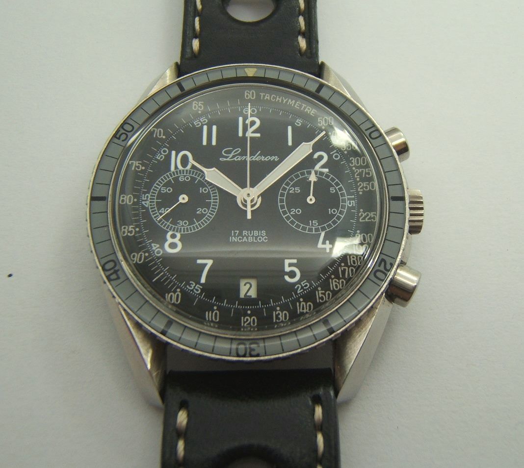

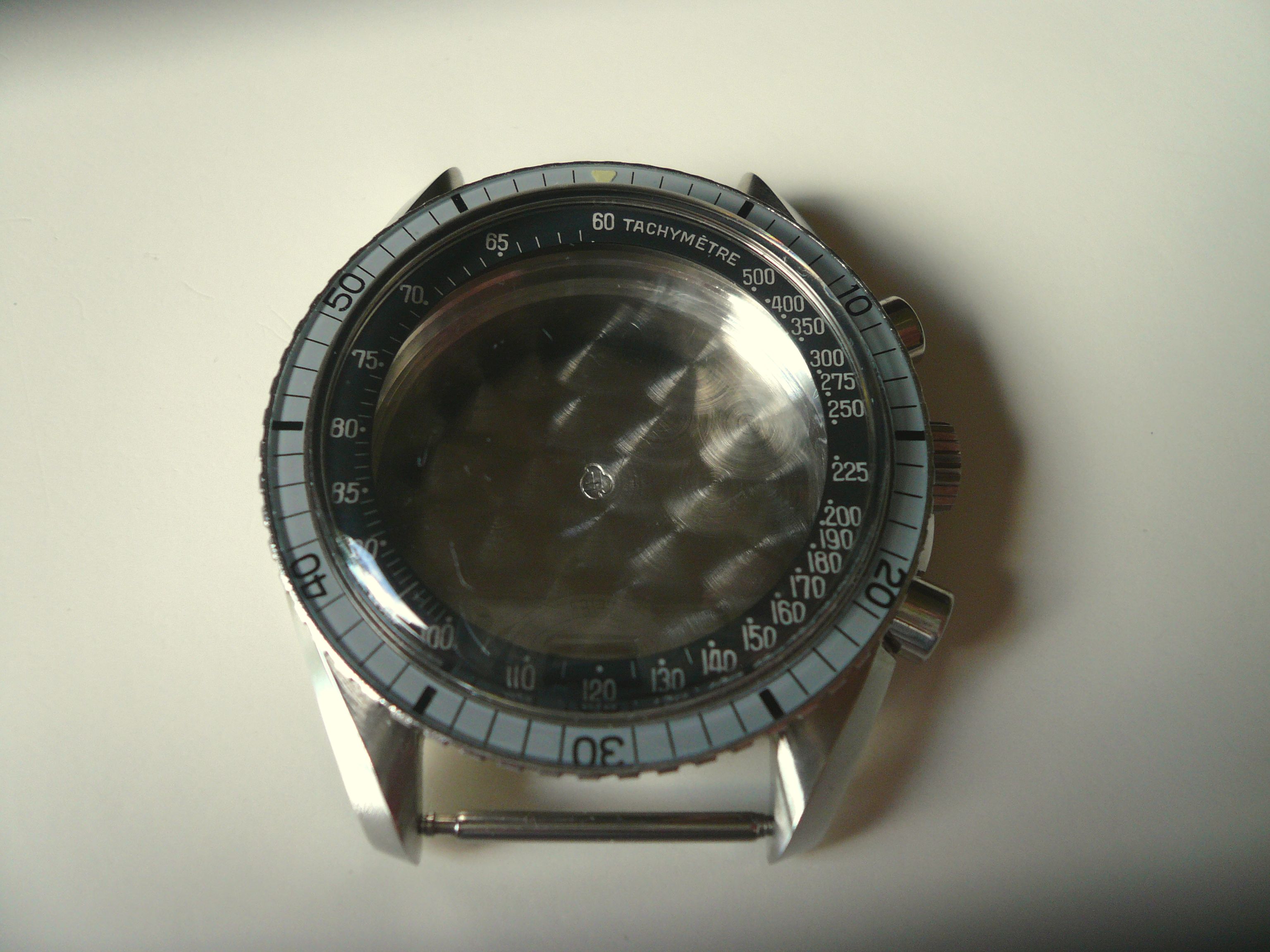

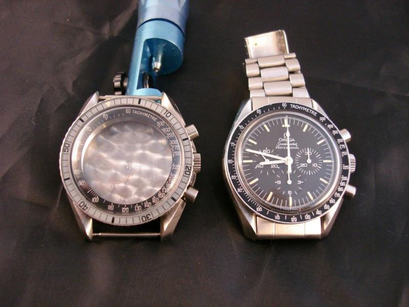

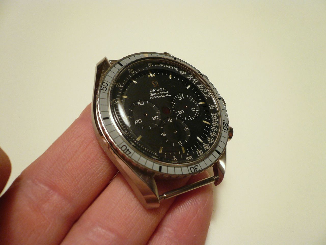

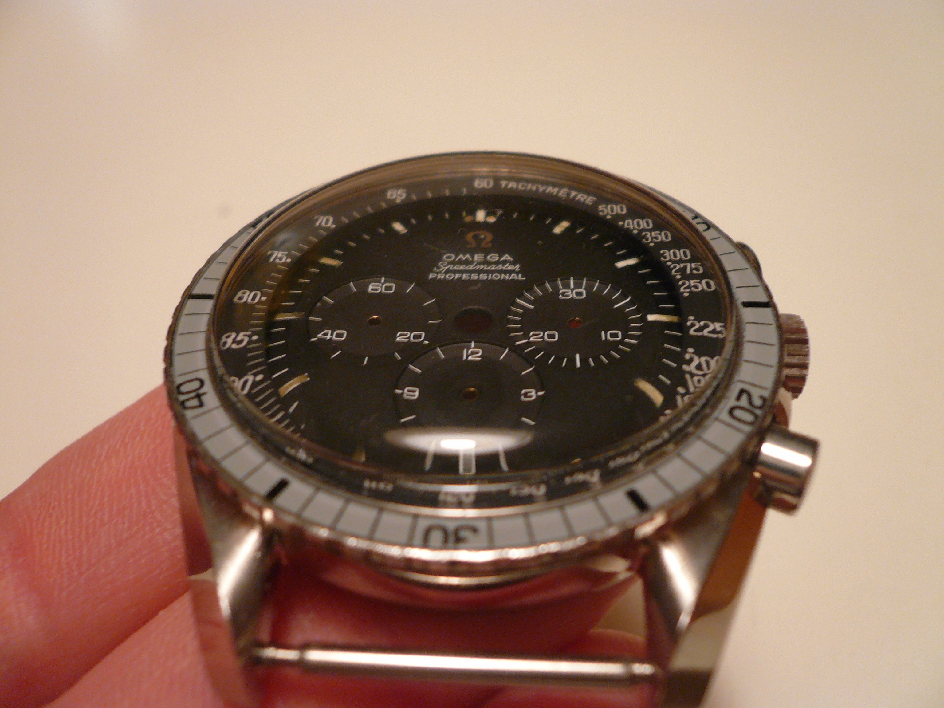

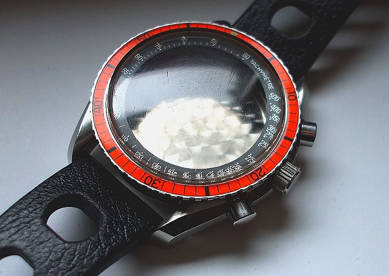

I expect the museum were not aware of the origins of these cases, and they do look very much like a development of the Speedmaster. The collective knowledge of enthusiasts is often greater than the Heritage team.
Once you see where the cases have come from it is obvious that this is cobbled together. I am sure they would on reflection change their stance.

Must be a prototype part to match the prototype serial #
or have they just shaved the top off and restamped it.
1,344
1,971
I am sure they are Lemania 873 bridges. Probably a batch of movements that does not have serial numbers from the factory.

Thanks @Speedmasterfan88 for sharing. I stick to my first opinion : 100%-put-together-pure-franken 👍

Are there any other indications of the age of the movement that can be seen. It looks awfully fresh. Also, I am curious about the date marks on the bracelet. Auction info indicates a 1/69 marked bracelet and an estimate of 1970 for the watch. Verrrry interesting.

Dial and lume almost looks like a typical dirty 69 dark chocolate 2911xxxxx ...
Let’s for one second entertain the notion that this is a prototype...why a ‘69-or-71/861? These watches/parts were in regular production for half a decade already. If this were a prototype Speedmaster, it would have to be much earlier...contain a 321, early pro/pre-pro no-t AML dial (or even something more exotic), earlier bracelet etc etc.
