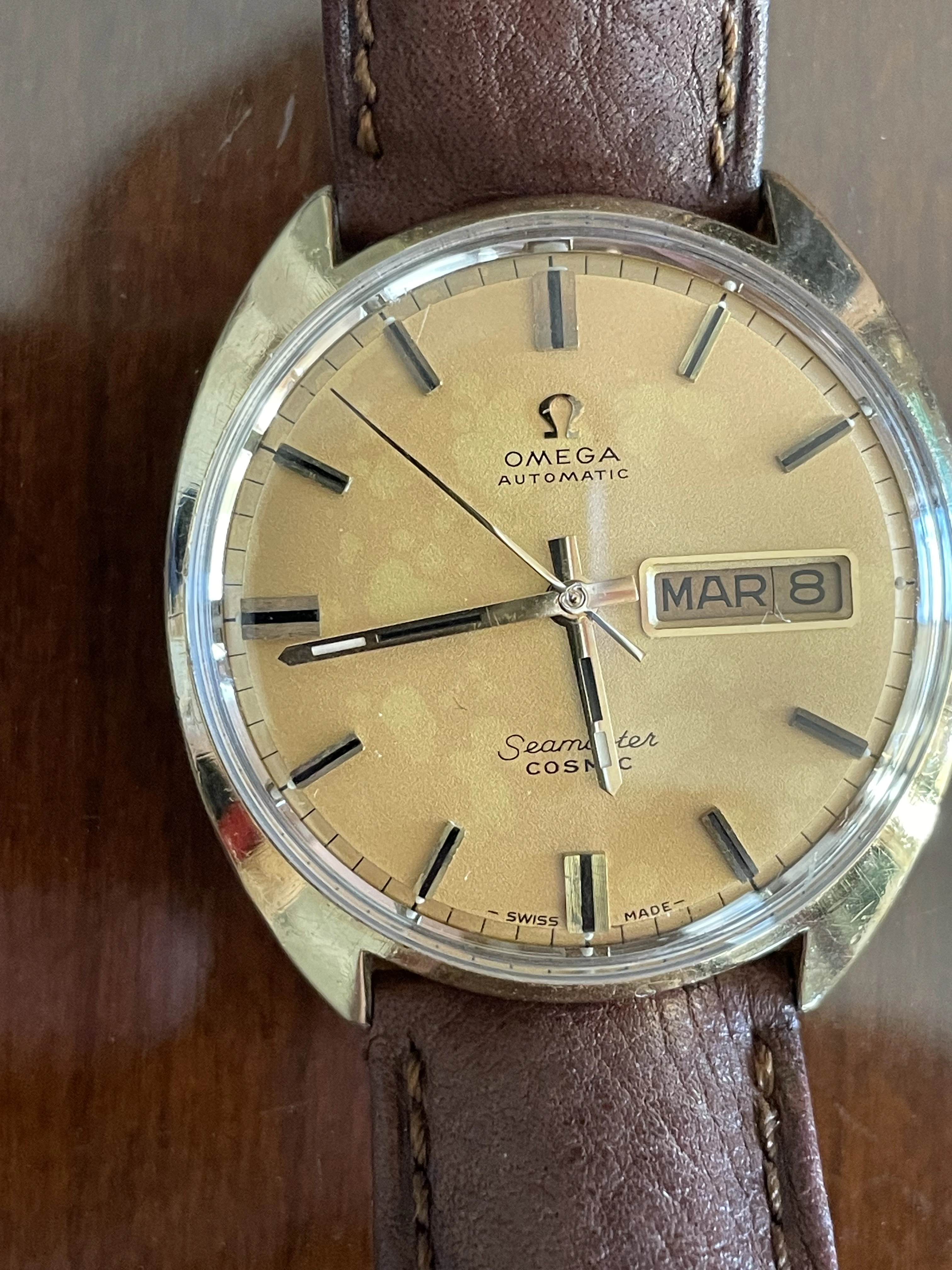

I like Seamaster Cosmics, I bet it's really special to have one that used to be your father's.
Can we see a picture of your watch?

Here's a photo of the watch.

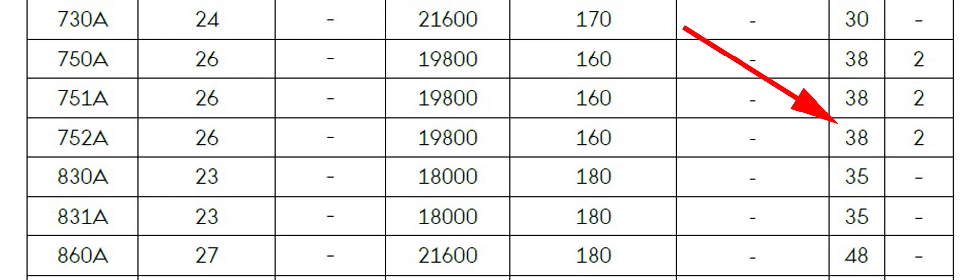

From what I remember, the power reserve of cal. 752 is indeed 50 hours.
It is not. It's officially 38 hours as indicated at the red arrow:

I stand corrected. My reference was mainly based on below sources:

Reckon that the table you have quoted is from an official Omega source?
Yes. It's directly from Omega.
While Ranfft and these others can be helpful, I have found many errors in the information they provide, so I wouldn't take them as a completely reliable source for such details.

Once again thank you very much for all the information. I feel relieved that at least I don’t have a power reserve problem.
Just to be clear, 38 is what is required, and 36 is quite low, so there still may an issue.

As an aside from the power reserve discussion, I'm curious about what was done to the watch. The hands look new, but the dial looks old and patinated, but with new lume dots. It does not appear that they refinished the case with the proper surface finishes.
What did Omega list as the work performed?

The hands are indeed new. The face was not changed (the discolouration was probably due to humidity ingress) The lume dots were changed on 2018 (previous service again from Omega). In fact two lume dots (5 and 9) were missing when I sent it for service this year but were not replaced. As for the case they mentioned that because it is gold plated they cannot renovate it.
I understand, but wouldn’t it be normal after 50+ years of constant use and abuse the mainspring to lose some of it’s elasticity and therefore not be able to have it full original power reserve capacity?
The mainspring would generally be replaced.
