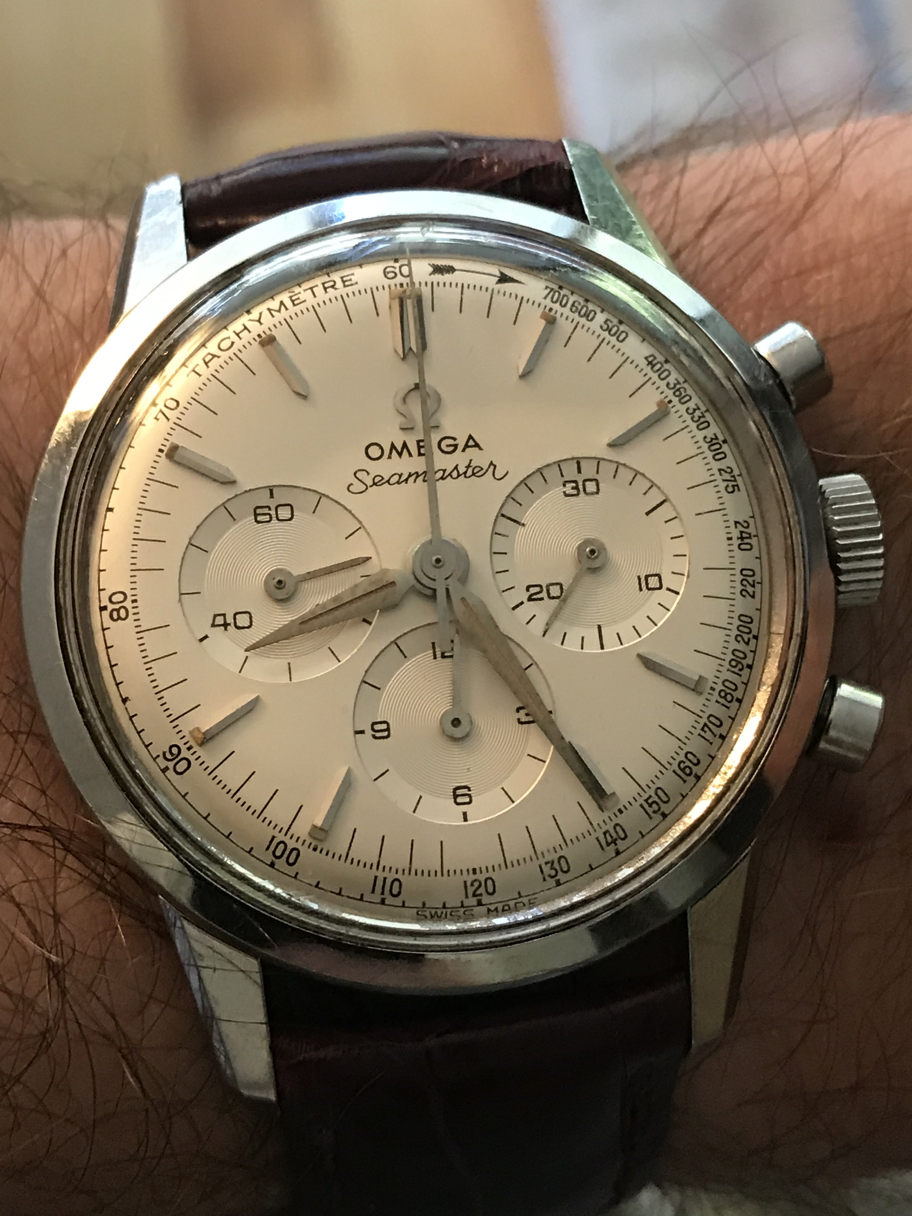

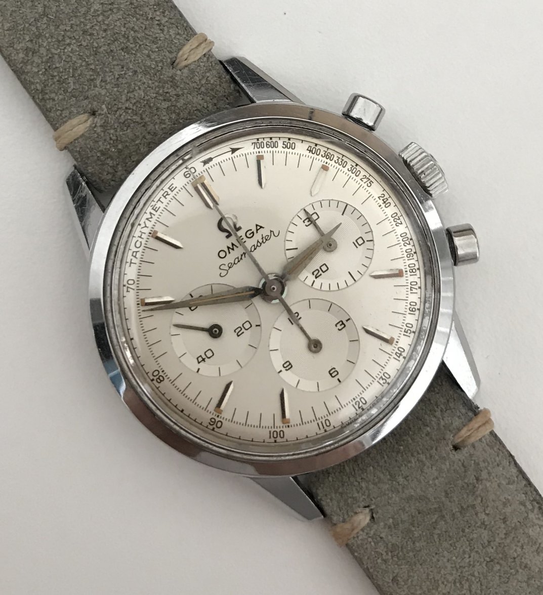

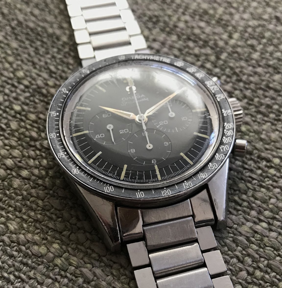

From what I have observed the hour counter sub dial hands are flat like the OP example until 1962 (my ex 105002-62 pic below). Rule is the same for Speedmasters and other Cal 321 based chronographs like 105.001-62 (see also pic below of one I sold) . Anything -63 onwards tends to have the raised bump in the centre like the one posted by Al.
One of my favourite tells for a good original example is seeing this flat hour counter hand. You know straight away the hands were swapped at some point if not.
It might be that some early batch -63 Speedmasters have the flat hand but I have NEVER seen one with it.
