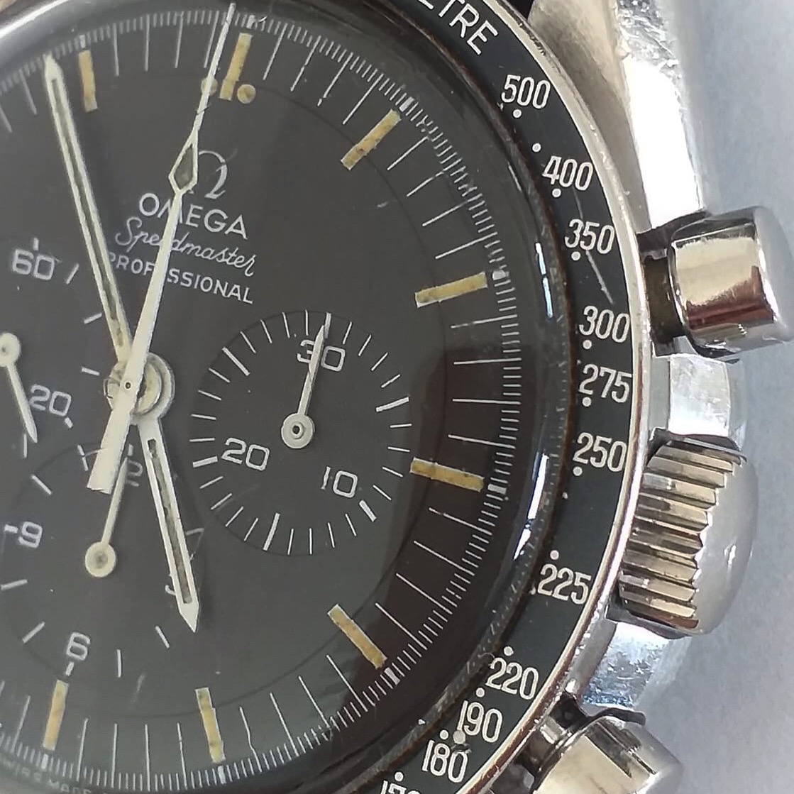

Thanks, mine wants to be a chance to make some considerations that can be helpful for someone else. Anyways my biggest question mark it is about hands. Case has some scratches but doesn’t matter.

Those hands look fine, bright white sharp hands standout like a sore thumb on a vintage Speedmaster, I have one with chipped paint at the base of the hands and was considering having those areas touched up with matching paint, but the consensus is to stabilise them and leave as it is.

I think the hands were retouched in the past, there is an area that is not so well painted..also there is a yellow shade/dirt that is very bad..for this reason I was thinking to do something. Second hand is the only seems fine

I think the hands are fine. It’s in keeping with the rest of the dial and case- in perfect harmony. Retouching the hands could make them stand out.

Did you notice the 220 bezel. Is your SN in the right range. Neat little detail...

Yes the serial is ok with the 220 bezel..
