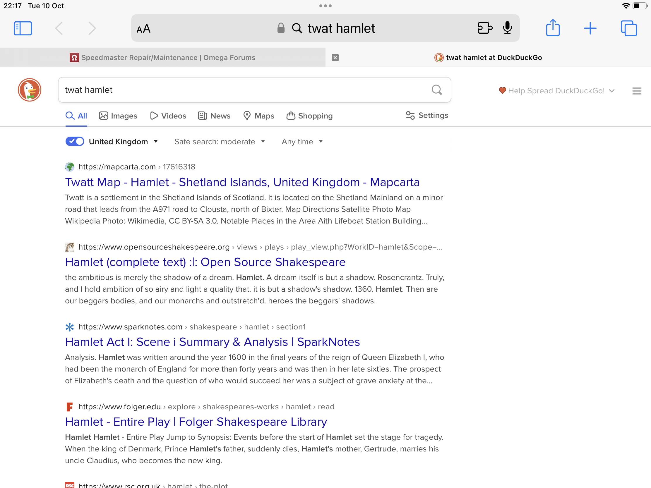

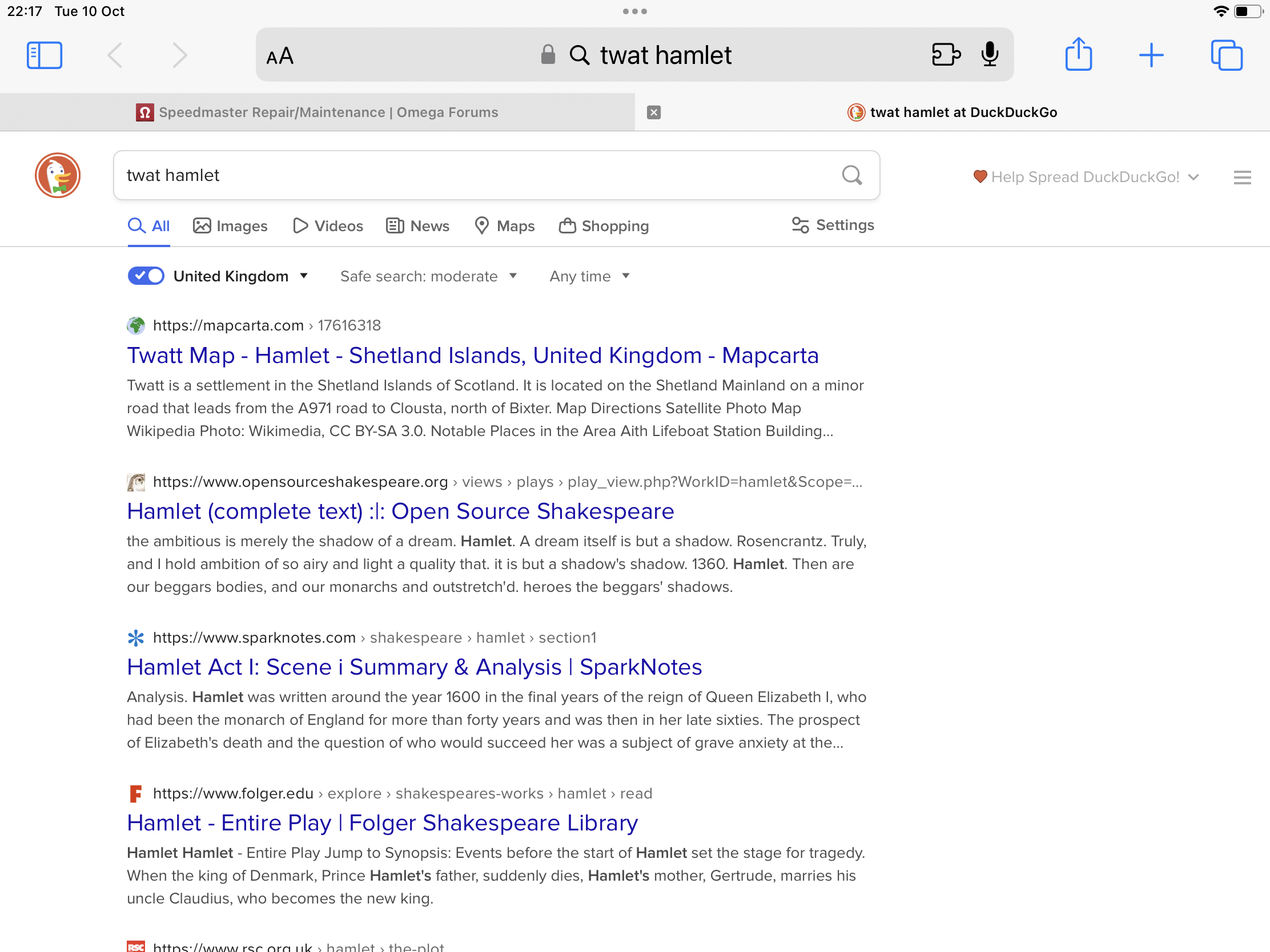

@Davidt @Aroxx Couldn’t help myself…..
….thank you, off to open a watch repair shop.
Brave man. Your google ads are about to get interesting lol. Soon the top hit will be this thread.
