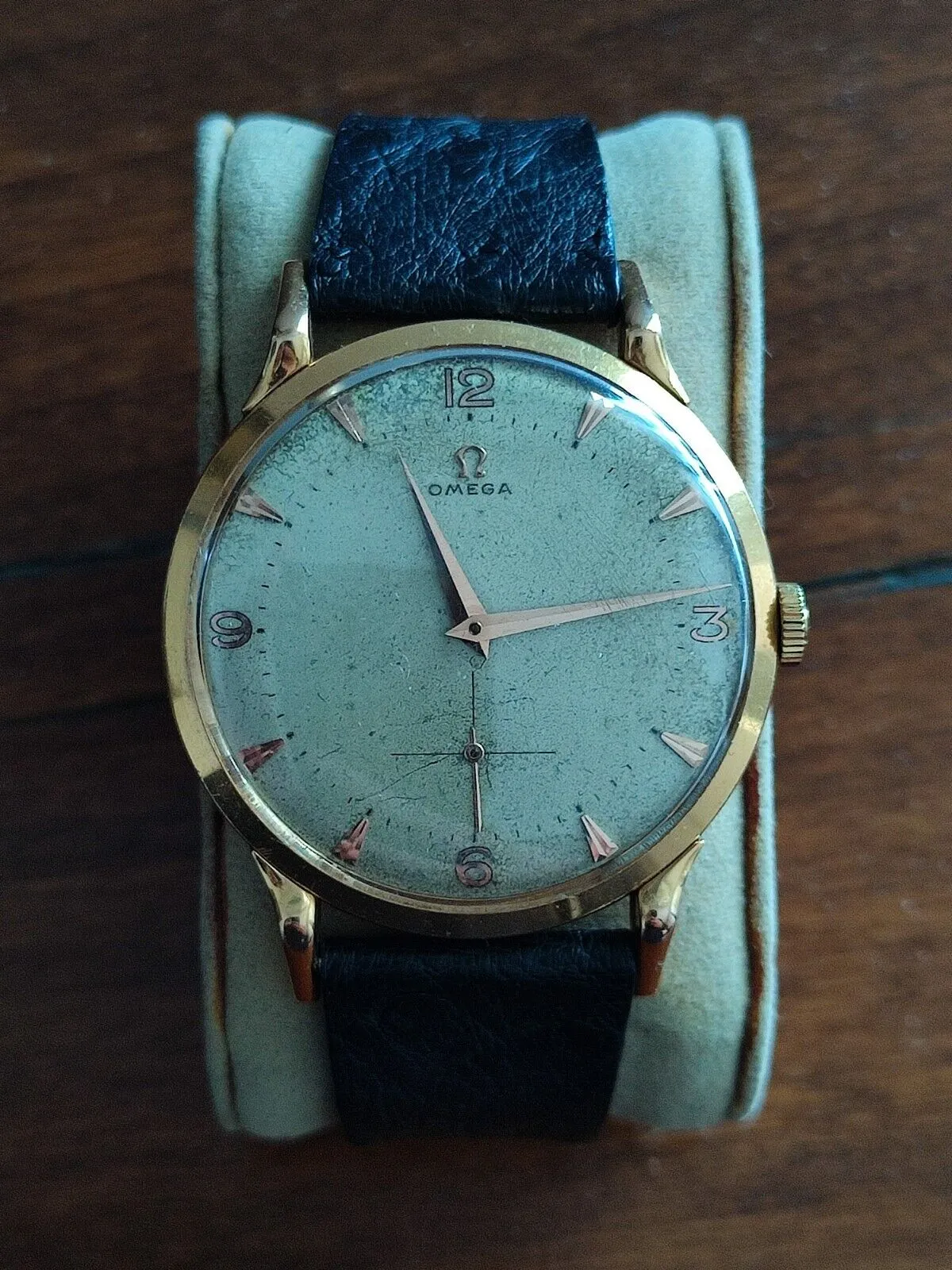

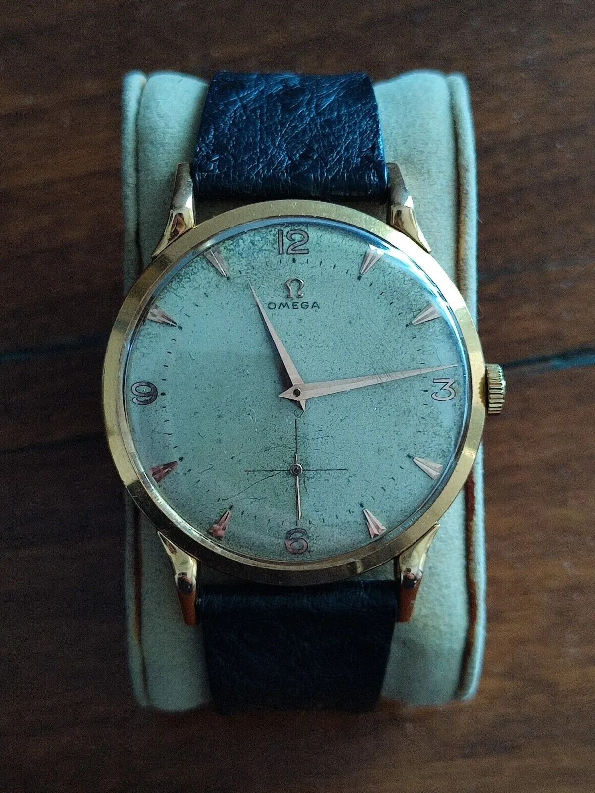

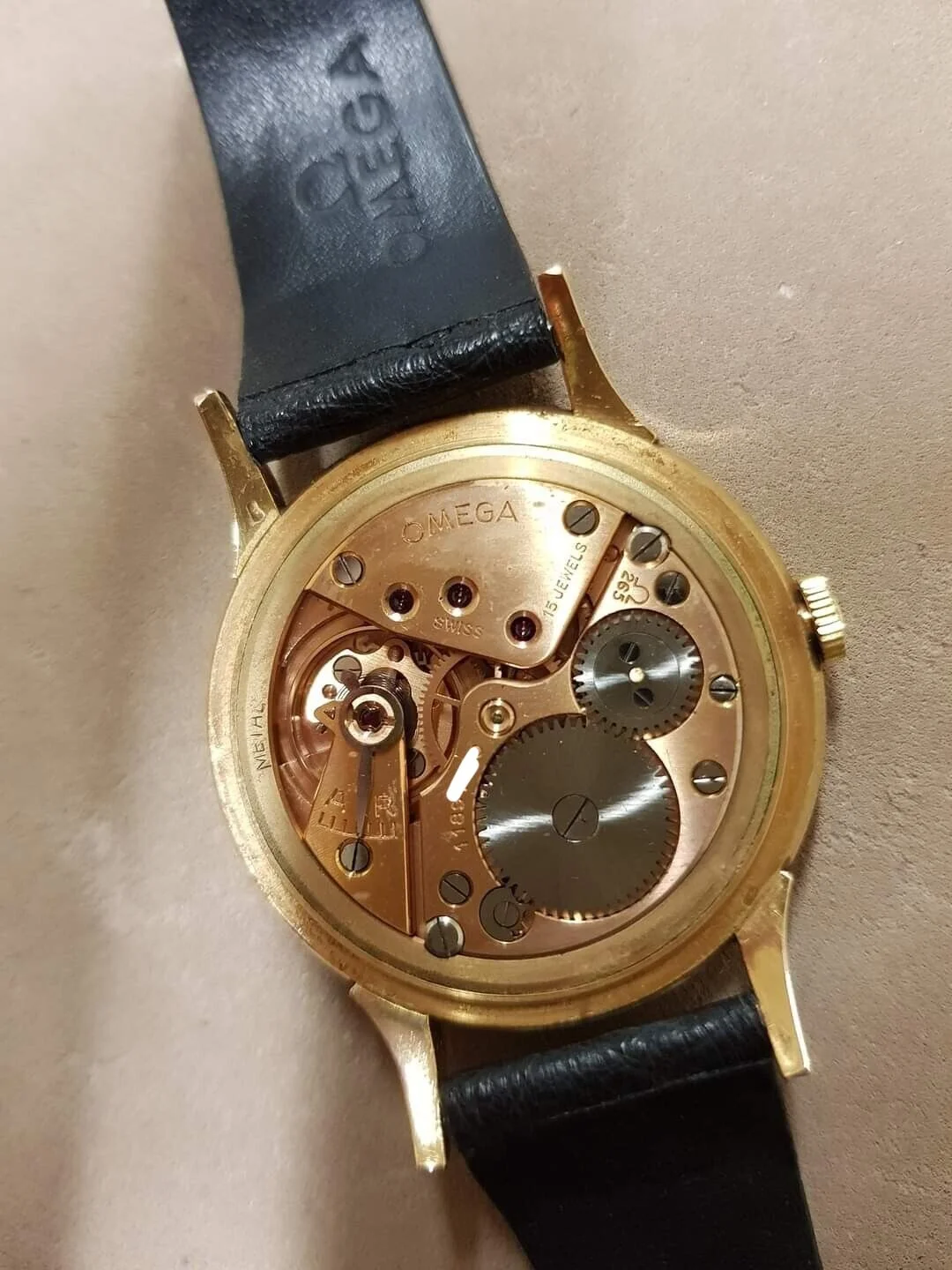

Hi, I inherited this watch and would like to know how normal it is to lose the correct time and when it is normal for it to lose its charge. I hope I have been clear but before taking it for a review I wanted some more information. thanks so much Alex

A watch like this which was serviced in 2020 should not lose much more than 30 seconds per day. So when wearing it, you’ll have a good estimate of the actual time. 😁
About losing it’s charge: just wind it every morning before strapping it on your wrist. It shouldn’t stop before the next day.

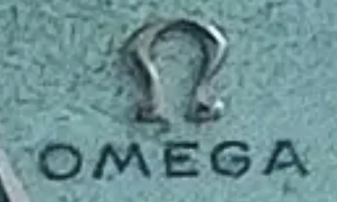

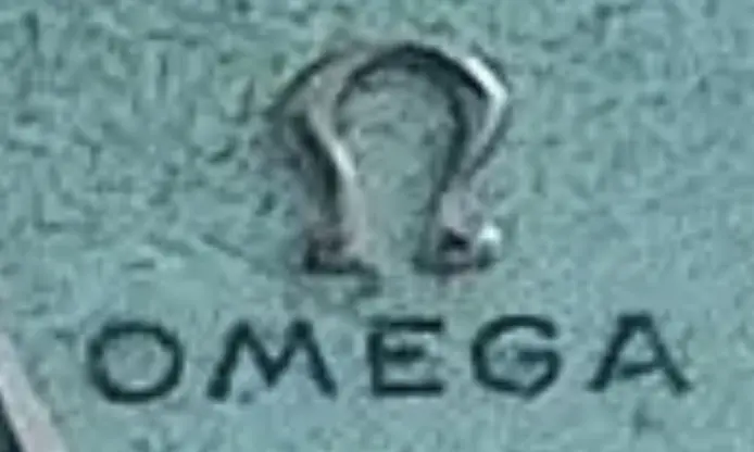

In principle, the power reserve should be in the neighborhood of 36 hours, but as long as it is keeping good time day to day, you don't need to worry too much about it.
These dials do usually have SWISS or SWISS MADE at the bottom, so it's possible that the dial was repainted at some point. We'd need better photos to determine that.

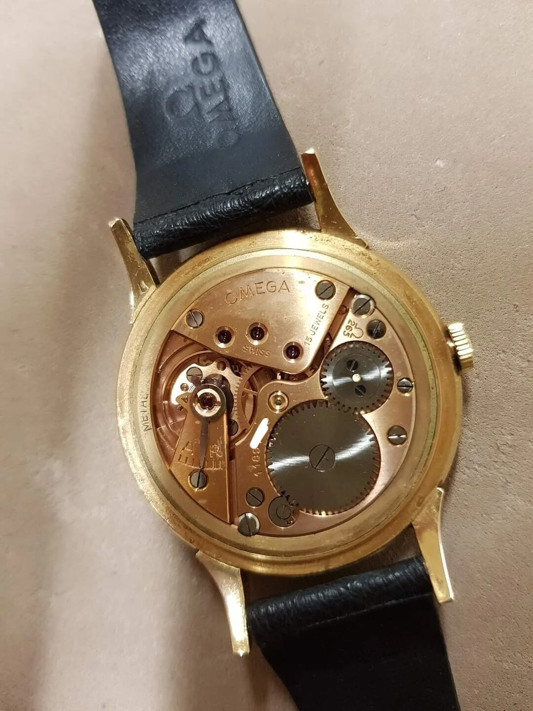

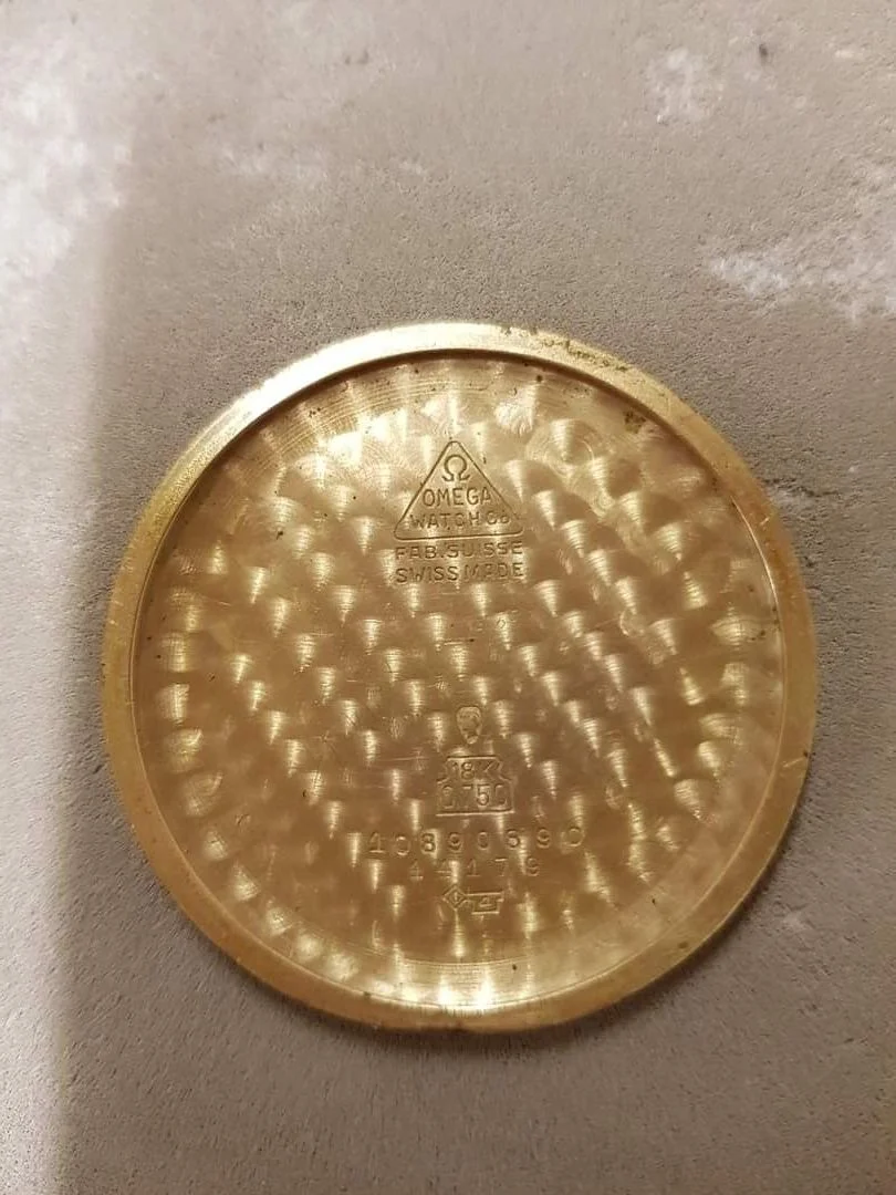

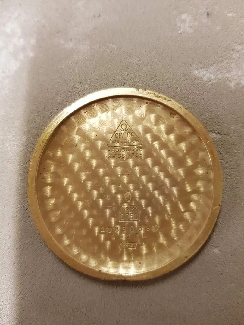

Could I just note that your watch isn’t a Constellation as mentioned in your thread title.
If you can show the inside caseback we would get an idea of the actual reference

here is the photo, strange because I had searched on the site and it gave me that but I also had some doubts about it

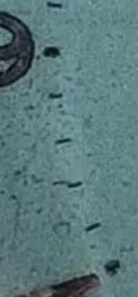

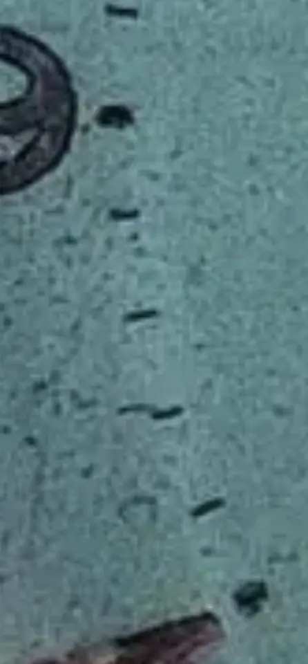

mmm interesting looking at it carefully I don't see it written but I also noticed looking around that it is not always written the photo doesn't really do justice to the colour which is more of a "champagne" colour
24,823
55,208
We would usually make a judgement based on the correctness and fine-ness of the printing. For example, looking at the font and the accuracy o the tick marks. Sloppy fonts and misaligned and uneven tick marks are signatures of a repainted dial
I did some research but found conflicting opinions, so you assume that it was just repainted and not that the dial is not original? The omega symbol seems consistent with the vintage of the watch (always based on my research) thanks
