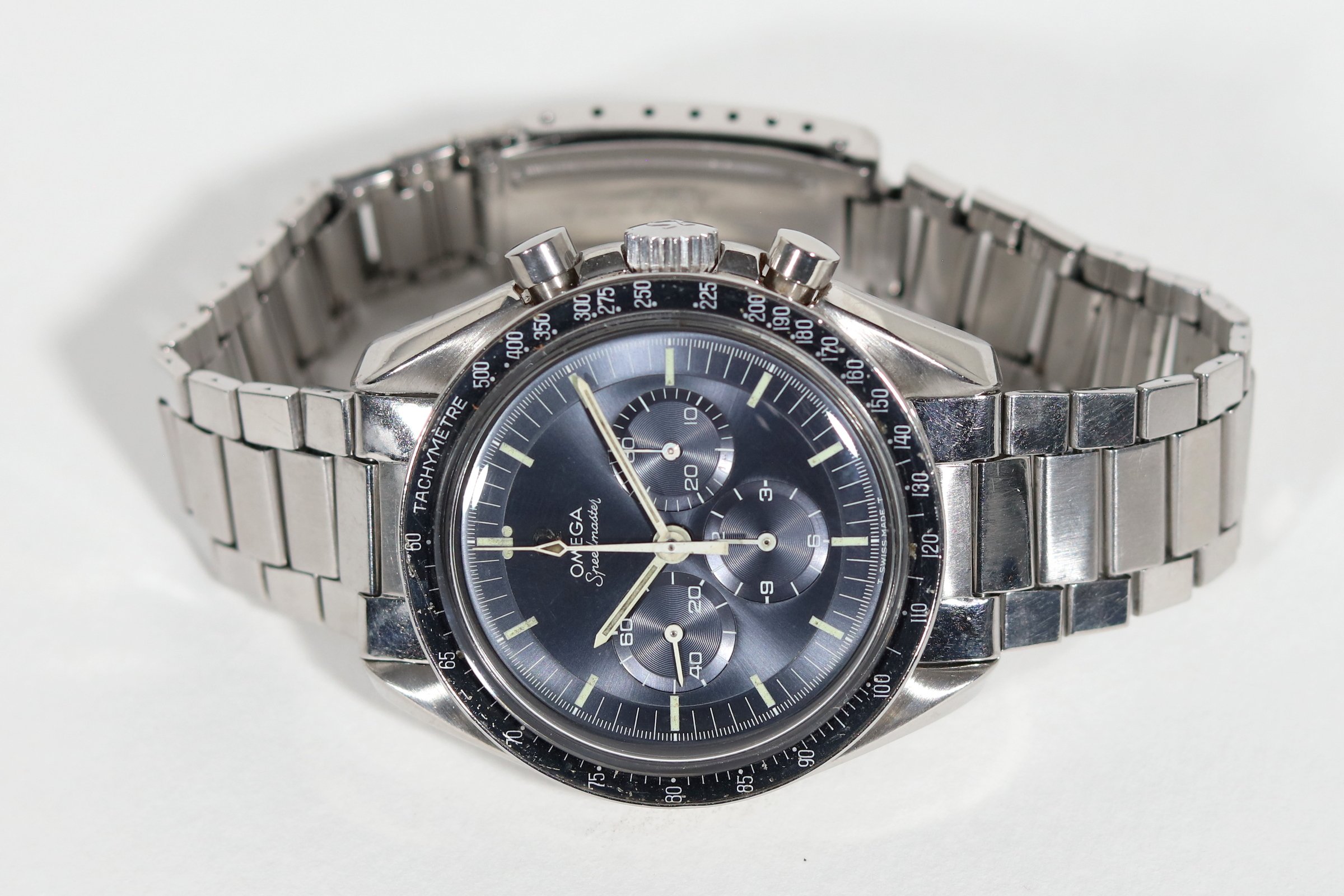

I post this just to prod us all into posting more Speedmaster threads.
Here is a very rare dialled 105.012-63.
The extract states:
Several things to note.
The "Light Silvered Blue Sunburst" dials are seen most commonly on Ed Whites, but I have seen them on a 2998 and more than one 145.012.
Most that I know of have confirming extracts.
At least one similar dial plate was fitted without feet to a watch offered at auction. WOK had one that failed to sell, as it was a loose dial without provenance.
The extract, while confirming the dial, might now, along with all "special" extracts, be called into question - however I have no worries I think these dials are factory fitted where specified.
There are variations in dial style. Some long markers, some professional marked, but there are so few, that we cannot say if there is a correlation between styles and references.
The received wisdom is there is around 20 Blue Silvered dials in existence, but this figure is not based on anything more than a guess based on public sales.

The excerpt states" sun brushed " , which is not an agreed description term. I'd even question that excerpt now. The only thing, I've seen in the Flesh, are these dials on Dial Factory Sample Books. All without Dial Feet. Which are not difficult to fit with the correct equipment.

Was the extract issued without a photo or mention of the dial? If so that is very interesting. If not then errr as you say it may be not fully reliable.
It is very interesting if factory fit that it has no Professional marking as I had always believed that no such combo of twisted lug and non Pro dial existed other than in illustrations or Frankens. It is a very early twisted lug mode l so perhaps a few were released with the non Pro dial in this era. Then again The wide Ts and short indices are also noteworthy and a little strange on a dial purportedly made in 1964 or earlier. Many (most?) -63s have no Ts at all or asymmetric Ts, and -64s to -66s have them narrow set. Surely Ts like that werent seen until 1968 on normal series dials so again I would question whether this might be a marriage, a marriage made in Italy as many weird Omegas seem to be.

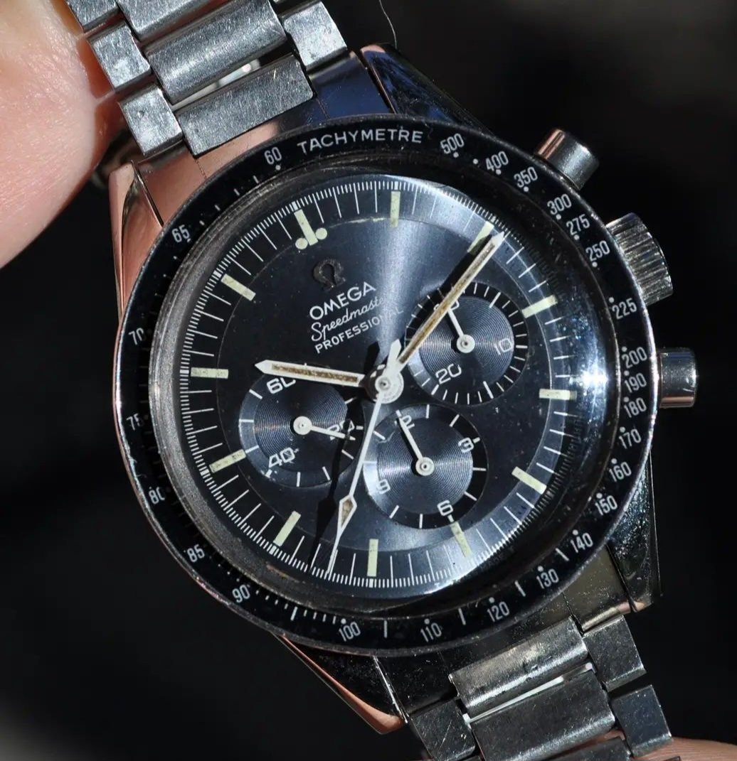

Thx for posting @Spacefruit .... have seen blue on a so-called soleil metallic dial on Ed Whites but of course not many out there. Sliceoftime also showed a grey Soleil for a 105.012 on which the hour markers extend on that example the full length as normal. Nice looking example here too on yours! Nice, rare find

Professional on the Dial ? Sure, because these Sample Dials were made in the 70's , as far as I know. Made by Dial manufacturers in the Hope, OMEGA would order them for a new variant of Speedmaster. Like the metallic blue TV Dial version aso. Like some Rolex and Tudor Dial Sample Book examples , that found the way to dealers and eBay.

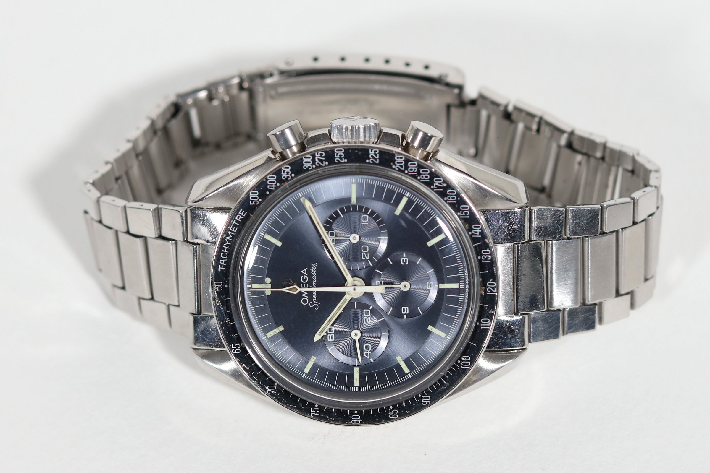

Mine says hi.
The watch is a 2915 (as per the extract) and was serviced many times by Omega during its past life. My guess is that the dial and hands were swapped due to either damage or due to the new radium regulation.

Mine says hi.
Similar colored lume, too.
