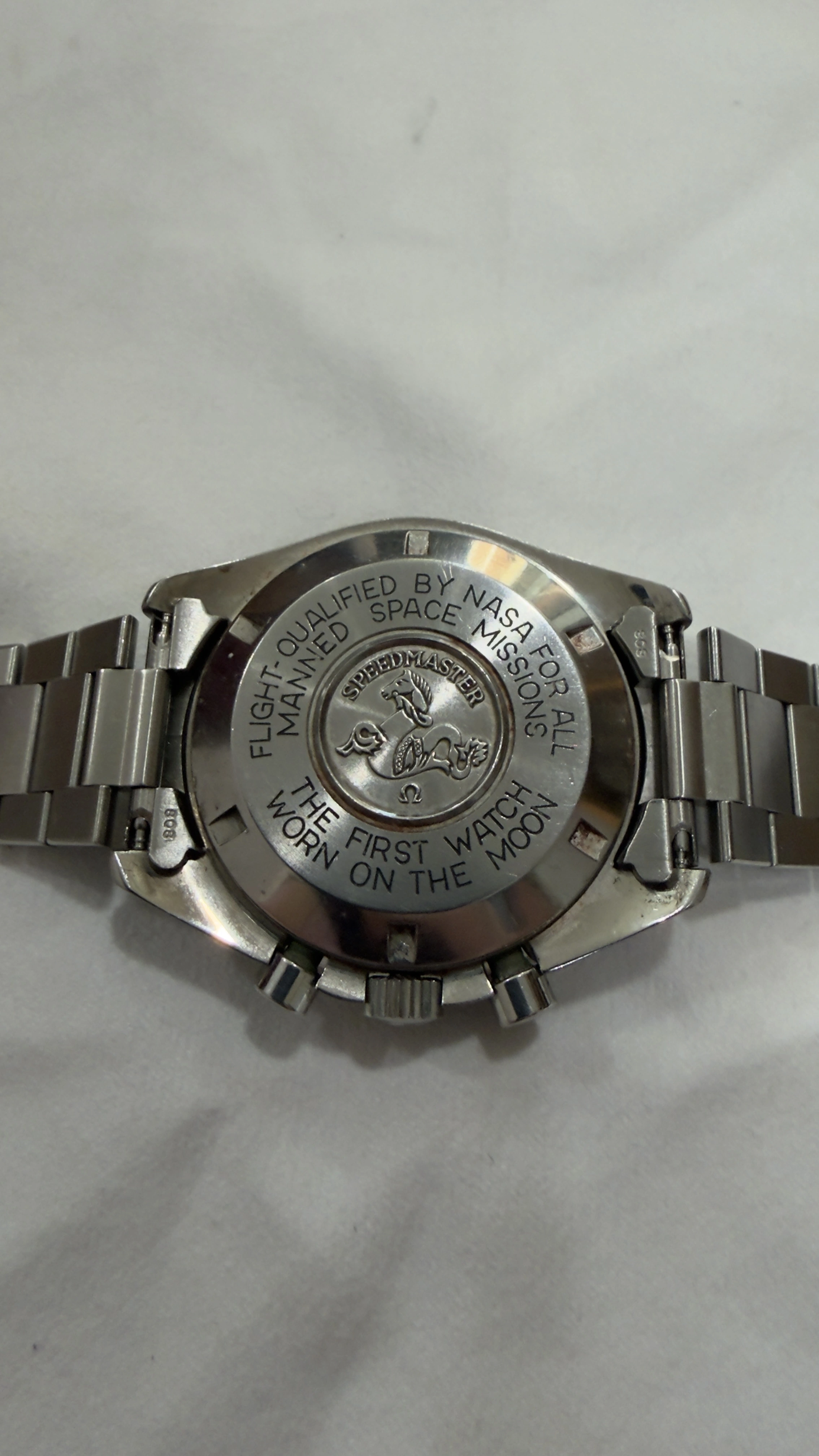

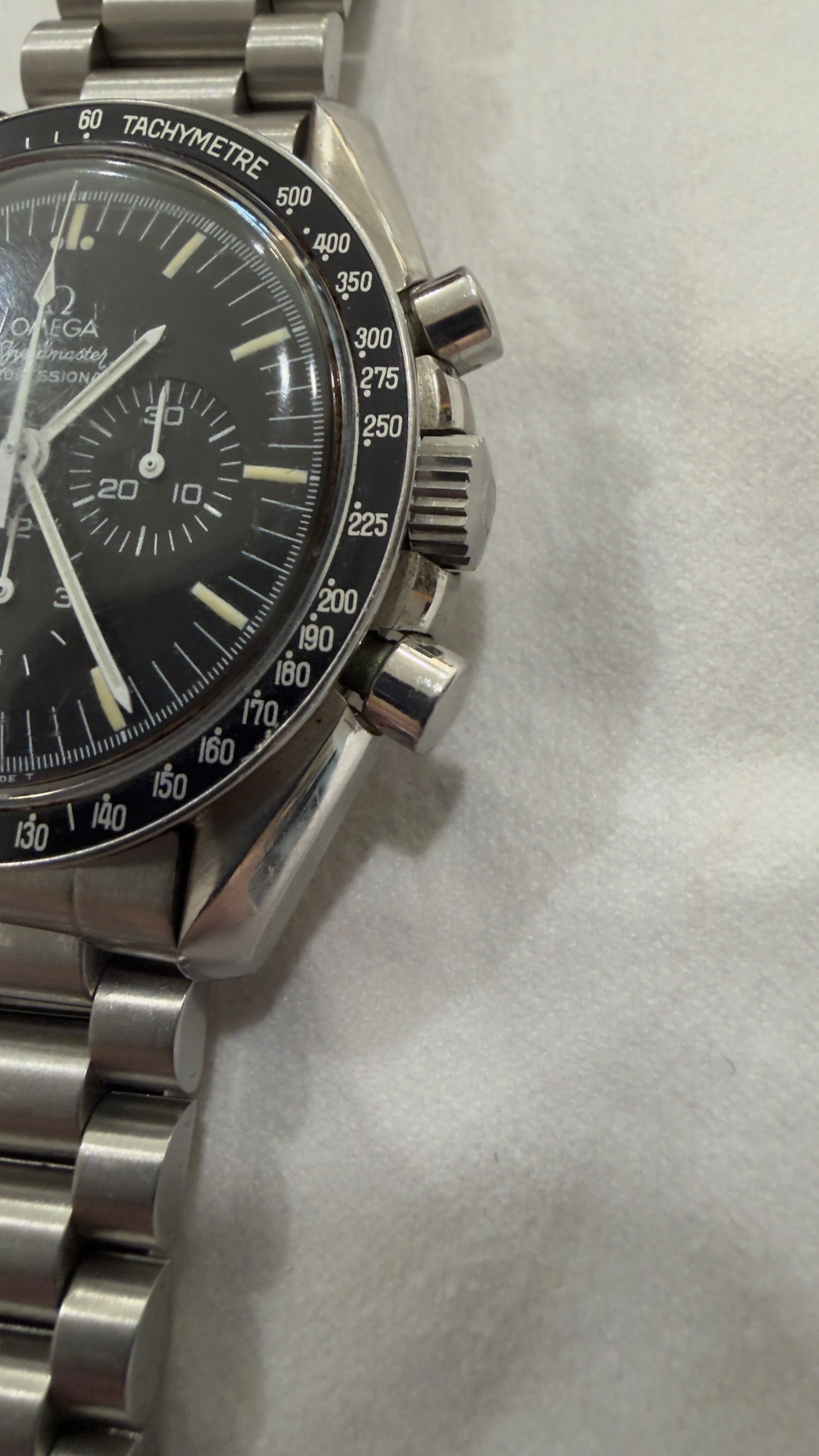

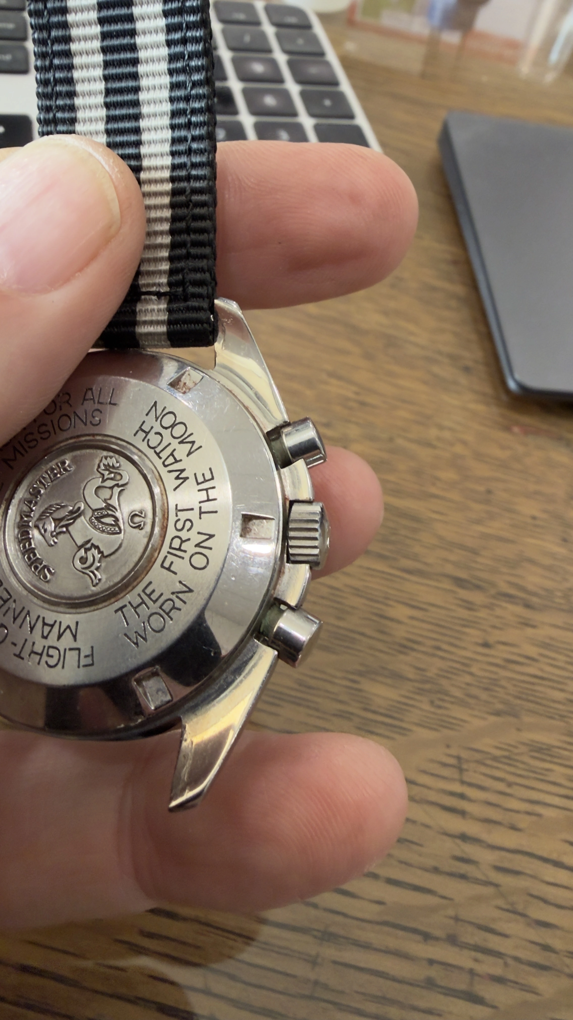

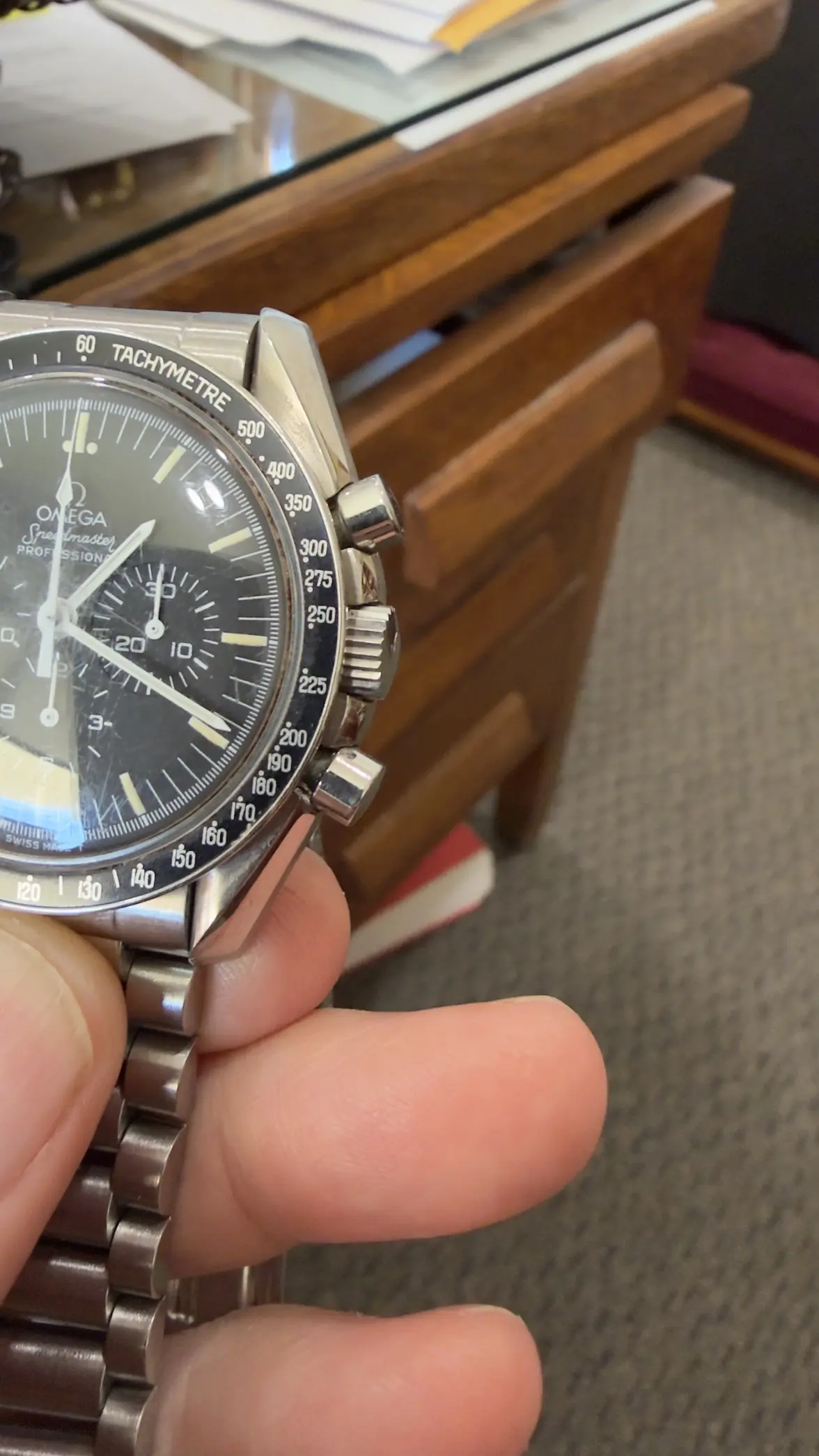

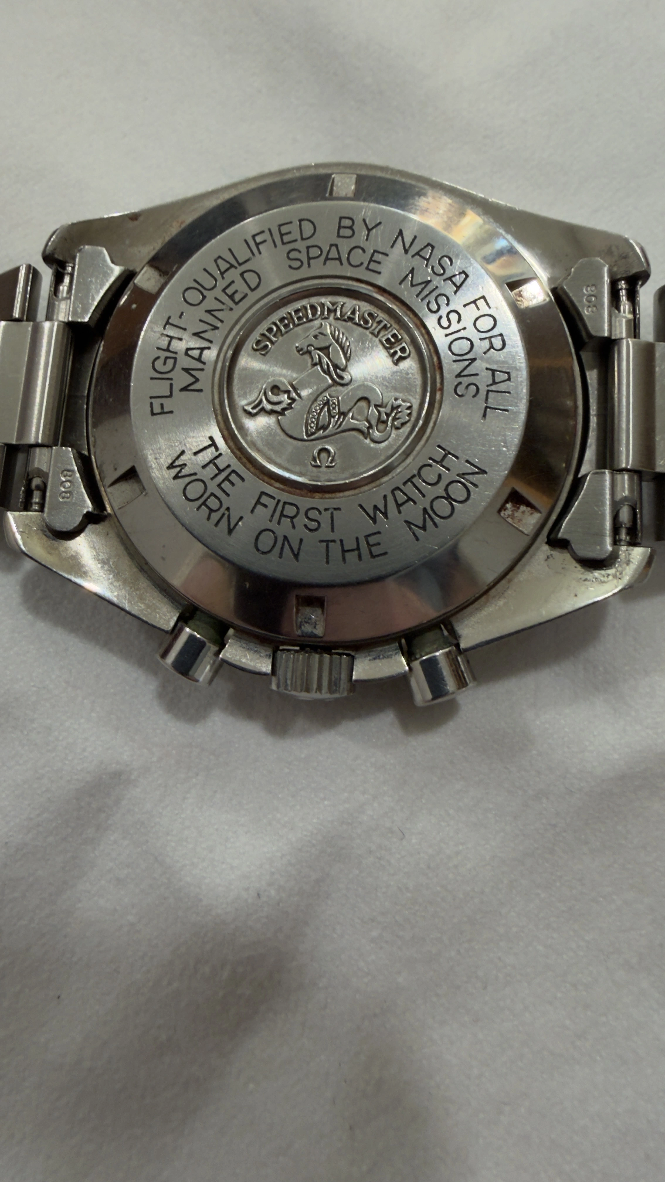

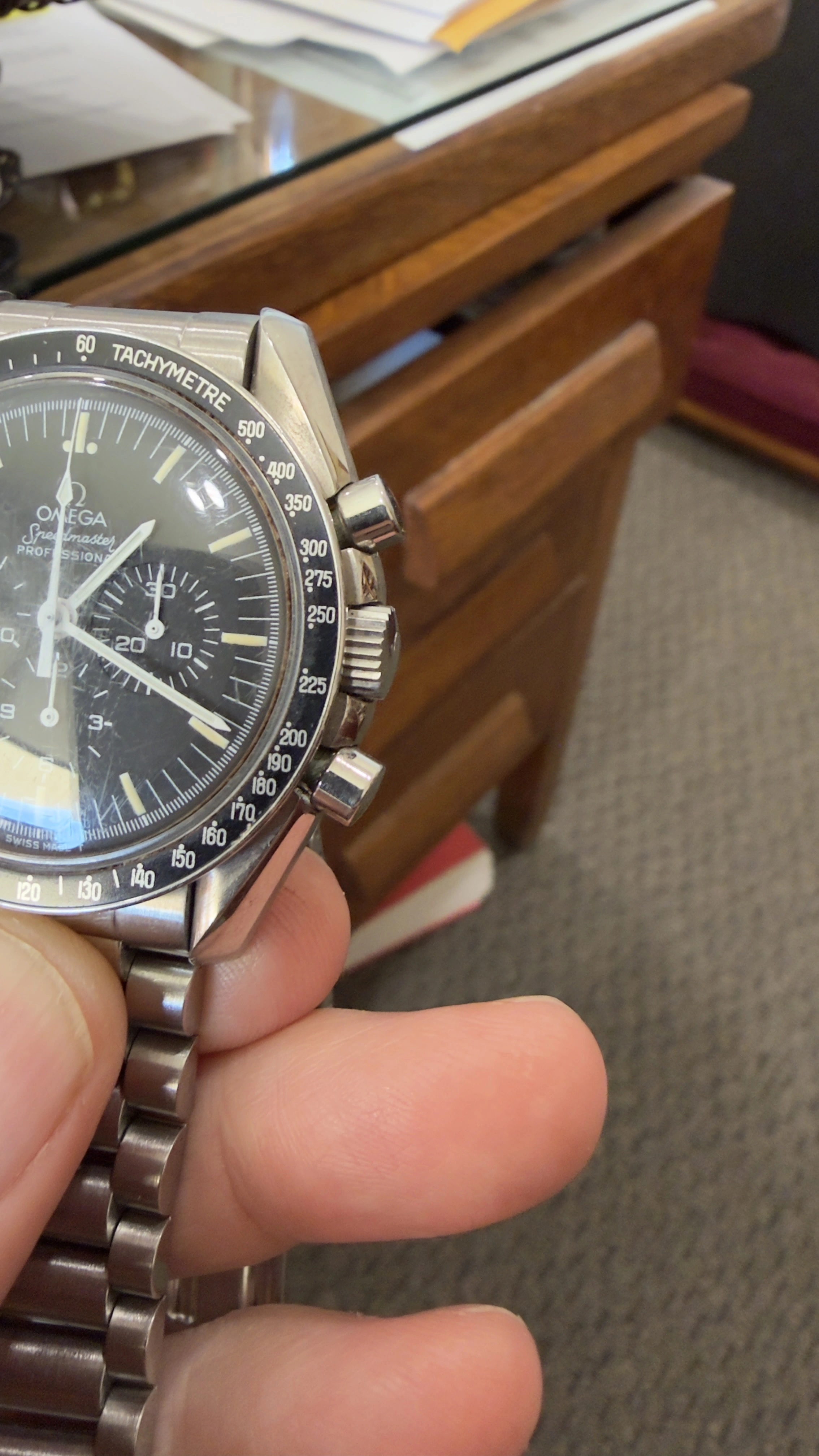

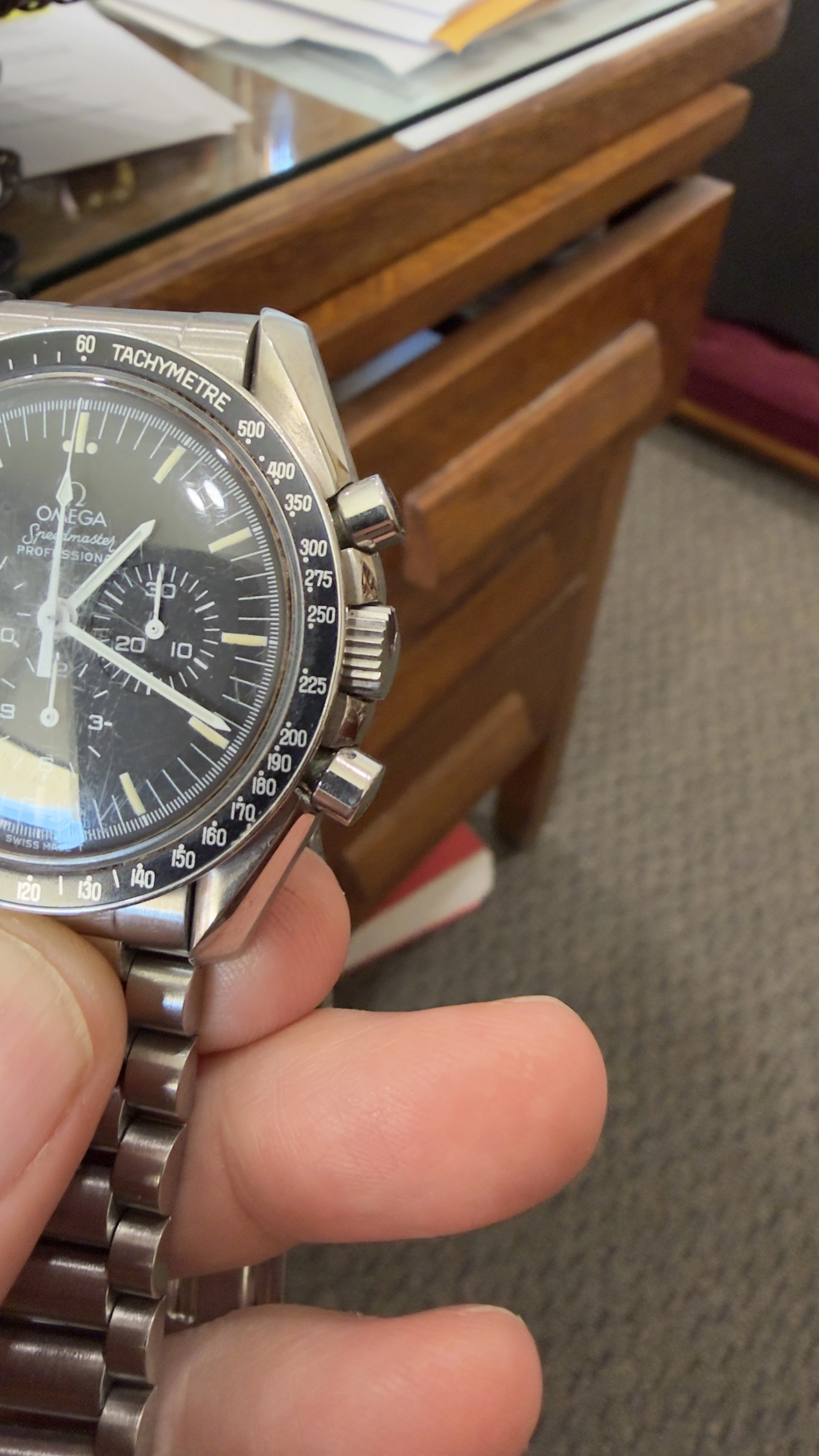

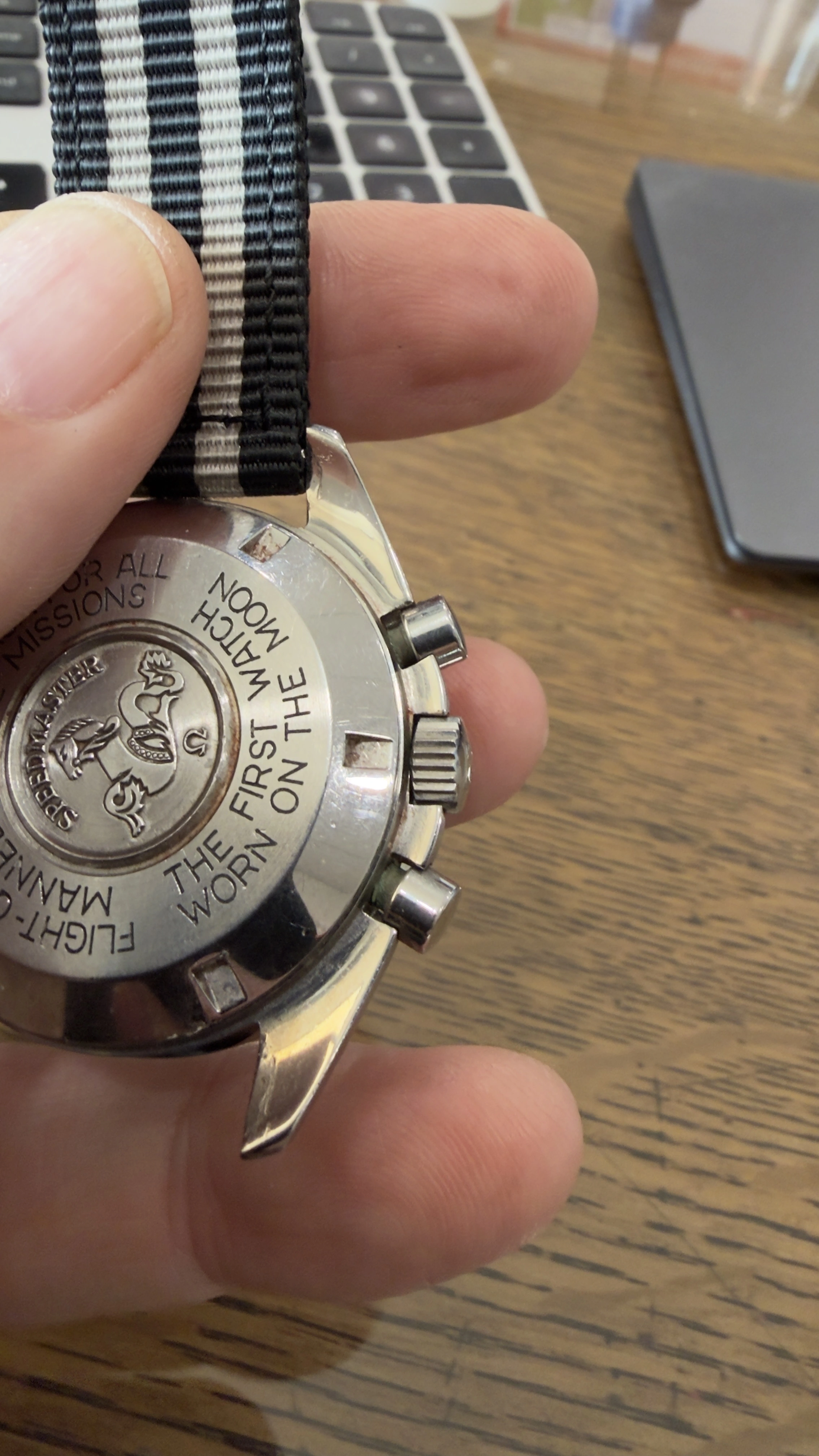

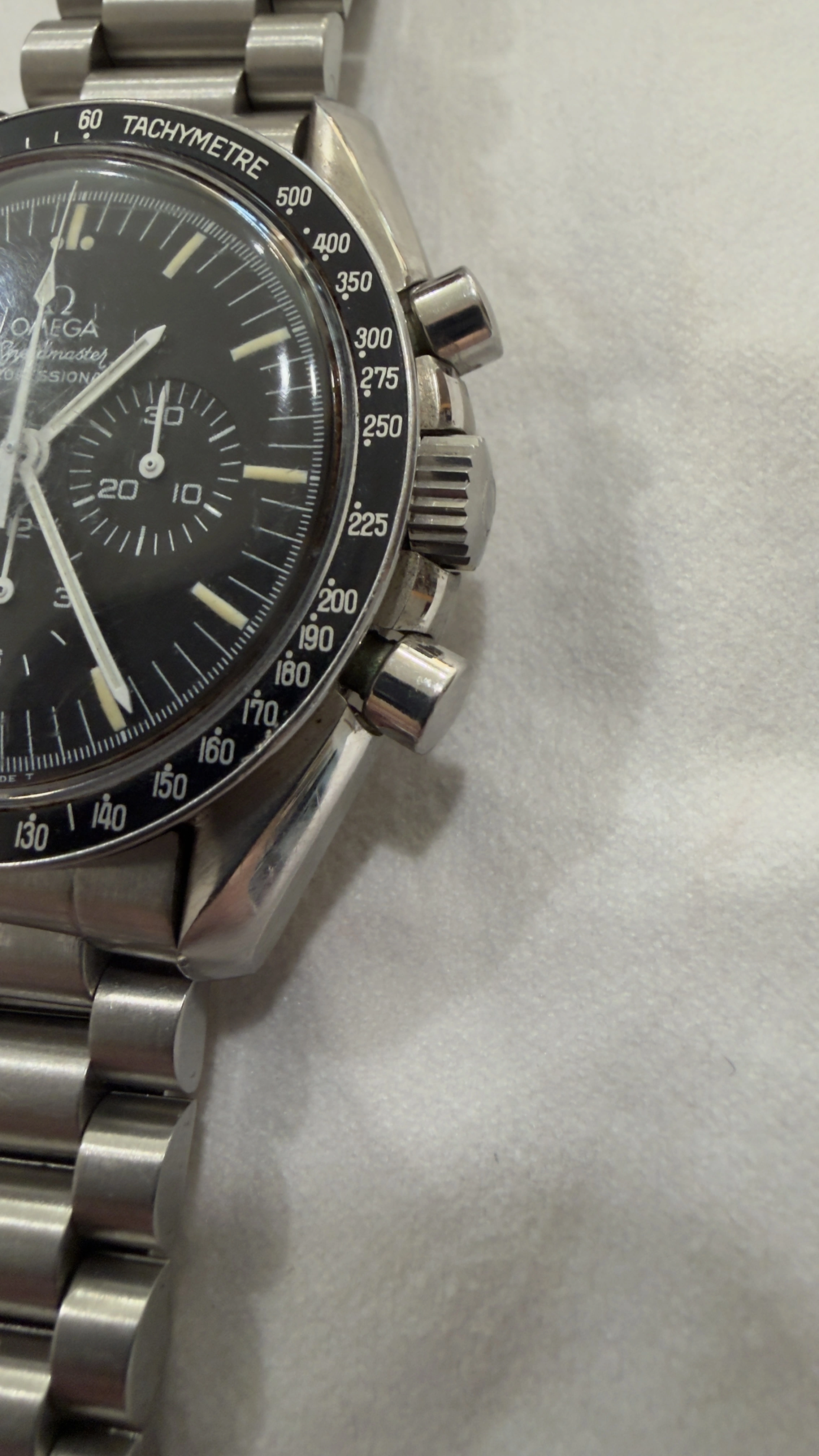

I picked this up and noticed the bottom pusher seems a bit more stuck out. Does this look like it to you?
What would you do?
24,836
55,255
You should have it tightened by a watchmaker. The cap is coming unscrewed.
30,270
78,120
Yep - movement needs to come out and then the screw can be tightened.

Years ago I removed a movement from a Mark 2 that had a broken crystal and glass floating around. It made me a bit nervous but I was successful. I actually put it back into another Mark 2 case for the time being. I am entertaining the idea of doing this myself but first I'll ask a local watchmaker whom I sort of trust. I don't know him well enough to really know. But I don't want to loose this!

I’d say that this something you can do yourself if you have some tools and you’re comfortable pulling the movement. It’s a fairly simple repair and something I’ve done on a couple of occasions.
If you don’t want to do it, I’d recommend putting the watch into a ziplock. The cap doesn’t look like it’s about to fall off, but why take chances.

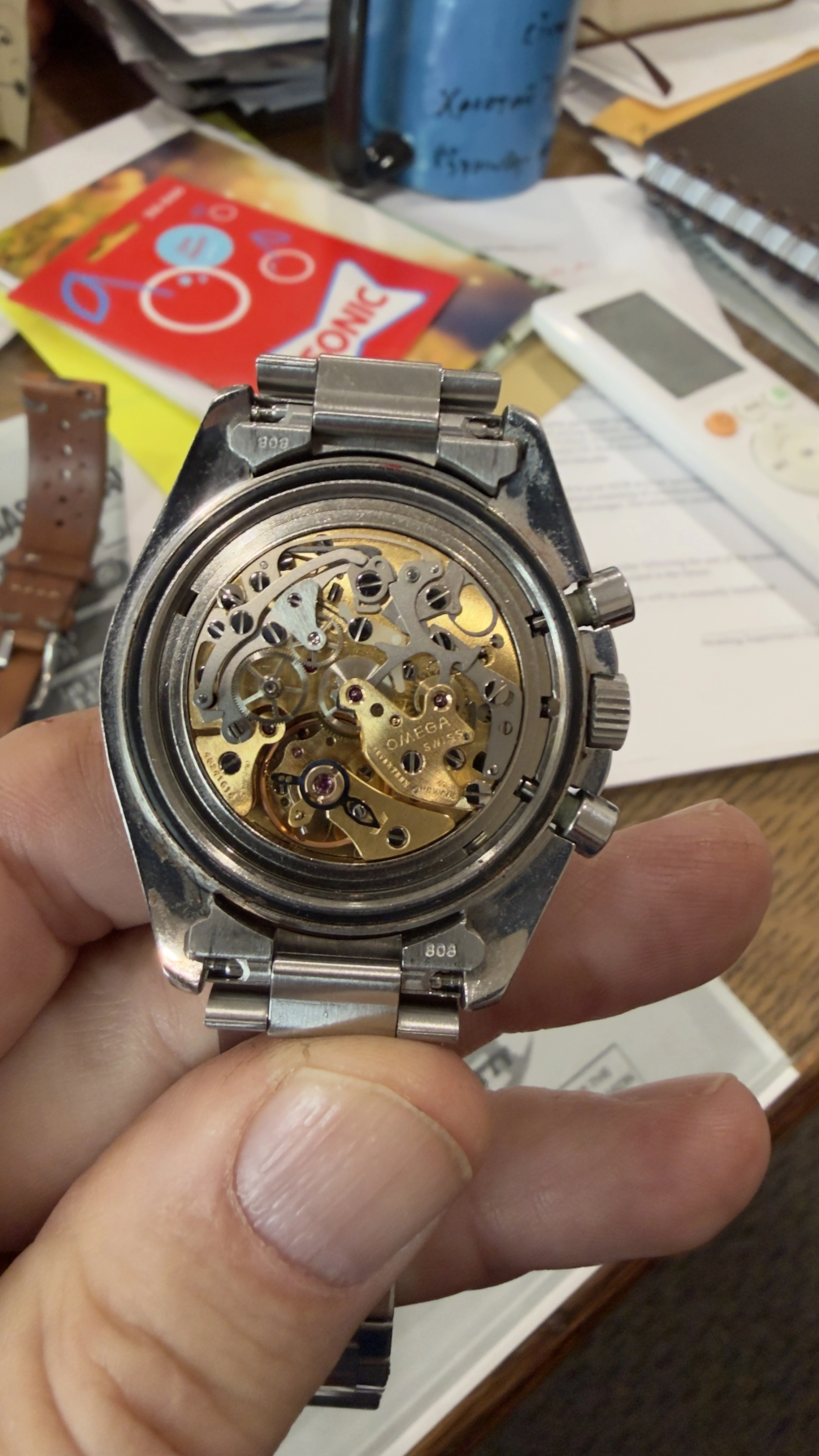

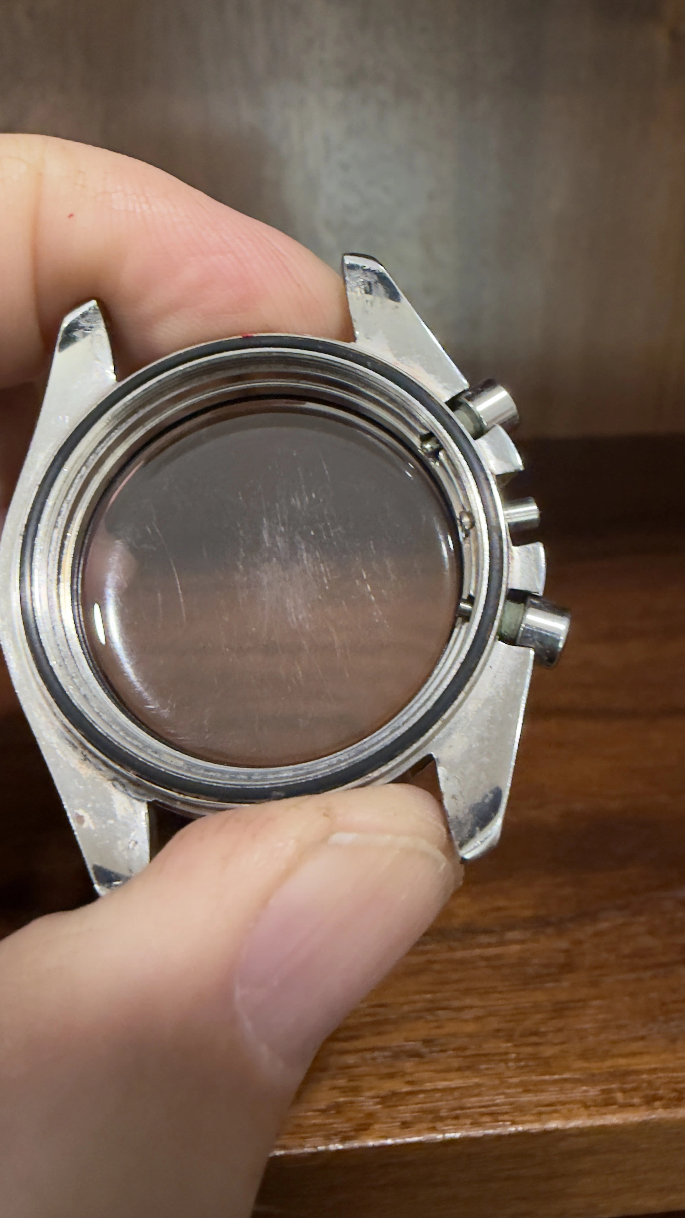

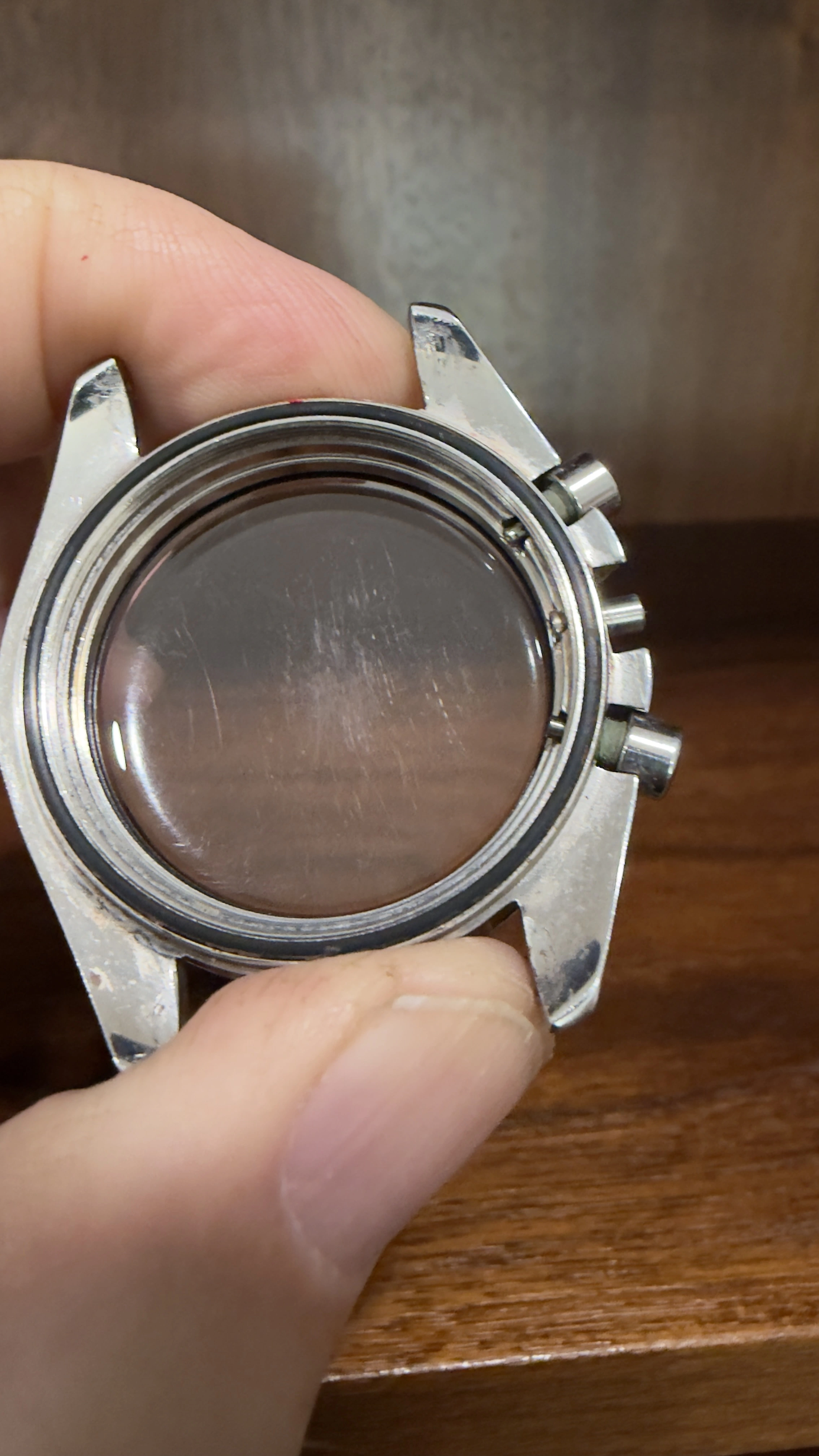

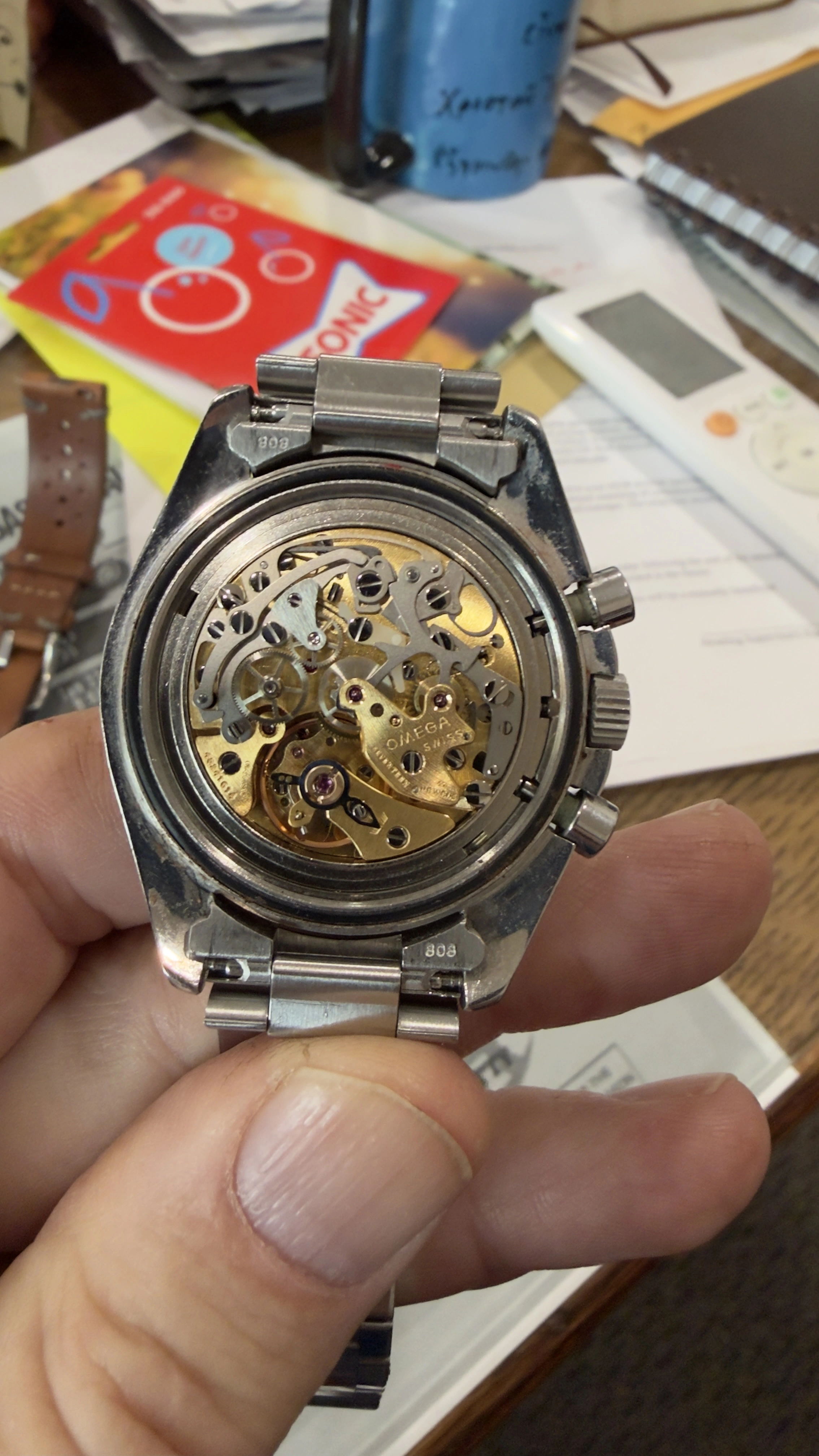

I ended up just doing it myself. Had sufficient tools and barely enough nerve. I will eventually be sending it in at some point for a service. I found some smudge marks on the inside of the middle case. Movement is beautiful. No marks before or after! The case gasket was ok but not super great.
