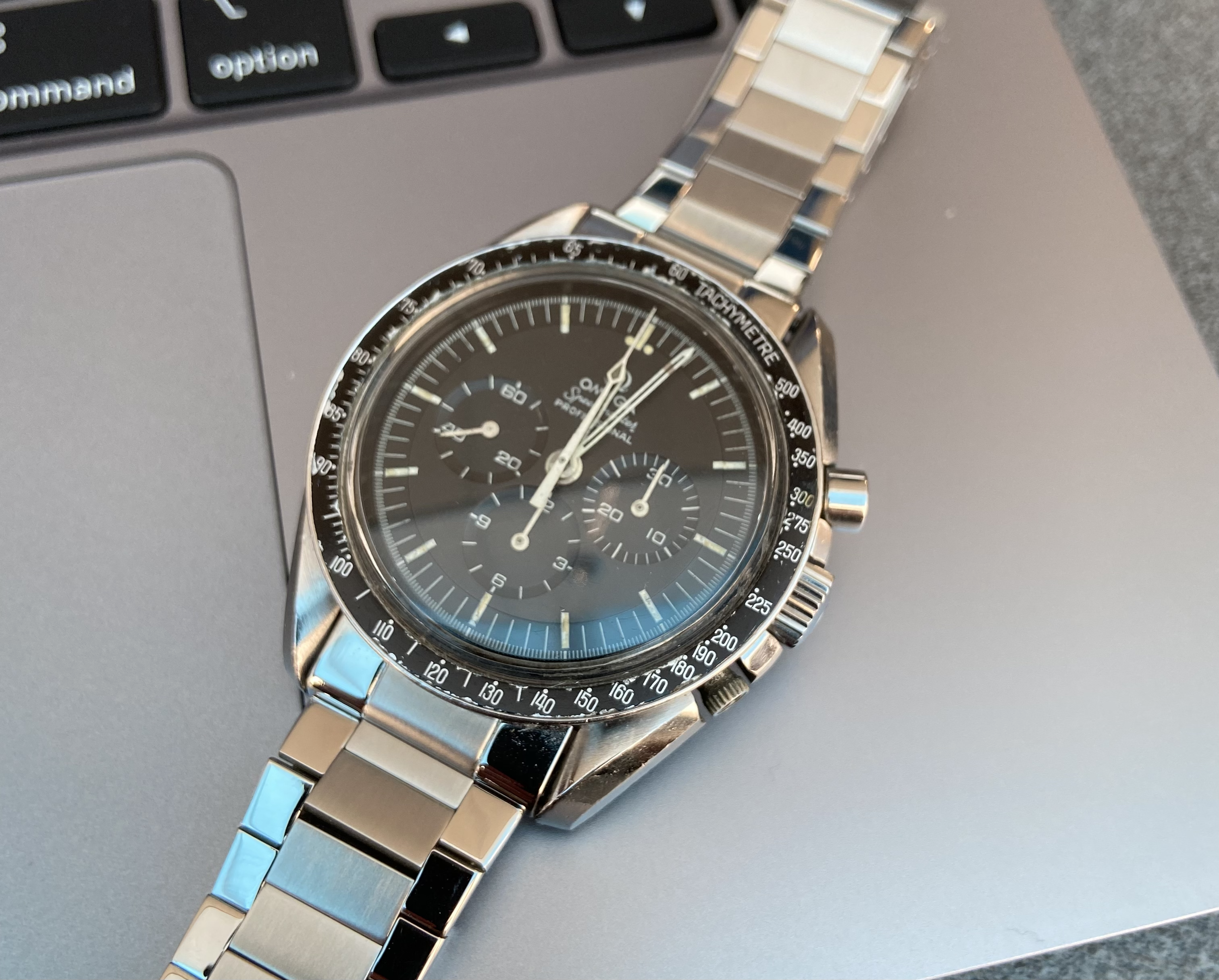

Hi all
I've lost the button from one of my pushers and wondered how difficult these are to replace. I'm sure the entire pusher should be replaced, but I've been unable to find a good explanation of the method. I know they screw in on a 69, but do you need a special tool? I'll take it to a pro if this is way beyond a novice. I would be very grateful of any advice.
Those with sharp eyes will notice this has a sapphire crystal fitted (as I bought it).
Thanks
Jim
