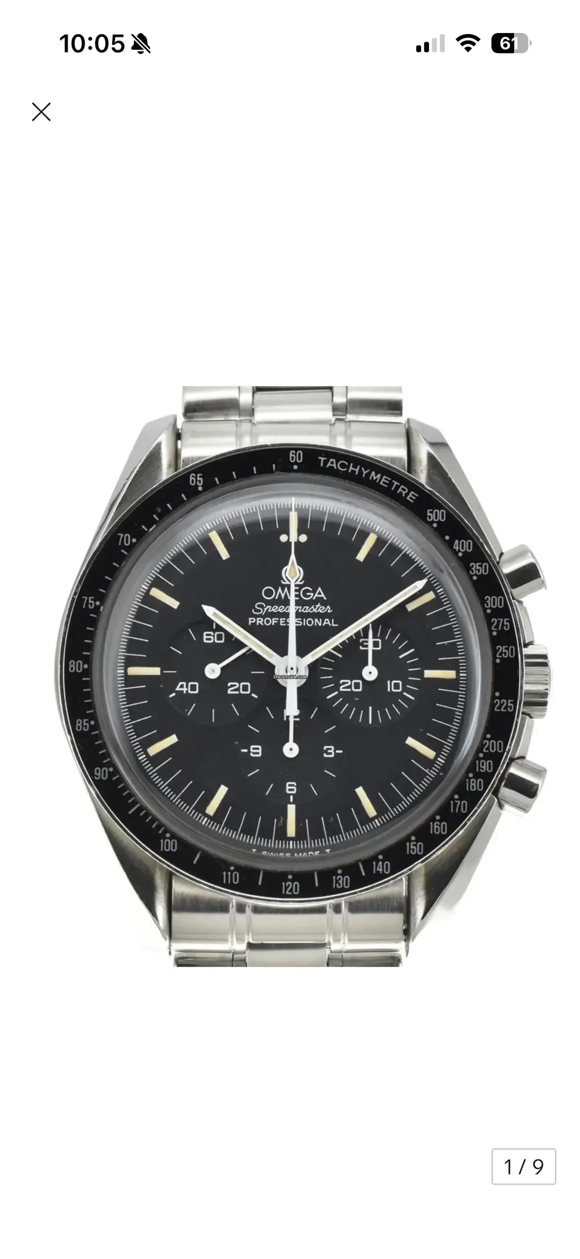

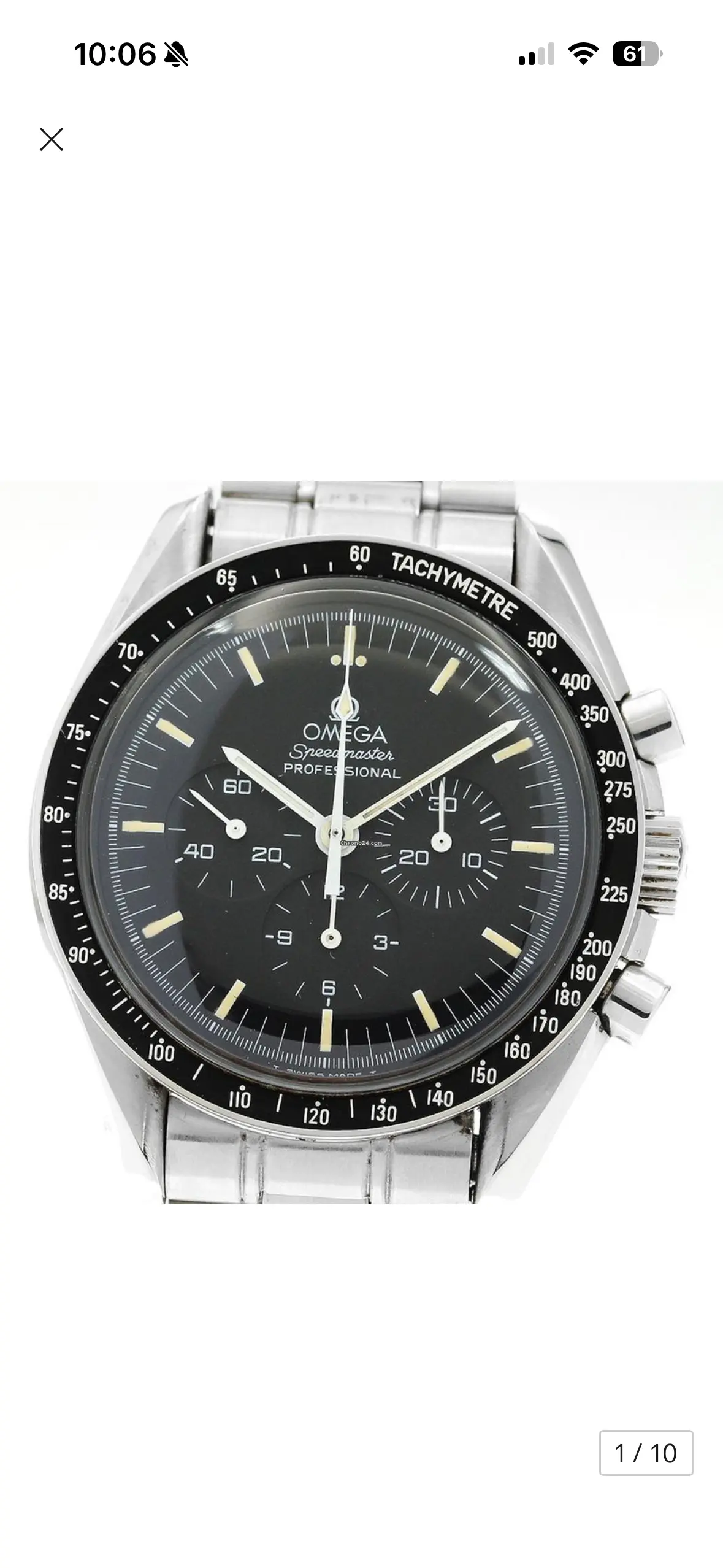

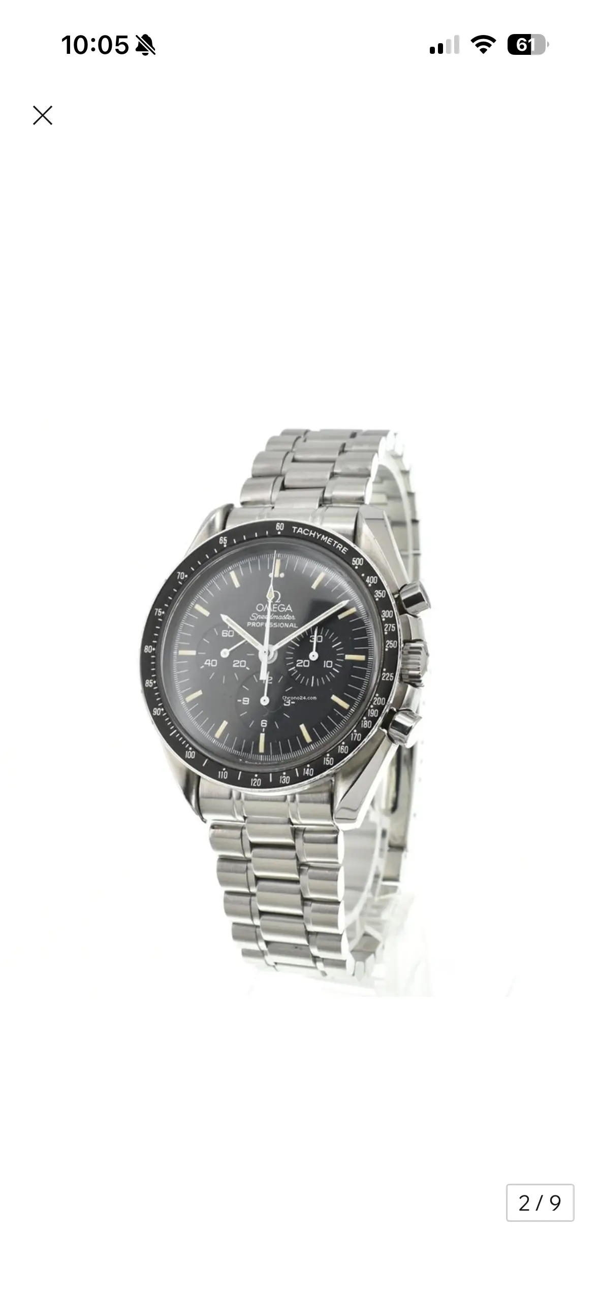

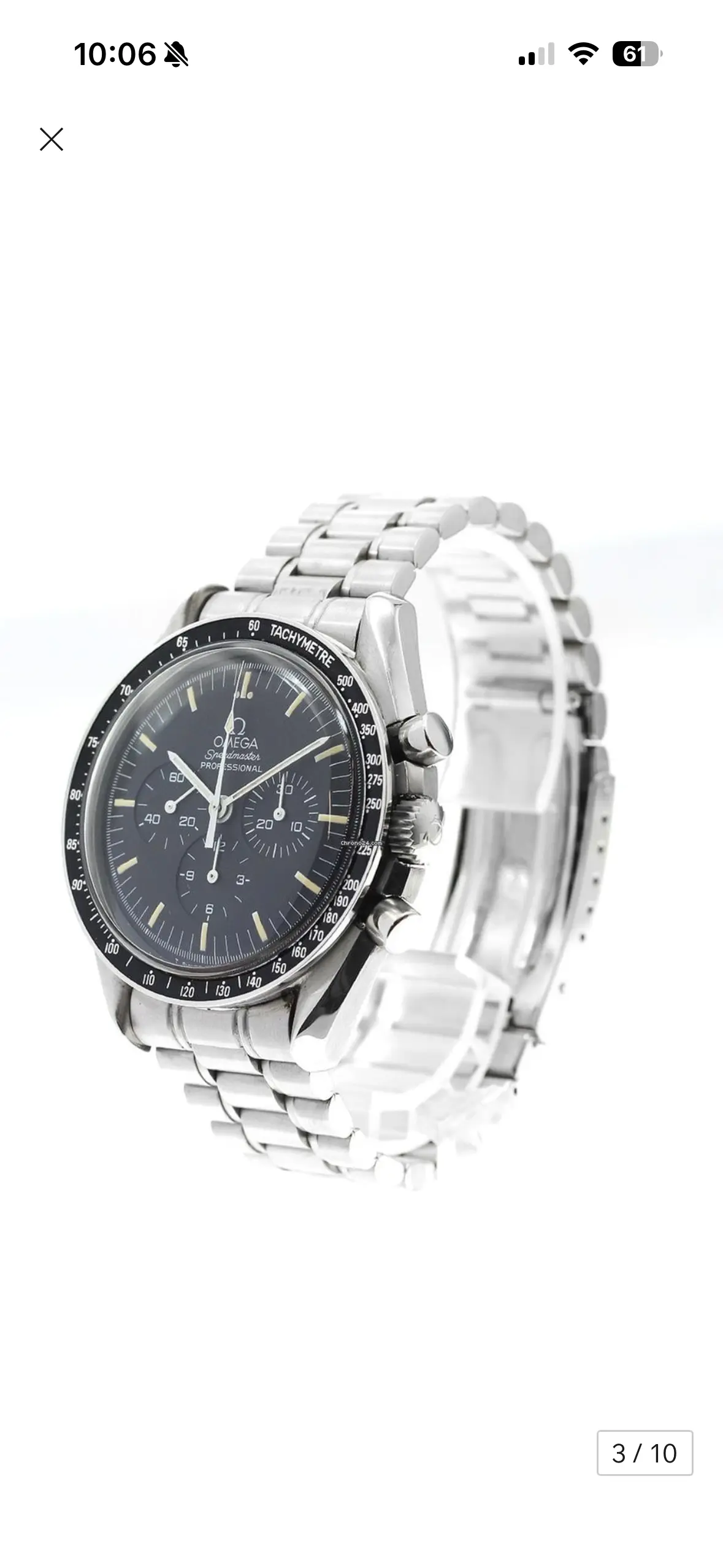

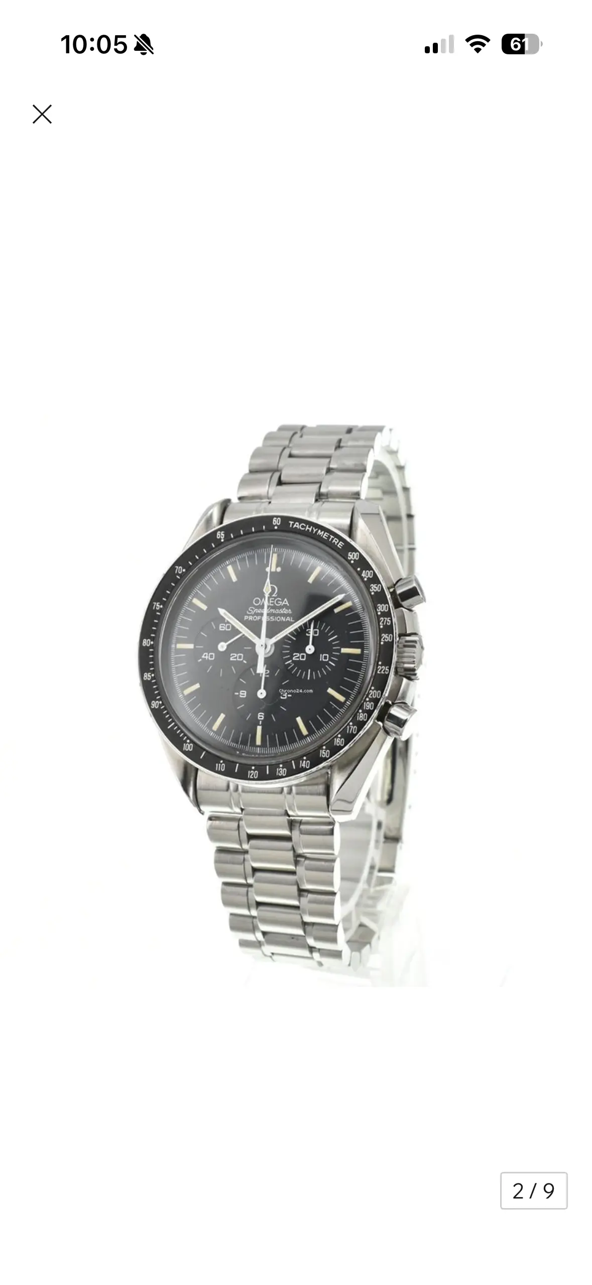

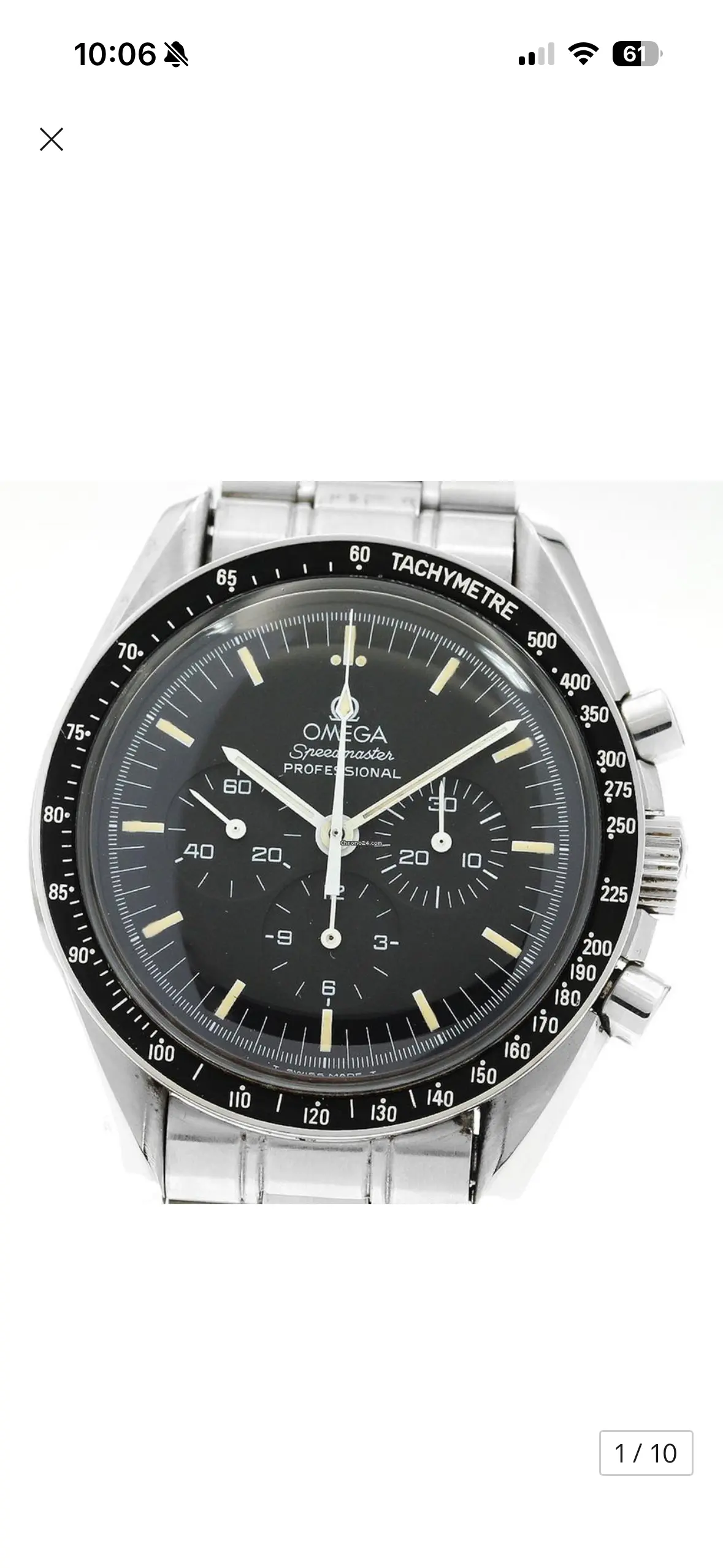

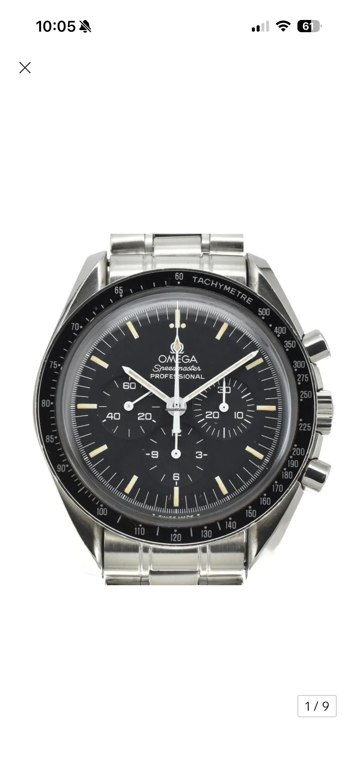

Does anyone have experience with the larger Japanese sellers on Chrono24 e.g. Closer, aonohappa? They have a lot of positive feedback, but of course some bad is thrown in as well. They seem to have a lot of Speedmasters coming up for sale consistently.
In many cases I am finding it a bit hard to judge the condition of the case and dial from the pictures they provide.
For example my assessment of the condition of these two watches correct? If they don’t include a picture of the movement is that a bad sign?
Watch 1
My assessment is that the case has been polished but appears to be fairly sharp still.
The tritium on the dial and hands looks quite nice, but a fair amount has turned dusty.
The bracelet looks correct.
Watch 2
Hands not as nice as watch 1. Some discolouration.
Ends links on strap don’t seem correct?
Case itself is similar to watch 1?
