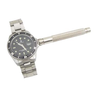

I've done some site and web searches on this, and have experimented with several of the techniques recommended (winding it from below, using the index finger to 'spin' the crown, etc). I've also looked at some tools designed for this purpose:
I'm wondering if anyone here has experience with such a solution, or if there are any other suggestions for easing the process. I am otherwise very happy with the watch, and have no desire to replace it, but I would like to enjoy rather than endure the daily ritual of winding.

My Speedmaster is a little bit challenging to wind up, and I've got tiny fingers and no real digital impairment, so I can understand the OP's pain. That tool for the Tudor (I think that's what that is) is a neat idea, and I imagine that once you figure out how to make it, get the tooling done and all to fit the Omega, you'll have invested thousands of dollars for something that will sell for $9.95. But you'll be able to sell hundreds of them...

Like you, I also have some nerve damage to my right hand and find winding the Speedmaster Professional with it's crown guards somewhat difficult. There are some Bergeon crown winding assist tools shown on the Otto Frei site. The size of my current Speedy Pro crown is 6.51mm, so check the sizes. I have some question if these tools would have enough crown to "grab" due to the guards. My Speedmaster is manageable if I do it daily and use my fingertips. I've had it since July and it has gotten easier over time. I try to faithfully wind it every morning when I get up, I think of it as my daily " bonding time" with my favorite watch.

The crown guards are the reason I'm thinking a crown winding tool isn't useful, I have also tested speedy 1861 movement at the AD which was much more easier to wind.

I don’t have issues winding any of my watches, but my wife’s Deville prestige has a 4mm crown that destroys my fingers. She usually wears it every day so I don’t have to wind it, but she always forgets on the weekends to stick on the winder. So Monday morning I’m winding it. I use that tool in the picture and it’s fantastic. Her watch is rose gold and zero scratches from the tool.

Thanks all for your observations and suggestions. I will keep at it, and will also pick up a tool to try just in case. If things don't improve I'll also look into some additional lubrication for the crown stem. I feel like the additional torque that is generated by a popped-out screw-down crown a la Seamaster might have been helpful in this design, but I get why that might have presented additional difficulties/problems. And I'm guessing that duffers with hands like mine never sniffed astronaut school.
