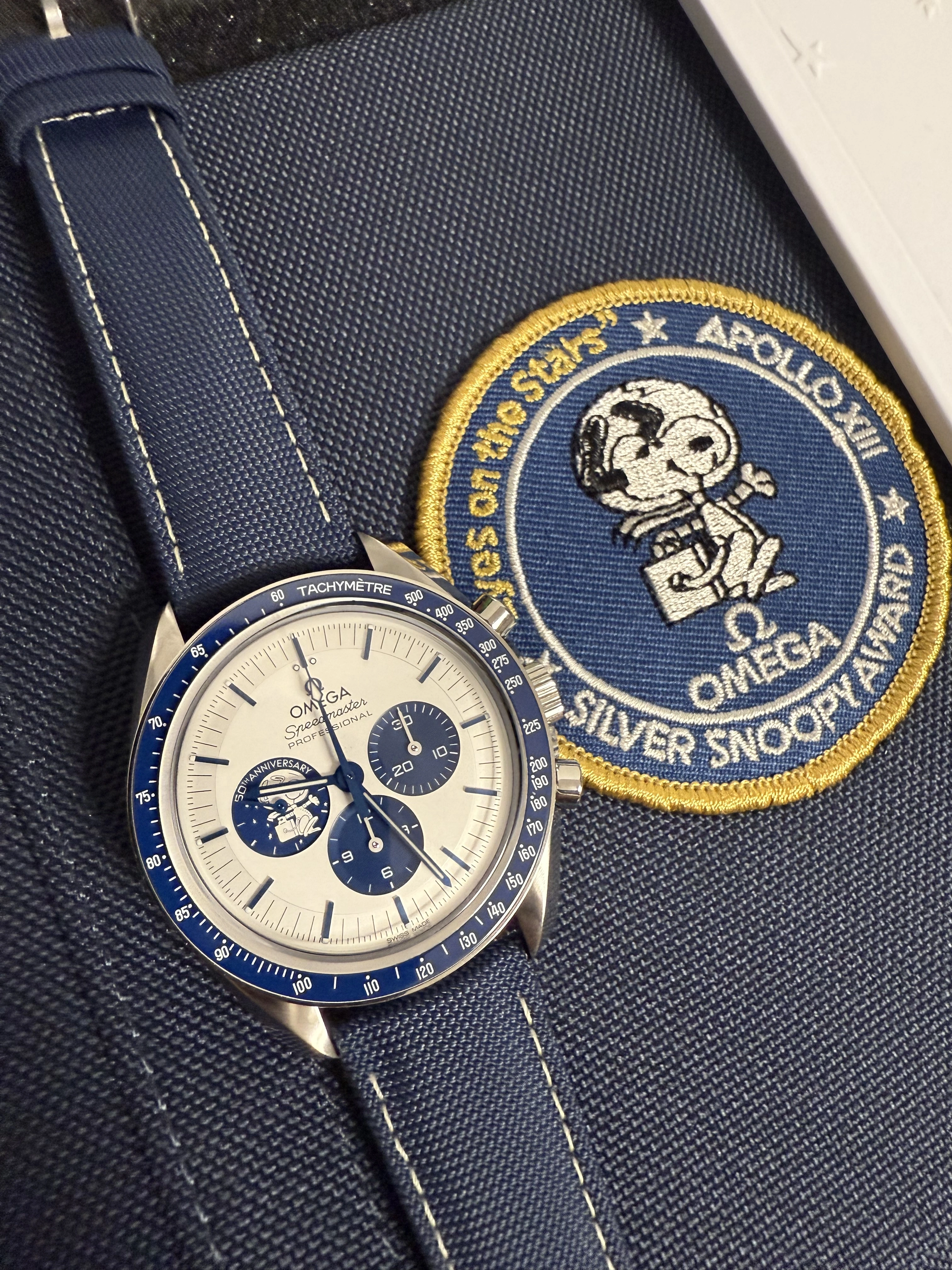

Hi, after 4 years waiting, I finally get the lovely snoopy. But yesterday when I first time winded it, the watch seems like strange. I winded the crown CW until the end, rebound happened, then I stopped. Until now, already 24h, I can still not wind it, rebound still there(full winding situation?) is this because full winding? And how long this full winding will keep? Or I have to contact service? I can sure I was really carefully winded it.
Thanks in advance!

And you need to post pictures. Everyone here likes Snoopys.
