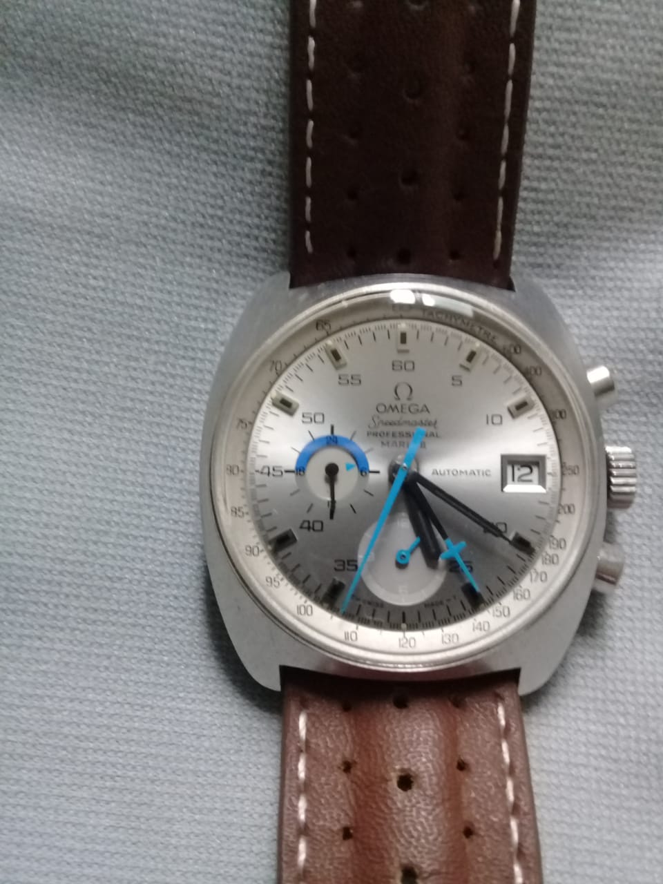

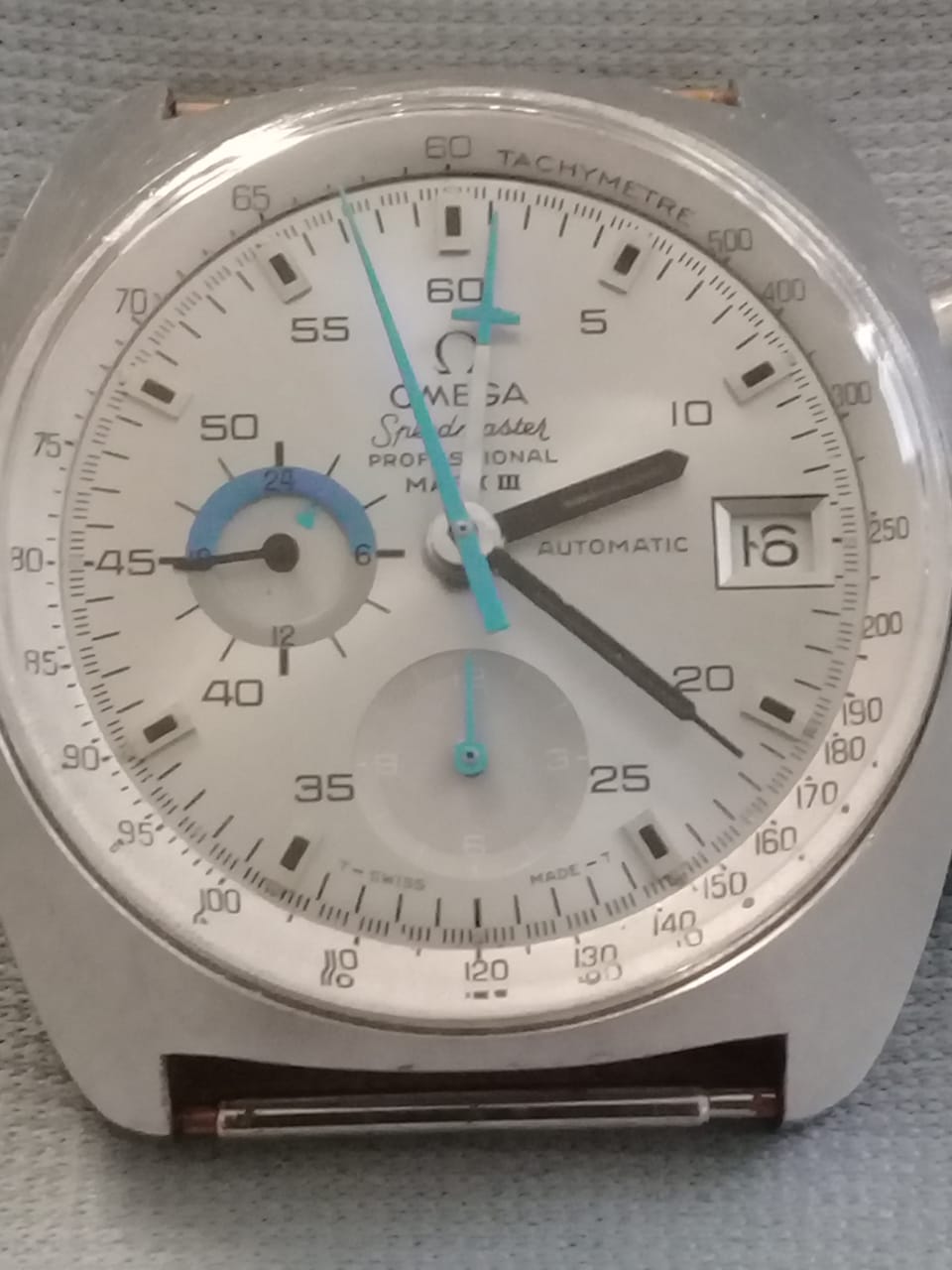

Hi guys,

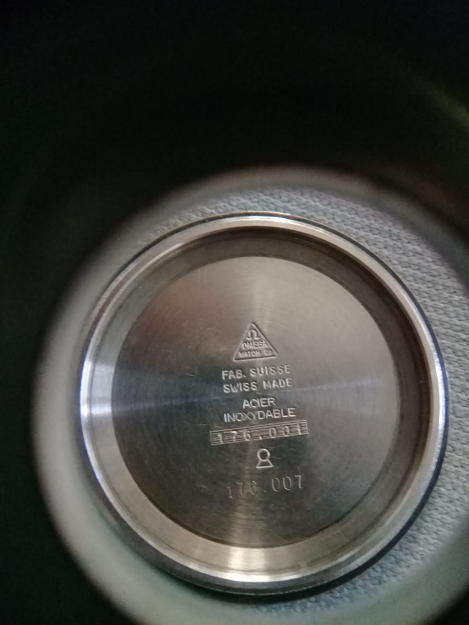

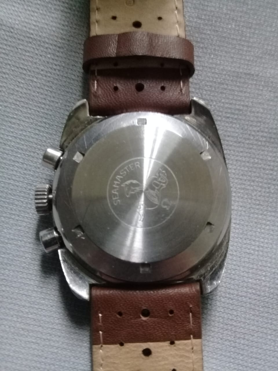

I was offered this Speedmaster Mark III, but there is an inconsistency I detected: the Mark III shouldn't come with this case, but rather with the beefy Jedi one. The movement is cal. 1040. My guess here is that the dial and movement are correct for 176.002. Very strangely, on the caseback the engraved 176.001 is scratched and there is a second engraving below 176.007.My research shows that this ref. corresponds to a Seamaster (no Mark III on the dial), case is cushion indeed...

Yeah, looks like a Mark III dial put into a Seamaster 1040 case.

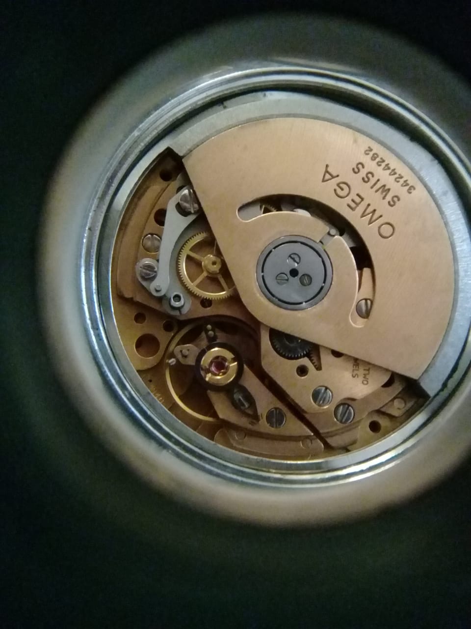

It also seems that there is some oxidation in the lower right side of the movement (4th photo), which could explain why the dial was replaced (i.e. water damaged the original dial).

Hi @banshee, there are people out there that believe that Omega made Speedmaster Mark IIIs in this configuration (ref. 176.007) but I'm not one of them. As @valkyrie_rider said, I think this is a frankenwatch that should have a Seamaster dial.

Thank you for the input guys! Indeed, I'm inclined to the theory that it was a Mark III with very damaged case (those large cases get bumped up a lot) and later the dial and movement fitted to a Seamaster 176.007 case.
What's your opinion on the caseback: scratched ref. 176.001 and the 176.007 engraved below? Someone told me that's something Omega did in the factory back in the day.
This is pretty common for the earlier 176.007s. Omega discontinued the 176.001 pretty quickly after they started production and repurposed the casebacks.
