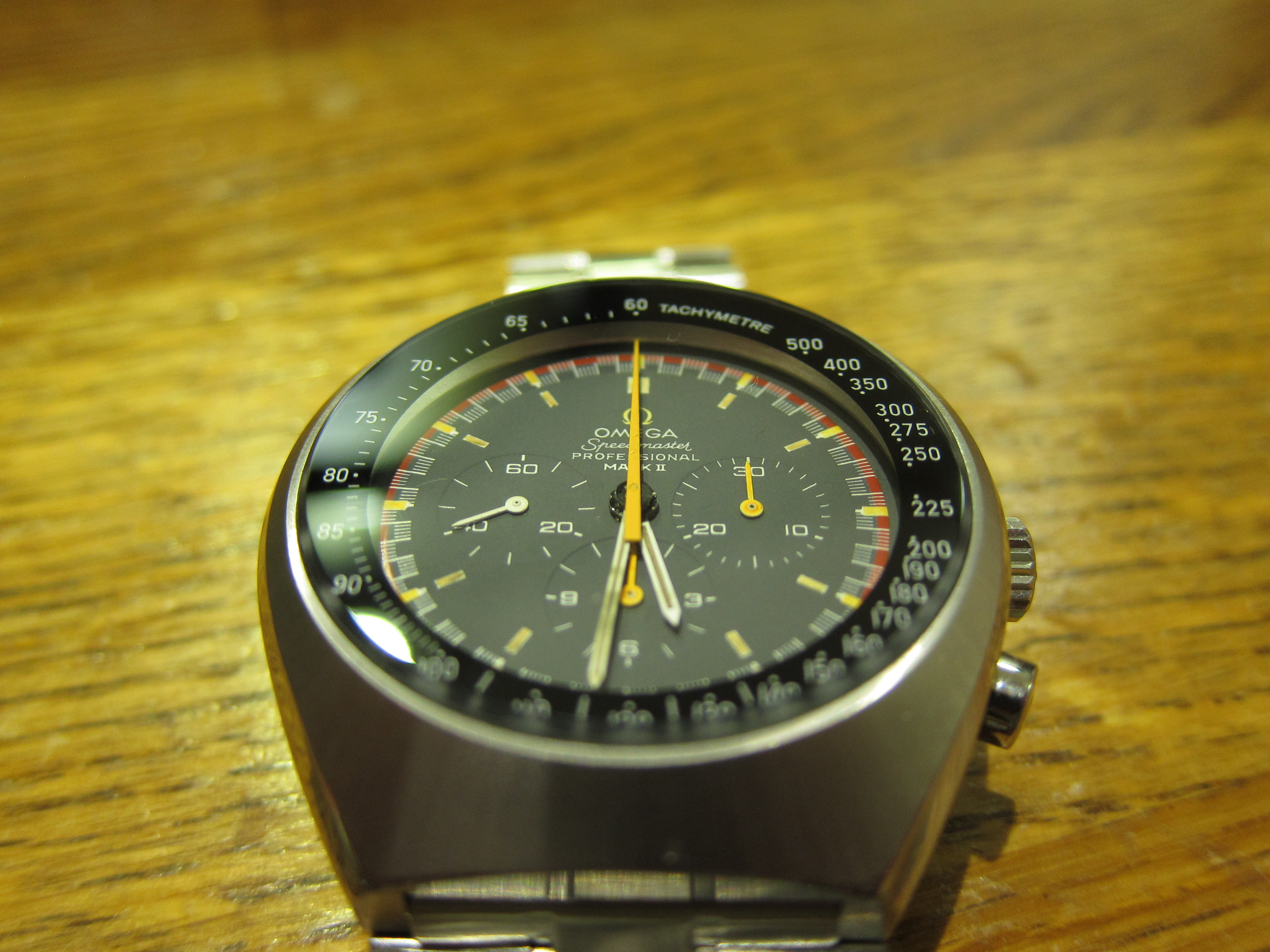

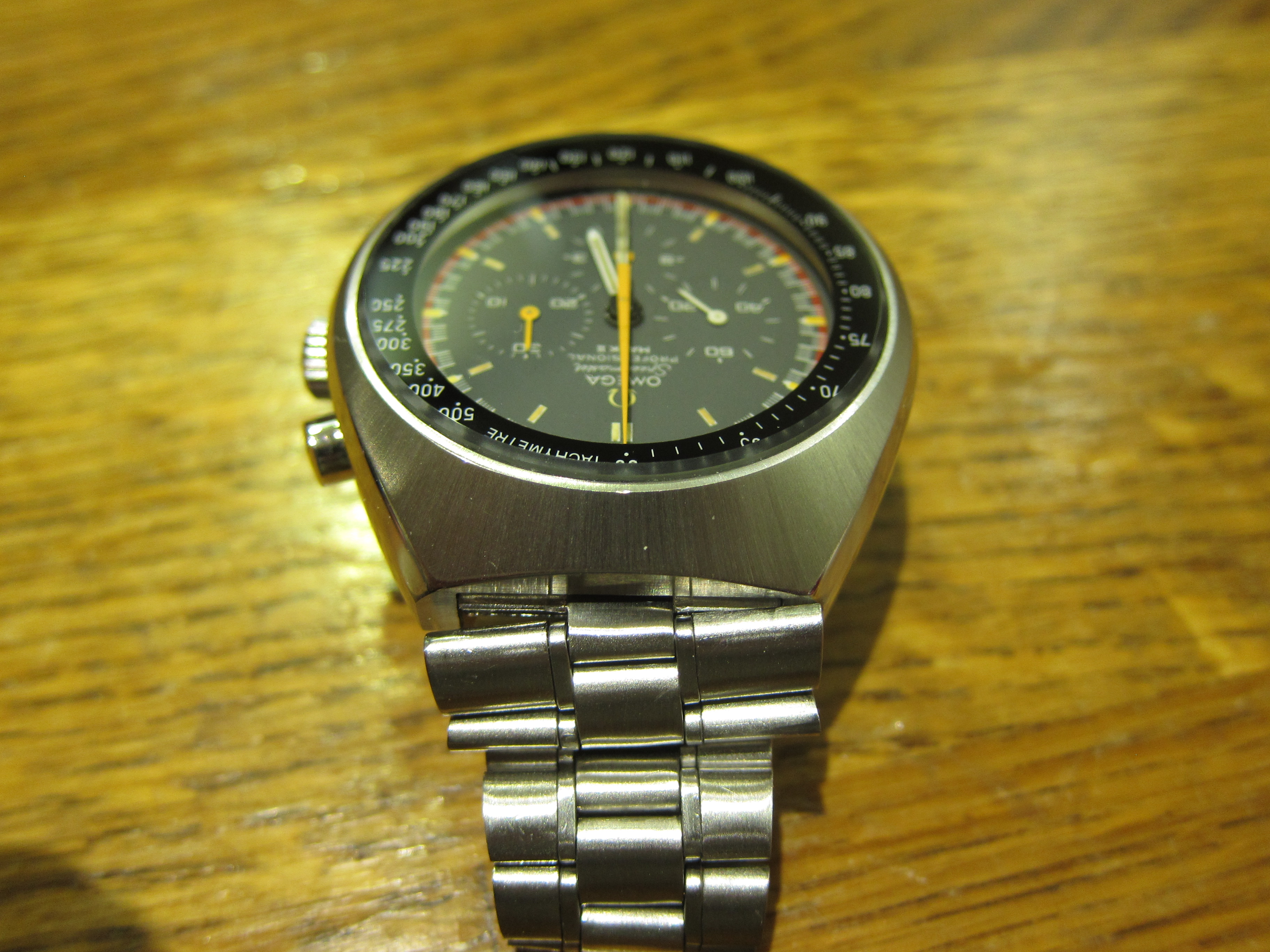

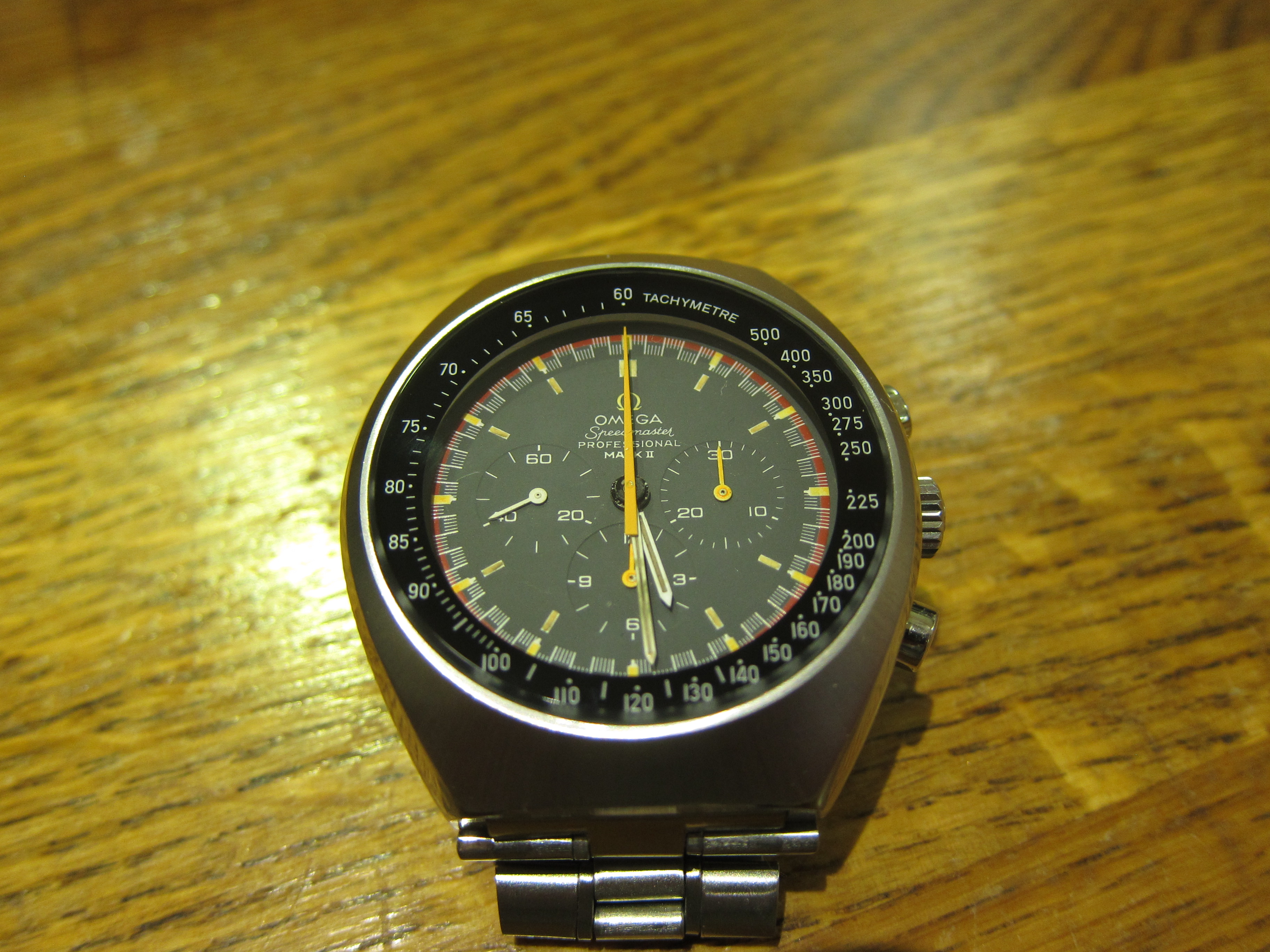

The only small issue that i'm not entirely happy with after coming back from STS is that when the sweeping hand is returned/reset it's not sitting 100% lined up between the twin marks of the 12 on the dial (seems to sit fine on the tachy ring - it's as if the dial is a fraction off centre/about 1/2 a degree clockwise... in the square on pic above it's been started and stopped about 1/2 a second simply to satisfy my OCD!
(I'll speak to STS on Monday and have a chat about if it can be resolved) or am I being too picky to expect a 40+ year old chrono to perform like a modern piece even after a service?

Hi D4uk, i don't think you are being too picky, all at the 12 o/c position doesnt look aligned, and it seemed to be aligned in the "before" pictures, so maybe the dial hasnt been put back properly?
I,m sure most of us on here couldnt live with that either !
Cheers, paul

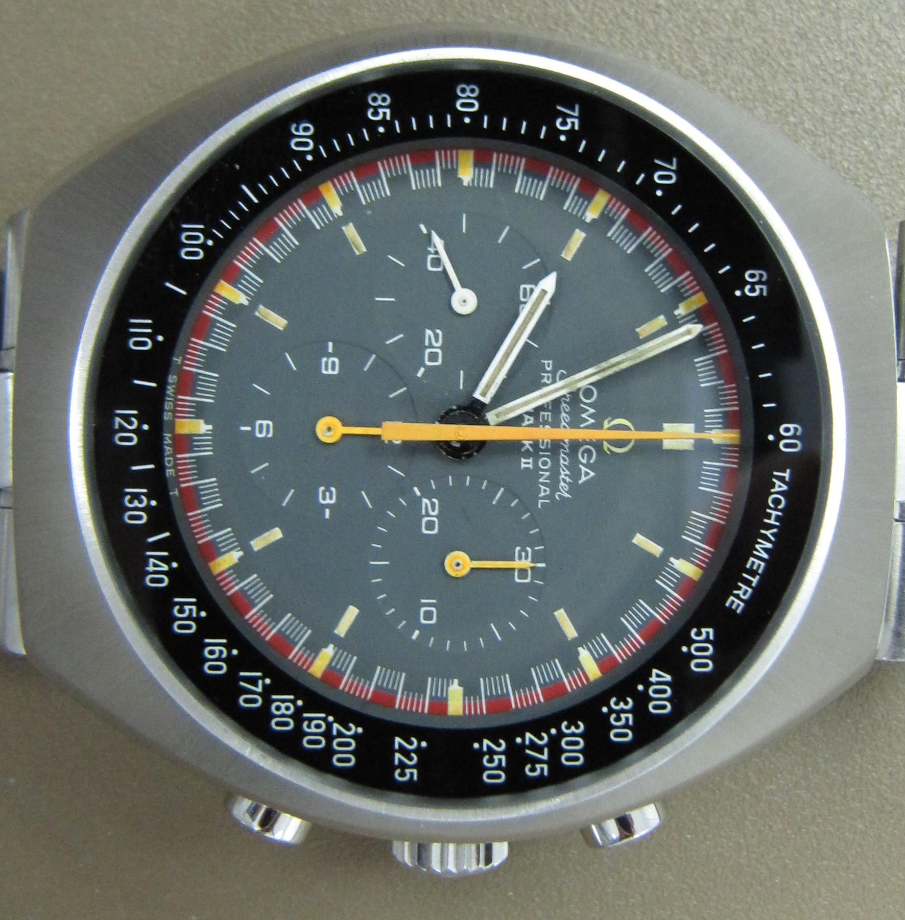

here are a few pics to show you want i mean... I'm thinking the dial is about 1 degree off clockwise (ie: it needs to come 0.5-1 degree counter clockwise...) might be less as the min sub dial hand looks off too... but it will naturally look more off at the tip of the Sweeping hand as it's furthest from the centre.
thoughts? I only got it back yesterday so not had a chance to speak to STS yet...

I would actually say that all of the chronograph parts are not properly installed. The only immovable part is the dial itself.
The hour counter is the furthest out and if you look at the base of the second hand, that is out by half its width comparing it against the "12" marker on the hour counter. The minute counter is also slightly out and the crystal (the tachy ring is stuck onto the bottom of the crystal) is also out of alignment.
If I had to guess, I would say that someone put the hands on badly, cased the movement without looking at it properly and then they lined the tachy ring up with the sweep hand when they put in the crystal.

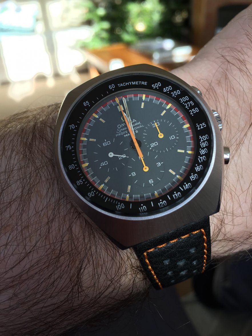

well i must say i'm very happy wit the service from STS - emailed them and advised o the issues, posted the watch back to them at my expense and had another in-depth call once they received the watch.
They then undertook all the revisions and sent pics in advance of returning it to make sure I was happy..
needless to say I was and to top it all when I got the watch back - attached was a cheque to refund my expenses for returning the watch to them.

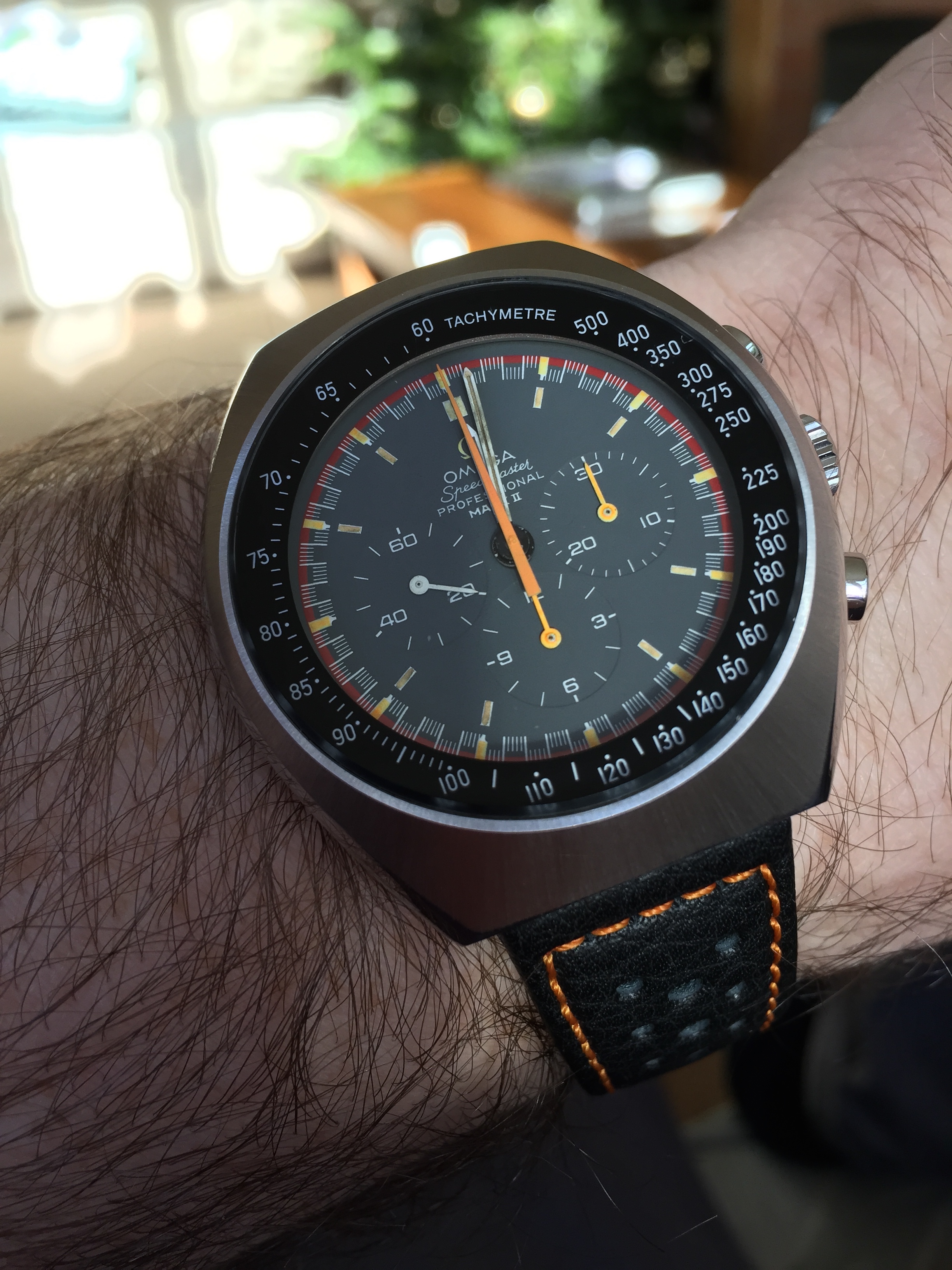

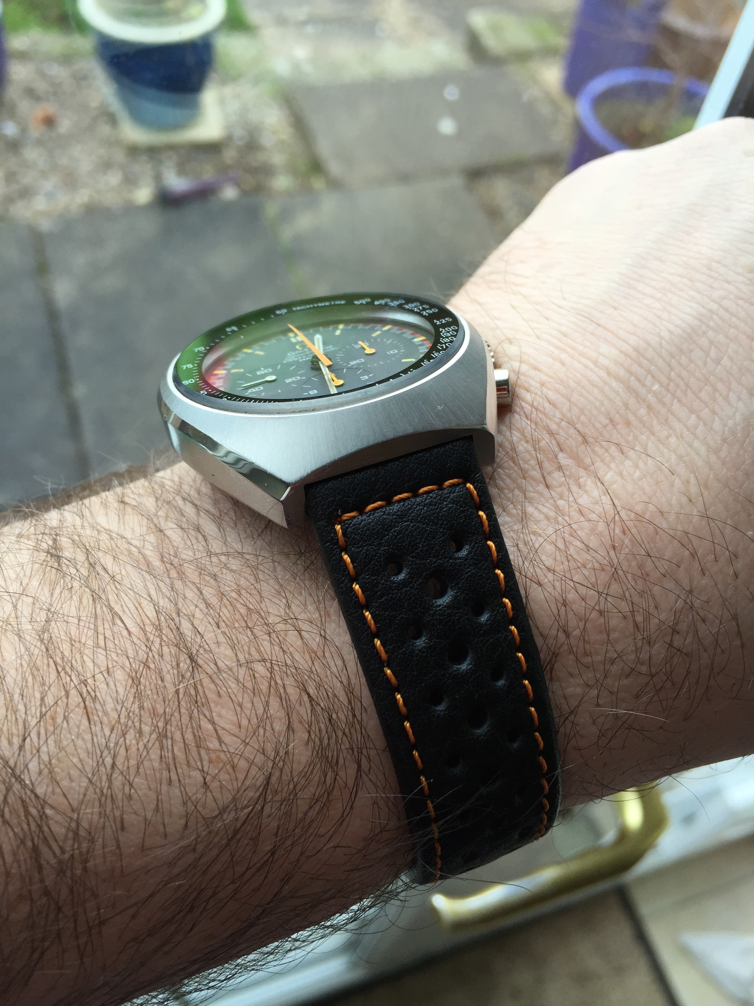

Hope you agree that it now looks spot on.. I'm waiting to collect my new (1162/173) steel bracelet from my AD so in the meantime have put it on a leather strap - which I really like (recommended by Tony on Turf)

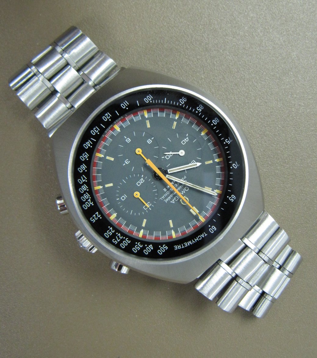

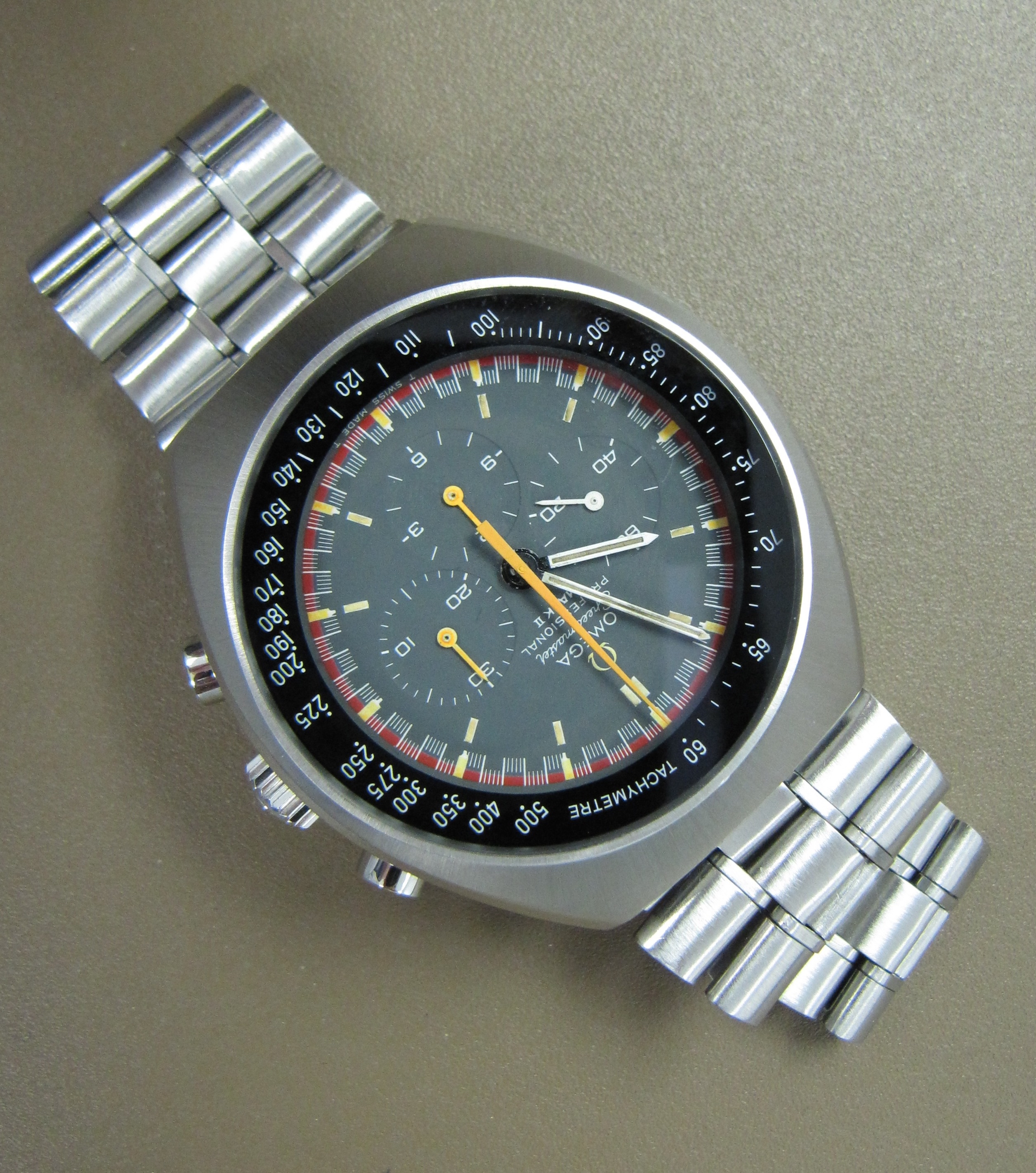

I have a black face version which I just got back from being worked on by a shop in Hong Kong. I would recommend them for having the bracelet rebuilt if you want to keep the original bracelet.
Here are some before and after photos of mine. The bracelet was gross to begin with and came back close to new and very functional. The finish looks great on the watch to my eye as well.
Here is the pricing:
1.Movement service USD 250
2.Bracelet rebuild USD 150
3.Hands and hour markers relumed USD 30
4.Detailing USD200
5.New crystal USD80
There are a few details that still need to be taken care of so the watch is going back to HK at their expenses. The Lume wasn't done (for one). Some will likely think up nuts for wanting that.
