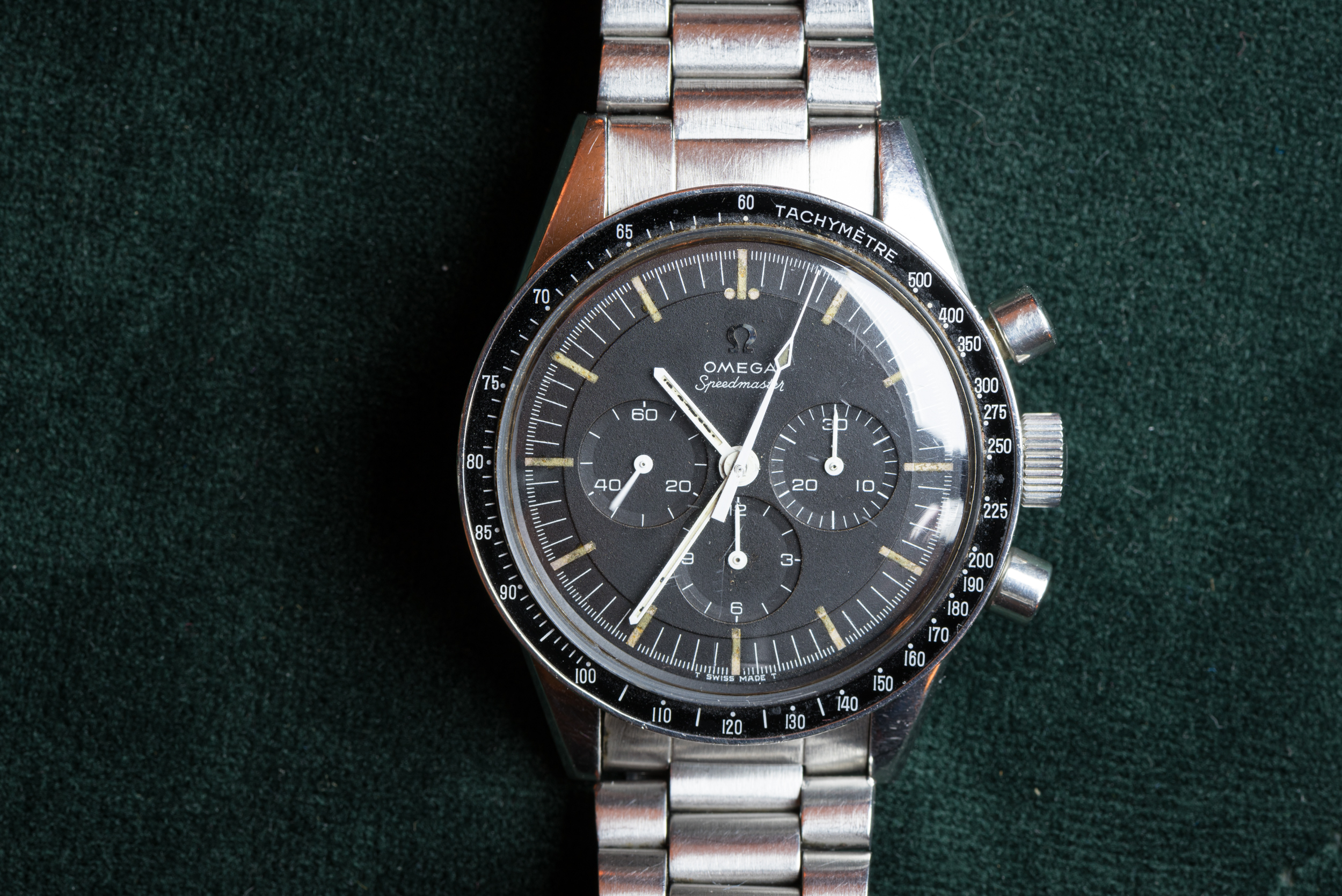

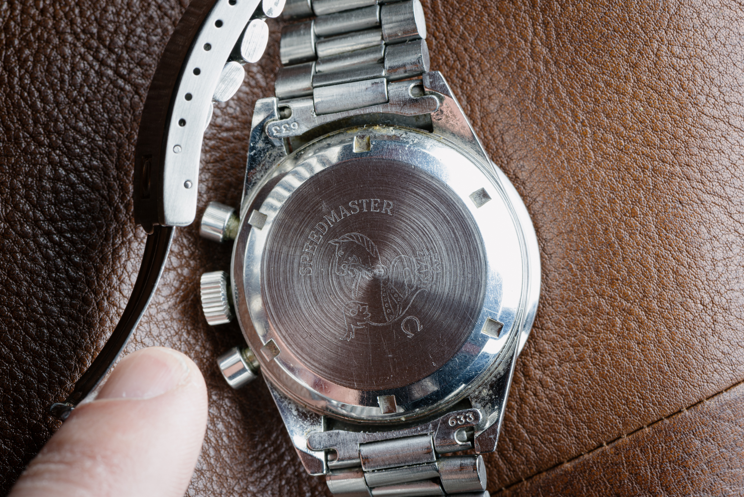

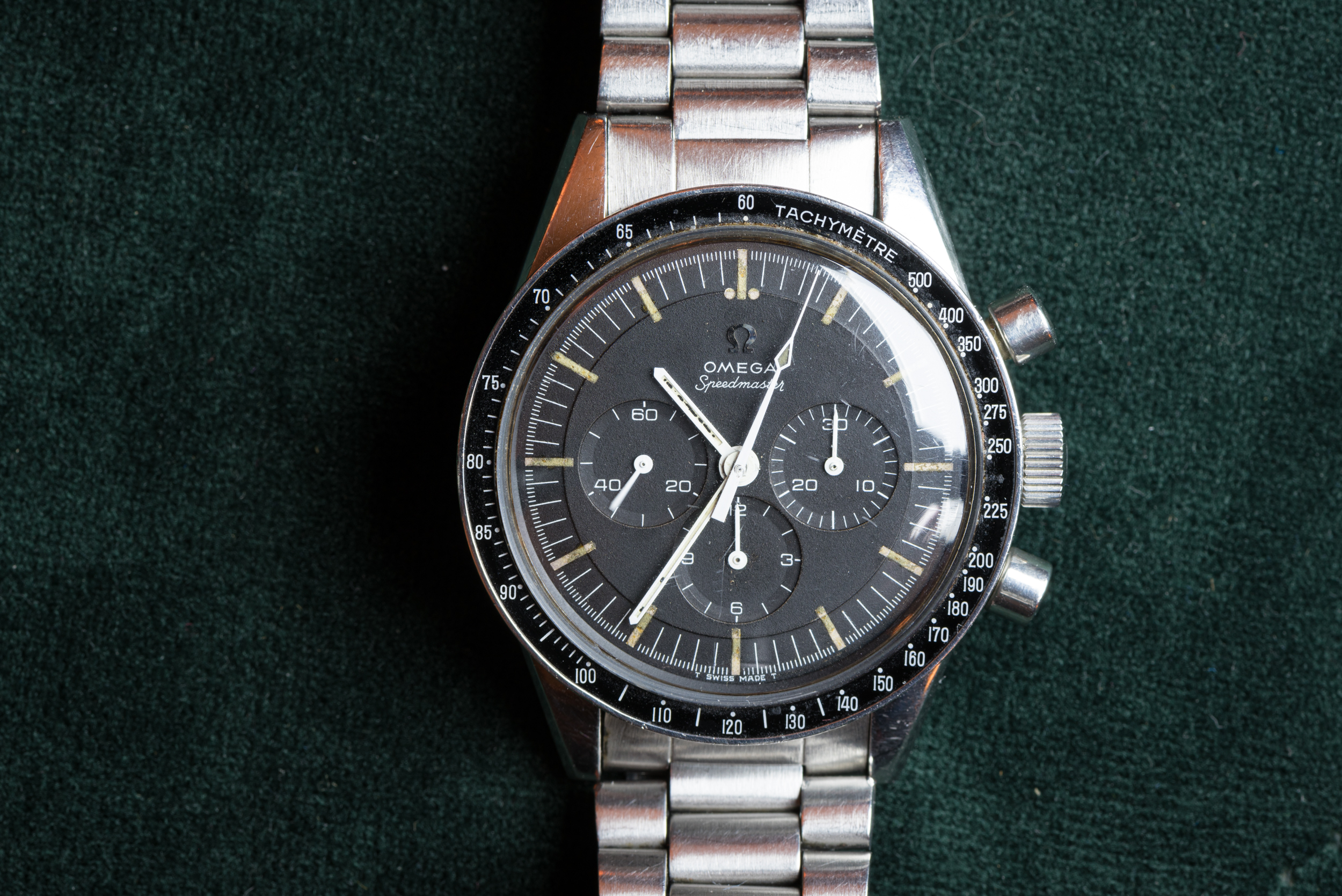

My father sadly died last week and left me his Speedmaster. I like watches and have a couple of newer (and much cheaper!) ones myself, but I'm a long way from being in any way knowledgable. In the past I'm sure he's told me all about where he bought it and its history but, frustratingly, I retained none of it and I can't find any paperwork so far either. From memory he had it for perhaps 20 years, maybe longer, and wore it every day.
I've been reading up on them for the last few days and have learnt a lot about the various references and points to look out for, but my knowledge is even now so shallow that I won't embarrass myself by mentioning what I believe about it so far! If anyone's prepared to have a look over the photos and give me some pointers as to likely model/year etc then I'd be hugely appreciative. I have no intention whatsoever of ever selling it, so while everyone's always curious about value I'm really far more interested in just knowing more about it.
Going on from there, I'd also really appreciate any advice on how to look after it. By which I mean, I again have no knowledge of its service history. I'm sure I remember him talking about having it serviced but I've got no clue at all about whether and when he did, though I don't imagine it was something he did regularly. Should I therefore get it serviced soon? Should I use a registered Omega service centre or some kind of independent?

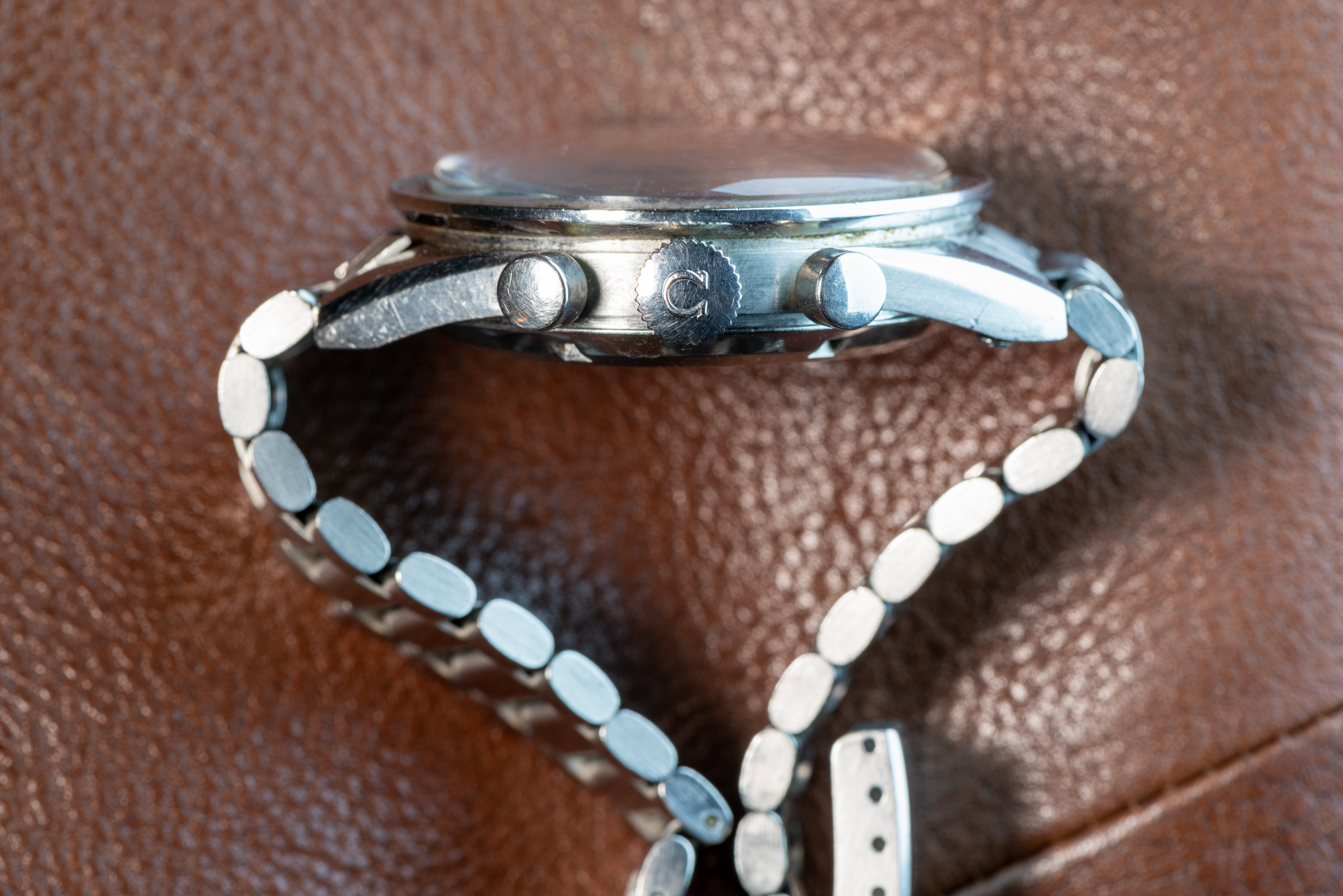

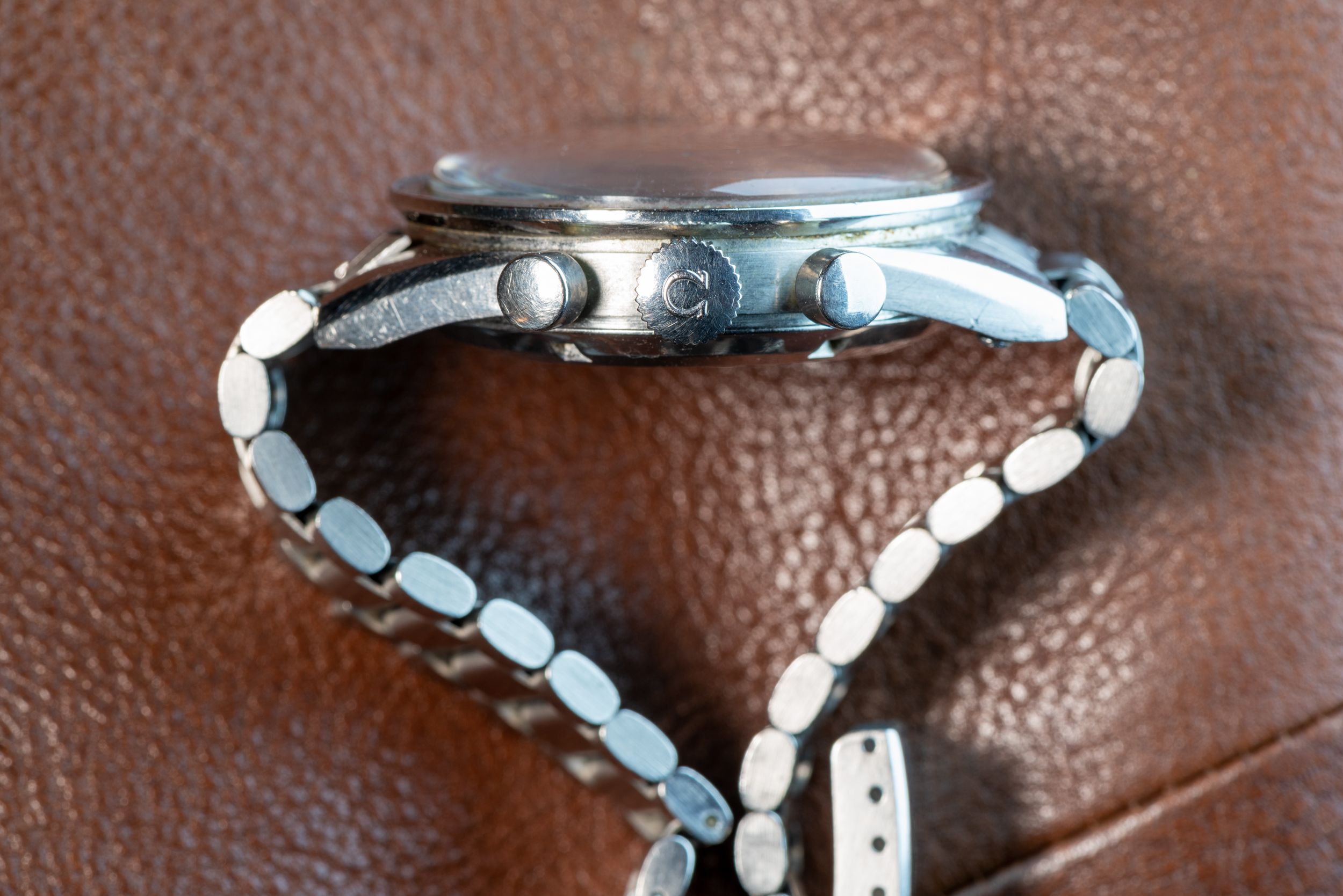

Looks like an Ed White with new (changed) hands, pushers and bezel. Quite valuable.
looks to have slight lug bevels so is likely a 105.003-65 which was produced from 1966 to 1969.

Welcome to the forum, greater minds will soon join in on this I think. In the meantime, it looks like an early Speedmaster, with at least changed hands and bezel. You don´t happen to know if there is any bag with spare parts laying around for this?
I think sending it to a watchmaker specialised in vintage Omega would be the best choice for servicing. Do not send it to Omega since they do not respect vintage pieces.
Thank you.
That's satisfying in that that's exactly the conclusion I'd reached myself so far.

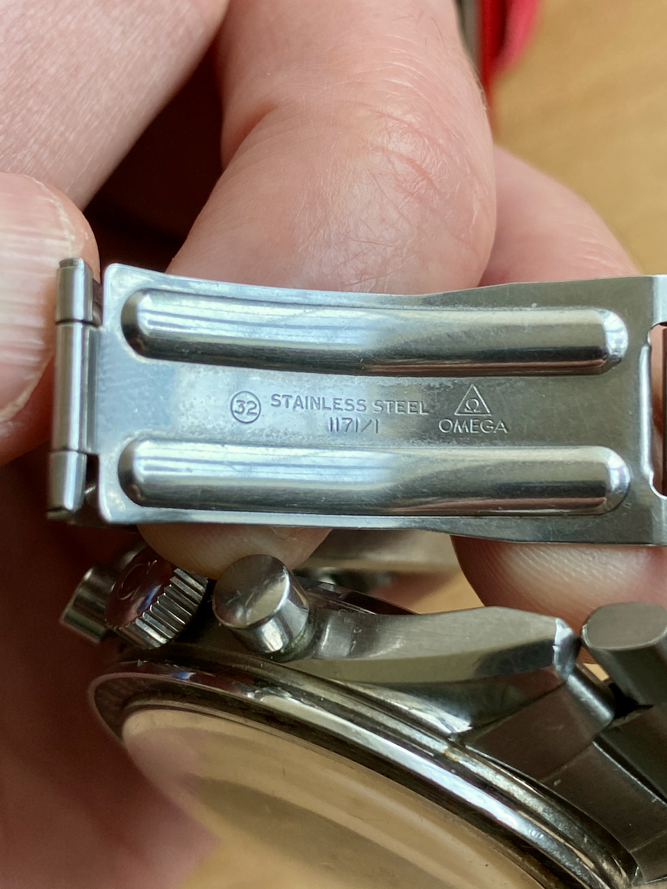

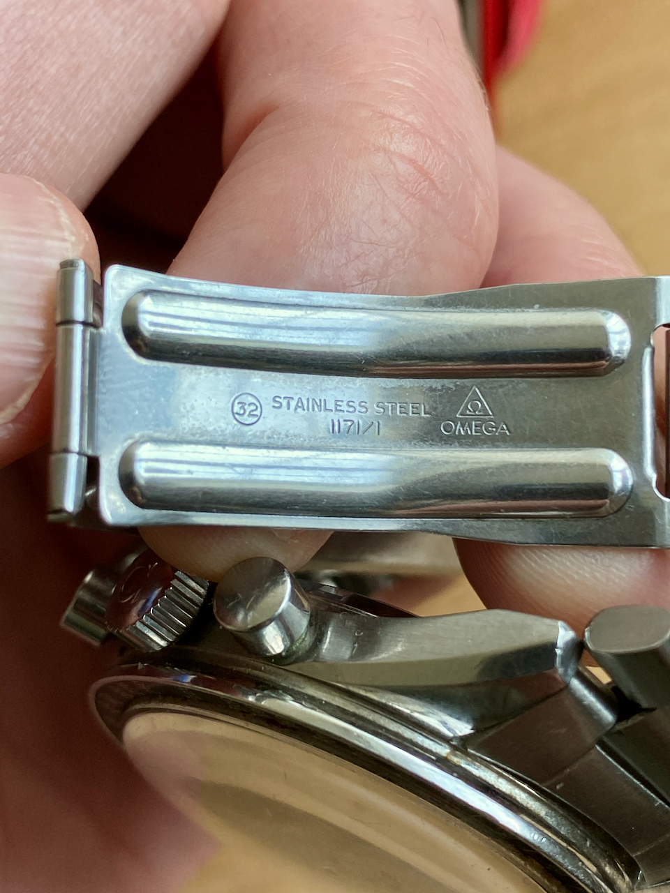

The bracelet is also newer I think (a 1171/1). Maybe had a big service at some point and a load of stuff replaced at once?
Yes that would be typical. It is worth searching to see if you can find a bag of parts. Some are pretty valuable, the original bezel in particular.
It’s likely model 105.003-65.
The bracelet is nothing special and dates from the 1980s
This.
The reference is most probably a 105.003 with some service parts as highlighted by @padders.
Please find bellow the details about this ref :
https://speedmaster101.com/105-003/
Cheers !

Looking again. There is rather more bevel on those lugs than I would expect for any 105.003, -65 included so either it's had a refinish at some point or the case (but not the dial) is actually from an earlier model. A refinish is the most likely explanation.

Looking again. There is rather more bevel on those lugs than I would expect for any 105.003, -65 included so either it's had a refinish at some point or the case (but not the dia) is actually from an earlier model. A refinish is the most likely explanation.
I can definitely see what you mean... good spot.
