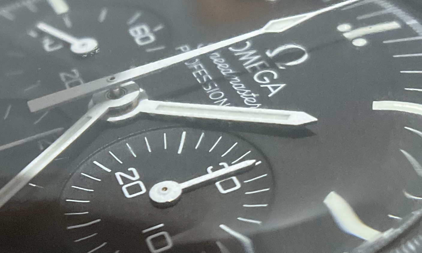

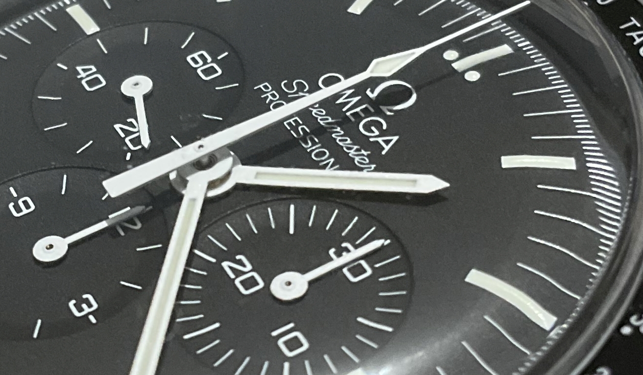

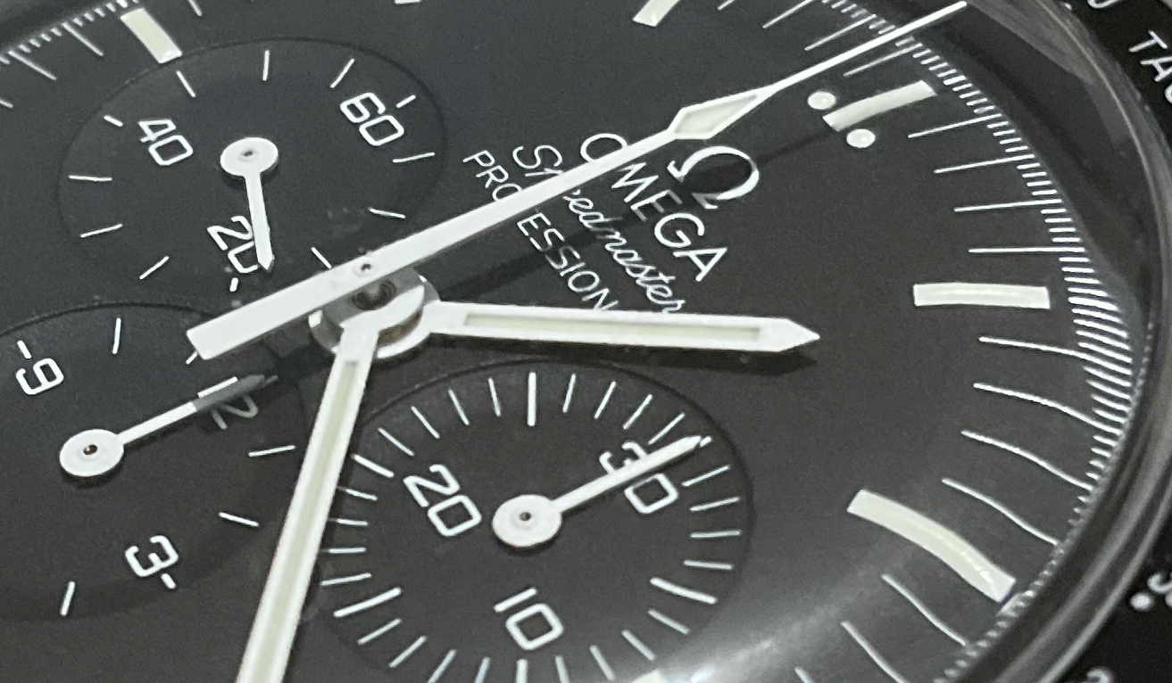

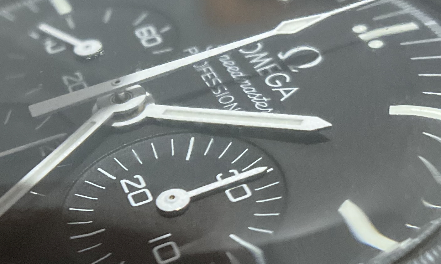

Long story: during the last few months I had to return my 1861 Speedmaster for warranty repairs a few times. After one of the repairs I noticed that the clearance between the hour hand and the small seconds hand was very, very small small. Two weeks later the watch began to stop randomly between 8 and 10 AM/PM. The reason was that the hour hand was sometimes blocking the small seconds hand and stopping the movement.

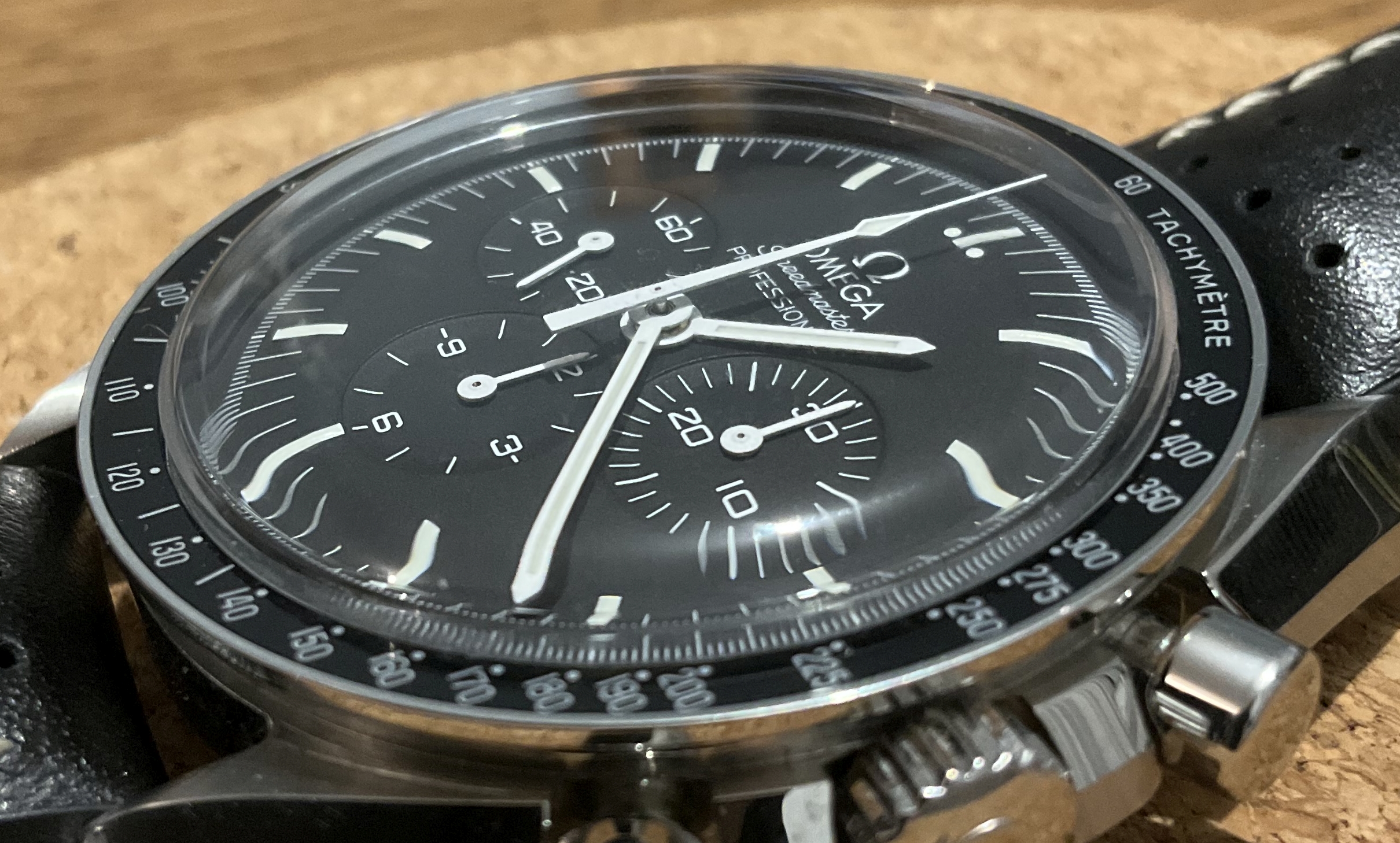

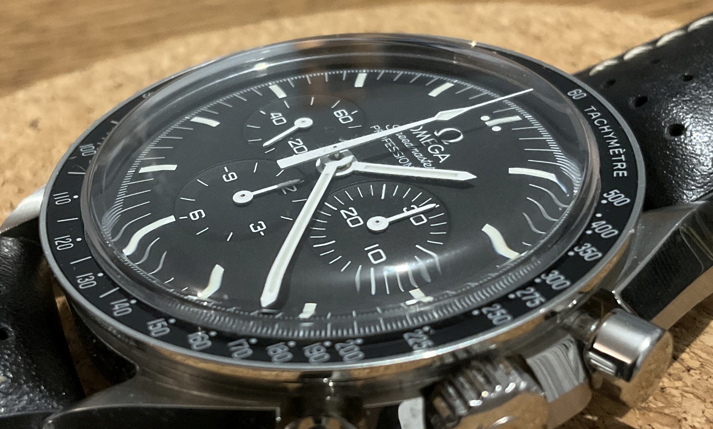

I returned the watch to Omega yet again and they solved the problem by bending the hour hand upwards. The watch works fine, but the bend is noticeable. I can see with a naked eye that the hand is not parallel to the dial, nor to the other hands.
It's bugging me not only visually, but also because I think that the repair is poor workmanship. But maybe I'm wrong, hence the question. Is it acceptable according to watchmaking rules or Omega standards to ensure clearance between the small seconds and hour hands by bending the latter?
I'd be very grateful for any info and suggestions on this.

Looks like someone used a short cut to solve the alignment problem. Perhaps raising the hour hand at the centre might have been a better alternative. If the watch is now working properly, it is your decision as to whether you return it yet again!

This is a bit of a short cut and not a great one. The running seconds hand needs to be removed and reamed slightly so it sits lower on its pinion.

Thanks! It seems that was indeed the case. I went back to Omega and after another debacle on their part they fixed the problem. They installed a new, straight hour hand, but this time there is ample clearance between it and the small seconds hand. I think it's because the seconds hand seems to sit much lower now than it did previously.
