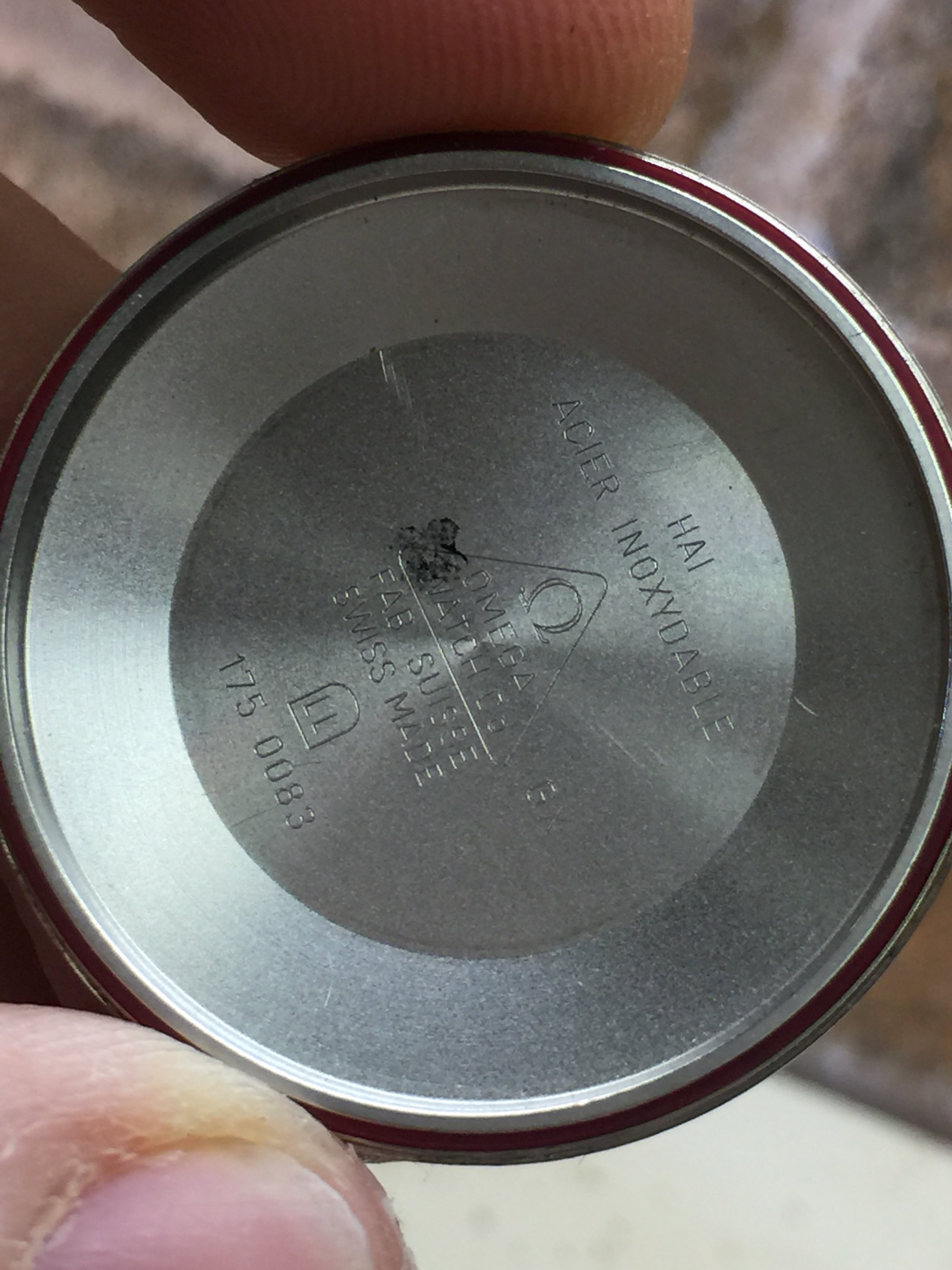

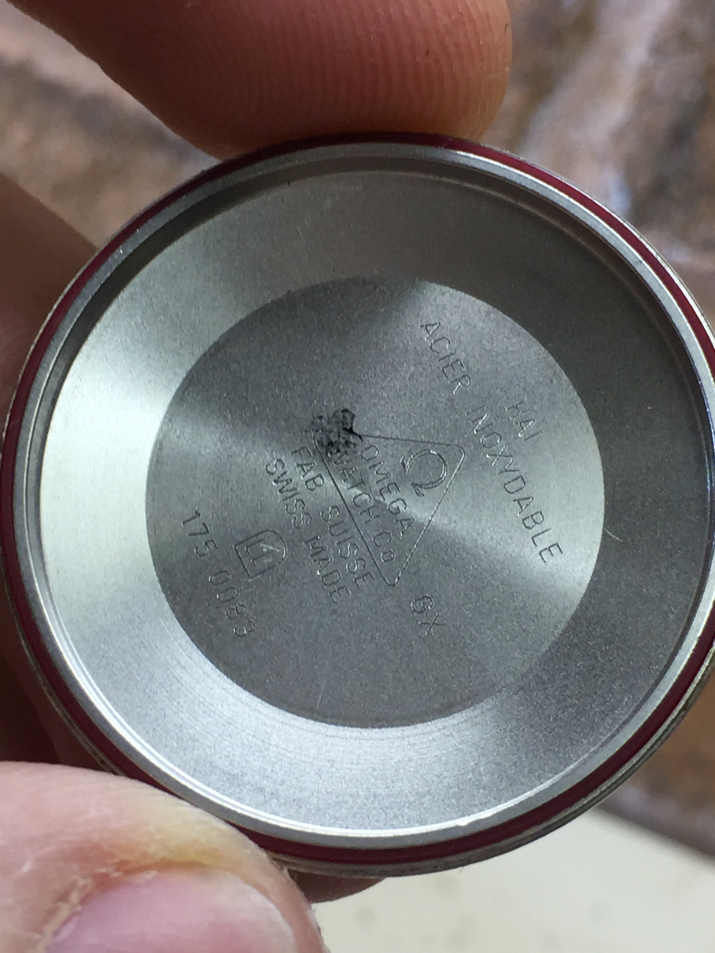

If the OP looks inside the case back, there will likely be evidence of the rotor rubbing.
Wow, thanks for the in depth diagnosis. I took a look at the photos I had of the back. And didn't see anything obvious, but since the seal is already needing replaced I might as well open it up again to double check. I can also check the rotor bearing then. Sounds like this is a watch I should take off my wrist.

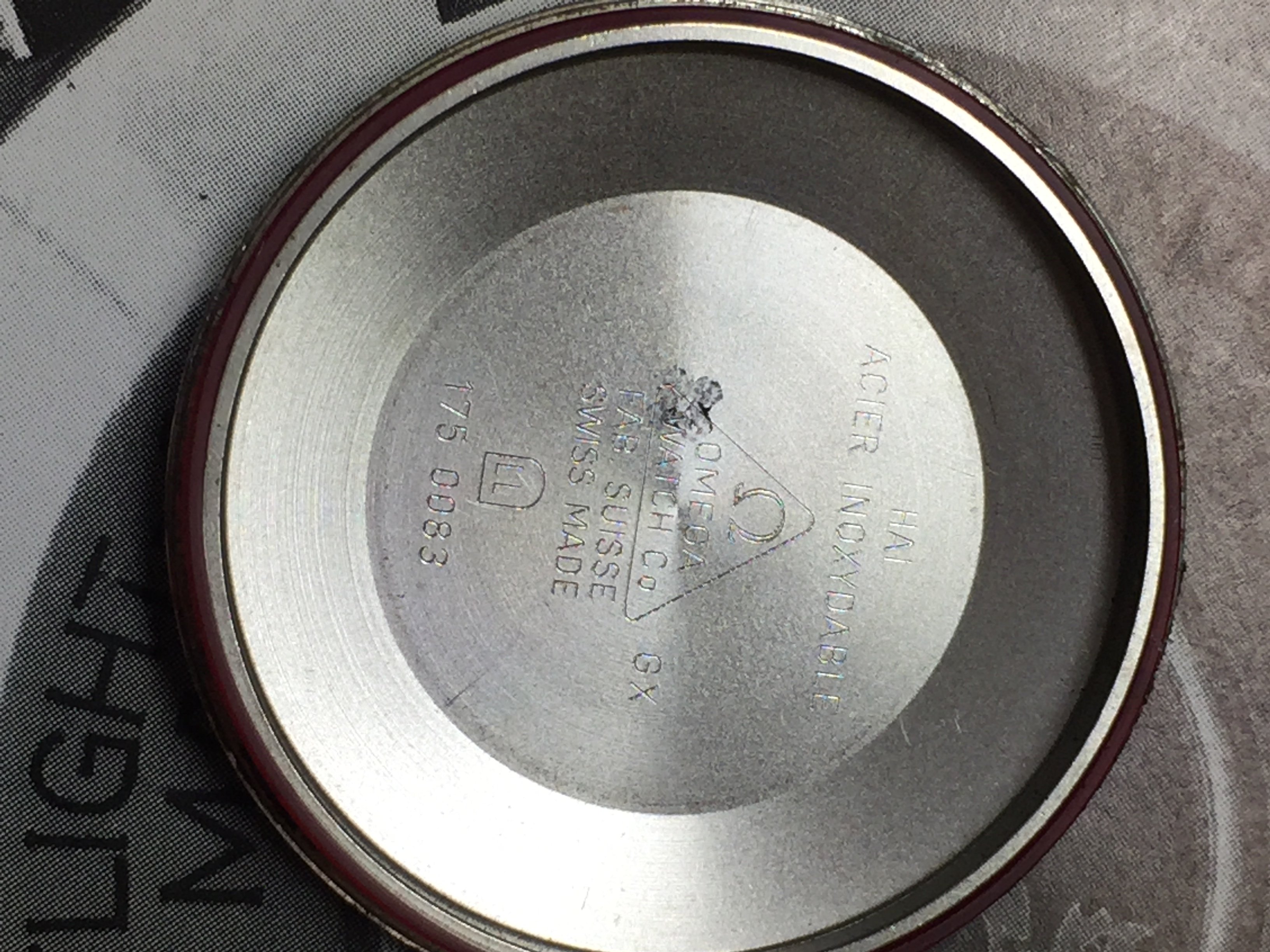

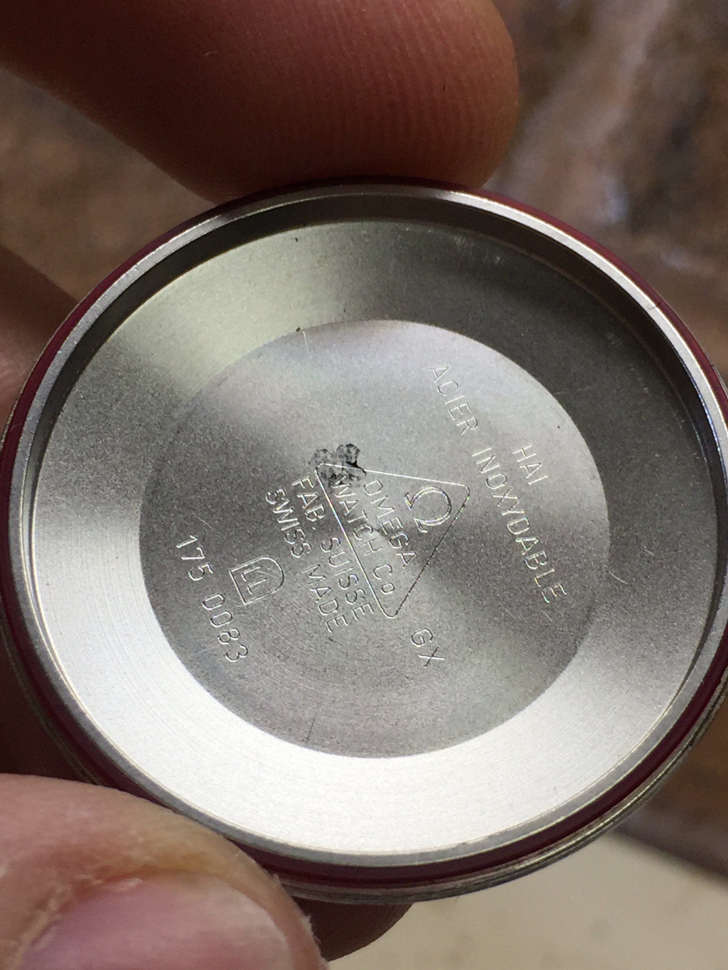

@Archer Thanks again for your detailed write up - I took the back off and still didnt see any deep rub marks. But I believe I can see a circle where the plate may be rubbing.
After putting my tweezers on the rotor - I definitely saw/felt as much movement as displayed in your video. Watch is off now to curb any more damage being caused. I guess today I get to wear this gem

Yes, that is the mark you will see - it's been rubbing on the inside of the case back for sure.

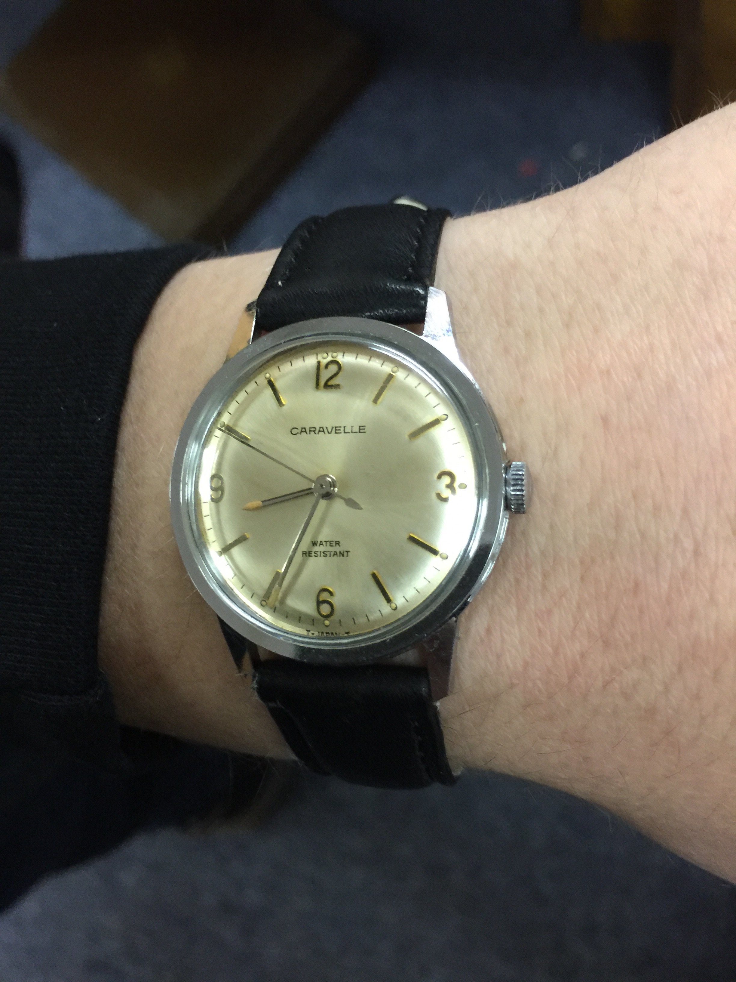

PS: I think that Caravelle looks nice, even though I know nothing about them.
Picked it up for $10 😀 definitely a watch I can afford to make a mistake on (unlike a speedmaster). I am super new at this too - always thought vintage watches were amazing and immediately fell in love with Omega. The irony is the more I read things on this forum the more I realize how little I know in a market that is actually quite competitive and potentially dangerous. Although I really liked this watch (a major point being the price), it is in no way the perfect Speedy - so investing a bunch of money in it will only get me farther away from the dream watch. Mistake are made and lessons are learned, I am just very appreciative of the fact that this forum provides expert opinions @Archer to complete strangers just because they enjoy watches and are nice people. I am only 25 so I have a lot of collecting and learning left - I will post a follow up once I find out what to do with this unfortunate lemon. At this rate I believe sending it back is way to go.

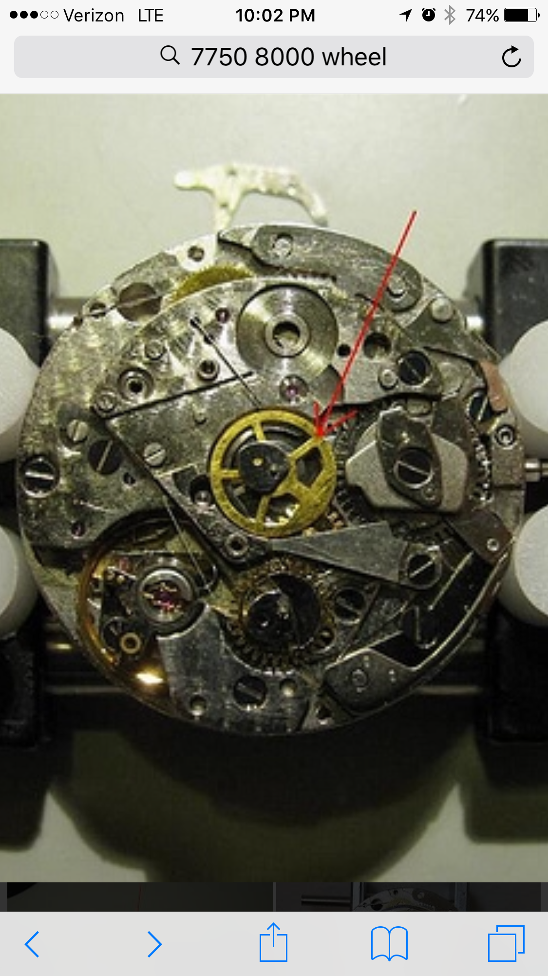

If the watch keeps time and sounds "strong" when wound, then it's just an adjustment on the chronograph second hand wheel spring that tips the intermediate minute counting wheel. Not a big deal but it may be hard to find a watchmaker who will just make the adjustment. You don't even need to remove the second to do it. Vary easy.
I repair chronograph land all the time. The 7750 is one of the best made movements of all time.
29,669
76,828
If you are suggesting that the finger is bent to such a degree that it is jamming on the minute counter driving wheel, that is unlikely. The finger would have to be bent to such a degree that it would be difficult to explain how that happened - the finger can get out of adjustment slightly, but I've never seen one so far out that it jammed the watch. Someone would have had to get in there and physically bend it to get a severe enough bend to cause it to jam and stop the watch. So people know what is being referred to (your photo isn't the best) here is a video of the finger flipping the minute counter correctly via the minute counter driving wheel:
Given the evidence of the movement's condition that can be seen in the photos, the more likely reason is that the watch needs a full service, and that lack of power is the reason the watch is stopping when the load of indexing the minute counter is added. If you are a watchmaker you already know that timing and the listening to a movement are not really very good diagnostic approaches, all this is moot now that the watch has been sold on...

Yes that photo sucked. I tried to find a better one but it wouldn't upload.
