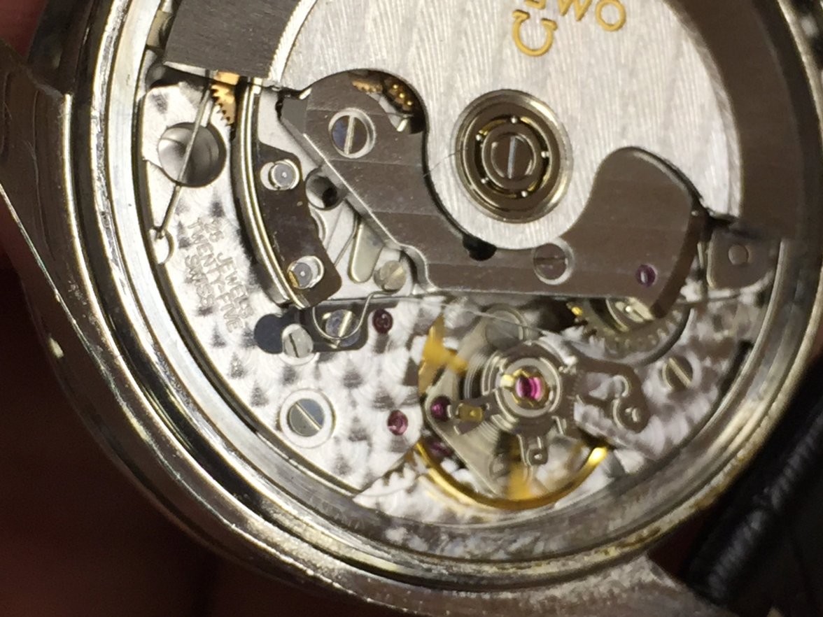

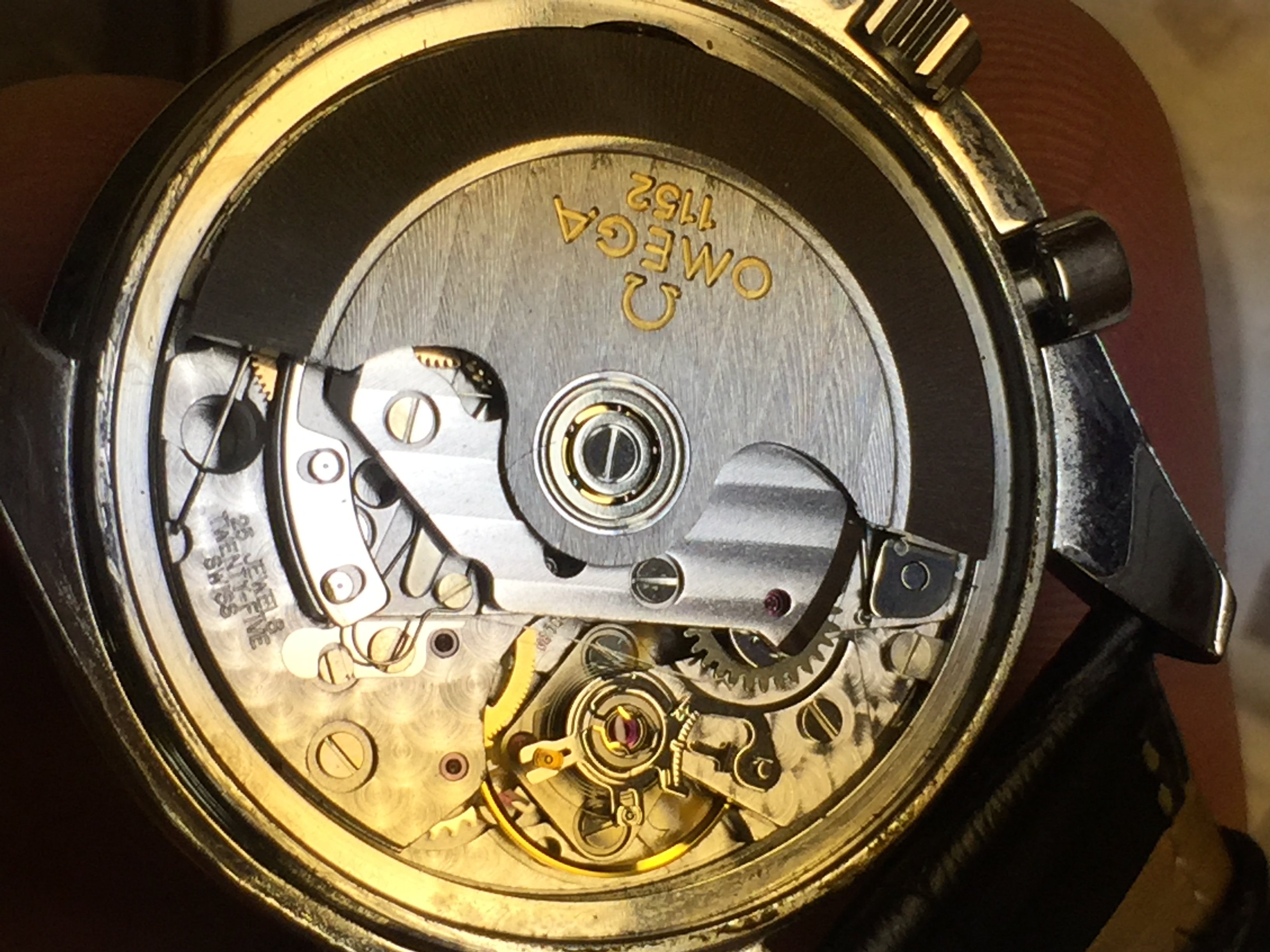

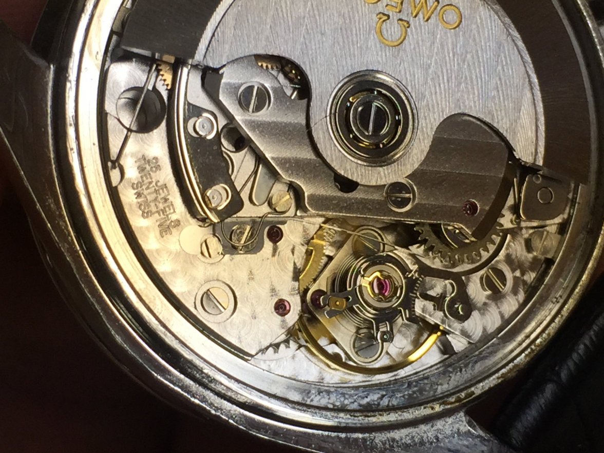

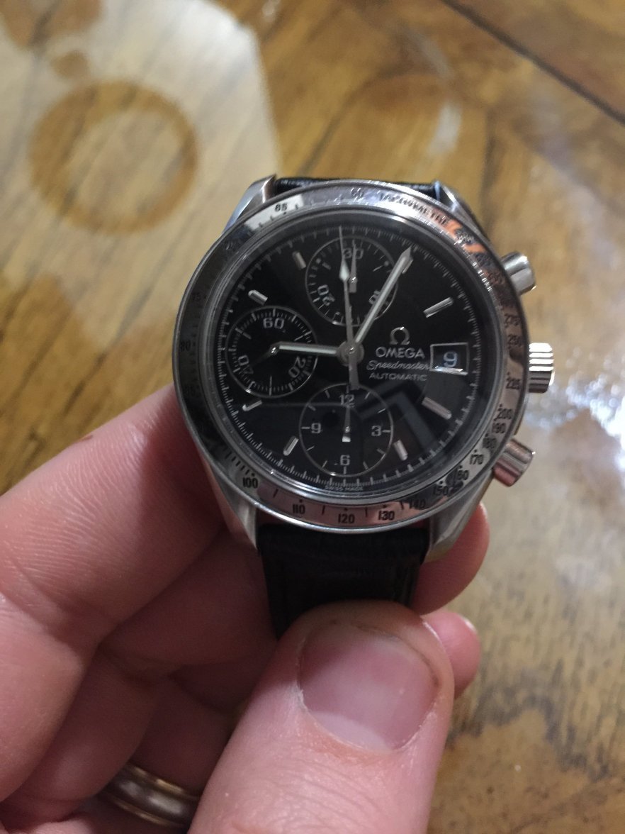

    I just bought a Speedmaster 3813.50.01 for a decent price (finally one I can afford!) - but unfortunately I am having some serious difficulties with it. I wore it for a couple hours and the watch is working great and to my knowledge keeping excellent time. However, when I started the chronograph function things got weird. The chronograph second hand goes around the watch fine until 59 seconds and then it stops. When it stops the watch also stops. If I click to stop the chronograph function the watch will start going again but the chronograph is still froze at 59 seconds. If I start the chronograph again the watch will stop again and the chronograph will not move. I can reset it and the chronograph second hand will go back to 60 seconds for the problem to start all over again.
    Has anyone heard of this issue? And does anyone know how to resolve it? I am pretty sure I can still send it back, but I am holding out hope that I could be doing something wrong. IMG_4742.JPG IMG_4736.JPG IMG_4739.JPG IMG_4738.JPG

    Your watch is due for a trip to the watchmaker, one of the caveats of buying a second hand watch is that unless you have the invoice from a watchmaker within the last 5 years you have to assume it needs a service, and given the stopping issue its going to have to go. On the plus side its a simple 7750 derived movement so any good independent watchmaker can handle the job for you without it being too expensive.

    Have you fully wound it by hand? The extra friction of turning the minute hand can stop a watch with low power reserves.

    Just tried it. I was really hopeful as it made the final turn, but unfortunately it still stopped at 59 seconds. Thanks for the suggestion

    Perhaps an issue with the hammer spring that advances the minute sub register.??

    Very possible... I had a similar issue with a different movement years ago. The good news again here is that it's a 7750 based movement. There are some non omega certified watchmakers that will service more mainstream movements for $150-$200. The key though is finding someone whom you trust.
