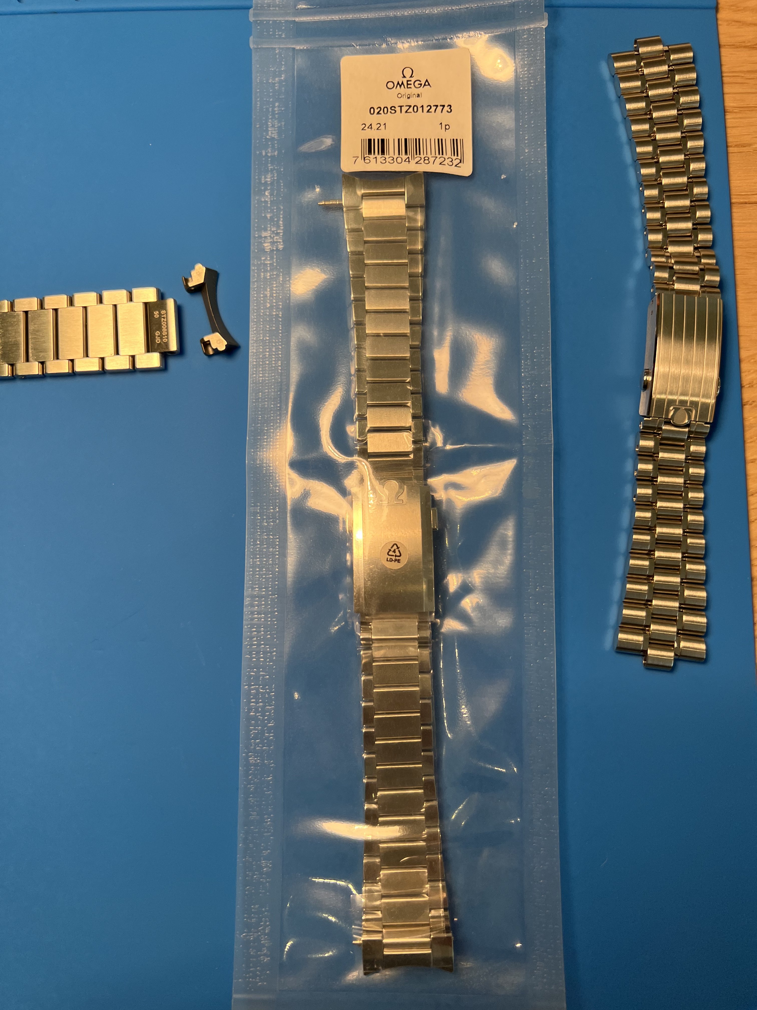

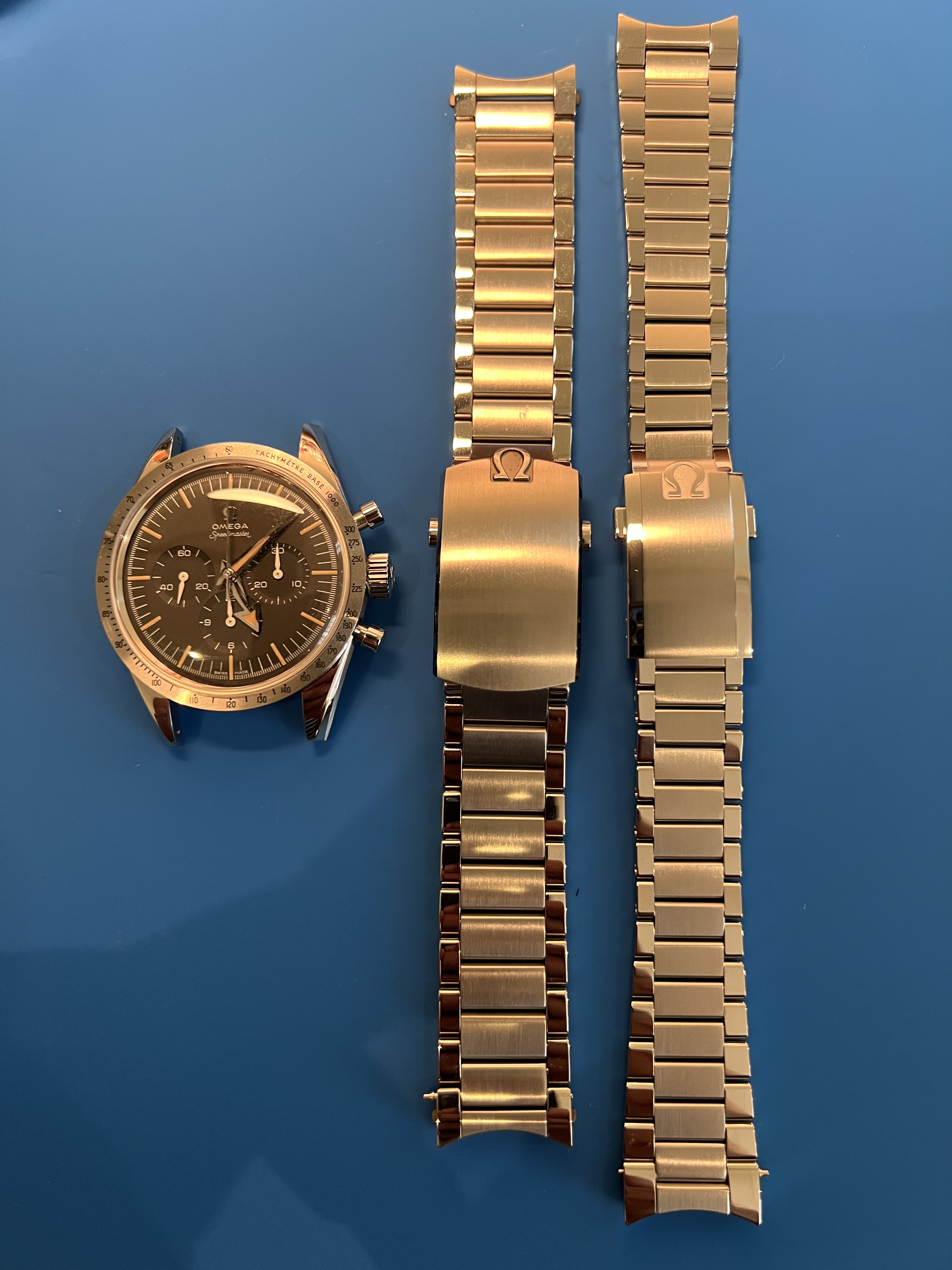

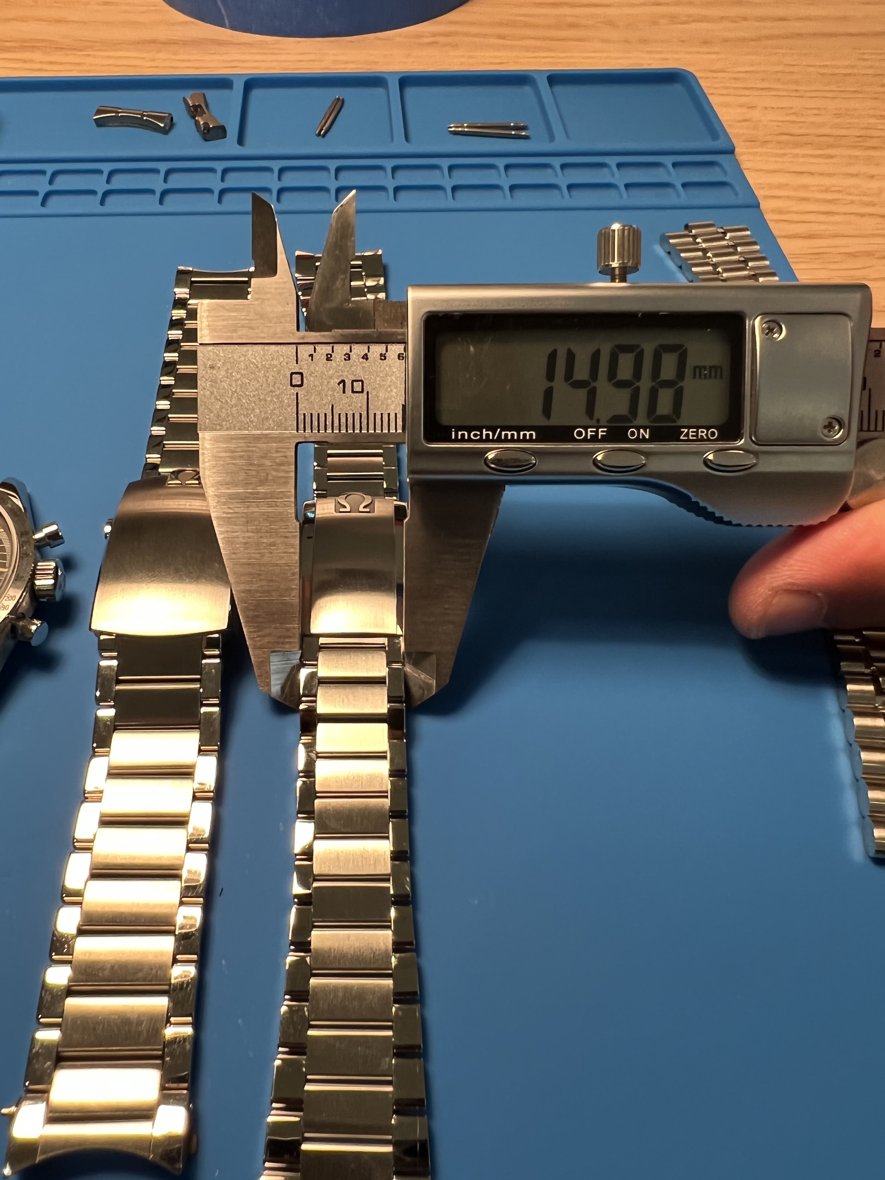

Does anyone know if the 321 Ed White bracelet is also compatible with the trilogy Seamaster 300? I would assume yes since they all share the same stock non-tapered bracelet. Just wanted confirmation & see if anybody has tried it.
114
158

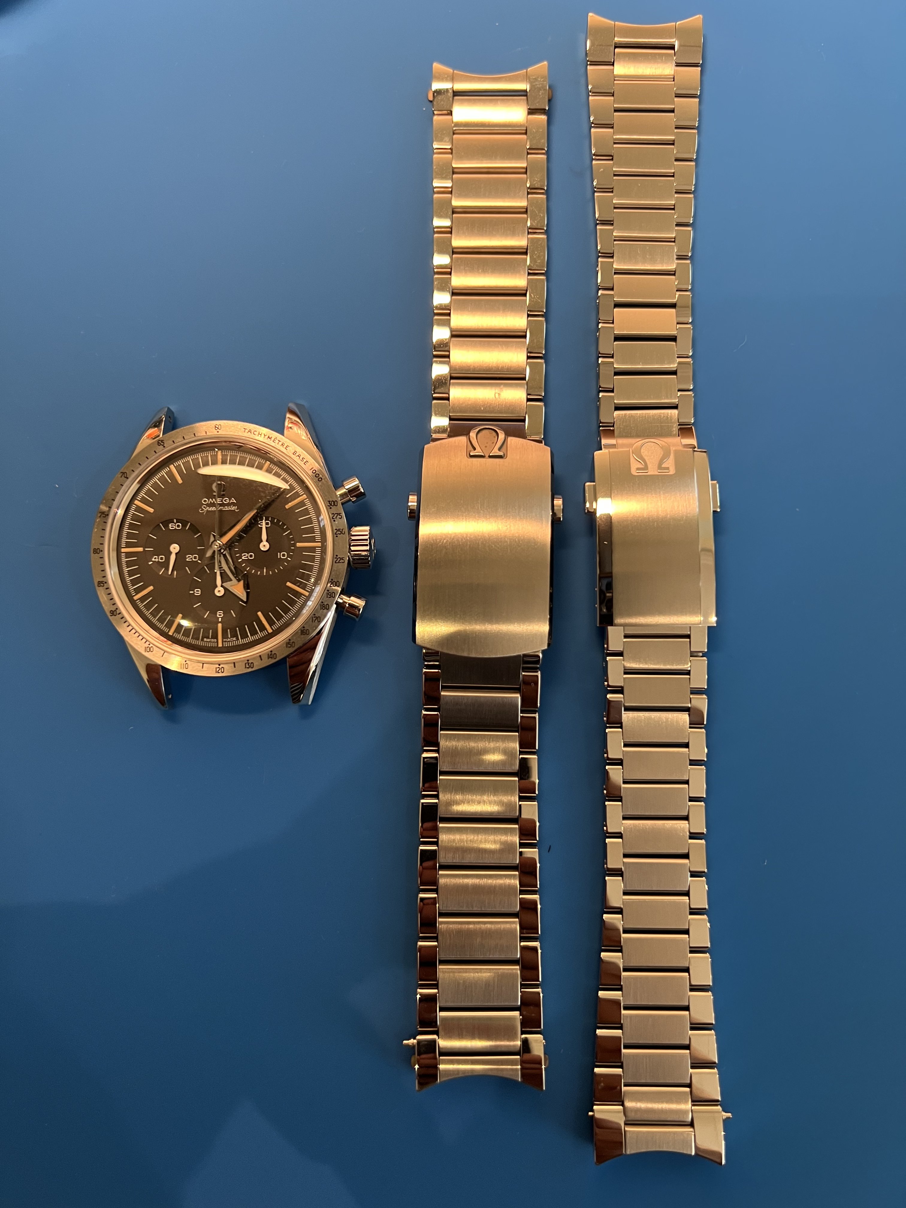

Update: Just tried the Ed White (parts # 020STZ012773) bracelet on the Trilogy Seamaster and I don't believe the endlinks fit into the lug holes in the case. Even on 1.5mm spring bars. It's just shy of linking in... I have it on now with Forstner endlinks, which is only working with 1.5mm springbars as well, but that is resulting in a very loose gap between the case & endlink.
Anybody else with a SM300 trilogy have better luck??

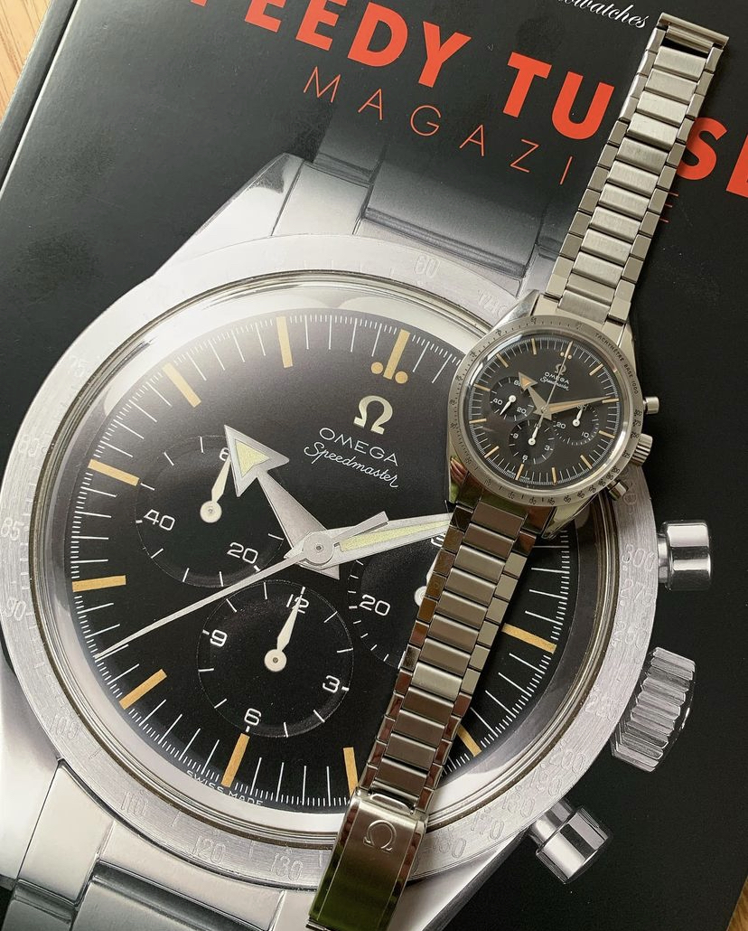

As much as I like it … of everything out there it’s still second place to this …
Is that a 1039/516 bracelet, Eugene?

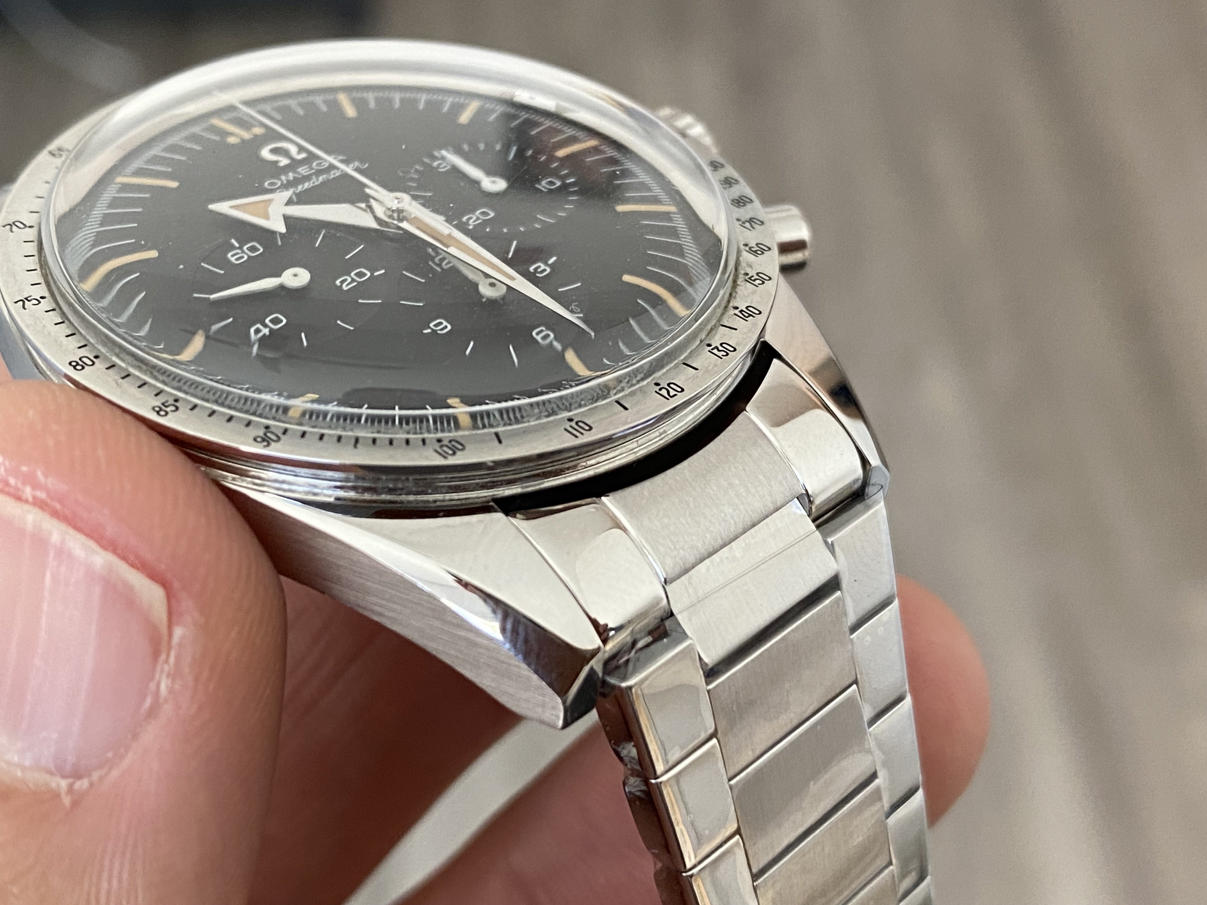

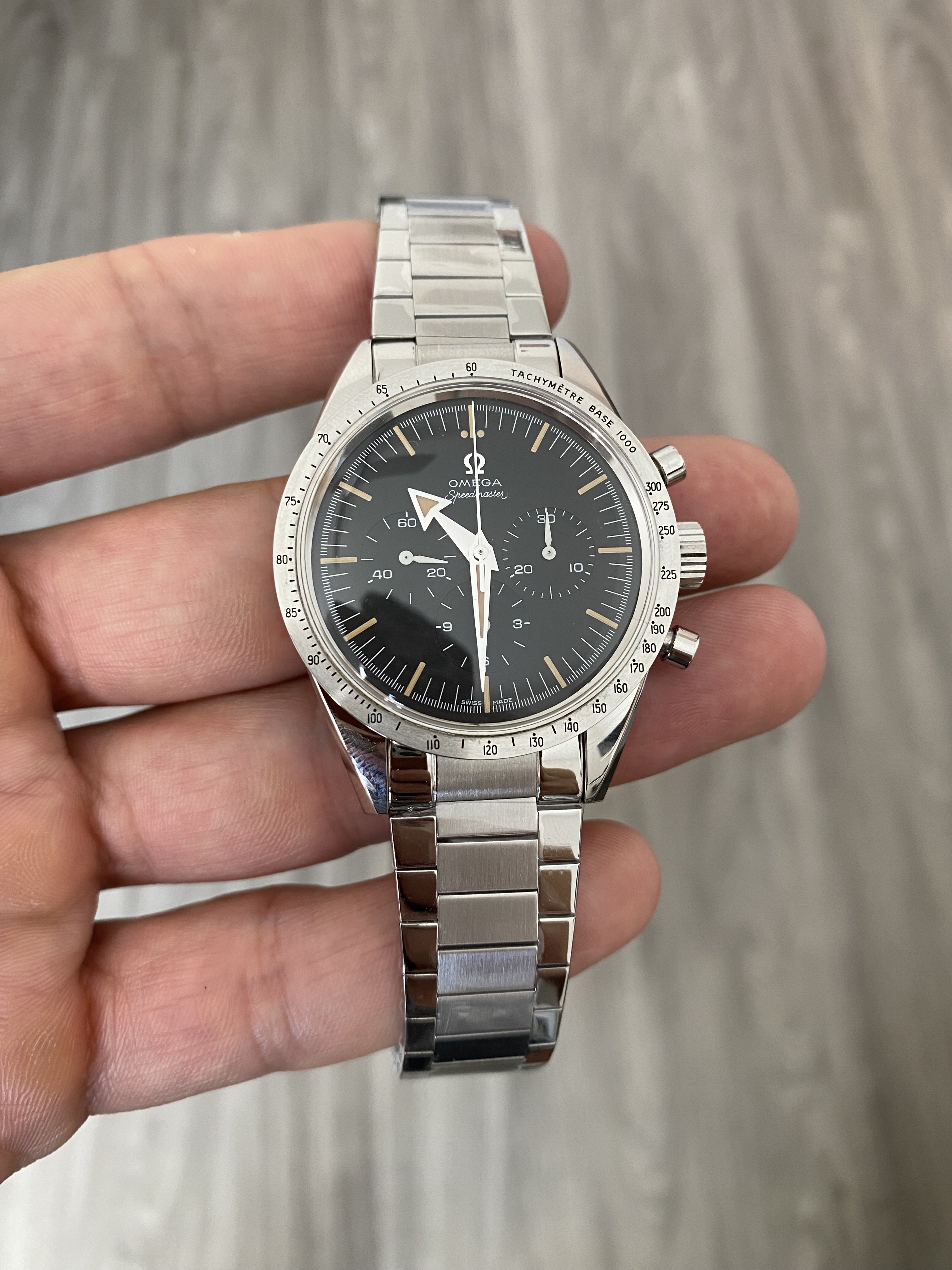

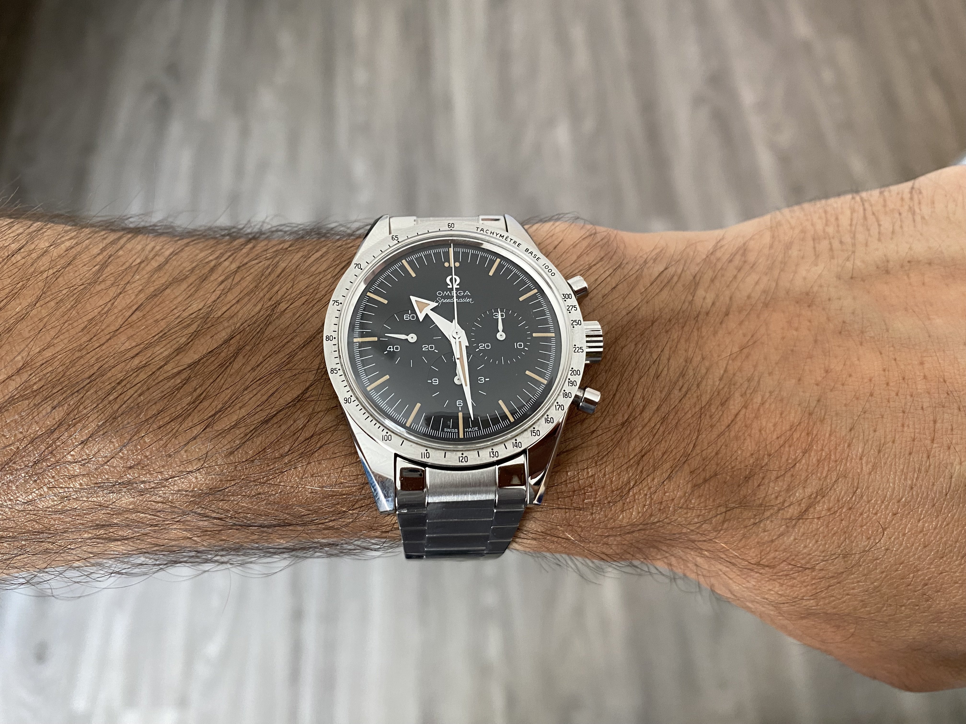

Did the 321 bracelet/Speedy Trilogy combo using 1.5mm bars and it worked great. There is a slight play in the last link since it should be using the 1.8mm spring to hold the endlink to the bracelet but its not noticeable if you were it fit, if you like to were it lose it might bother some people.

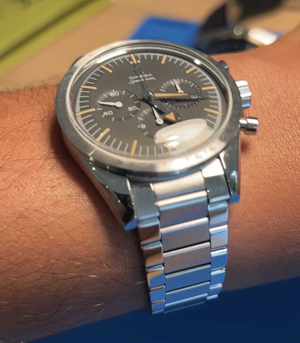

Hi all, I recently put my 60th on the Ed White bracelet using 1.5mm spring bars, and it worked, but the fitment was not very good. There was a noticeable rattle. The 1.8mm OEM Omega spring bars would not engage on both sides. I just wanted to let everyone know that I bought 1.7mm spring bars from Artem (https://artemstraps.com/products/springbars), and they are the best of both: perfect fitment with no rattling, but also fully engages both pins.

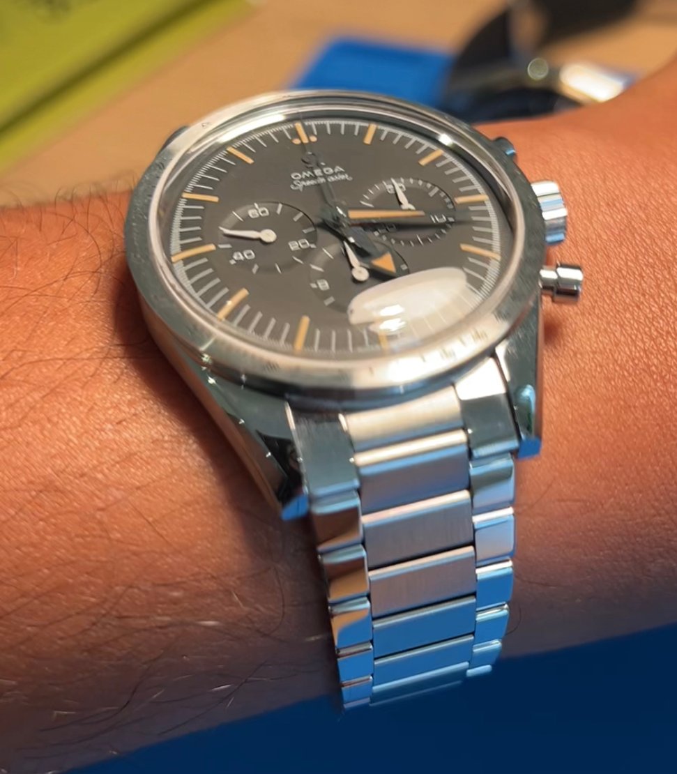

I am still more than happy with the 'cheap' US Flatlink 😀

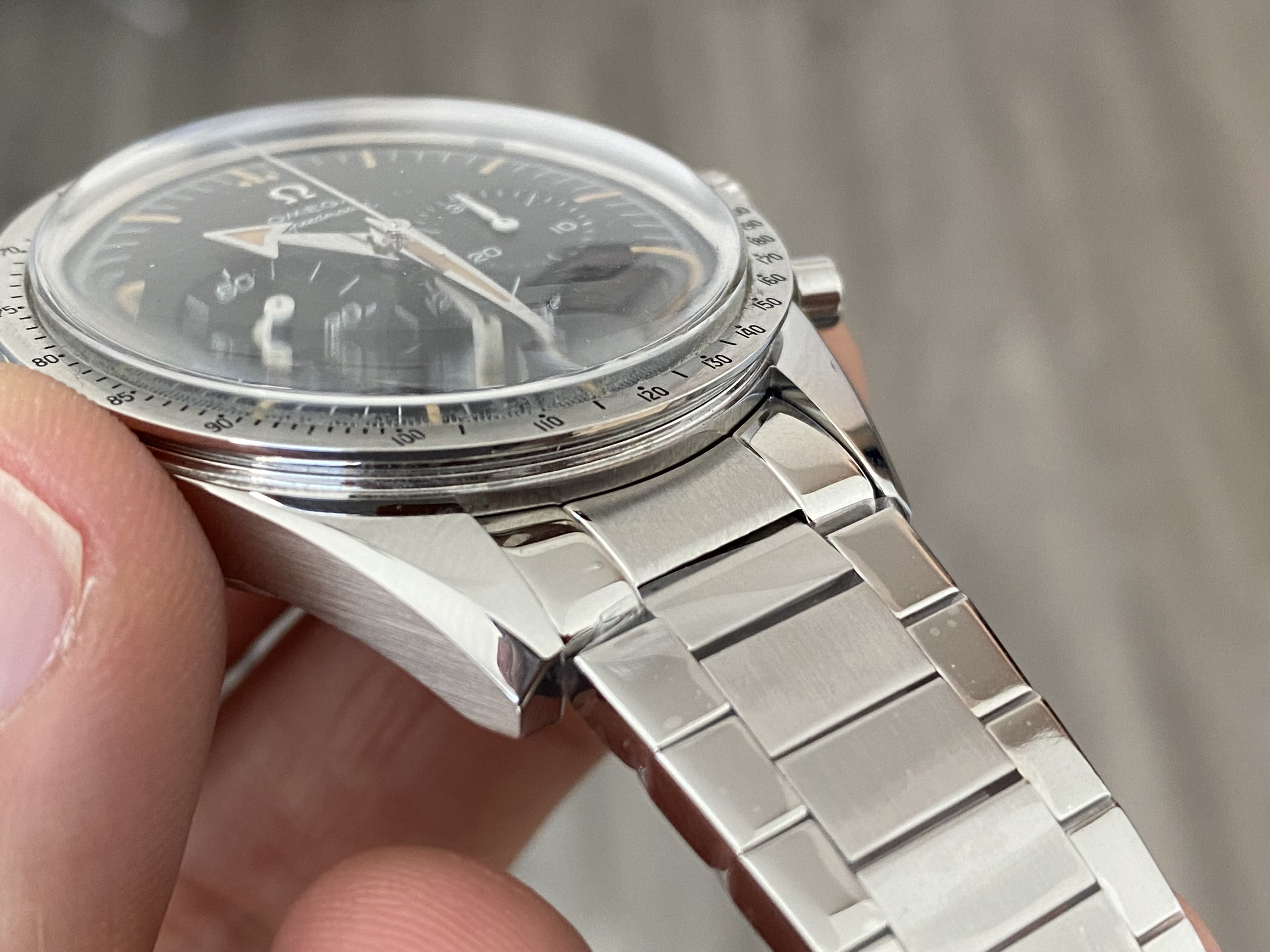

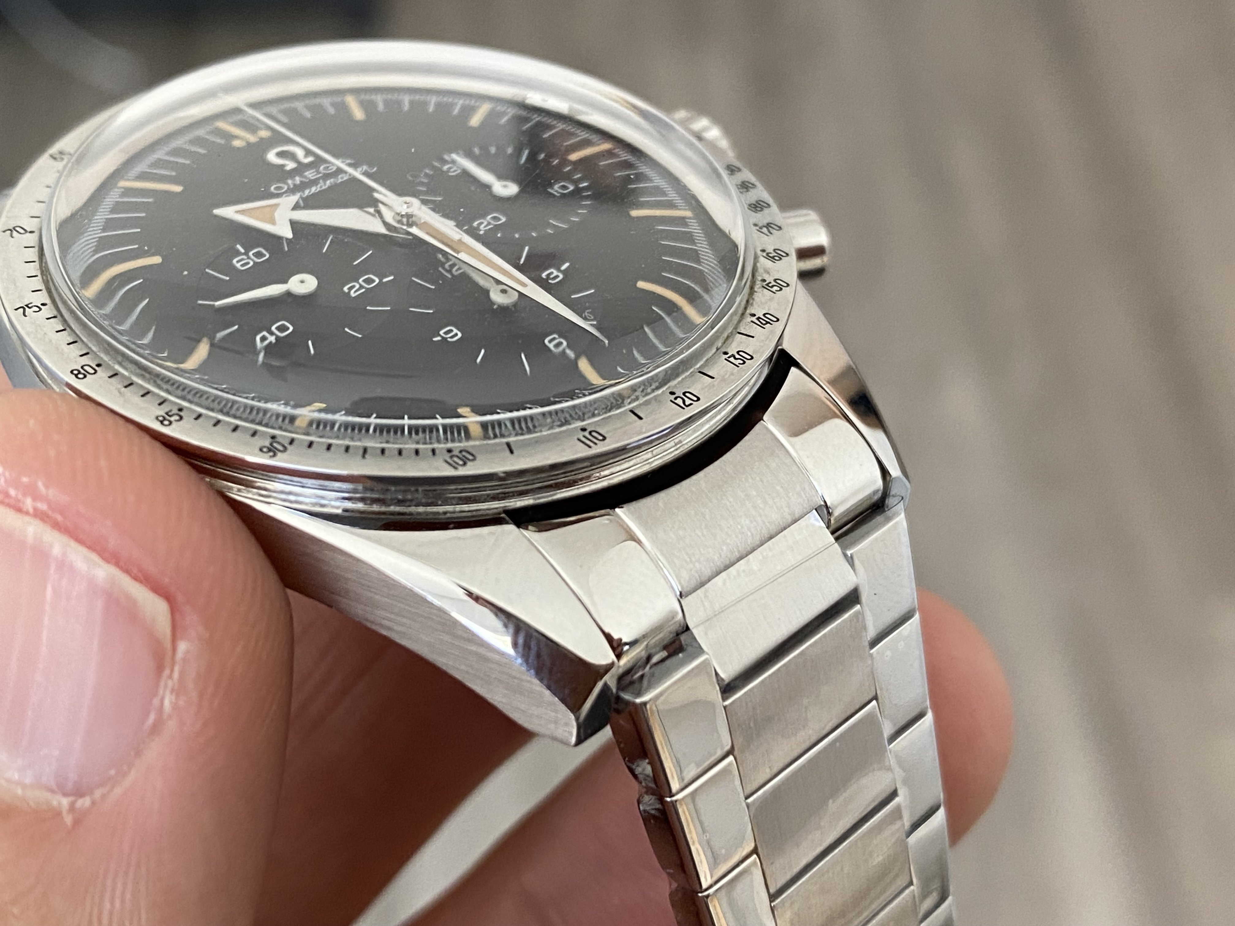

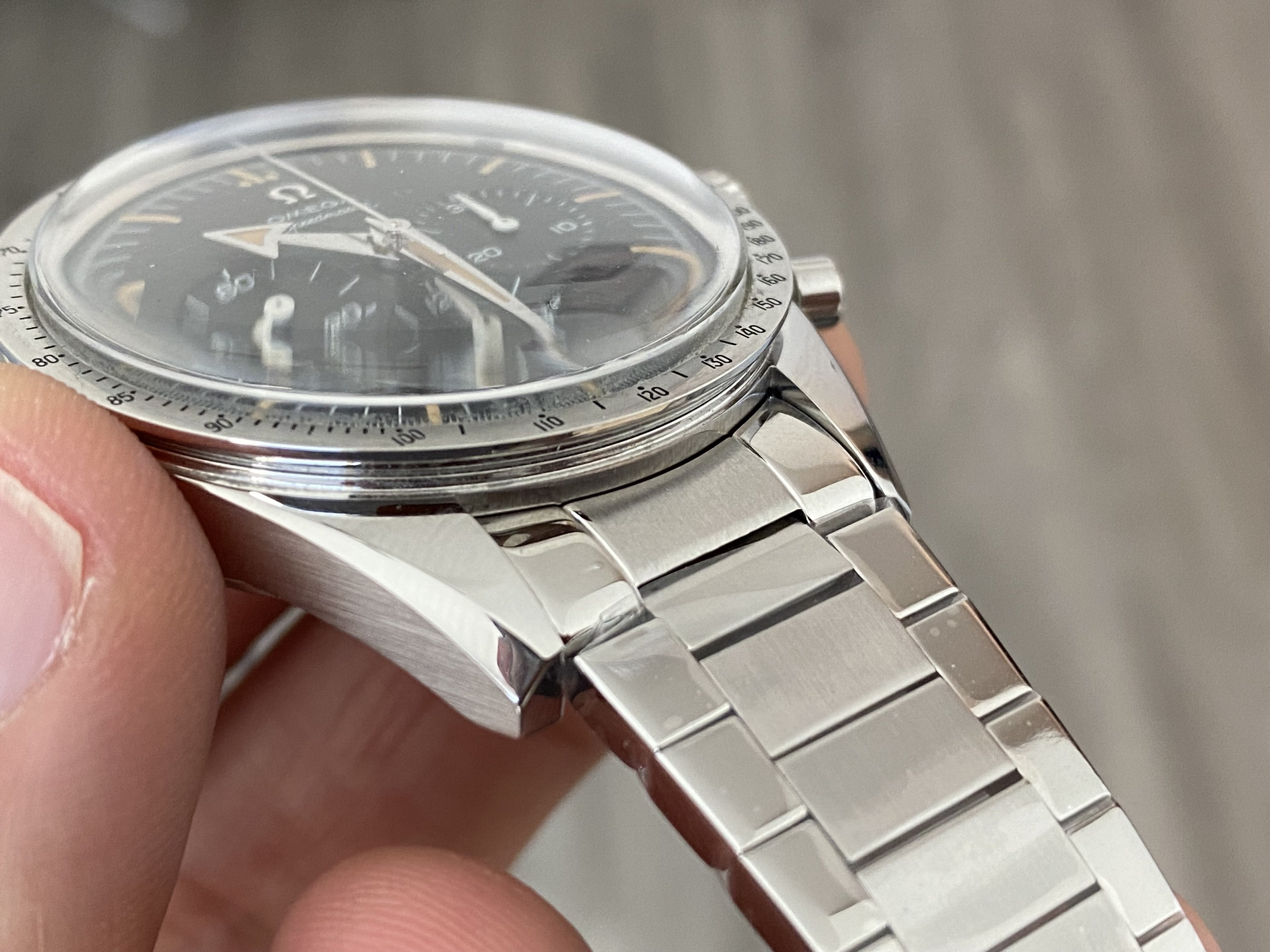

Does your Uncle Seiko flat link have a pretty noticeable fitment issue / gap between the end links and the case/lugs? As you can see in my photos, if the end link is flush with the case, it sits well below the lugs, but perhaps even "worse", when it is flush with the lugs, there is a pretty noticeable gap between the case.
Does this bother anyone? Or does it seem fine, given the cost of the bracelet and other improvements over the included bracelet (assuming I don't want to spring for the Ed White bracelet, at least not yet)?
Or, does anyone know if Forstner's flat link end links fit the Speedmaster 57 trilogy any better the Uncle Seiko's? And if they'd fit Uncle Seiko's flat link bracelet?! (Forstner has discontinued the 19mm polished/brushed flat link bracelets)...

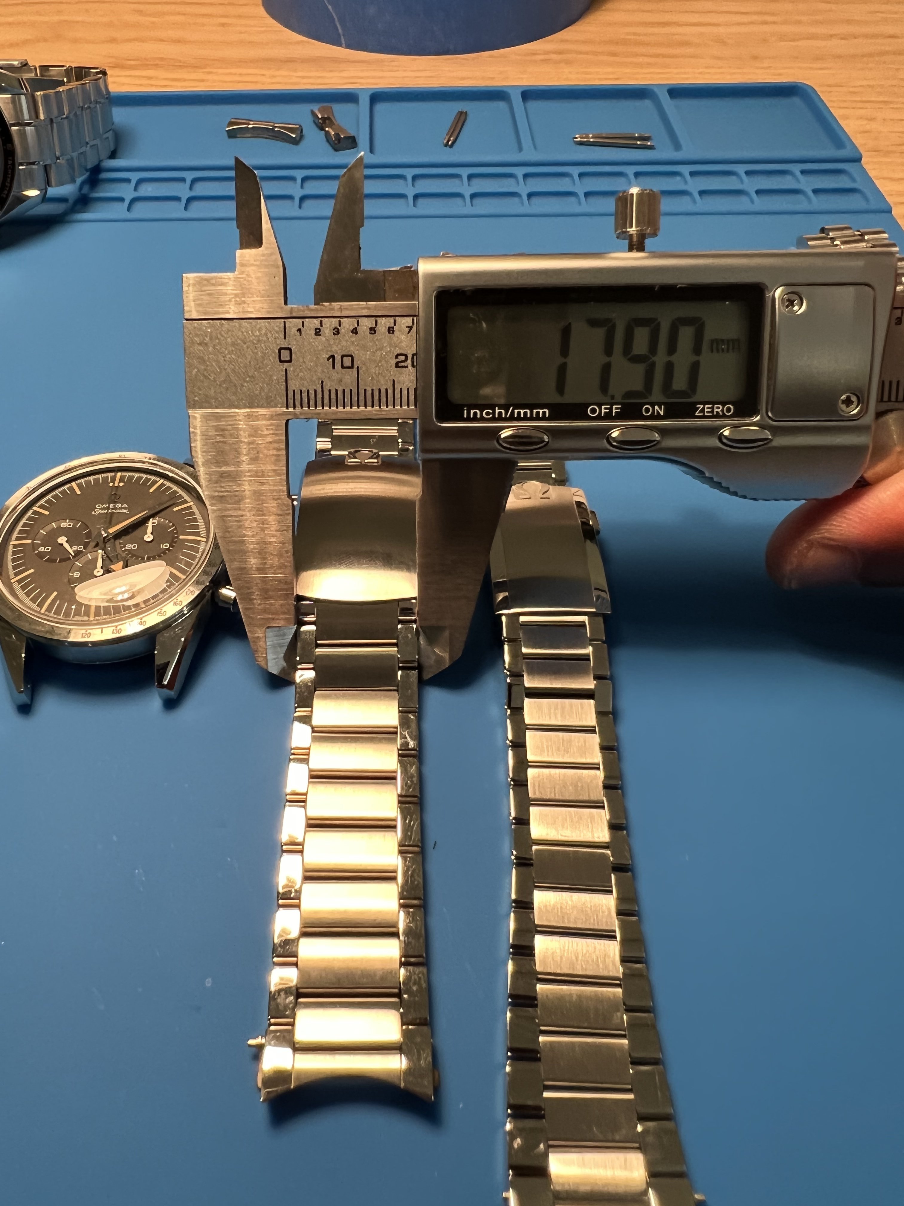

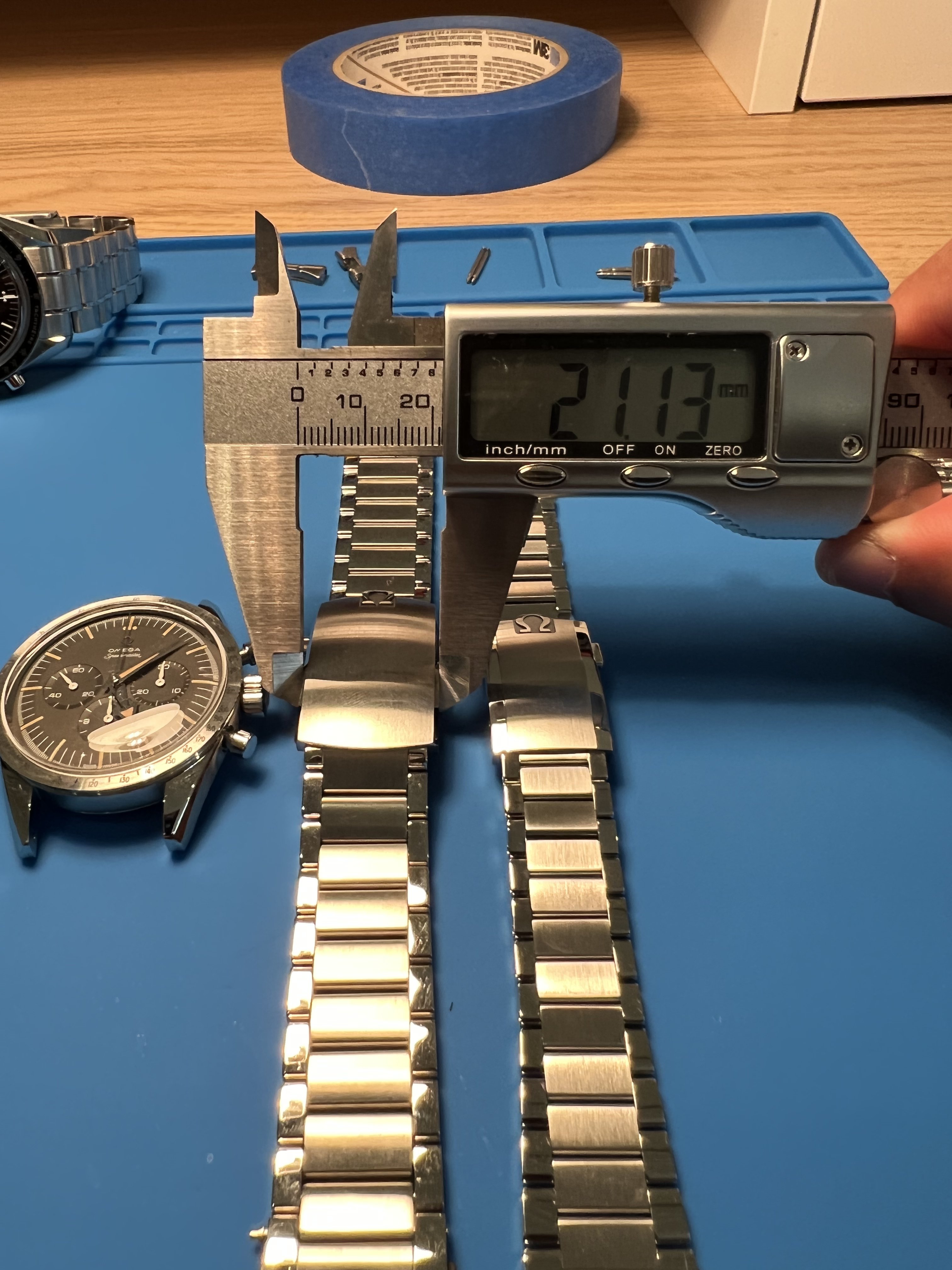

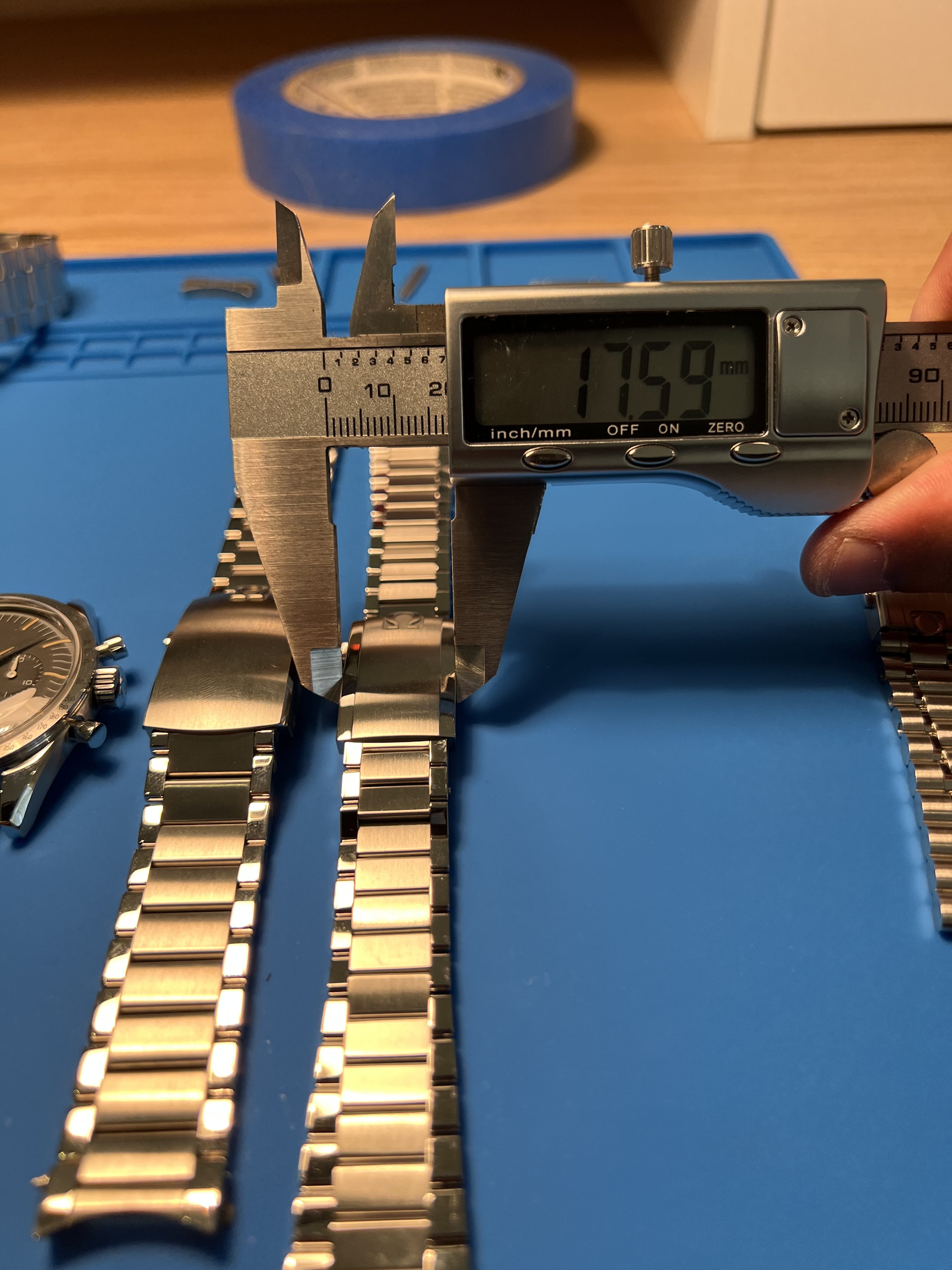

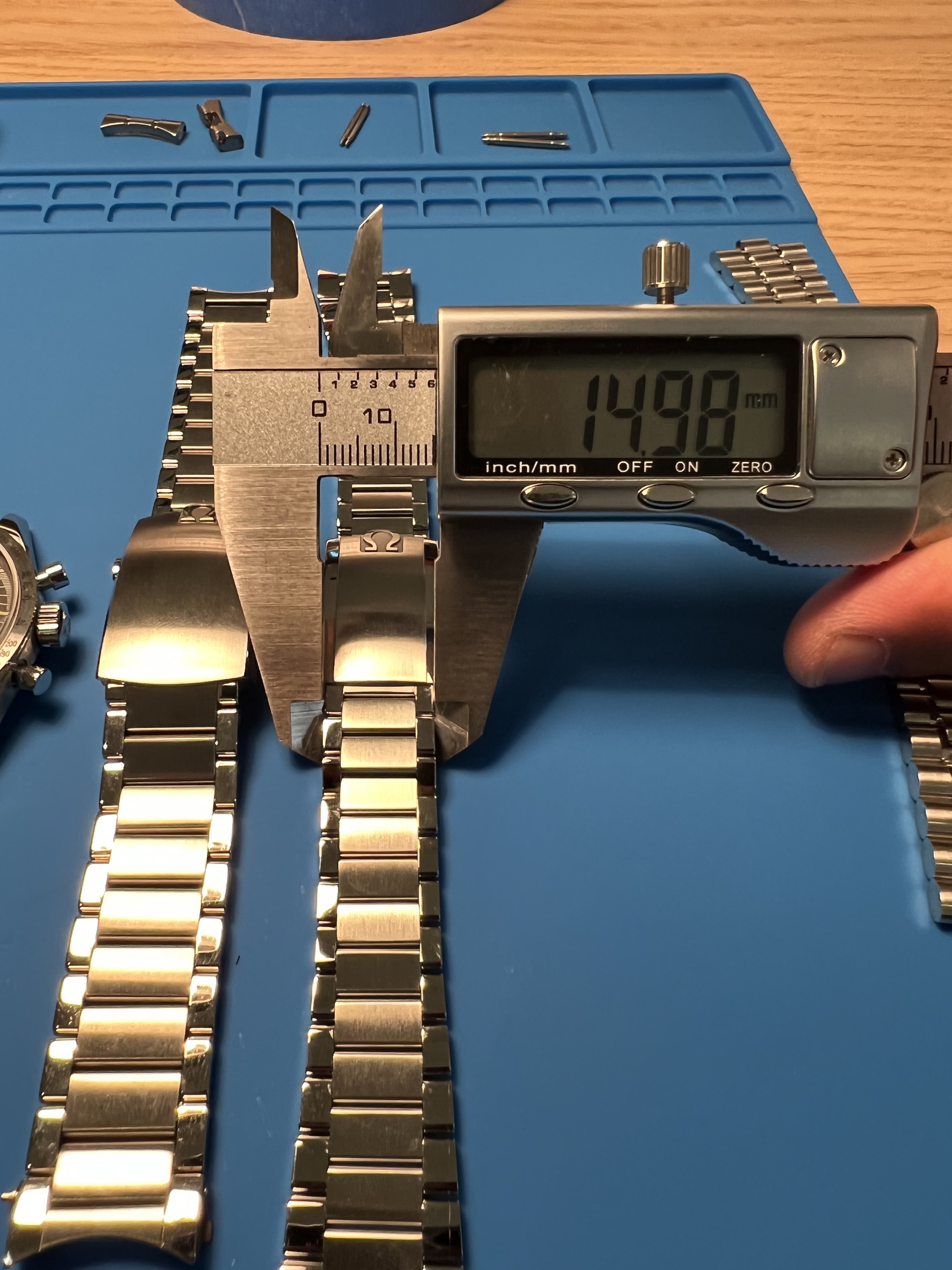

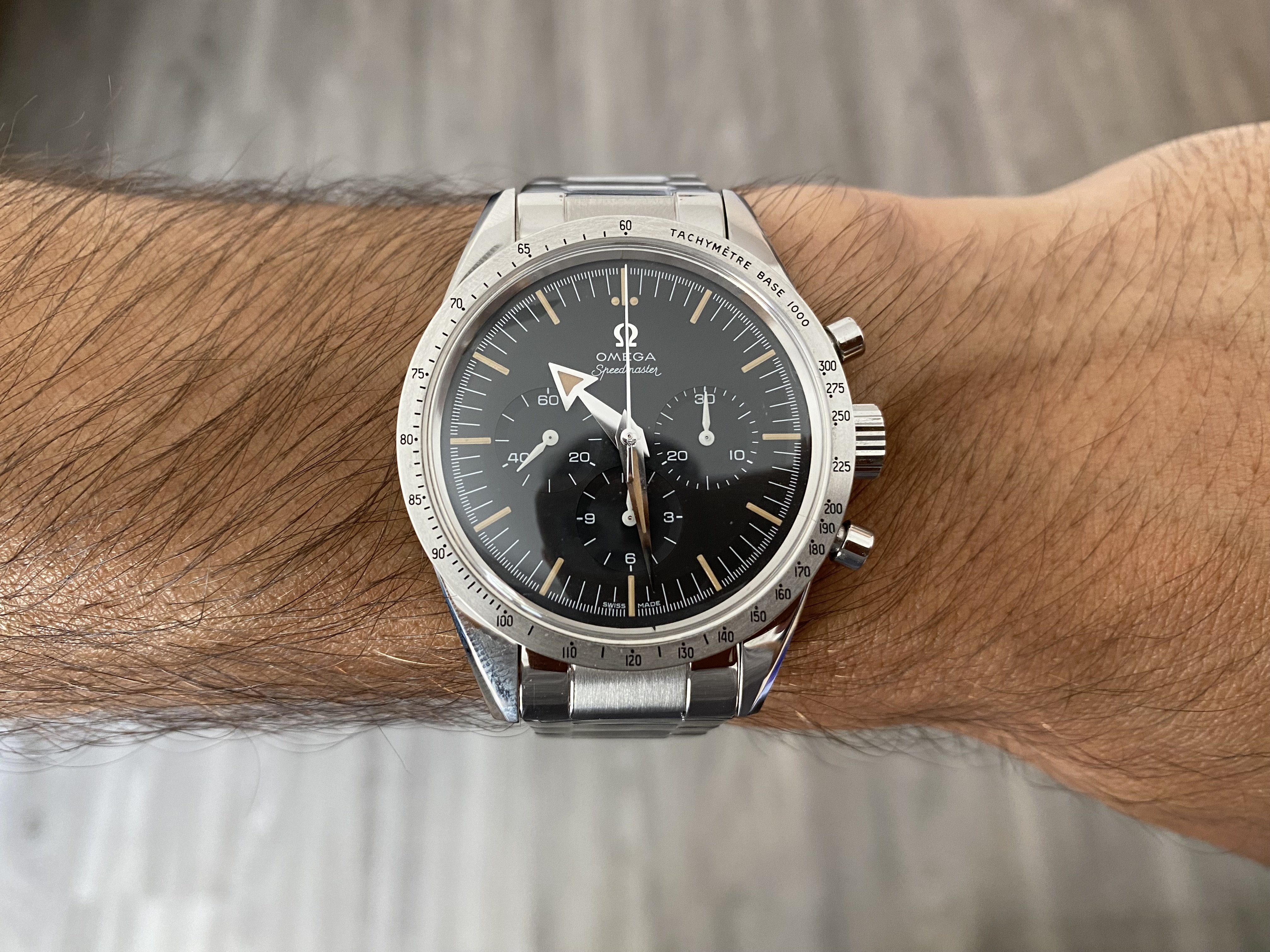

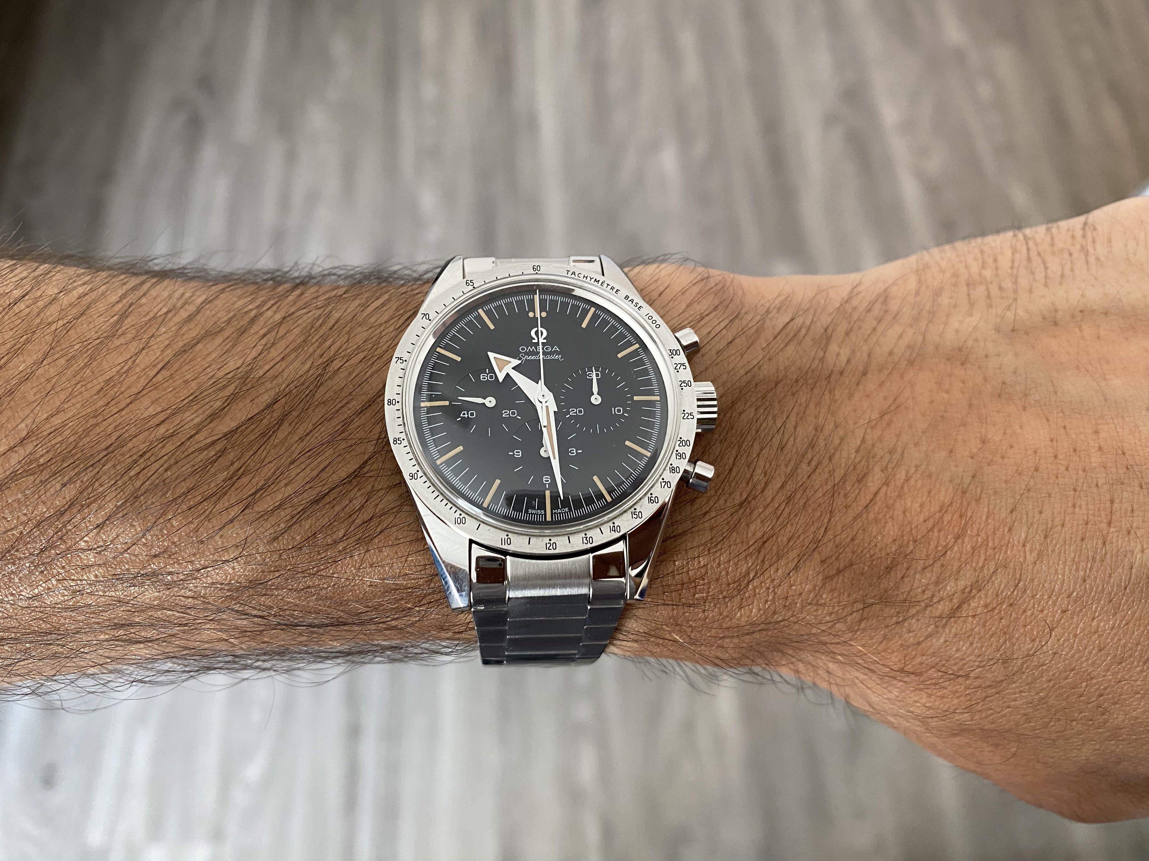

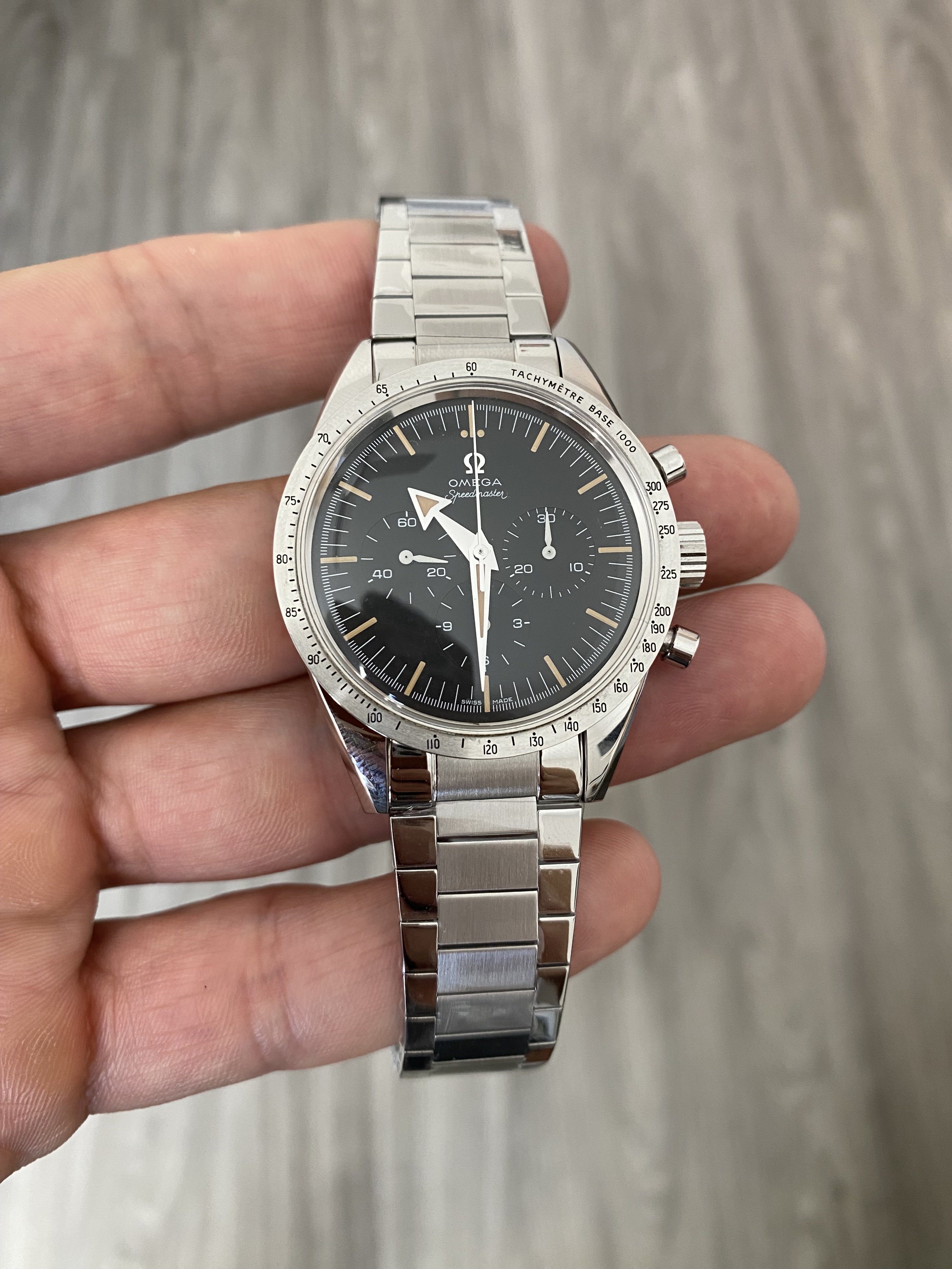

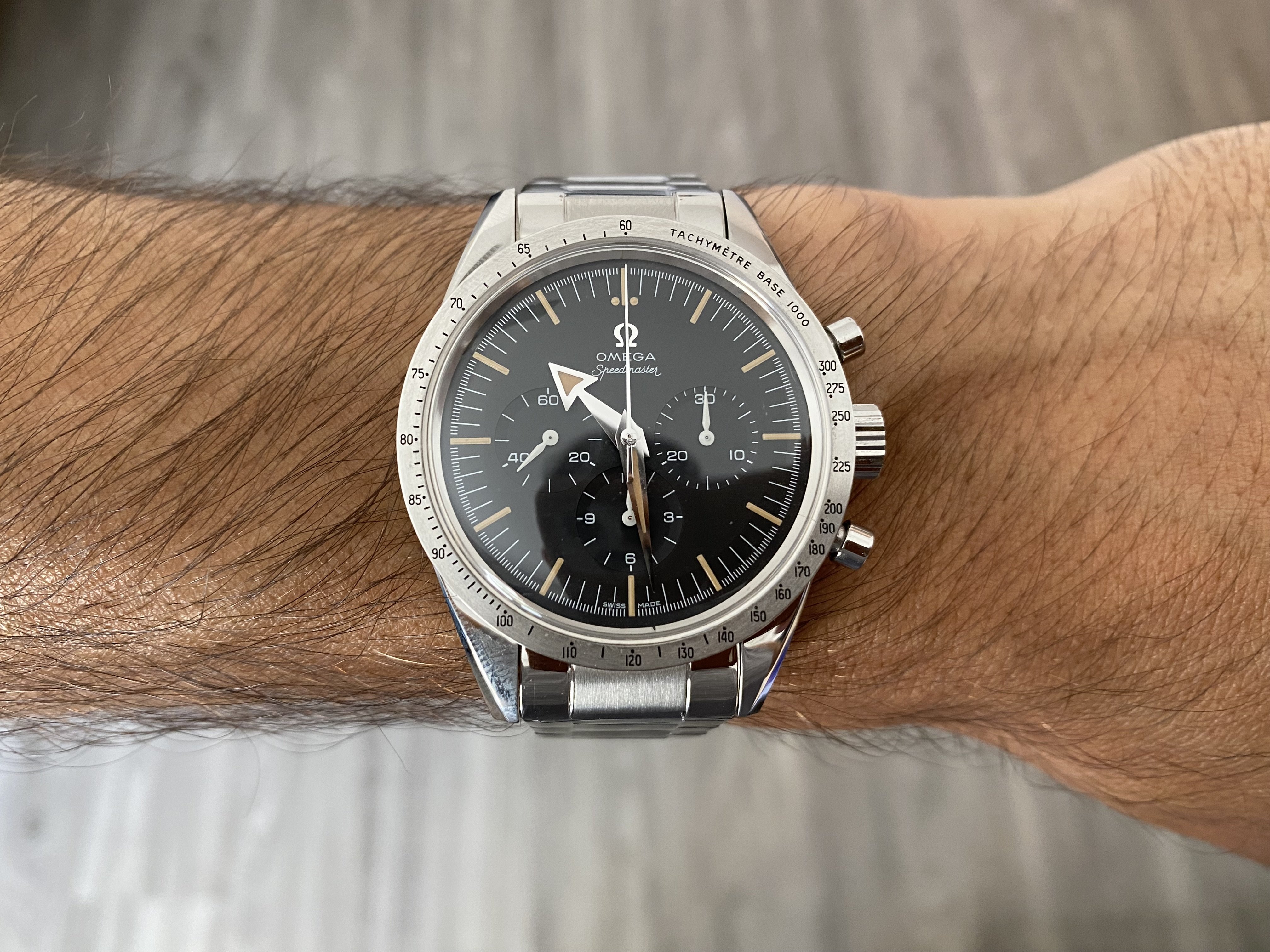

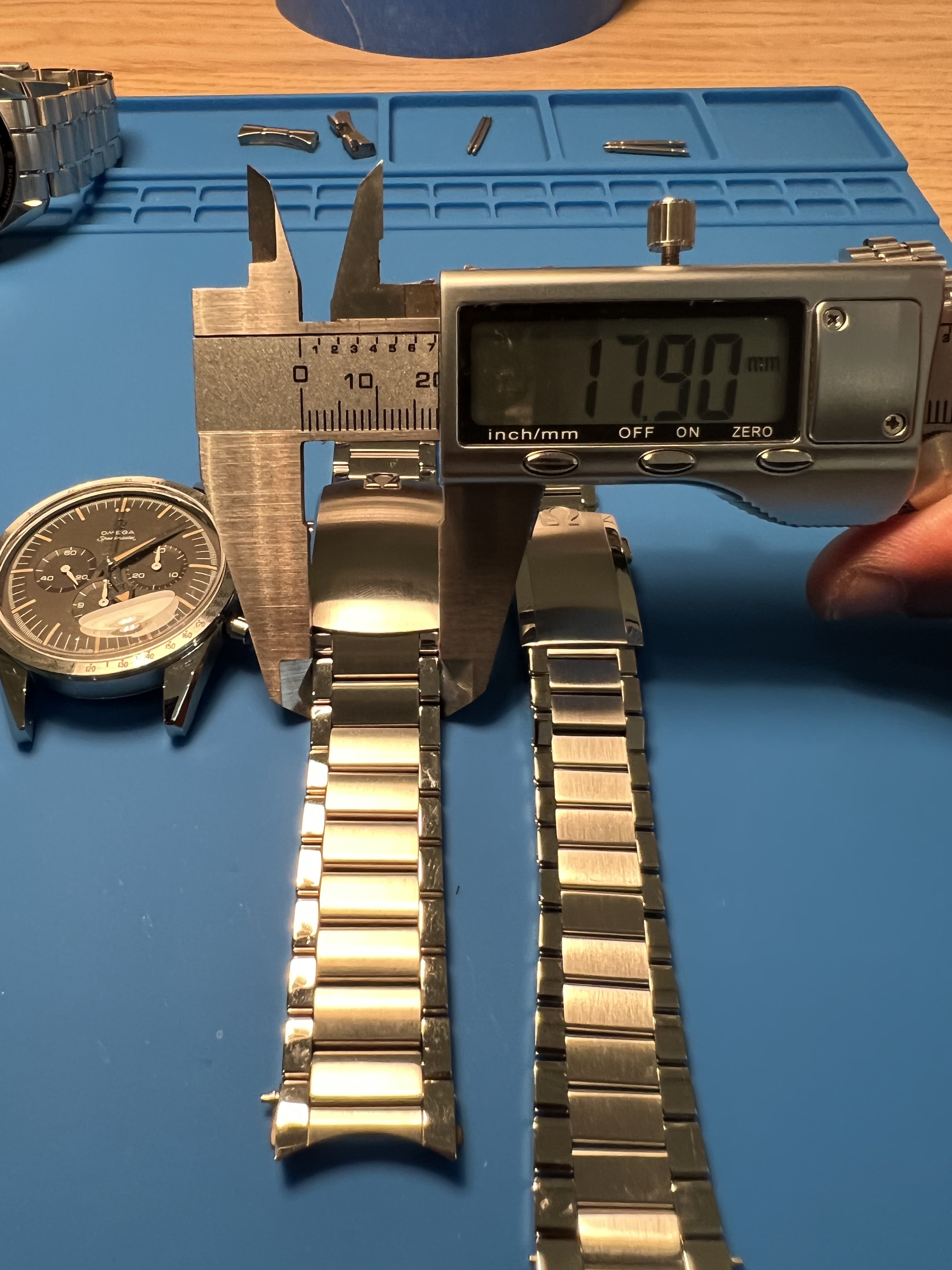

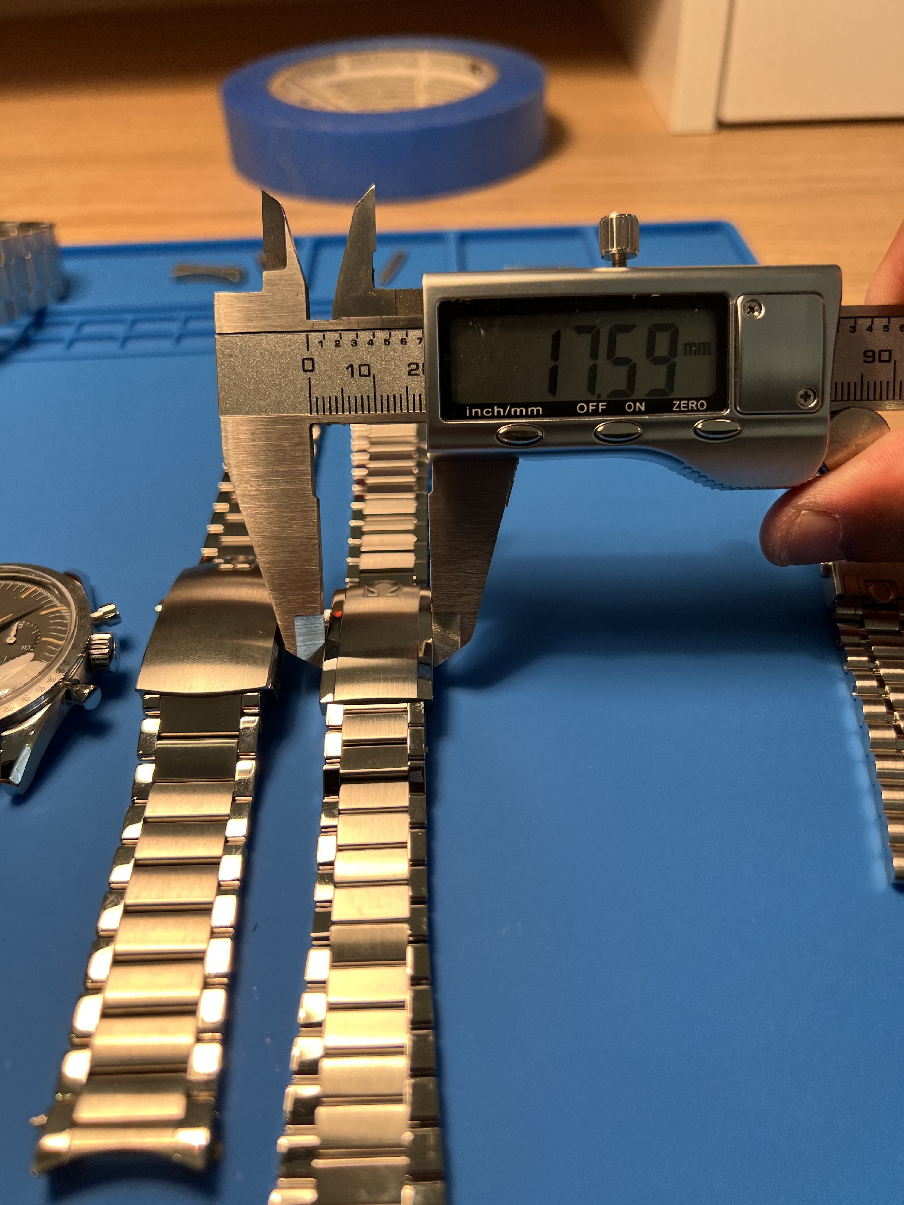

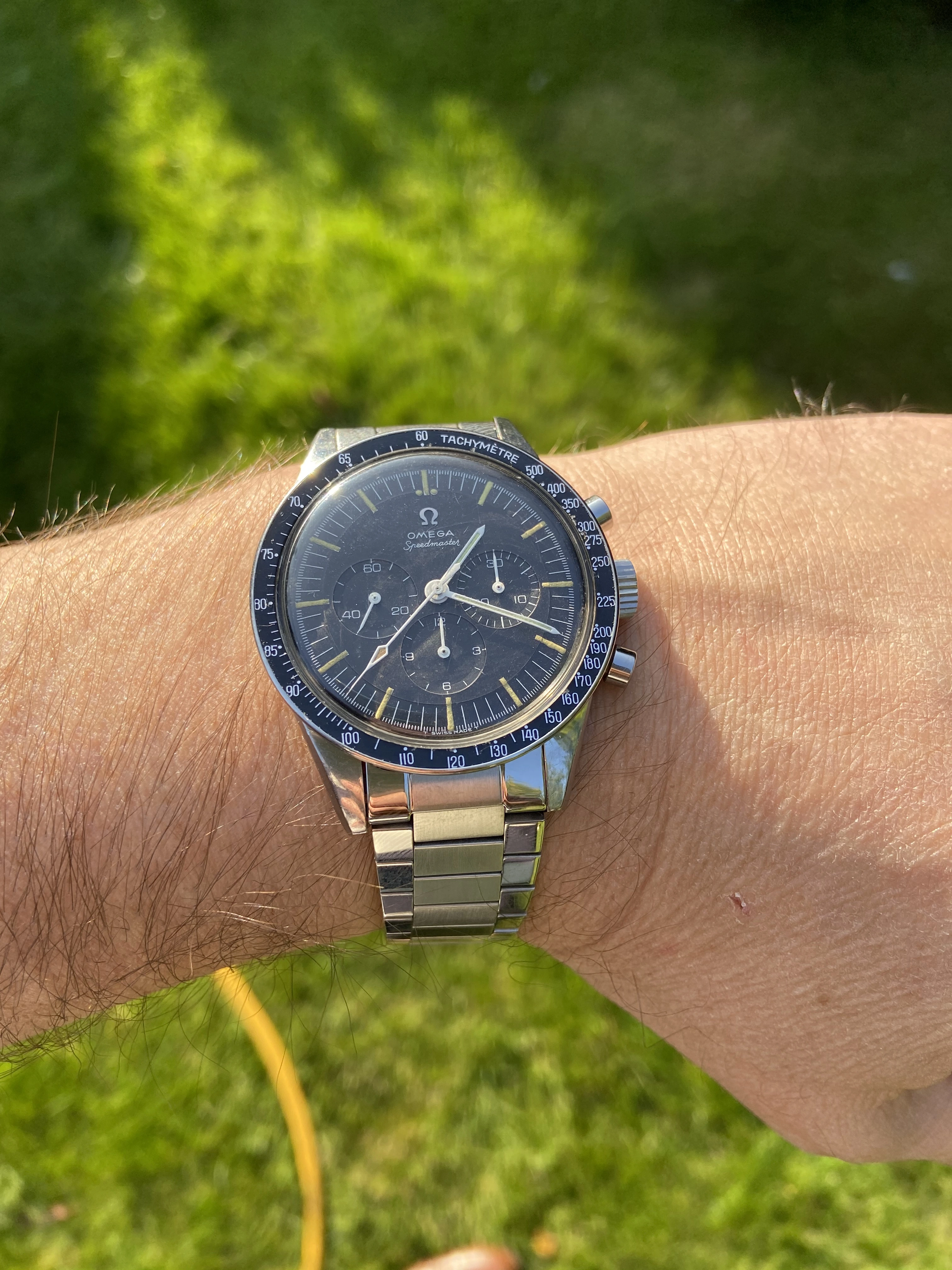

This thread has been dormant for a while, so another question: in the reverse of many of the posts, can anyone either confirm or speculate as to whether the Trilogy Speedmaster bracelet will fit without issue on either a new, or vintage Ed White? Thanks.
10,831
16,851

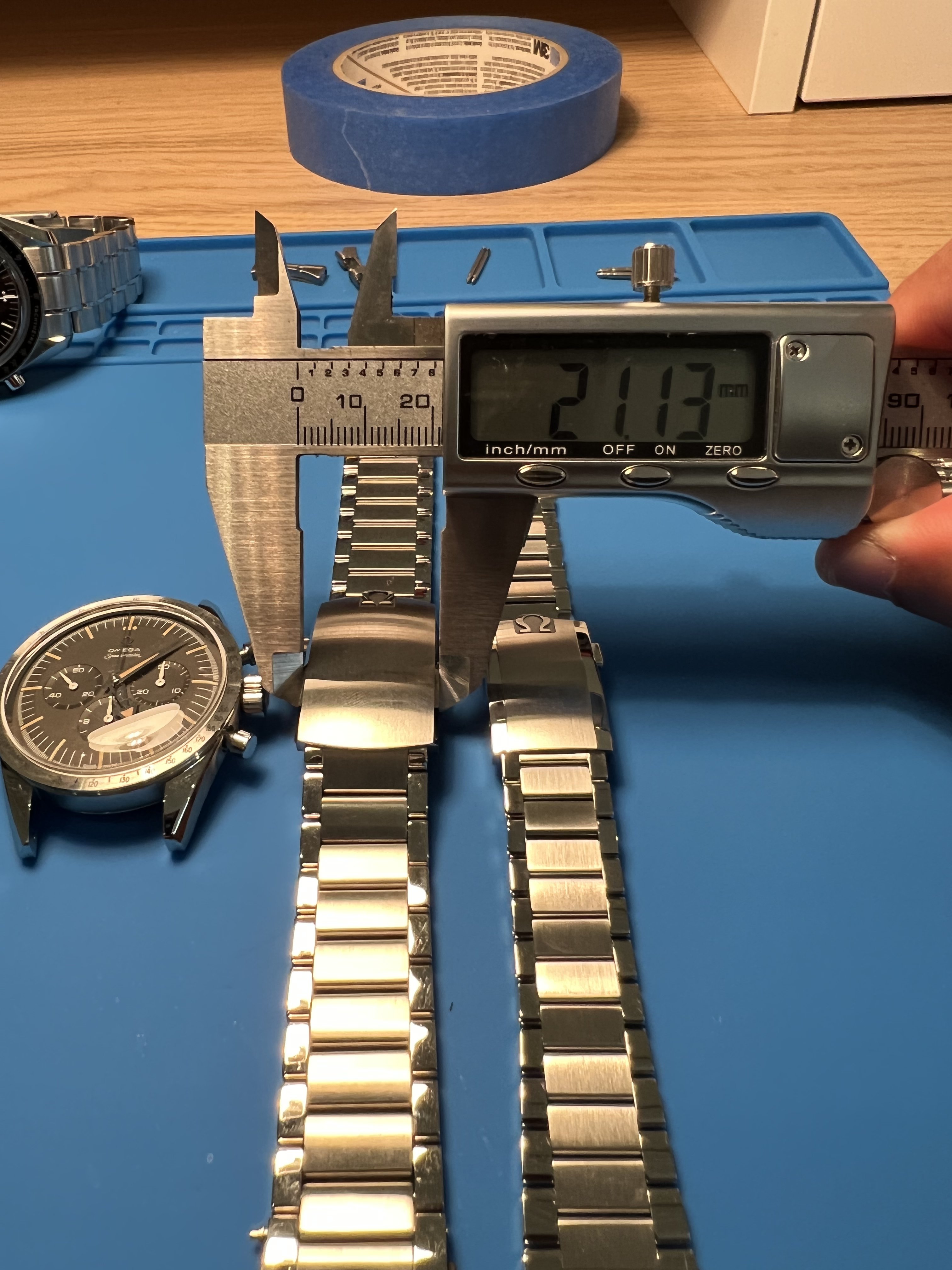

Yes it does in the case of the vintage with a little persuasion. I’ll attach a pic shortly.
