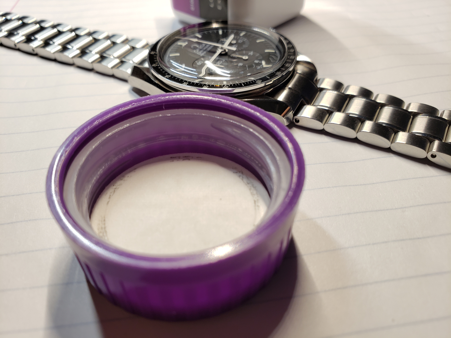

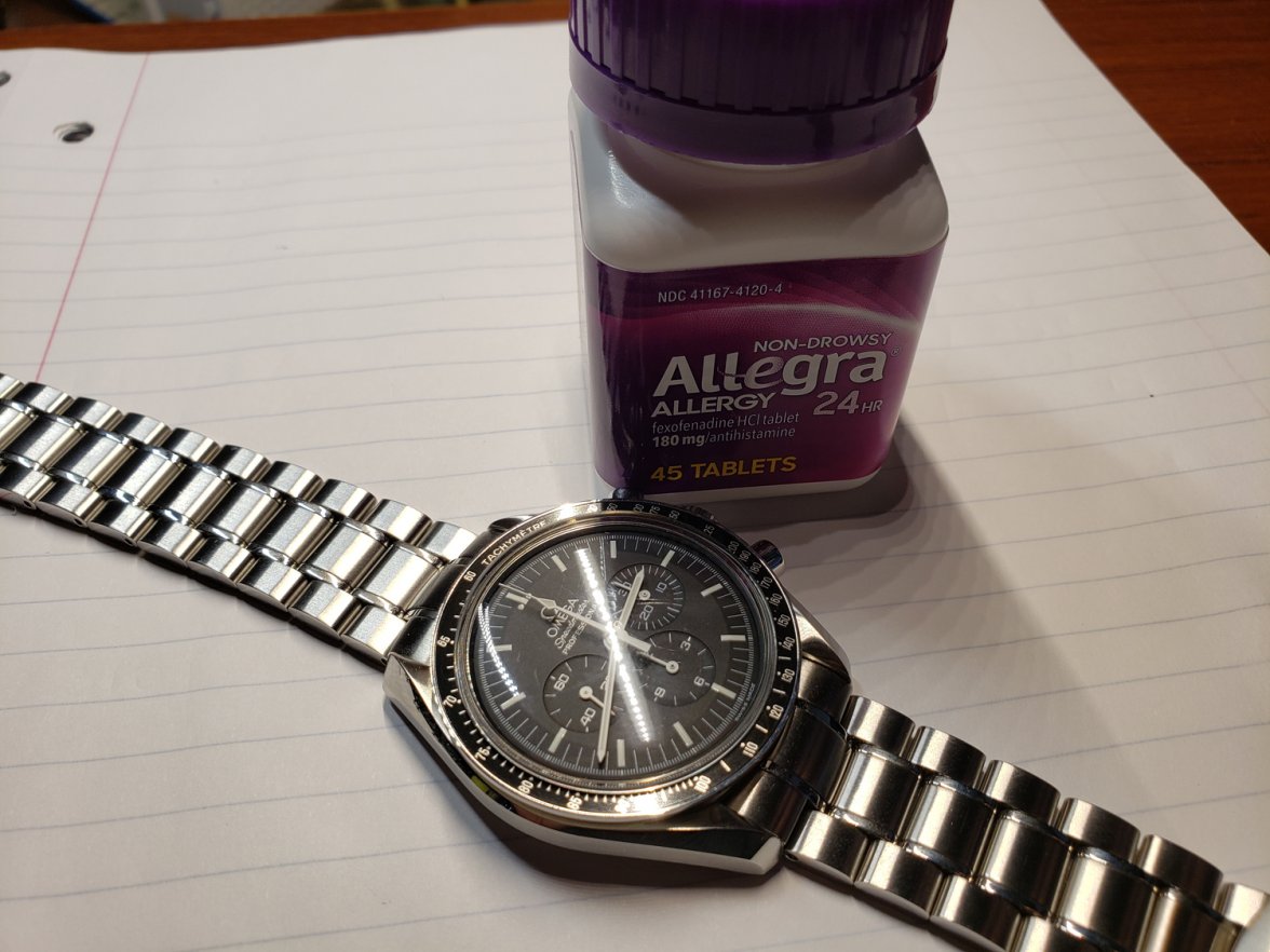

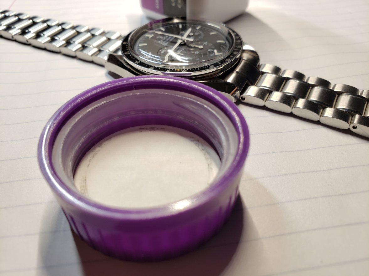

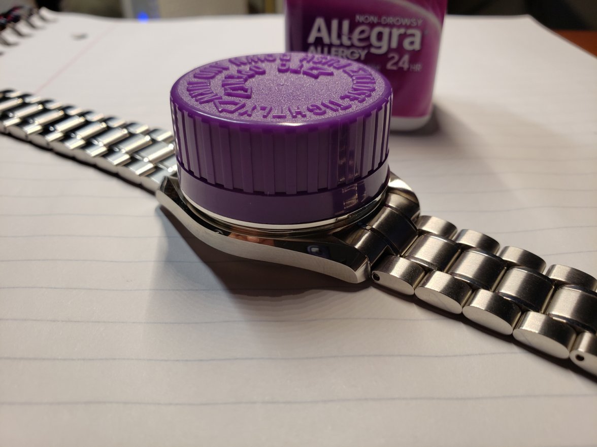

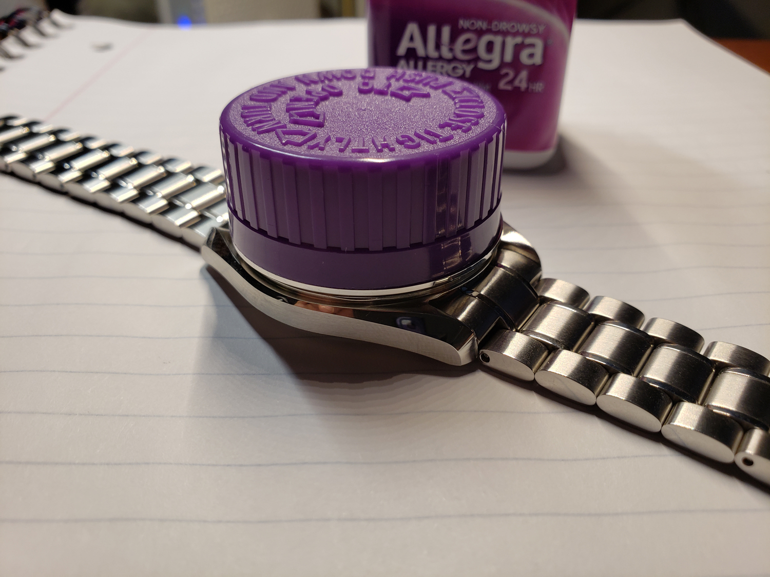

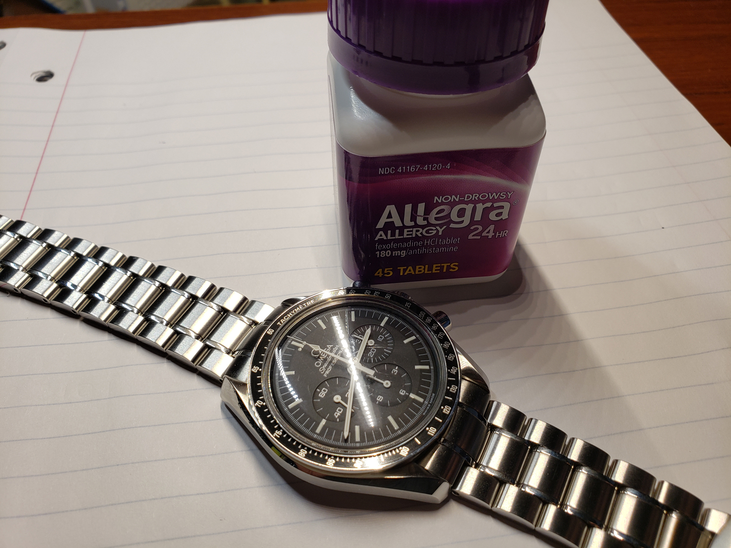

I also have one of those cheapo eBay crystal press tool as pictured and it doesn't clear the hesalite. If you put too much pressure, it will crack the crystal. However, I happen to have a seasonal allergy problem so I've found that the cap of an Allegra bottle clears the crystal and sits on the metal edge of the bezel perfectly (instead of pushing on the fragile aluminum insert), so I place that on top and then use the crystal press LOL
Protip: use some masking tape to hold the aligned bezel in place before using the crystal press to prevent it from shifting

I tried the allegra trick above (who doesn't have allegra!?), but it doesnt fit in the bezel press with the watch.
