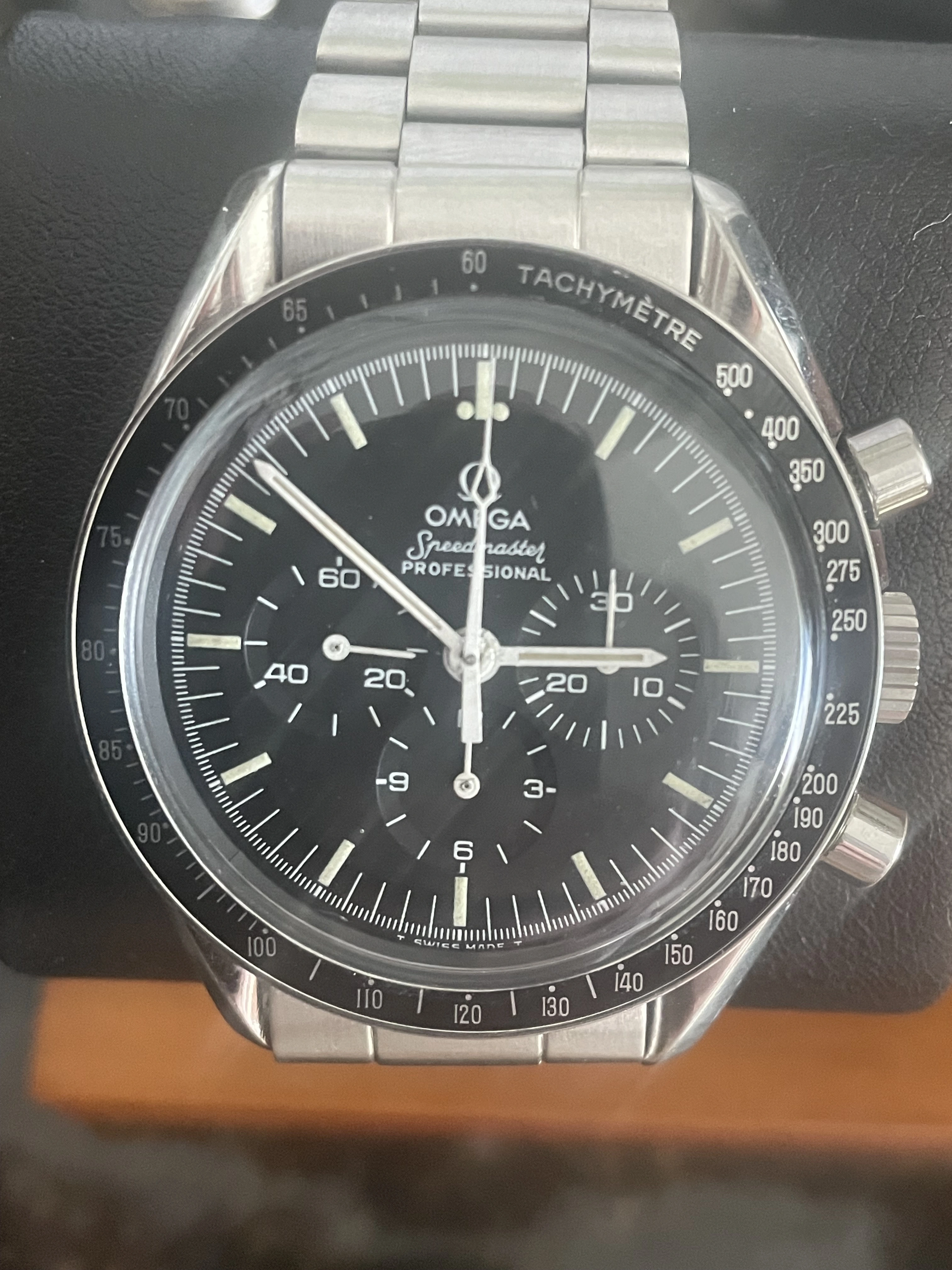

Hello everyone. The watch pictured below is a very sentimental Speedy I’ve had for years. It’s being restored as we speak. I’m aware that the bezel isn’t correct for a ‘79 Speedy. I’m pretty sure I need the No Accent version. Can I tell if the one on the watch is an original Speedy bezel just from a later watch? is sourcing an original is even worth the effort? I’m seeing some very high prices for supposedly original ones. Is there a reputable source for these where I can be assured it’s original and the correct bezel? Just looking for any advice.

You will need to open watch for ref number inside Caseback, and movement serial number to confirm what you have. 145.022-74 and 145.022-78 were produced in 1979, and if you have one of those you are correct, the bezel would not have the wide C or the accent which were on watches from the 80s.
There is no 145.022-79 BTW.

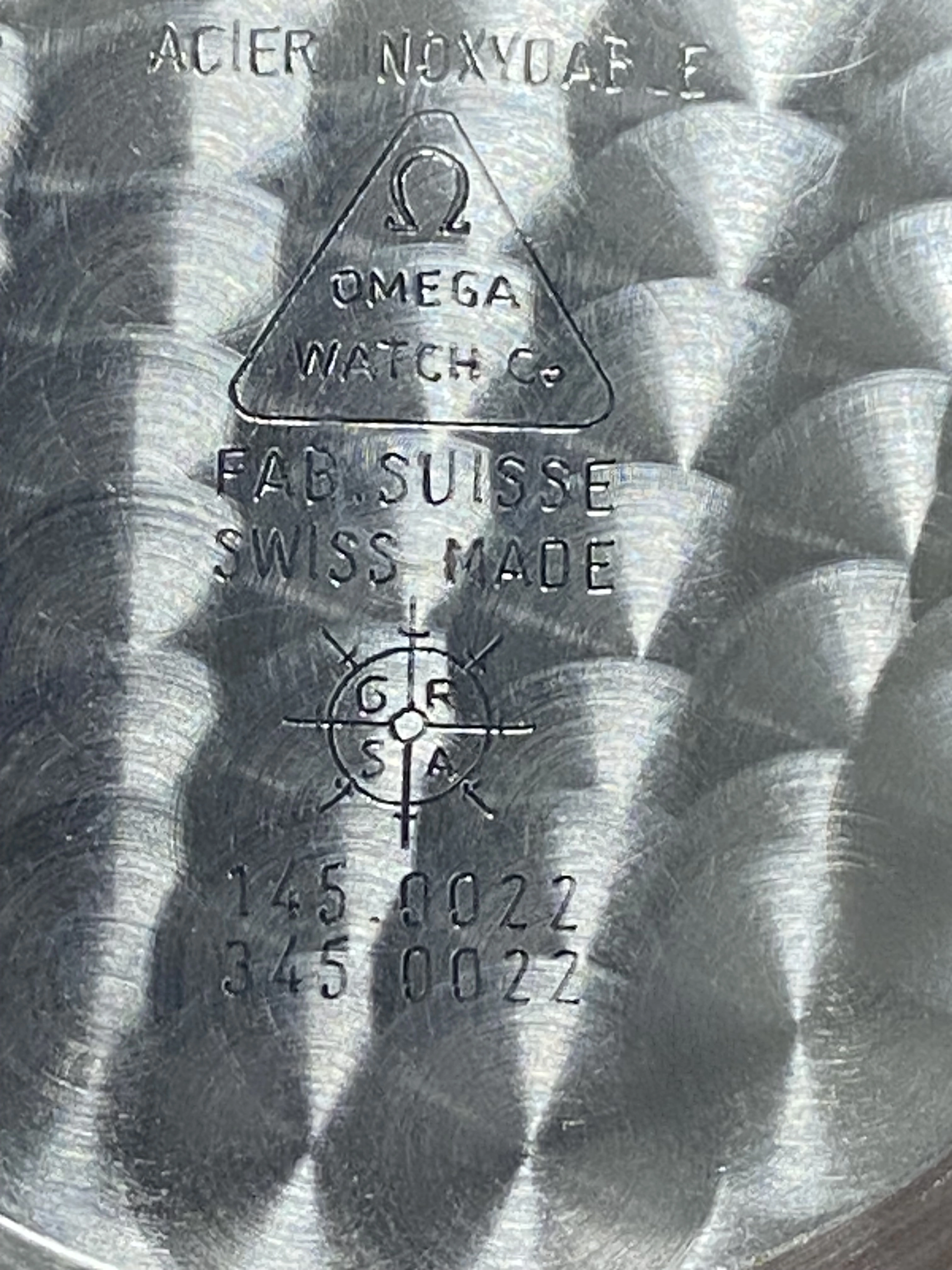

How would I find those numbers? Here’s a close up of the inside of the caseback. The serial number of the watch is 44821*** which I think is 1980 not 1979.

You have found the data . Consulting MWO and ilovemyspeedmaster.com suggests:
1. movement SN from Oct 1980 and correct for either 145.022-78, or 145.0022 80s.
2. The Caseback with dual reference and bezel is from later PIC 3590.50 version manufactured from 1988-1996.
So it seems that you have an earlier movement transplanted into a later case, sometime during a service. Not uncommon. I would just enjoy it as it stands I don’t think you will improve the watch by trying to change it now.

Thanks so much for that information! I guess this may be why the watch was so cheap. I got it for $1200. So, I guess even if it’s mismatched it wasn’t a bad deal. Like I said, it has sentimental value, and that’s why I had it restored. I’ll have to post some before and after pics later. I guess I’ll just leave the bezel as is and not worry about it now.

Good price I think. The late 80s- 90s watches with tritium are sought after and often go for 3x that price. The earlier movement is really not that big deal IMO as these are generally considered wearable , rather than collectible.

Good plan just to leave the watch as-is. It's a totally wearable example, and there's really no plausible reason to restore it with circa-1980 parts.

Thanks for the insight. I’m not sure if the dial came from the 1980 movement or the later case. I may never know. I do know it came with a 1171 bracelet.

Agreed. The only reason I had the case laser welded and restored is because it had been overpolished to a terrible extent. I’ll never sell it anyway due to the sentimental value. Thanks for responding!!
