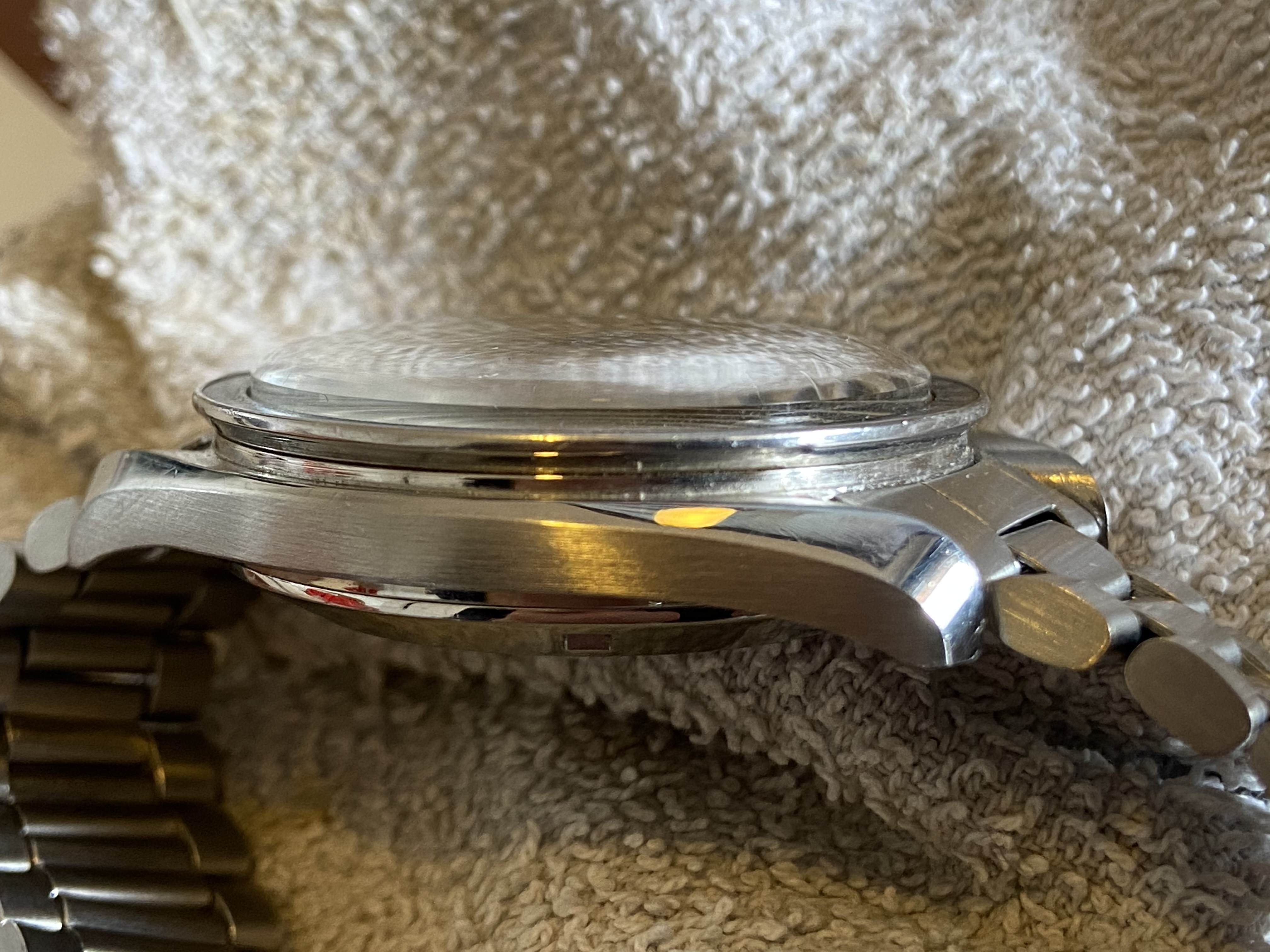

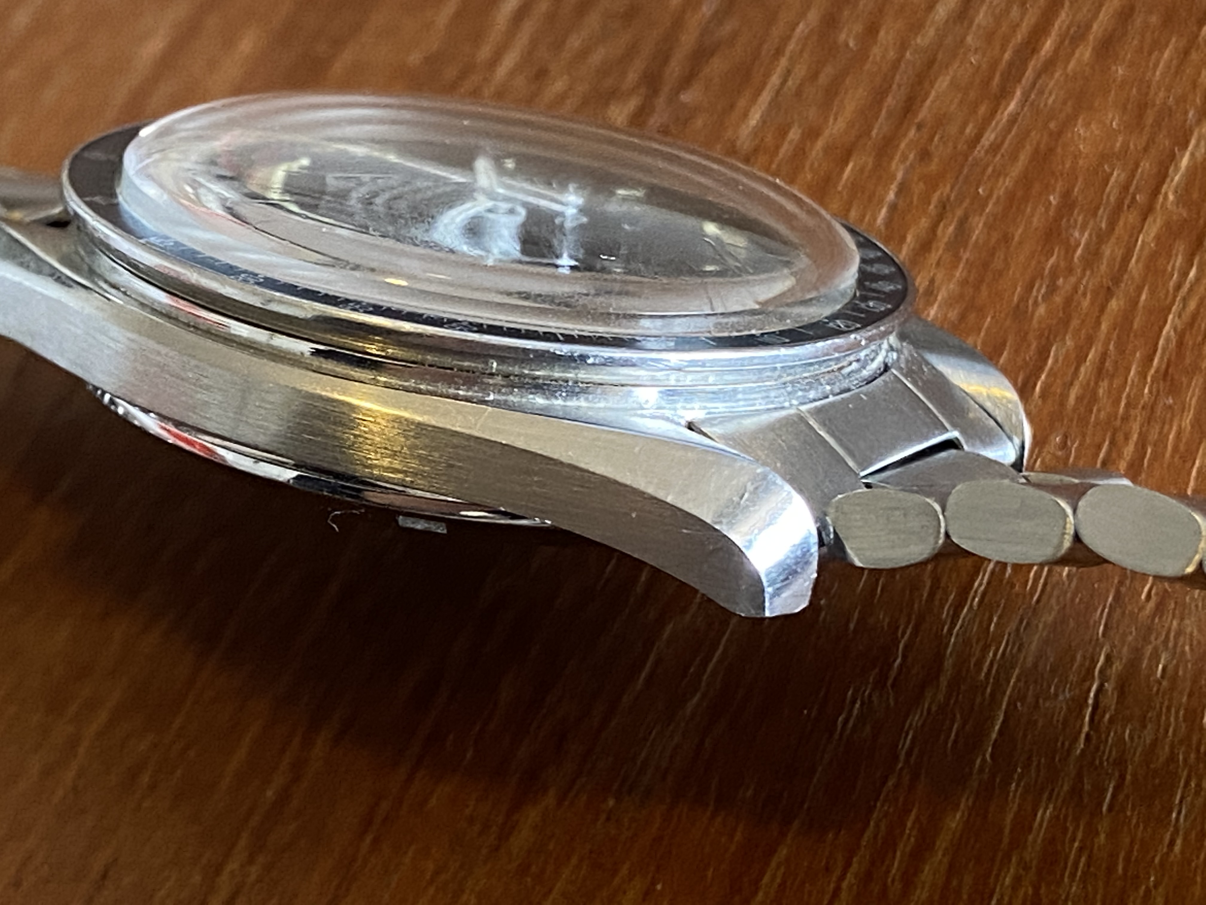

Hello,
I've bought an old speedmaster 145.022-69 or 71 and it looks like it's in a very good condition. Maybe too much...
The seller told me that the watch had only a service in the early 80s, and that nothing has been changed.
It looks like it stayed a lot in a box since.
- The case is sharp, brushed and glossy, looks like unpolished to me.
- The DNN Bezel is a little faded. Nice patina.
- Crown and pushers are originals
- The glass is with the old omega sign and looks like original
- The bracelet is a 1171/1 633 ( service in the 80s...)

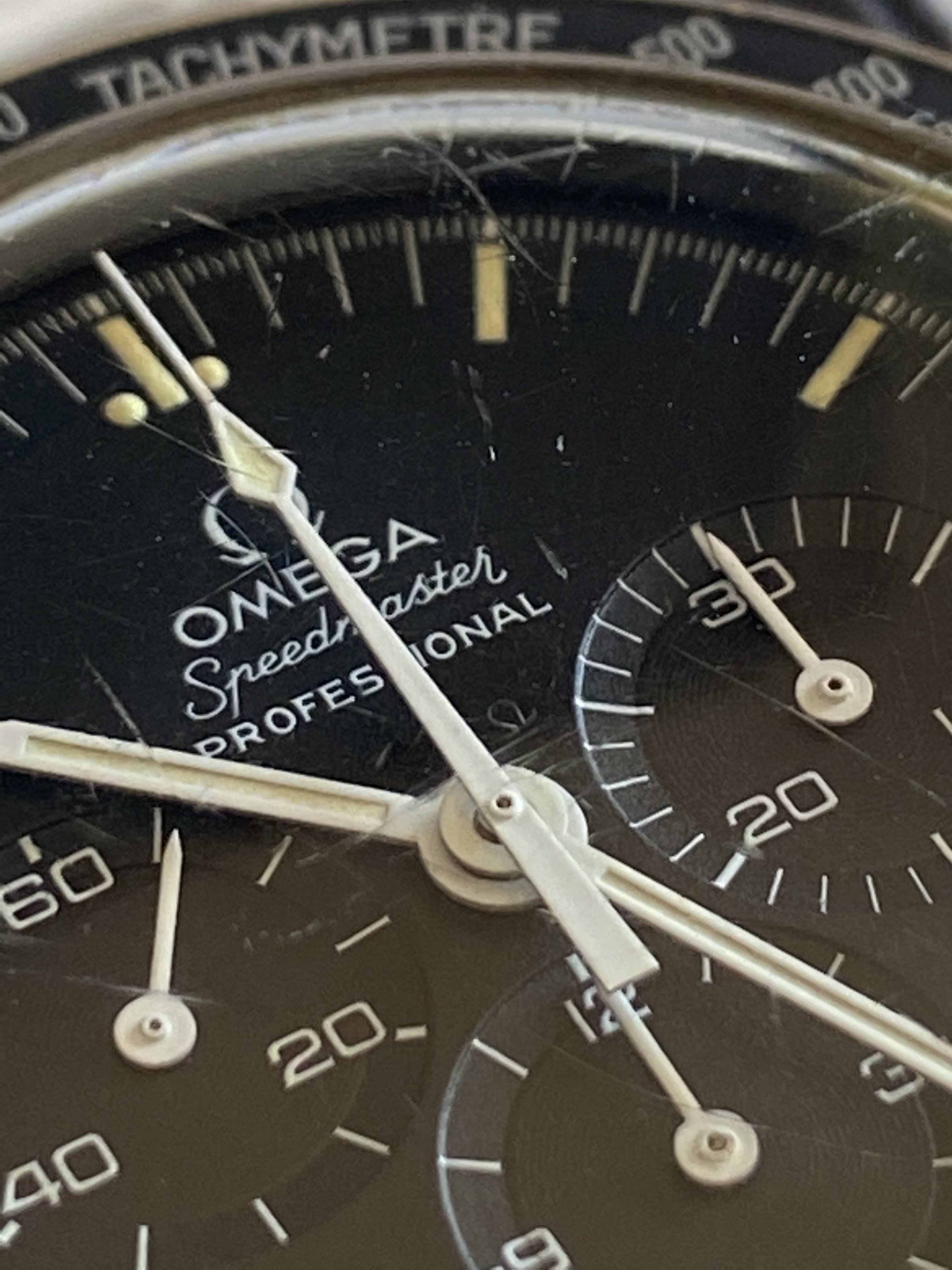

- The step dial and the hands have a yellow lume. Almost no light in the dark when I wear it. When I use my iPhone light (like 5 sec), it's a really strong and fade away then after a minute or two. I tried with an other 69 speedmaster (almost no light) and with my Tudor BB58 (strong light and no fade away).
Same thing about the hands.
- The mouvement is 28.42.XXXX (correct for a 69) and the caseback is 145.022-71. This is something unusual, I ordered an archive extract. I'll see...
My question is about the couple dial / hands. Is it relume for you or is it just normal after a long time without any sunlight?
Thanks!

Looks ok to me, and a (very) nice Speedy by the way 馃憤
that鈥檚 an unusual serial to see in a -71.
otherwise I like it
you may well have got a really nice 69 missing it鈥檚 back, for the price of a 71

I believe serial is too early for a DNN, should be a DON. But the dial and case are very nice.
24,836
55,255
I don't think the extract will tell you whether the movement is for a -69 or -71. It will just say 145.022. Wasted money I'm afraid.
As noted above, wrong bezel and case-back.
Correct. DON through about 30.5M IIRC.
Indeed.

So, someone scavenged two high value items.
still a nice watch! wear and enjoy!

I'm glad if the dial / hands are originals and not relumed.
I have some doubts too about the serial and the case back. The mouvement, produced in the era of an early 69, may have been use for a 71. I won't be surprised... Omega has done some weird stuff back in the time. In this situation the DNN and the case back can be ok.
I hope I'll have the extract soon to figure it out. The date of production may indicate if it's more likely a 69 or a 71 no?
The price was good, even for a 71, so if I have to change some parts, it will be ok and a nice and fun hunt!

Generally 28.42X.XXX is January 1970 so this is most likely a 145.022-69 with a swapped caseback and bezel.
Unless the extract comes back with a later production date for some odd reason then we could categorize this watch under "Anomaly -71"

Very nice good logo shape on the glass.
And what a case!馃憤
