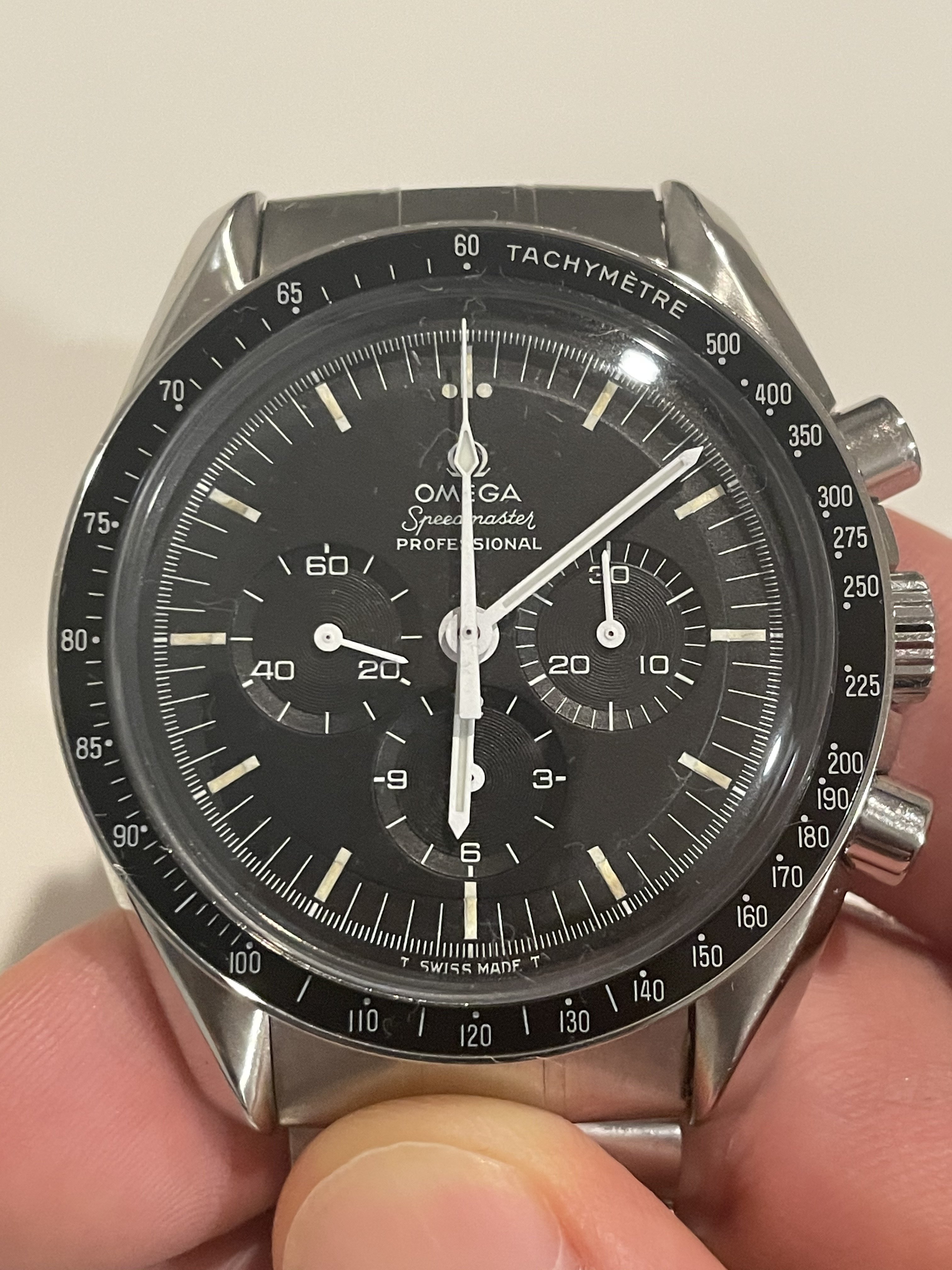

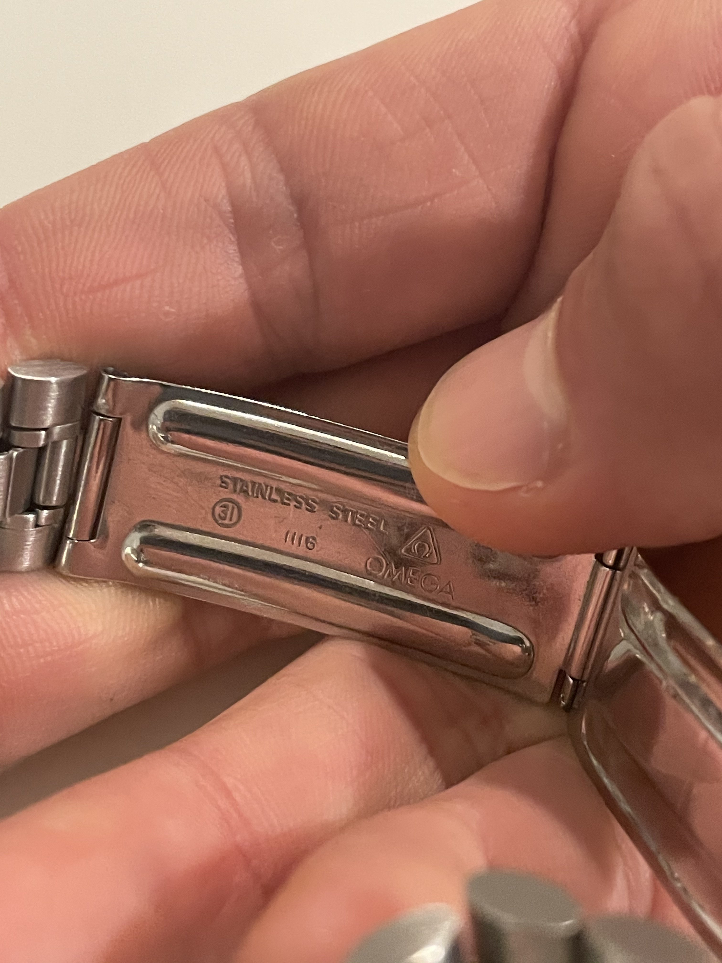

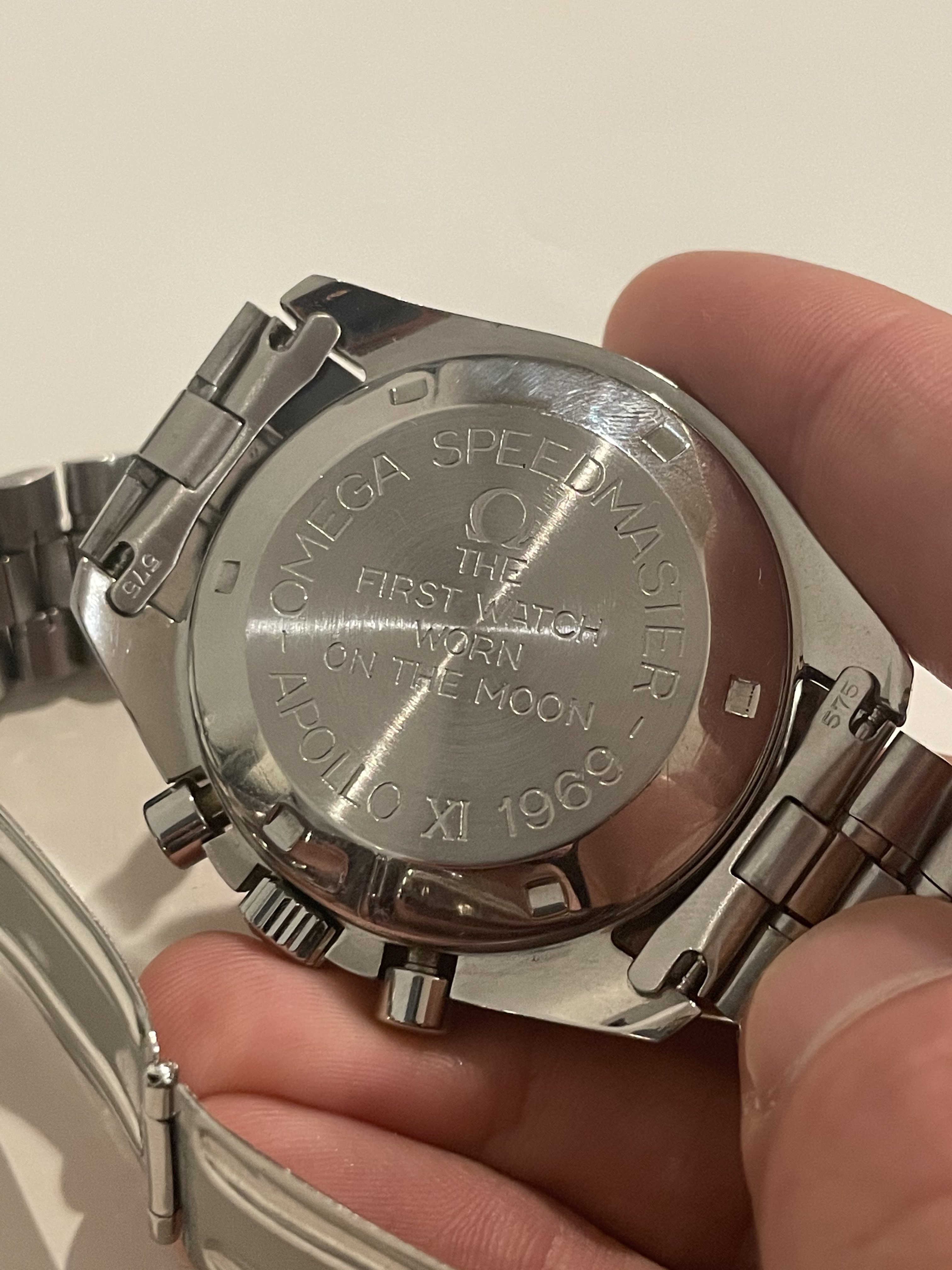

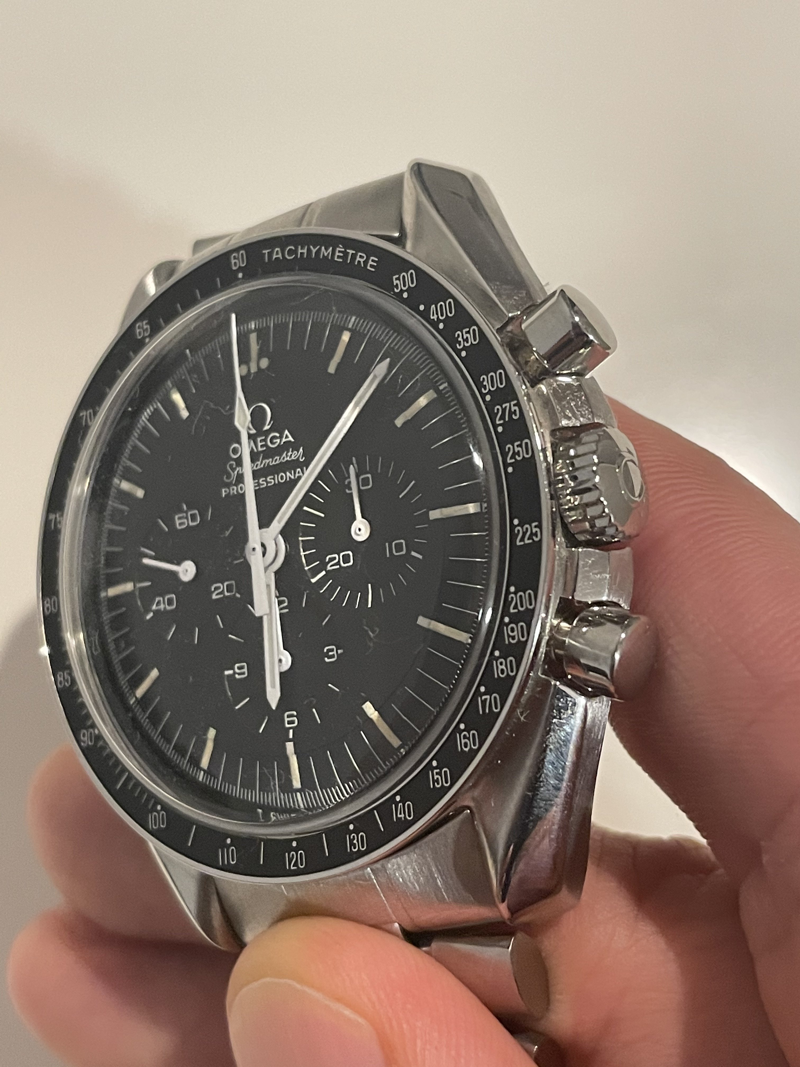

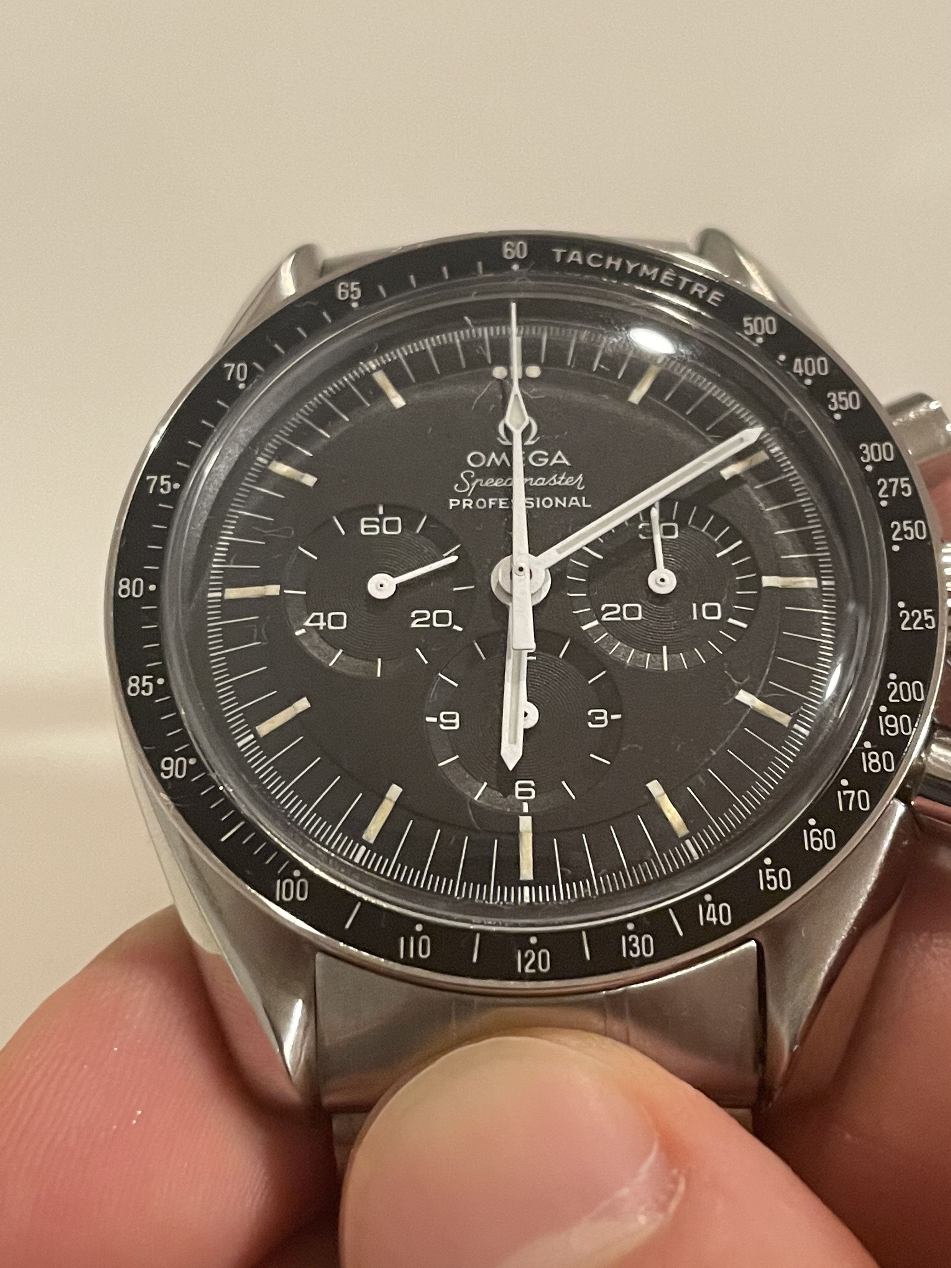

I was able to get some photos of a specific one I'm considering. This is the 145.022-69 I was referencing with the Apollo XI caseback.
Unfortunately I don't have photos of the movement but based on what I have, I'd be interested in help figuring out how much of the watch has been replaced with service parts. I can easily identify the mismatched bezel but am less confident on the other components.
Any ballpark value range would also be helpful. Thanks

Direct hypothetical answer; #2
IMO: Always buy the best quality you can afford, put together or inferior pieces will disappoint you in the end.
(Looks like service hands also but I am no expert)

That Apollo XI is a no-go for me. Service bezel and hands and a badly overpolished case.
More generally, you are comparing completely different watches. There is no way to guide you without detailed knowledge of condition and price for specific examples.
It's your job to decide which reference you prefer, since that's very personal.

If you want the Apollo XI, find a better example in my opinion. I agree with everything that Dan S wrote... the example you are interested in is a no go. It is not a collector's watch, however, if you are not interested in a collector's Speedmaster, and, If you like the watch, fine, it's your money and your pleasure. I understand the lure of the very rare caseback and if this is the watch and caseback you want and if you want to buy a watch that is collectible... then let the hunt begin, but get a decent example and be prepared to reach deep into your pockets...
Once again as Dan S has mentioned... it's very personal.

Somewhere, there is a white polishing wheel that is now black with metal oxide. I'm also a no-go, that midcase is wrecked and is never coming back.
