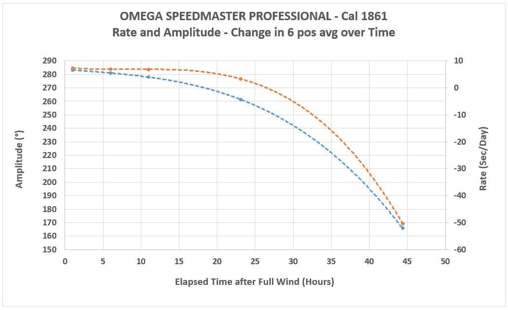

2,674
7,472
The concept of a 48 hour power reserve is a bit misleading. You might think it means running and keeping good time from the start to end of the power reserve cycle. However, the actual time-keeping accuracy of an Omega Speedmaster starts to decline after about 24 hours. I have a simple cheap time grapher and did a study to understand just how the Amplitude and Rate changed on my 1861 movement. See the graph below... it's why the best practice is to wind your watch fully at about the same time each day.
