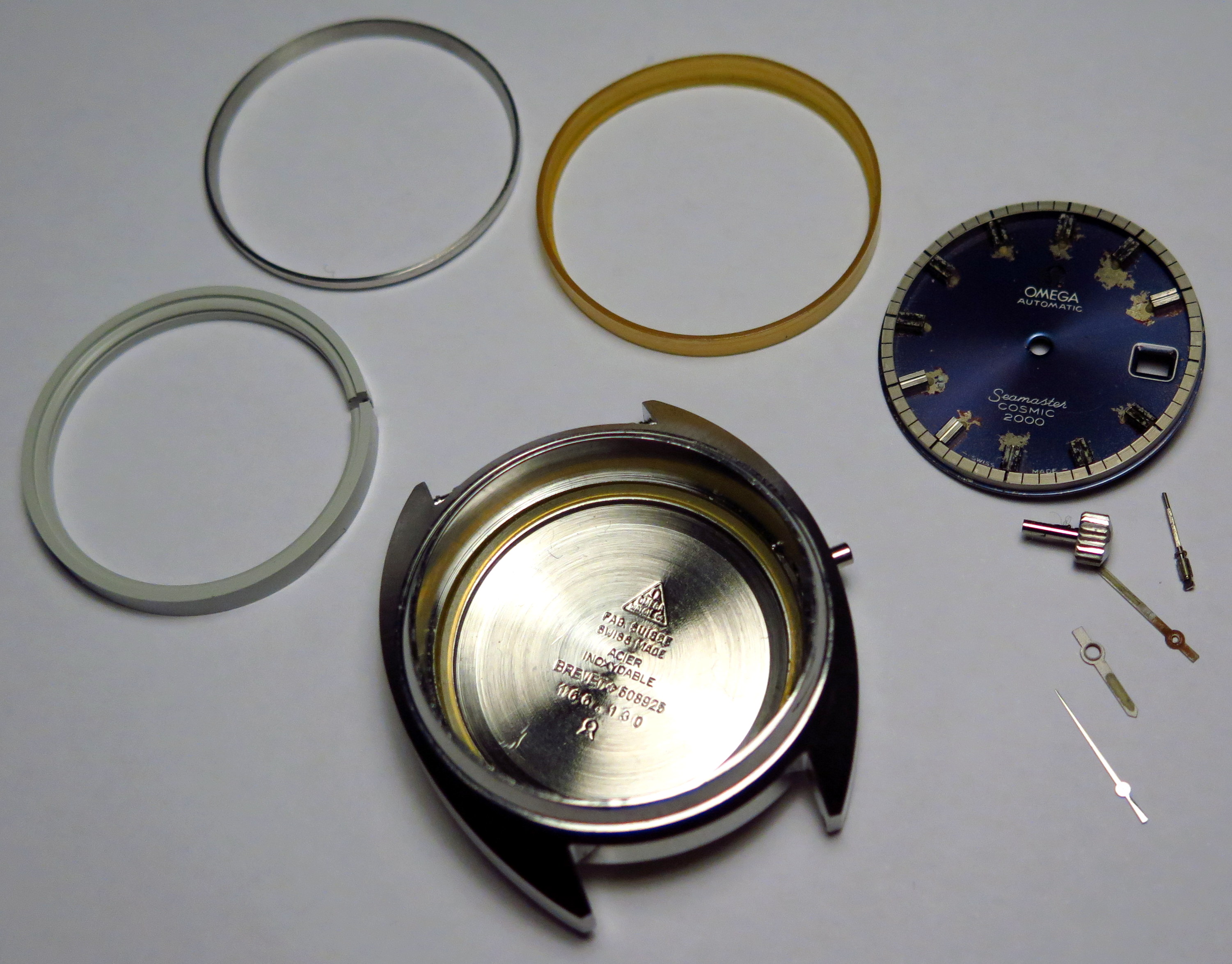

The problem with these projects is that cost-wise they are not too advantageous. Nowadays it is hard to get a NOS case for less than 120 Euros. A dial would be about 80 Euros; the bracelet for these costs not less than 80-100 Euros, and you would be hard pressed to find a genuine one for that price; then add plexi, hands, a correct crown and a service, and you are probably better off buying a complete Dynamic 1012.
In any case, the reference for the case is 166.175
You could as well try to complete a Cosmic 2000 with that movement:
Of course, there are also highly collectable divers which used that movement, but I suppose that getting from scratch all the pieces for a (non-watcho) SHOM or for a 1000 is next to impossible.
