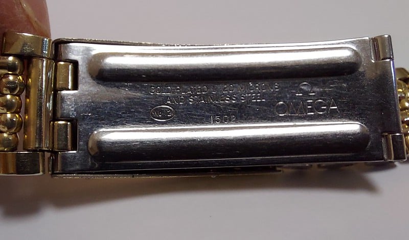

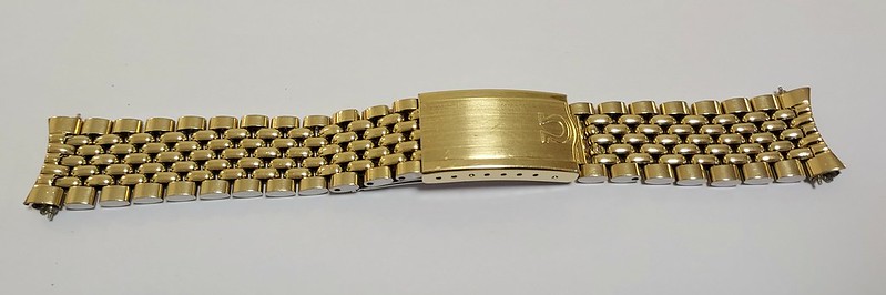

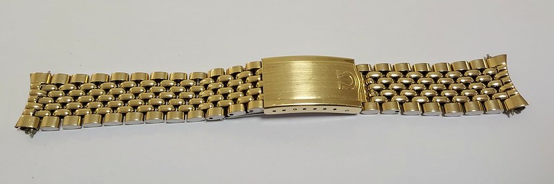

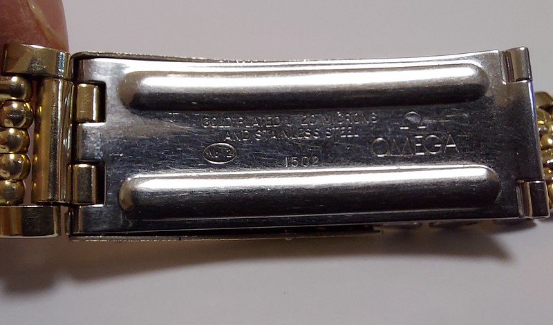

I had the (almost)same question, leading me to this thread. The difference is that mine is gold capped. Are the part numbers the same for the gold plated bracelet/links?
as I know, there are also 1502, gold plated
not my pictures, google helped:
