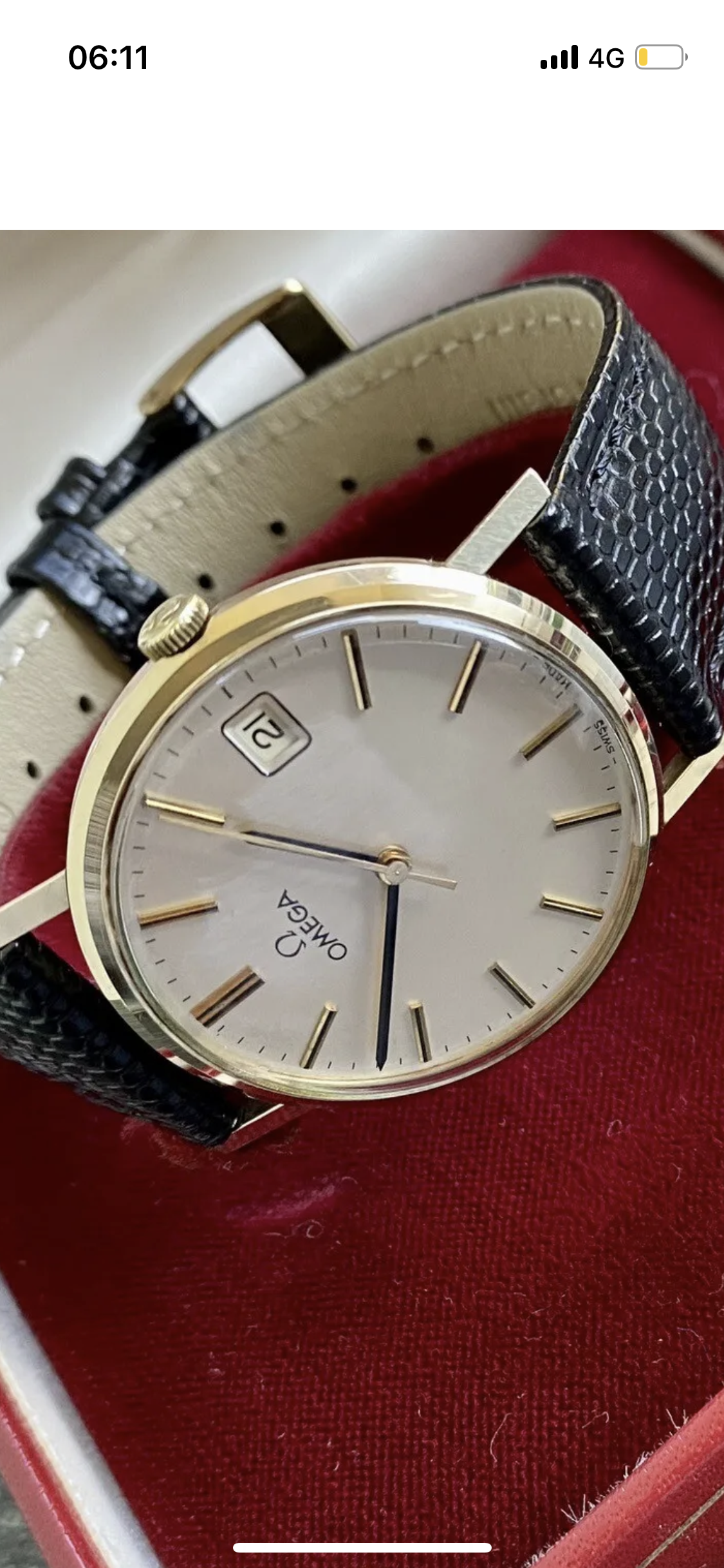

I am currently looking for spare parts before trying to gift an omega 132.5017. Looking for a crown mainly (069SX22020 says cousinsuk but one close to that will do). A replacement crystal 062PN0303) eventually.
Cousins did not seem to have the right one and I am going through ofrei right now.
Is my best bet giving the watch to a watchmaker with an omega account ?
Picture is from an eBay sale last week (thanks @dsio).
As always, thank you for the useful insights.
Tom

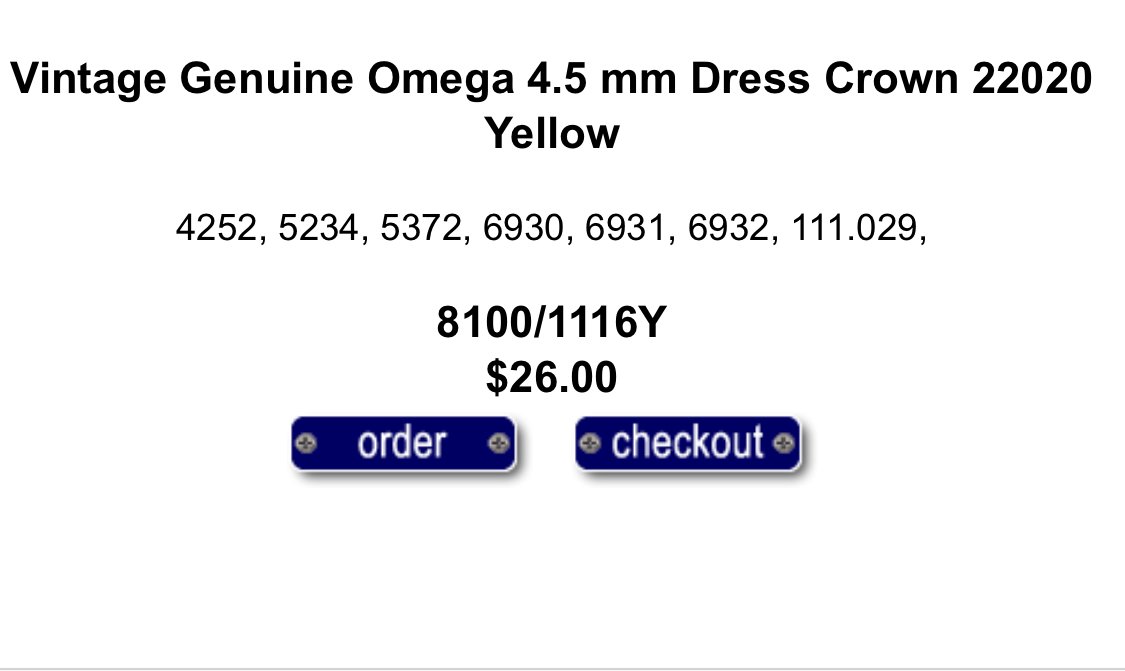

Found this on ofrei, I think it works. Please let me know if you believe it will not, haha !
Regards
Tom
720
2,109
It looks good to me; 4.5mm diameter like the one listed in eBay. However I'd wait for those with more experience to comment, just to be sure.

Thing about crowns is that they’re now gold plated. Current crown is gold filled or capped. You can see the difference.
gold filled or cap will have a softer look to it. Gold plated shinier.
how ever. Your case maybe heavy gold plate, so new crown could be a better match
can also try Jules Borel or H W Perrins in Toronto
39
Thanks !
Case is 9ct gold. The crown reference on cousins is pvd plated (gold plated ?).
Guess I will try different ones and see which one matches.
