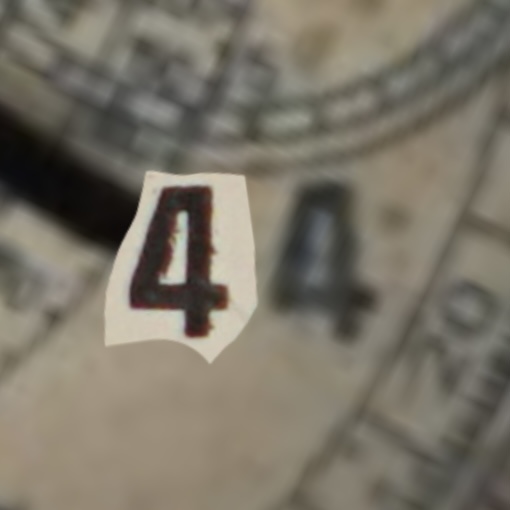

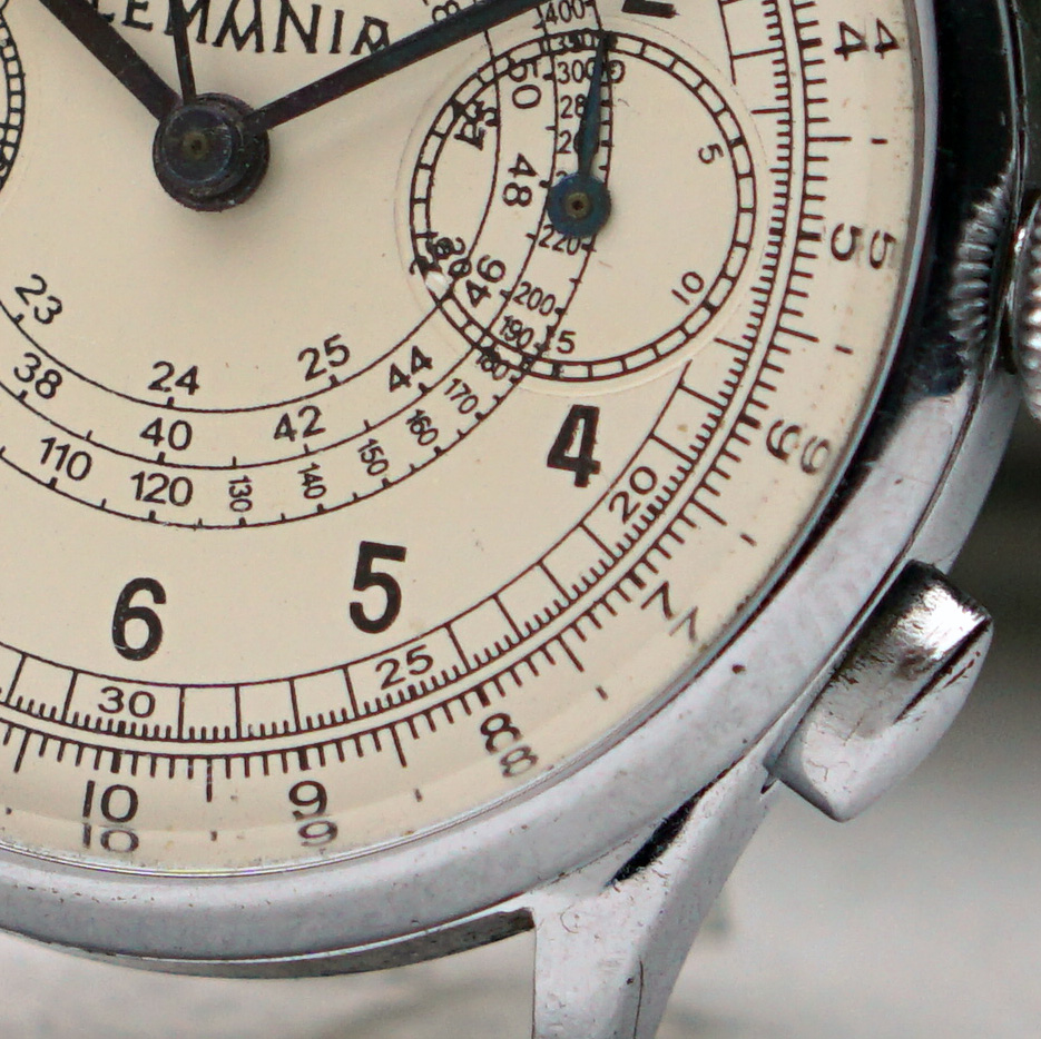

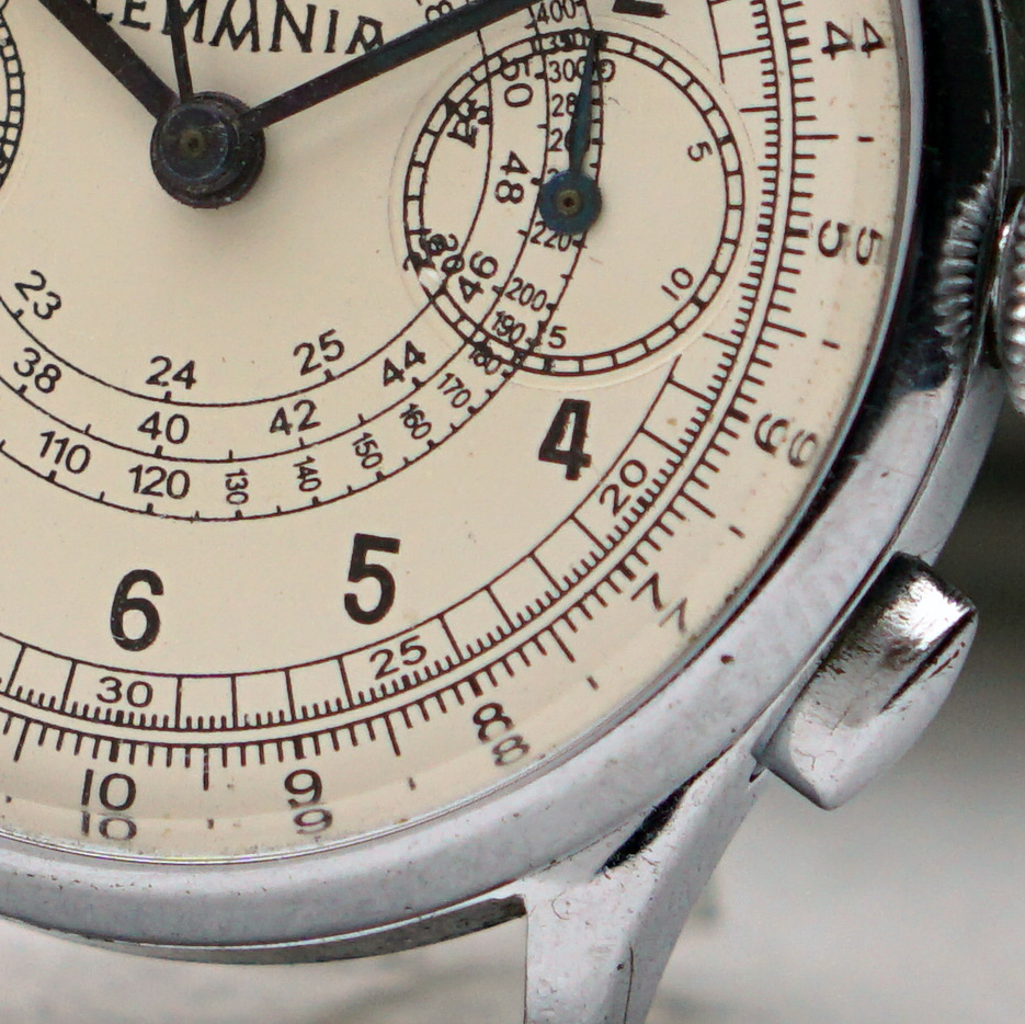

Find me a third one with that dial and you maybe get me 😉 At the moment, I see the exact dial. Also the "Swiss" I found on "my" dia. I showed some close ups to @Northernman and we agreed, its not genuine. The guy I got the watches from restored many of them to "new beauty".
here is a closeup:
2,597
5,666
I was just looking for any flaws on your dial but there’s nothing obvious. The 4 o’clock numeral looks a bit thick in the middle, and “maybe” that’s the same on the dealers dial ? Pretty hard to tell though.
5,114
15,815
If that is an artifically aged dial, its fantastic.
The 5 on the dealers dial looks a bit thick too...
Also, the chrono hand is slightly different.

Thanks Dave, with good will we can see the imperfections.
To turn it around. If my dial wasnt a redial, why change it for one in way worse state? 😉
To pimp up your better watch (And make money in the process)? Why would they change e.g. the chronograph hand as well? (Don't get me wrong, anything is still possible...maybe this guy is trying to confuse us 😀 ).
Great comparison ... could you do the same for the 5 please 😀
Edit: still open to theories as to how the black text turned blue (unless it was blue to begin with).
The second hand was relativly lose from the beginning. My watchmaker fixed it as good as he could. @kov knows what I am speaking of 😉 Also the "new" hand suits better.
Regarding the "black to blue" problem I don't have an answer either. Side effect of baking? like when hands were blued, or when you do a burnish?
