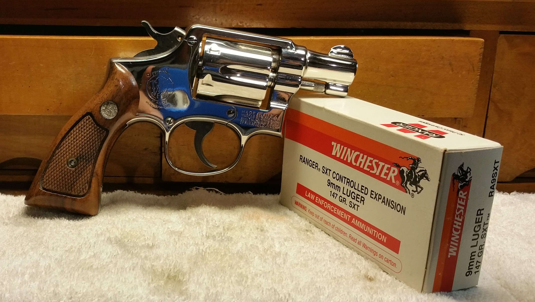

The M&P is back from the plating shop. This picture does not do the revolver justice. The M&P is coated with oil.. It's all back together with one minor issue way too much cyl. end shake. I'll take care of that and then off to the range. The non diamond grips will be used when I carry the revolver

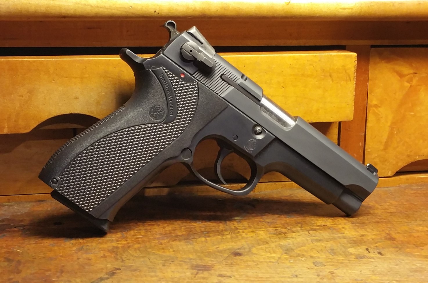

Here's one that is not shiny I finally took the time to finish up this 5906 The M&P above is waiting on some shims to arrive the yoke needs to be shimmed along with the cyl. Plus I'm going to need a some new side plate screws the original cyl. yoke screw is doing nothing other than holding on the side plate One old gun shop near my home may have some. One gunsmith near ne may have them but the guy turned into a real A hole.
Last time I stopped in for a part he made a smart a$$ remark we are not here to sell parts we are here to fix guns. I walked out and I will never go back to that gunsmith. Through the years I purchased many guns from that shop and had him do a lot of work on my firearms. Last time I had him do a very minor repair The shop screwed that small job up big time.
The pistol was a Sig220 some of the springs were in backwards and bent out of shape. to make them fit when I came home I figured I better dry fire the heck out of it for a function check in less than 5 or 6 trigger pulls the gun did not function. The trigger bar spring jumped off the trigger bar.
I pulled of a grip panel found the problem I went back to the shop and the gunsmith told me it's no big real. I told him just what I thought of him. And left the shop. The guy even tried to order me a new spring at my cost. I told him to go F himself and the horse he rode in on.

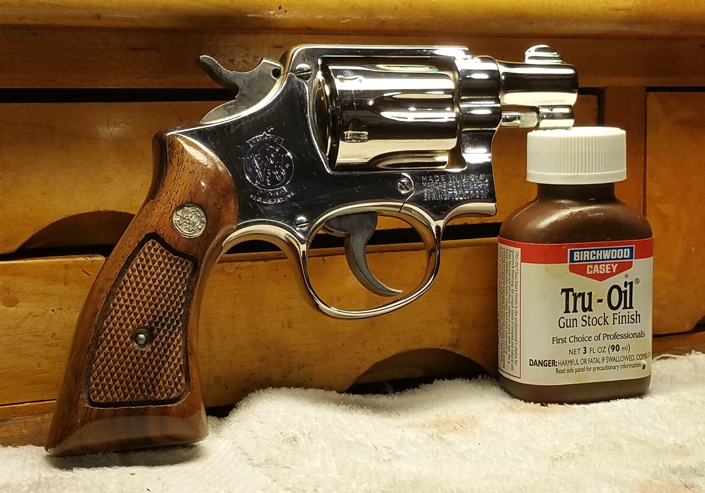

The M&P came out good. The revolver is a work in progress I had to shim the yoke to frame fit. Now that is fixed. I’m waiting on shims for the cylinder. Maybe the cylinder shims will arrive today. Then I can finish the revolver up. Rather than stretch the yoke it’s much easier to shim.
This M&P is 65 years old. One never knows how many times the yoke may have been stretched. I’m a big fan of these two-inch M&P’s. The non-diamond grips fit my hands better that the original grips. For carry use these are my go-to grips. I can live without the original style grips.

The cylinder shims arrived and installed. Now the M&P is ready for the range.

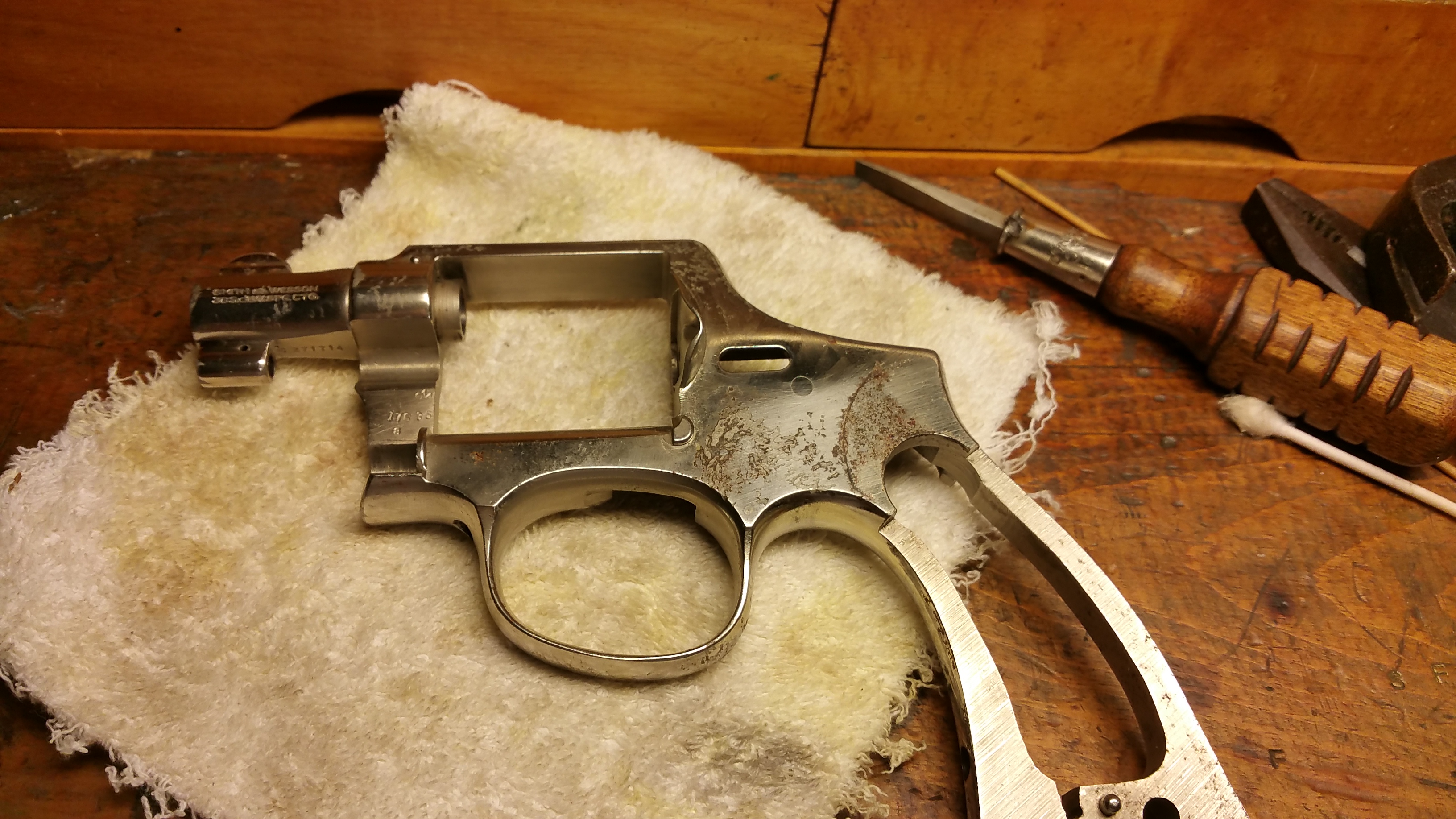

The M&P is from my underwater collection. The revolver spent several days underwater. The revolver had plenty of rust that need to be removed. Refinishing was the only option. I like to keep my firearms with the original finish. However this M&P left me with no choice refinishing was my option. Now the M&P is now functional.

The real credit for this project goes to the plating shop. I took the revolver apart removed the deepest rust pits then gave it to my friend for plating. I did what needed to be done. All in all the M&P came out ok.

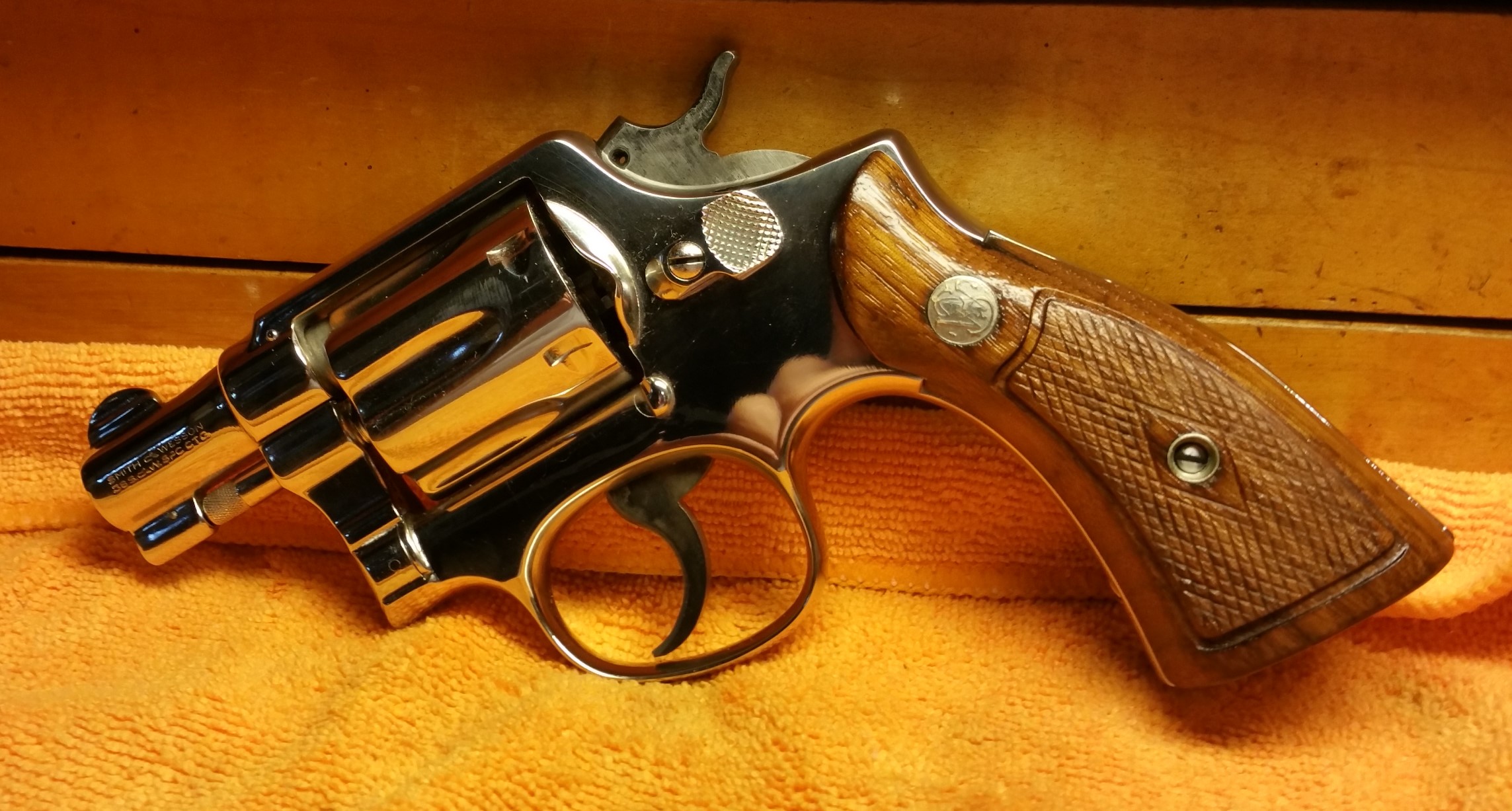

Your M&P looks great. Mine was a rust bucket now sporting a new finish and tune up.

The internet is a great source for finding vintage gun parts. Working on the 2” M&P above in this thread. I needed an oversized new yoke strain screw. I had 5 new screws however they were blued and not the oversized screw.
I managed to locate a new yoke screw with a nickel finish The cost for the screw was on the high $$ side for one screw. However the screw worked great no fitting required.
I used one yoke bearing ”shim” that with the new screw. Now no yoke end shake The cylinder required one shim. Now the cyl has about .001 of end shake and a barrel gap to cyl. .007
I’m fine with these results. Under twenty five bucks and the M&P is well within spec. Plus had some shims left over and I installed one yoke bearing on a 66-2 that I have
