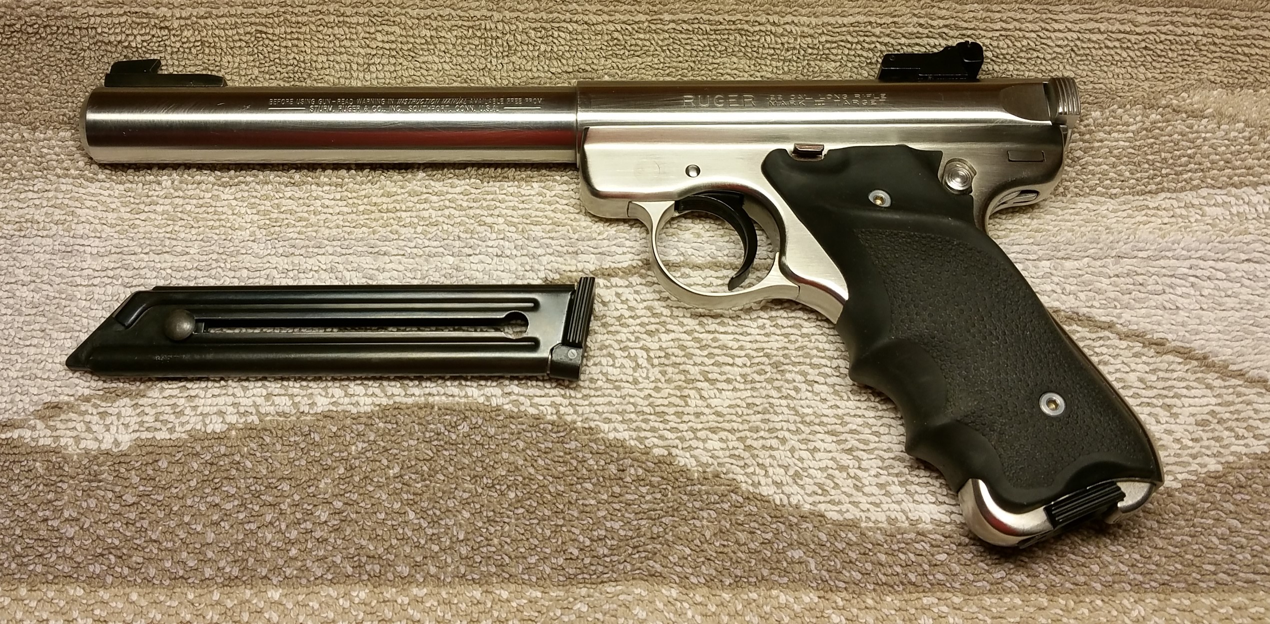

Rust blue and Cold bluing work well for small items. The other day I used cold blue on this Ruger mk2 mag the mag was rusted I took the mag apart soaked the metal parts in evapo-rust to remove the rust and original finish. Degreased the mag, applied one coat of Oxpho blue from brownells and was good to go. The mag looked good enough with one coat of Oxpho blue. I applied the oxpho blue using a small piece of 0000 steel wool rinsed the parts in water then wiped the mag with a light coat of oil and put it back together. Woked fine for my needs.

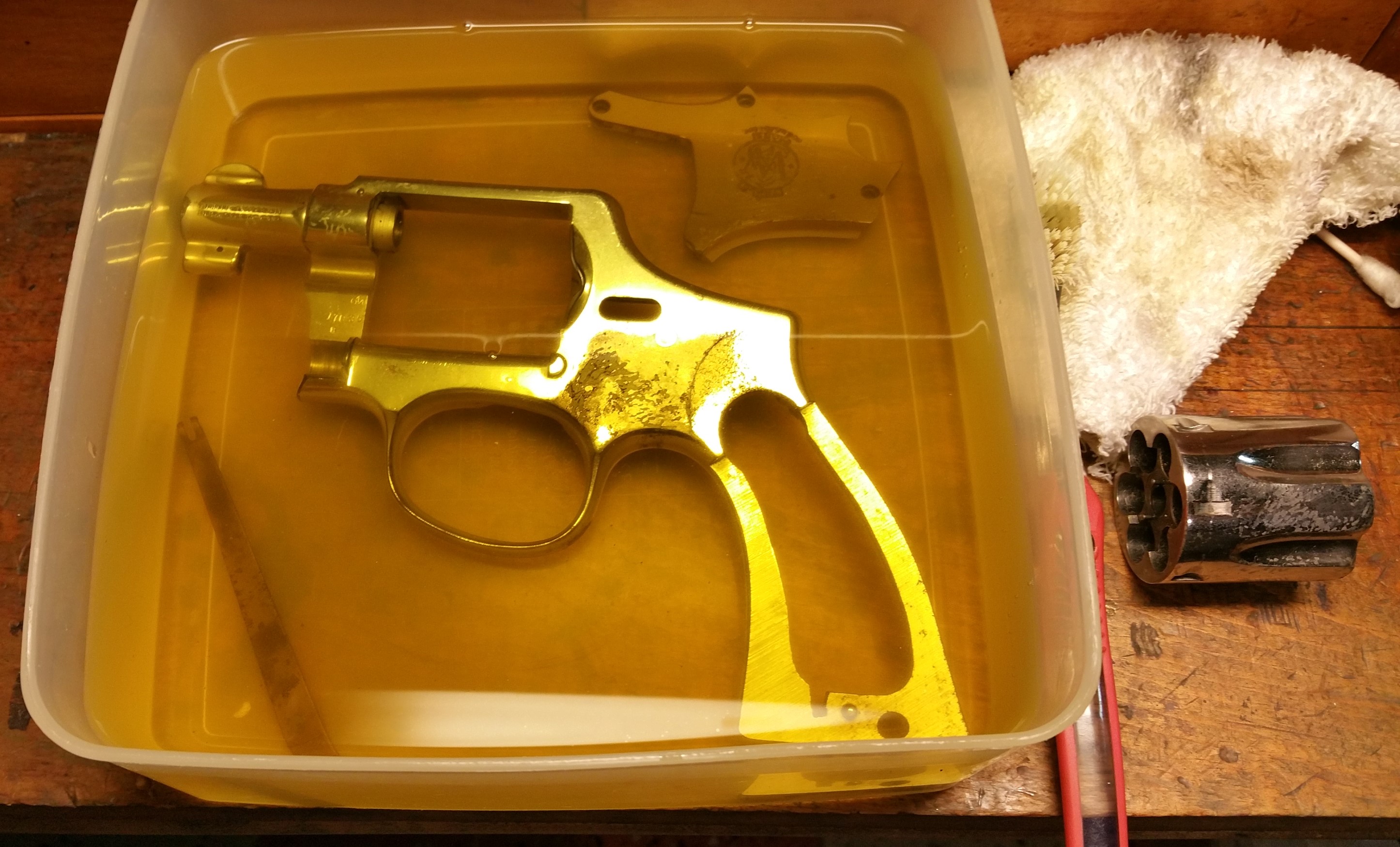

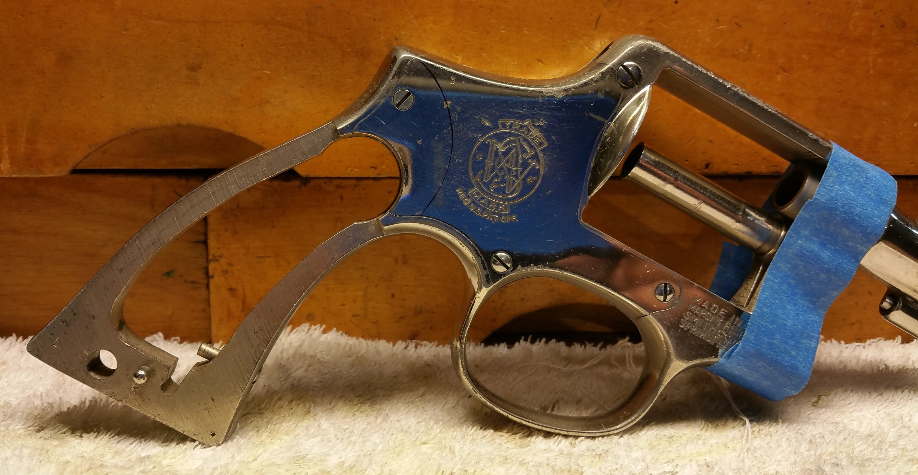

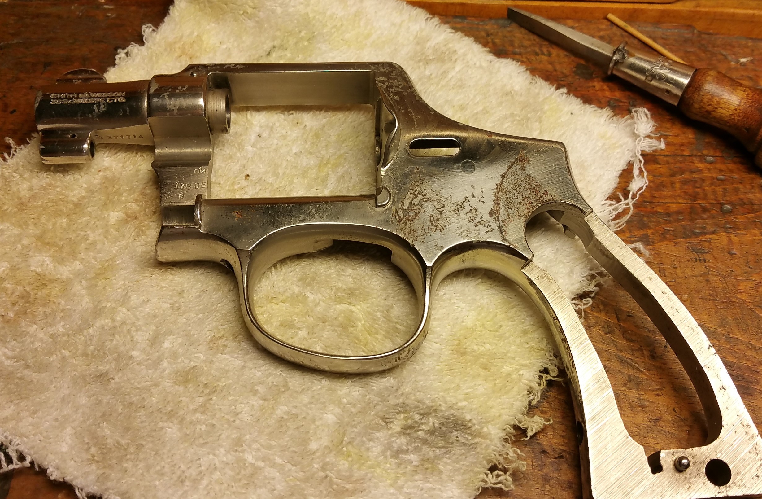

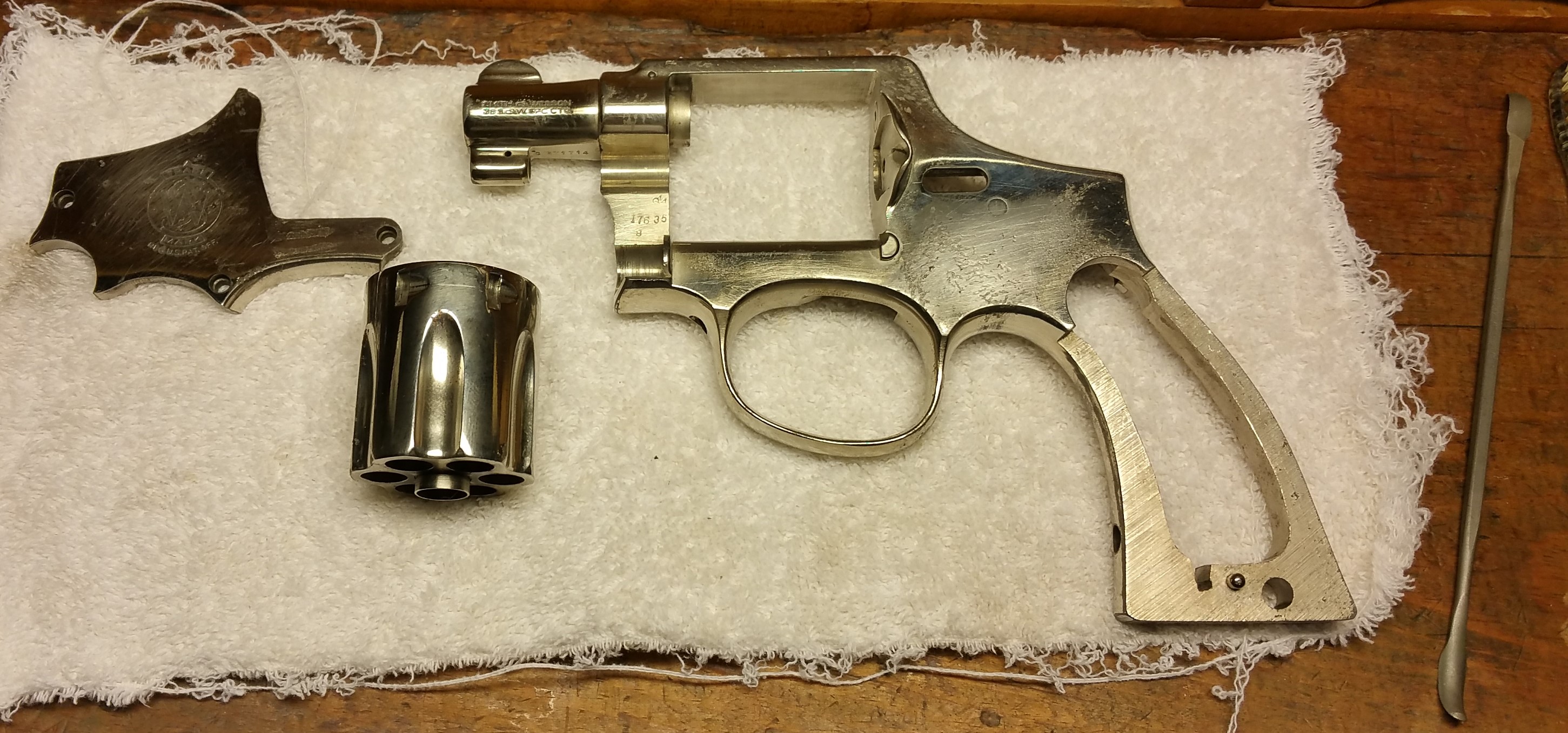

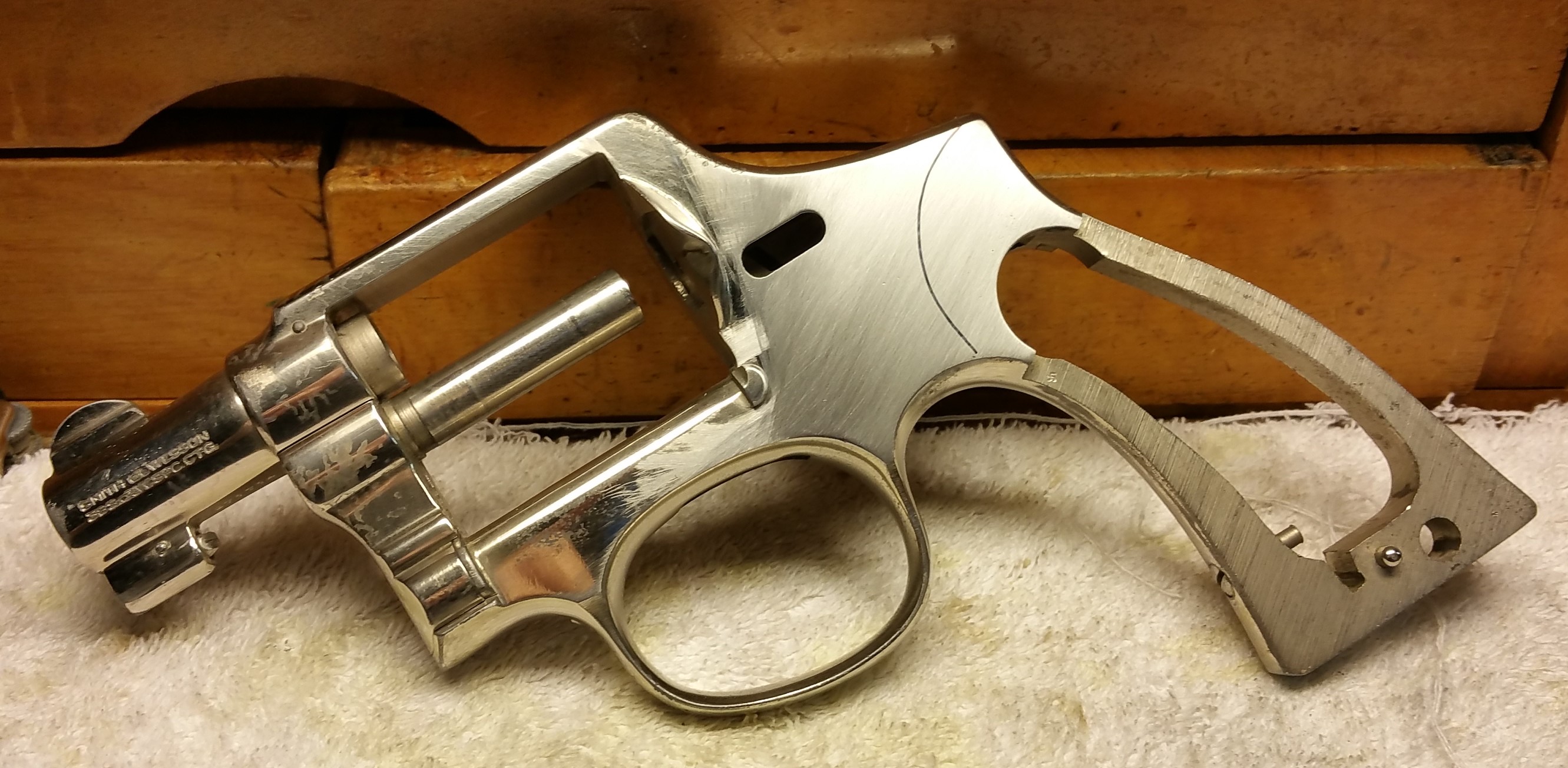

Another project revolver from my under water collection. This S&W was under water for several days. I'm finally getting around to work on the firearms. I took the revolver apart soaked some parts in rust remover. I worked on the worst part of the frame that took a lot of file work. Now the revolver needs to have the nickel finish removed, polished up and a new nickel finish applied.
Since I'm not setup to do plating. I'll drop this one of at one of my friends shop, and let him finish it up. I'm amazed that all the firearms that were under water none of the bores or chambers rusted. Since none of the stampings roll marks & trade marks are in great shape this revolver should come out looking good. This S&W is one of my favorite carry guns. The painters tape is just to hold the crane in place until I drop it off for the refinish work

That square butt Military & Police snub ought to be particularly fine with a new nickel finish once you complete your good prep job to its surfaces.
