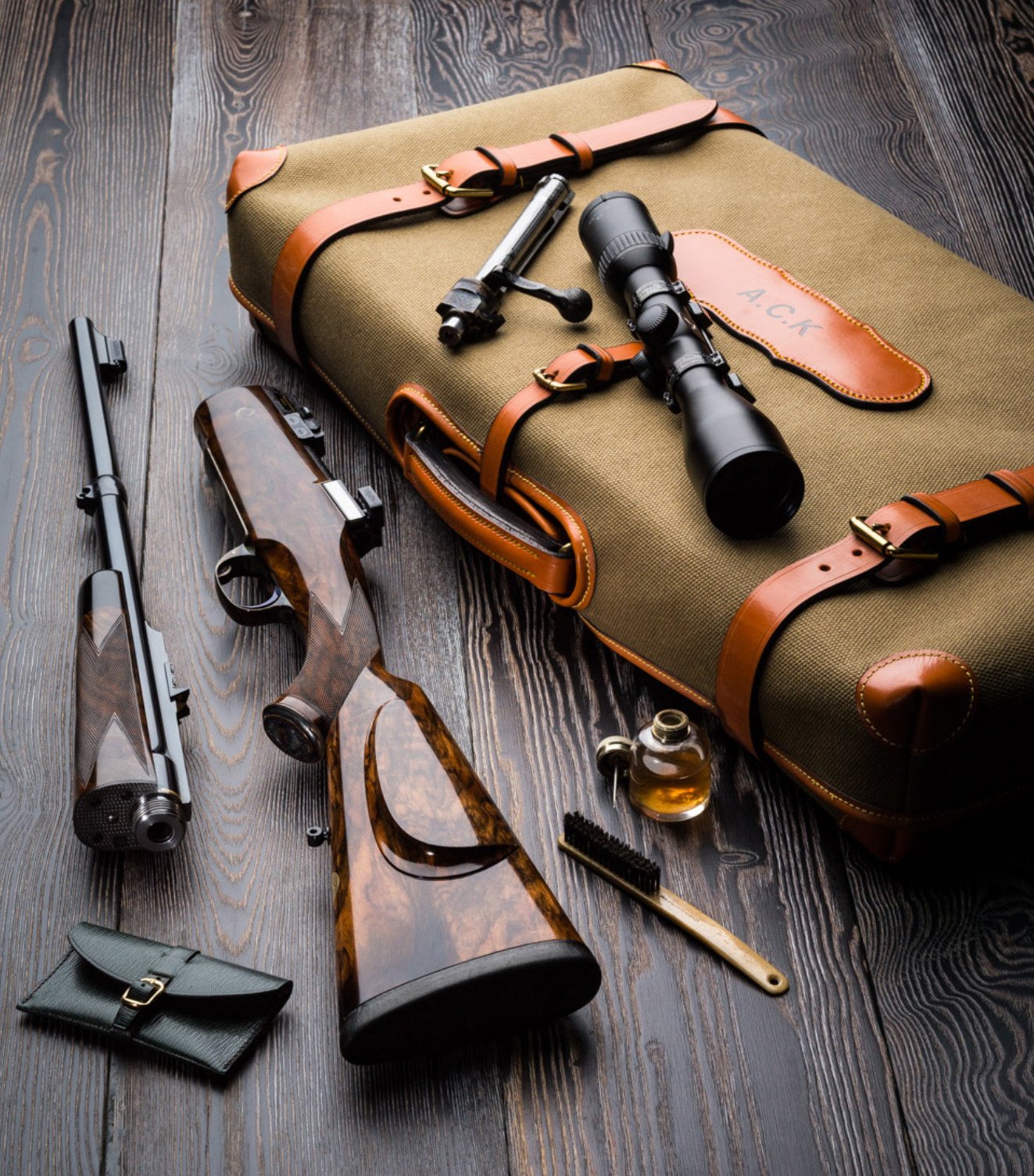

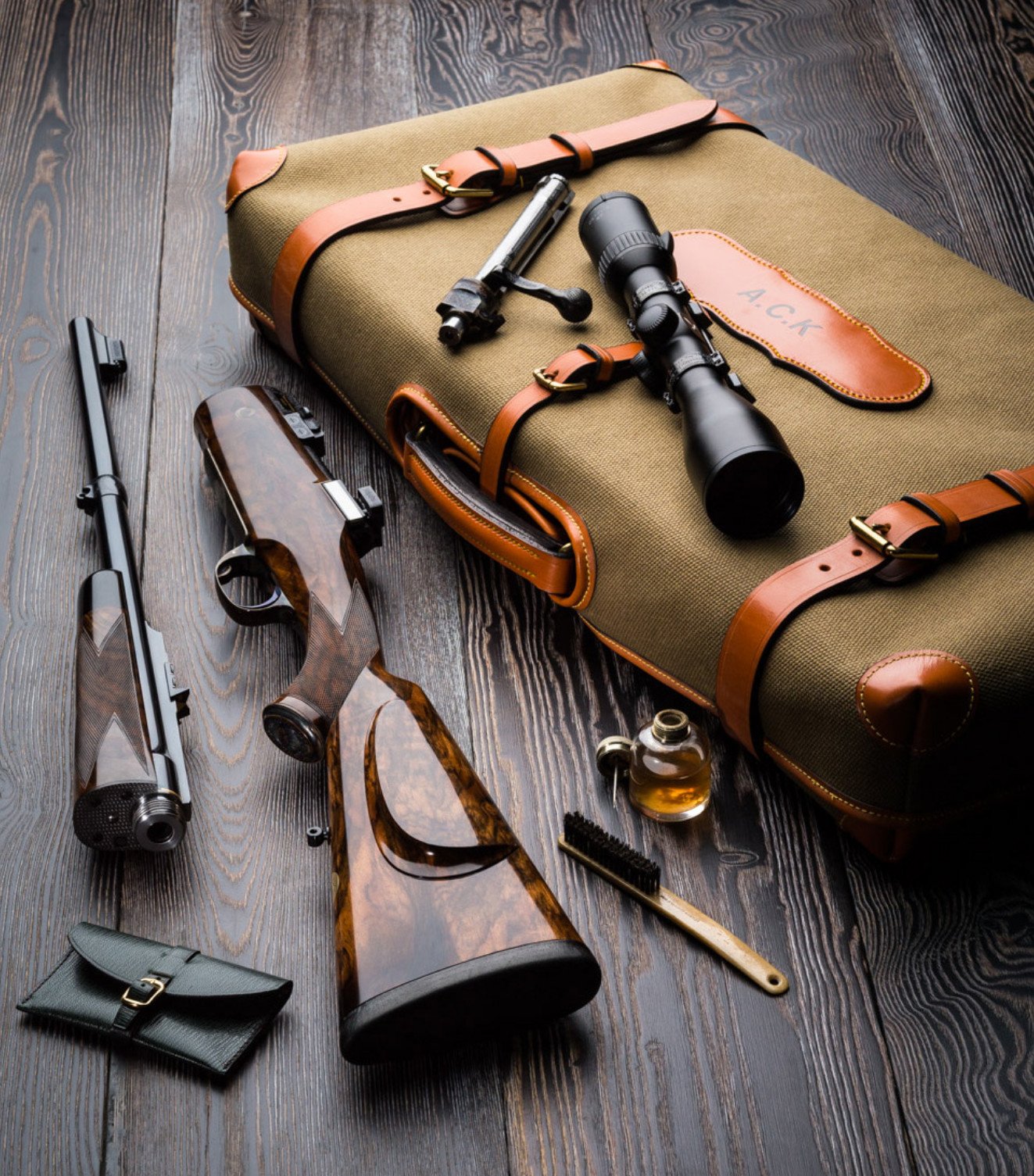

Depsite our strict gun laws, England does still make some beautiful guns - take this Westley Richards for example:

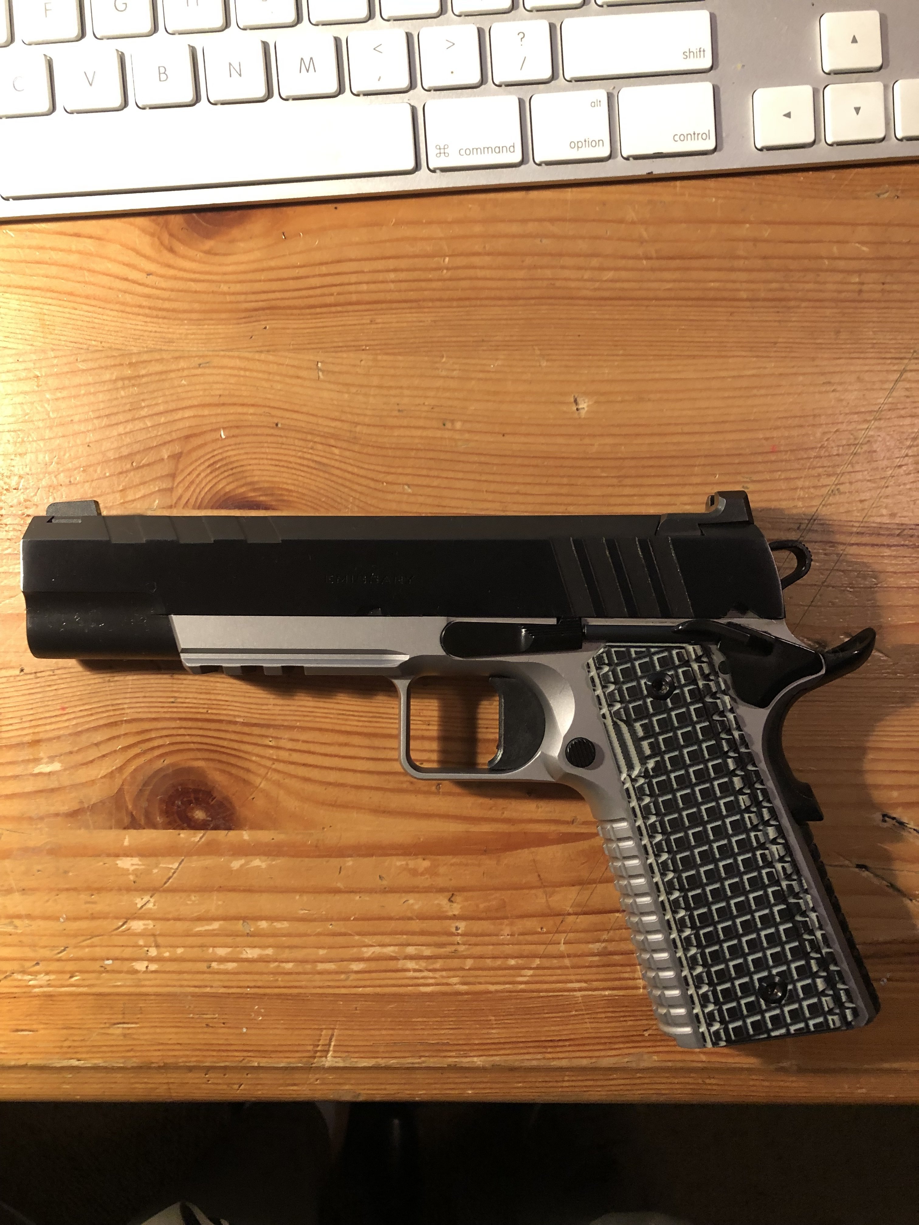

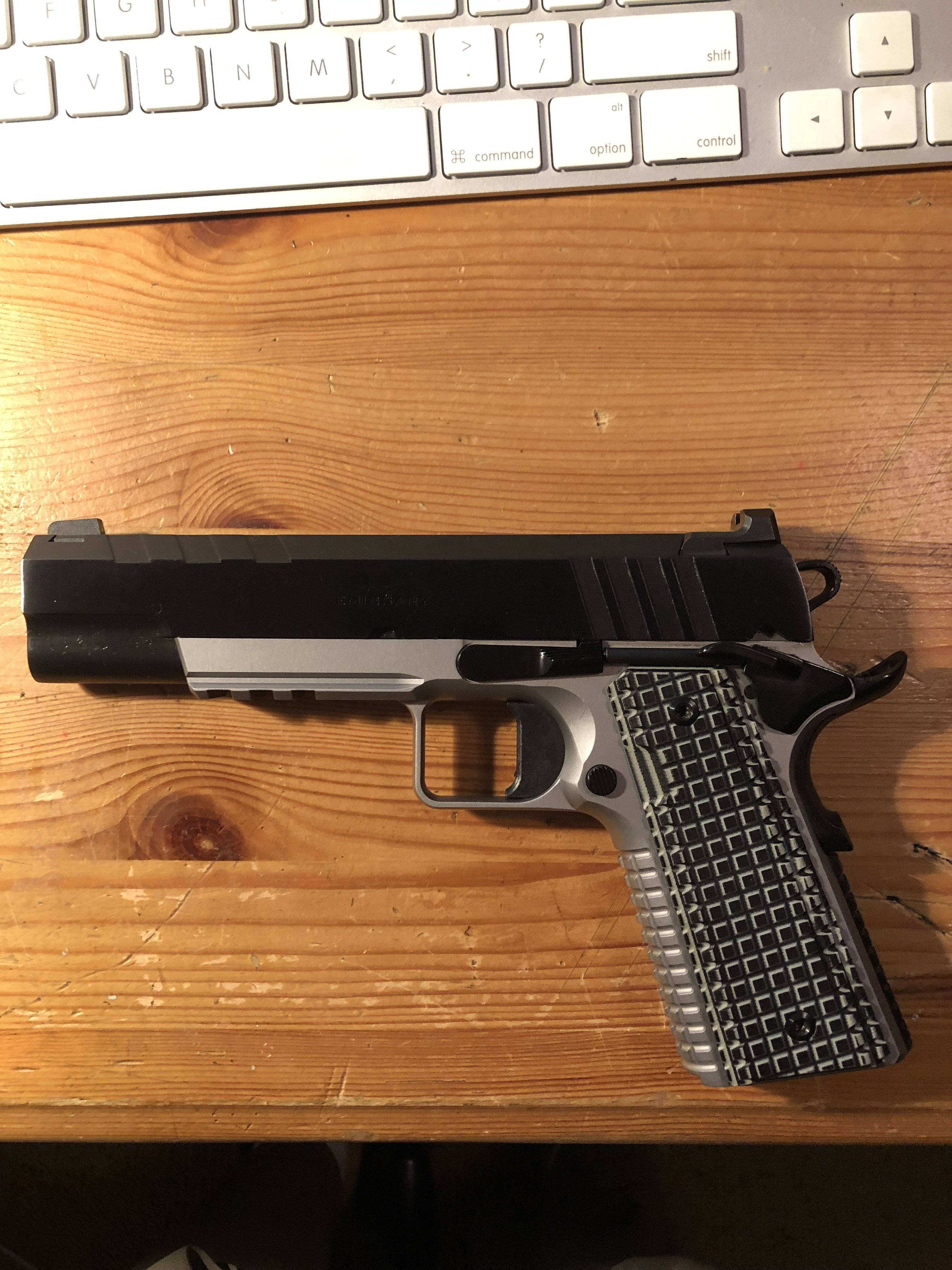

Look at this nice clean 1911! After several WTF? attempts getting half way there, puzzling over the book, useless You Tube videos, un answered e mails to the company, and ordering a 1:1 training session from the dealer in a few weeks, it took some lateral thinking to get it apart. Major PITA but now I know. I鈥檇 hate to be in the field under pressure trying to clean this thing. I understand why Glocks are so popular. I鈥檒l use my 1:1 for some cleaning tips and actual shooting now. I ordered a proper mat and some non metal tools from Amazon so I鈥檓 not tempted to deploy my jeweler screw drivers compressing detents and removing parts.

I'm going to sound like a curmudgeon here, but a 1911 is incredibly easy to field strip for maintenance. You only need to detail strip it once in a blue moom.
1) Depress the plunger and rotate the barrel bushing clockwise (if it is a tight bushing you may need a bushing wrench but 95% of them you can rotate by hand).
2) Remove the plunger, and rotate the barrel bushing counter clockwise, then remove the barrel bushing.
3) Move the slide rearward until you line up the disassembly mark with the slide stop.
4) Remove the slide stop and move the slide assembly forward and off of the frame.
Easy peasy, and can be done in thirty seconds or thereabouts. If it would be helpful I can post photos.

Nope. Bull Barrel design is what I think it鈥檚 called. Super fiddly.
1) Gotta move slide to removal notch, pop out the slide stop,
2) move slide forward and off.
3) Then there is this odd hex key. You compress recoil spring (ouch) along guide rod till a pinhole appears, short end of key goes into pin hole. Long end lays against guide rod which locks the spring and allows you to carefully ease the spring and guide rod though frame and off barrel.
4) Remove barrel
5) Clean and reverse.
Putting the slide stop back is a pain as well. There is a detent to deal with. I saw the procedure you described, I wish.

See my explanation. No way this comes apart blindfolded.
4) Remove barrel
It鈥檚 not a proper 1911 then, a variation of it maybe

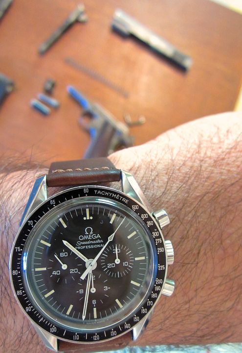

That's ok Larry. Your pistol is quite nice. I'd own it. I'd shoot it.
Seven seconds to field strip, including the time it took to use the Speedmaster as timer.
Of course it's helpful to use an old loosey-goosey, worn, military contract Colt 1911 from 1918 for the speed timing specimen.
I love it. According to Springfield, the Bull Barrel is preferred by some for target use because it鈥檚 beefier. Now that I know the procedure, I鈥檓 sure I鈥檒l get faster.

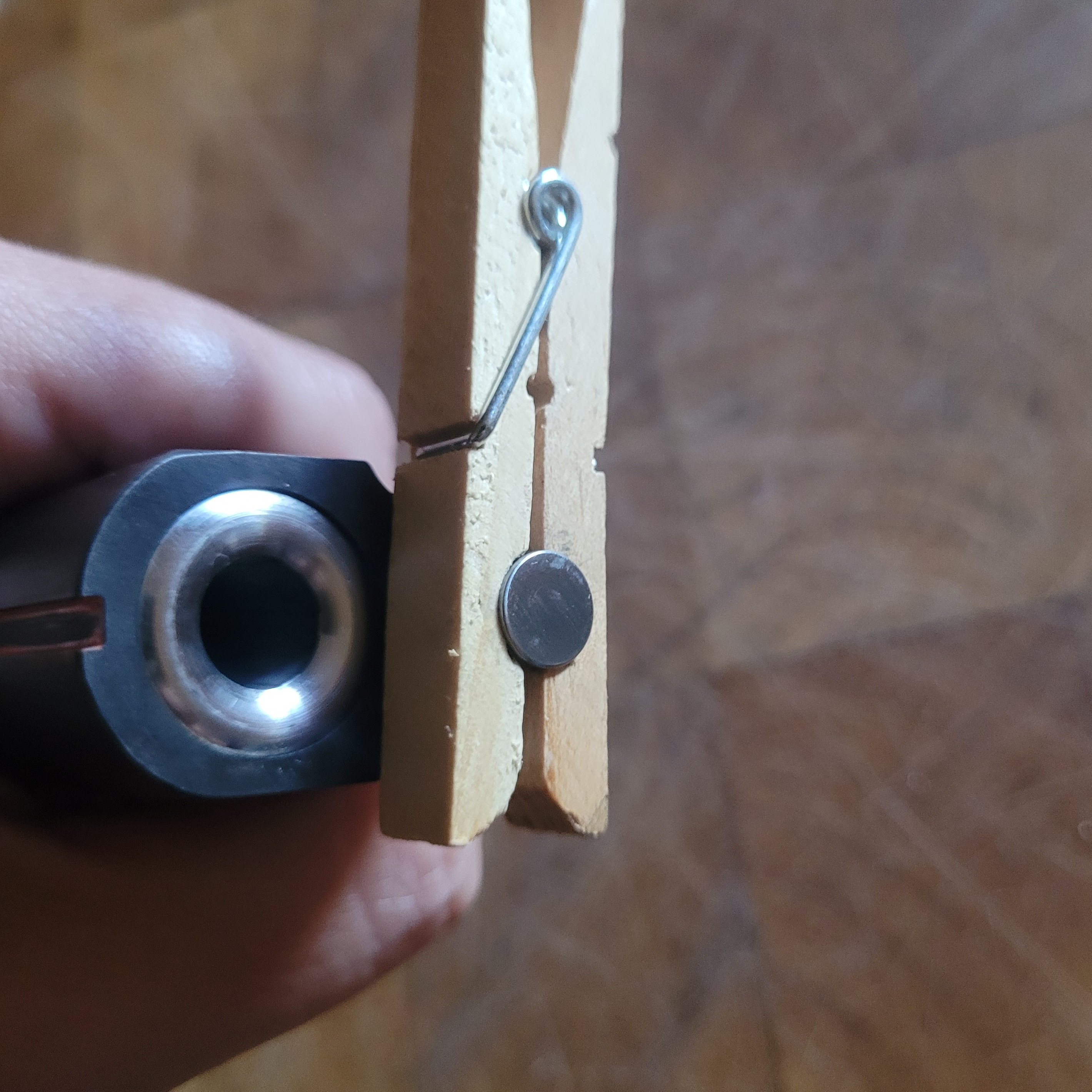

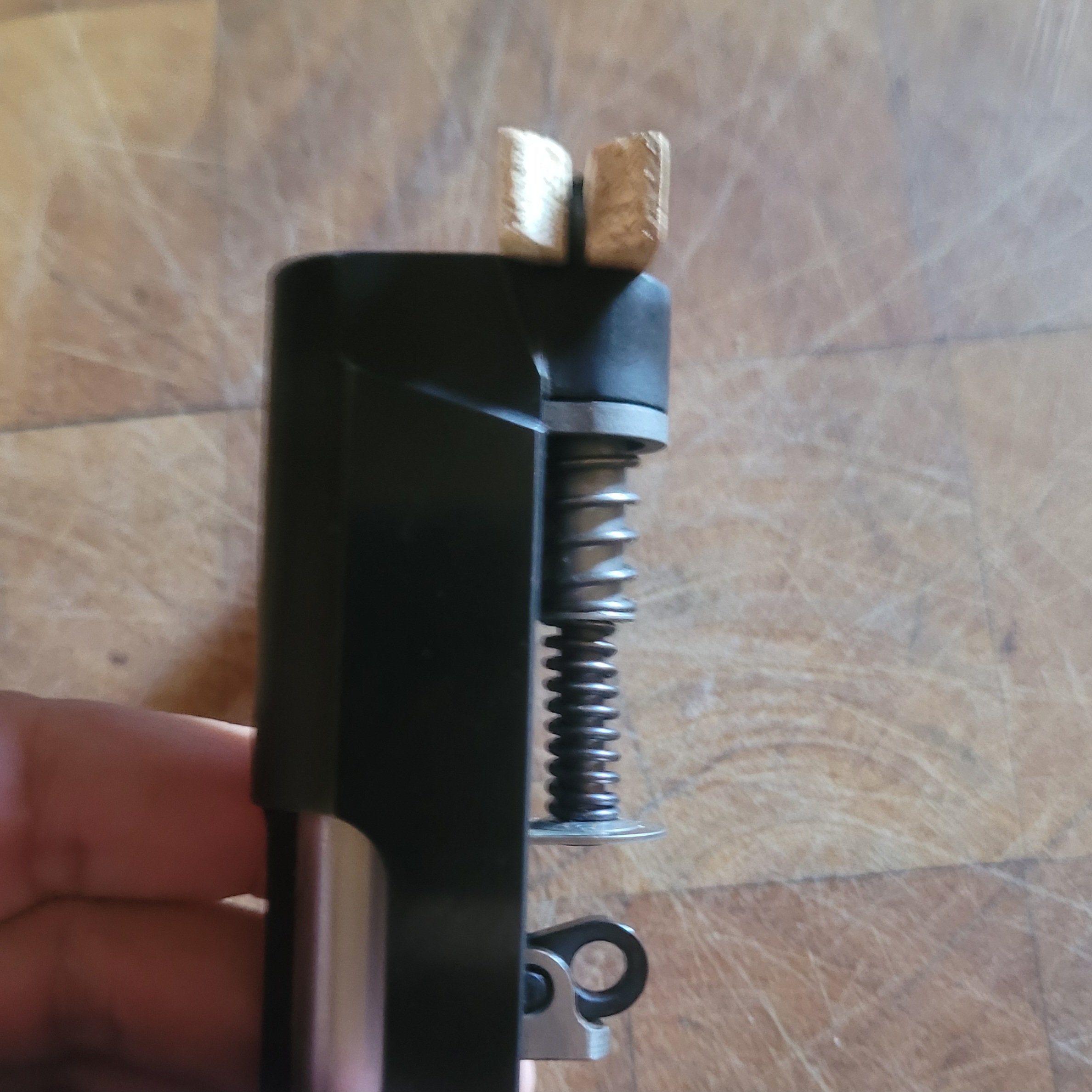

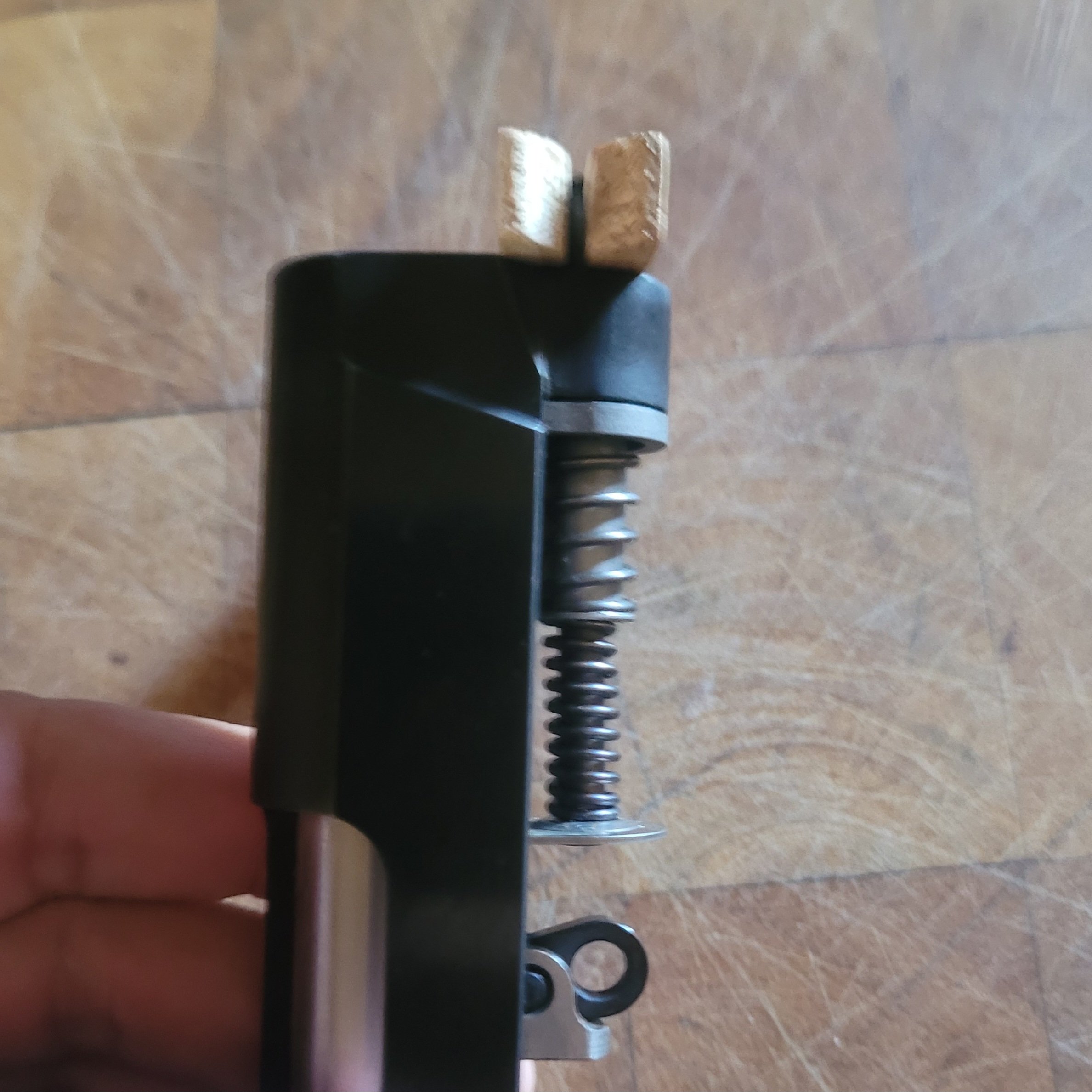

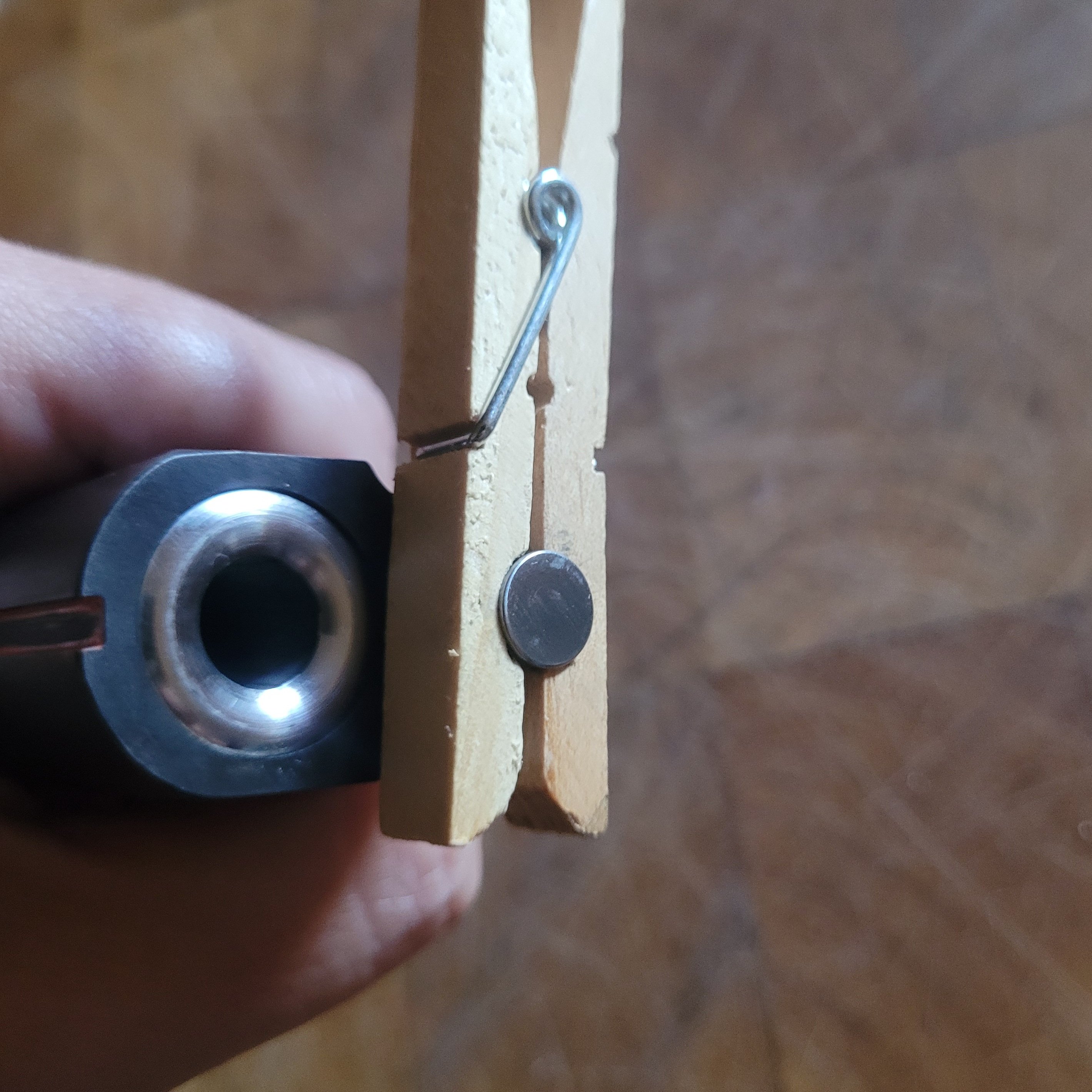

So, a bull barrel is another kettle of fish entirely. You can still take it down without tools, though.
1) Line your slide up with the disassembly mark, and while holding the slide in place with one hand remove the slide stop with the other.
2) Move the slide assembly forward off the frame.
Now, reassembly I find goes much easier with a specialized tool, as shown in the following two photos. This special tool grabs hold of the guide and secures it in place so that there is no spring tension on the barrel lug during reassembly.
13,958
54,169
2) Move the slide assembly forward ofc the frame.
No home should be without a drawer full of clothespins. Versatile invention. My guide rod and sleeve unfortunately has no flange to grab, just the pin hole. Gonna buy another couple of the wrenches/pins from Springfield. Gonna need another tool box soon.
