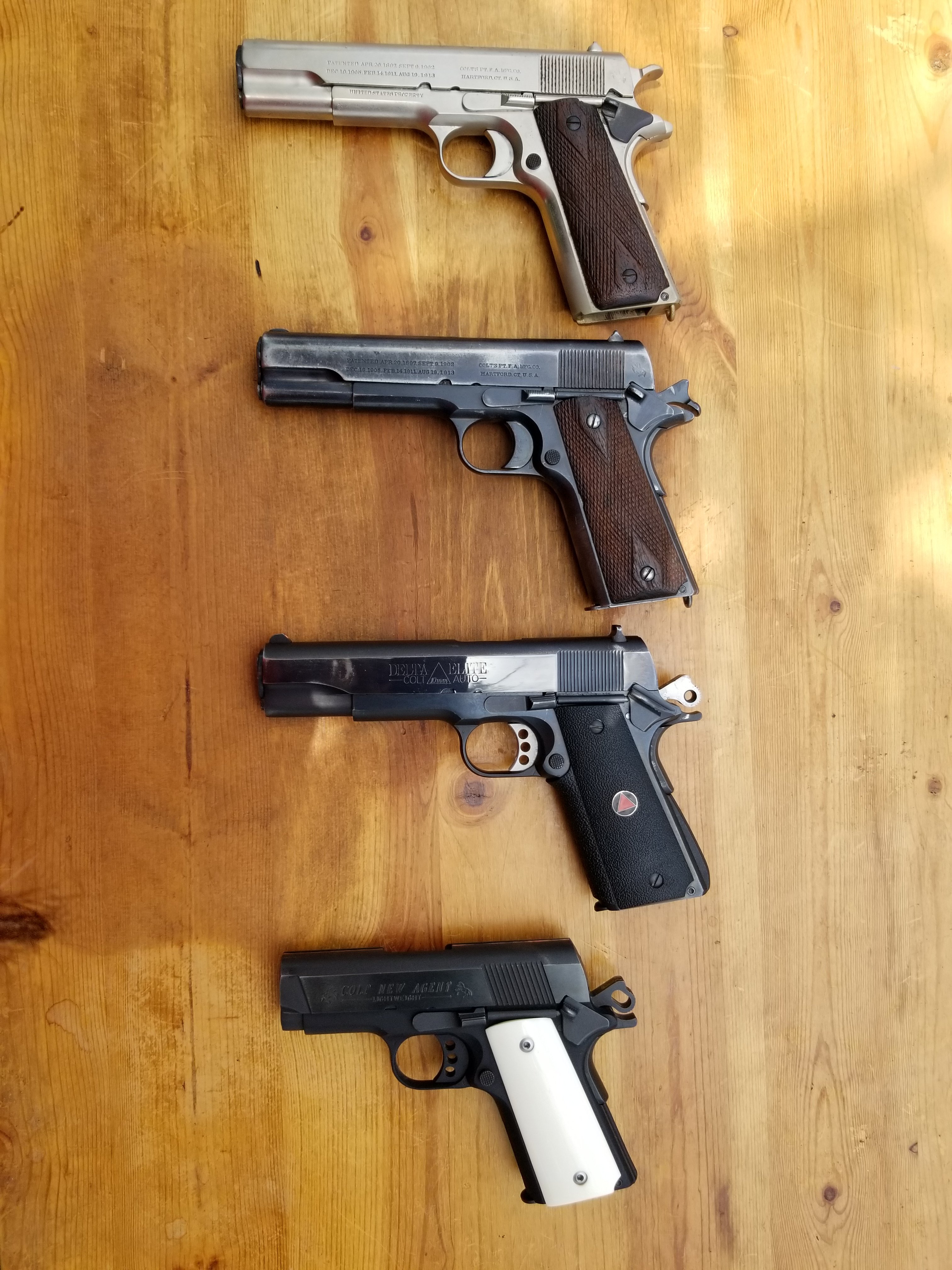

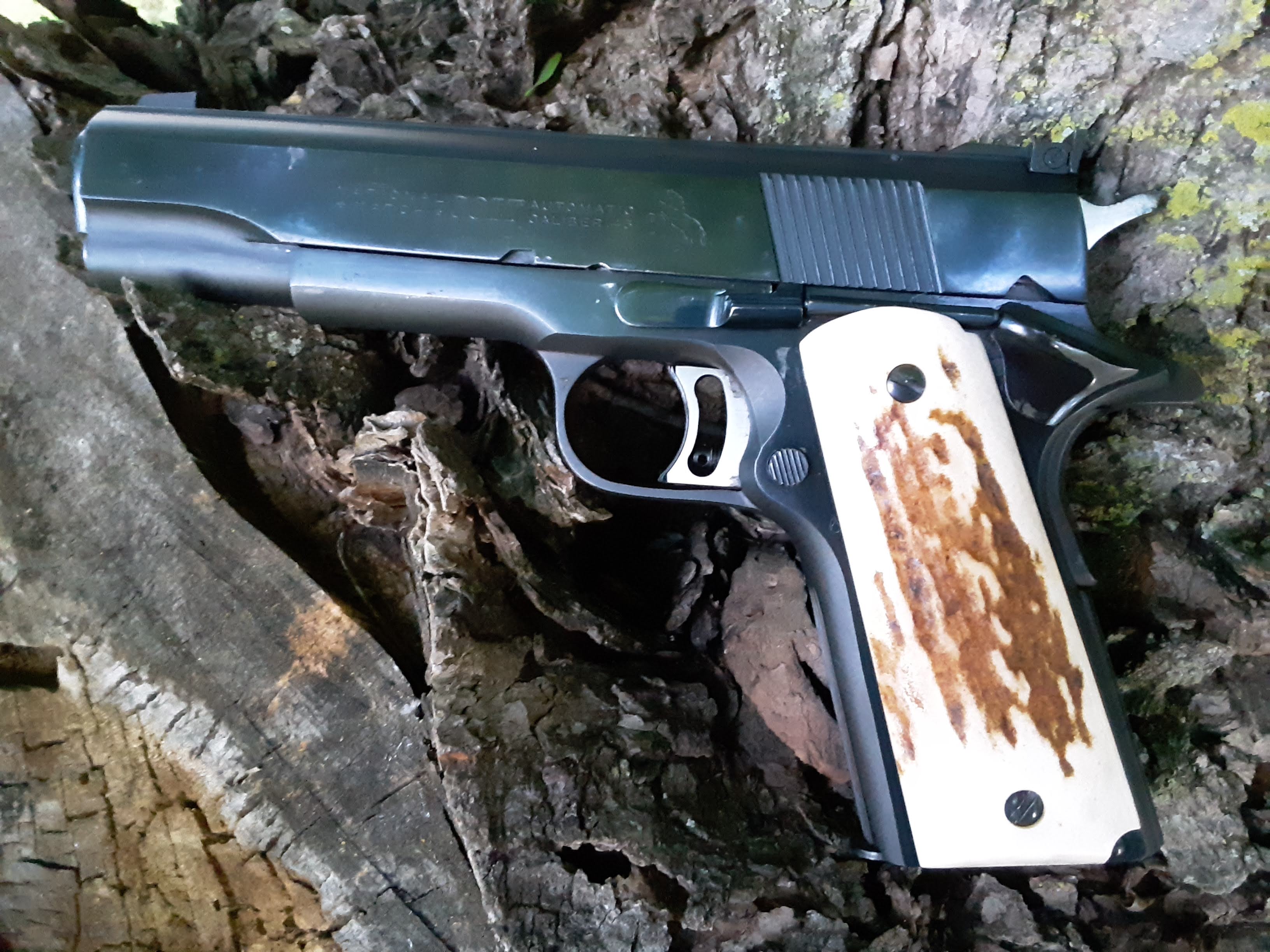

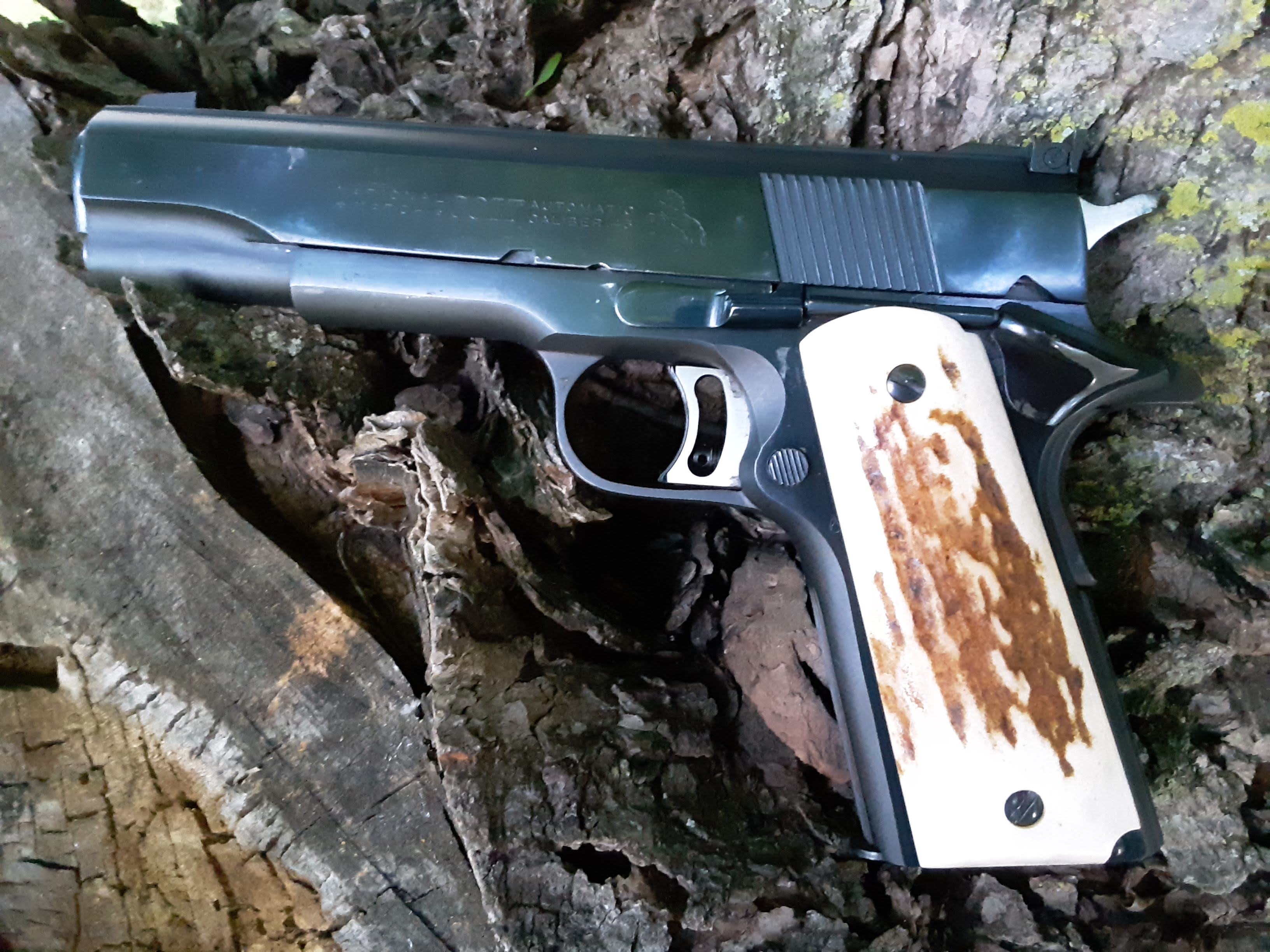

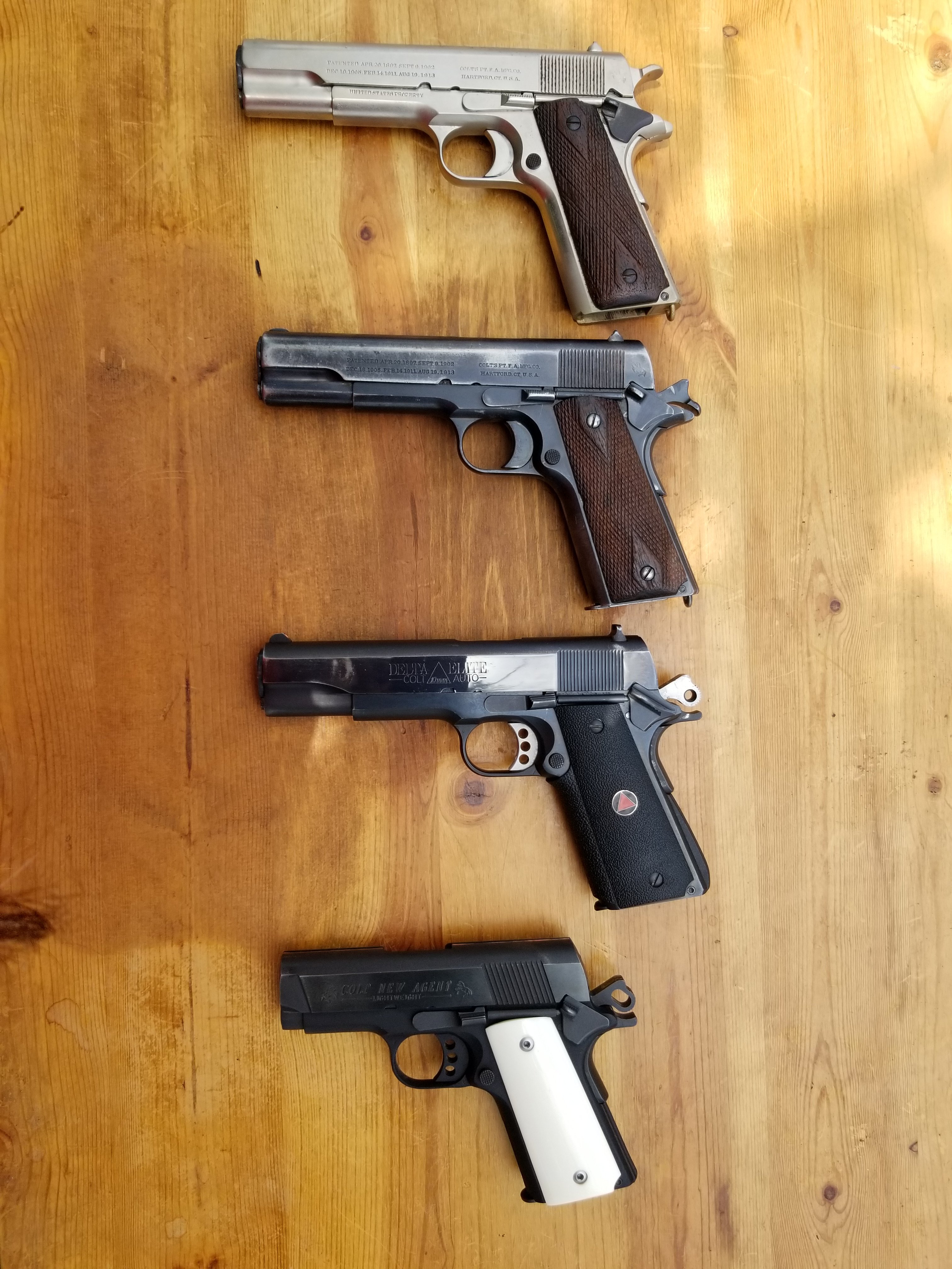

So, we're showing off our 1911s again?
Here are mine, from top: 1915 M1911 that was carried by my granddad, he was pushing 40 but went off to war with the 45th Infantry when they went to the European theater; 1915 Commercial Model, this one is interesting because it's one of 1000 ordered by Argentina in 1915 and adopted the following year as the Modelo 1916, it has the Argentine Crest on the top of the slide and all the parts are serial numbered; 1988 Delta Elite; New Agent I bought, probably five years ago. The second photo is my 1969 GCNM that is currently with Karl Bening getting finely tuned for bullseye.

Golly...your granddad's M1911...that just hits the feels. What a remarkable example!
Edit: not to shrug off the others, but that's just badass

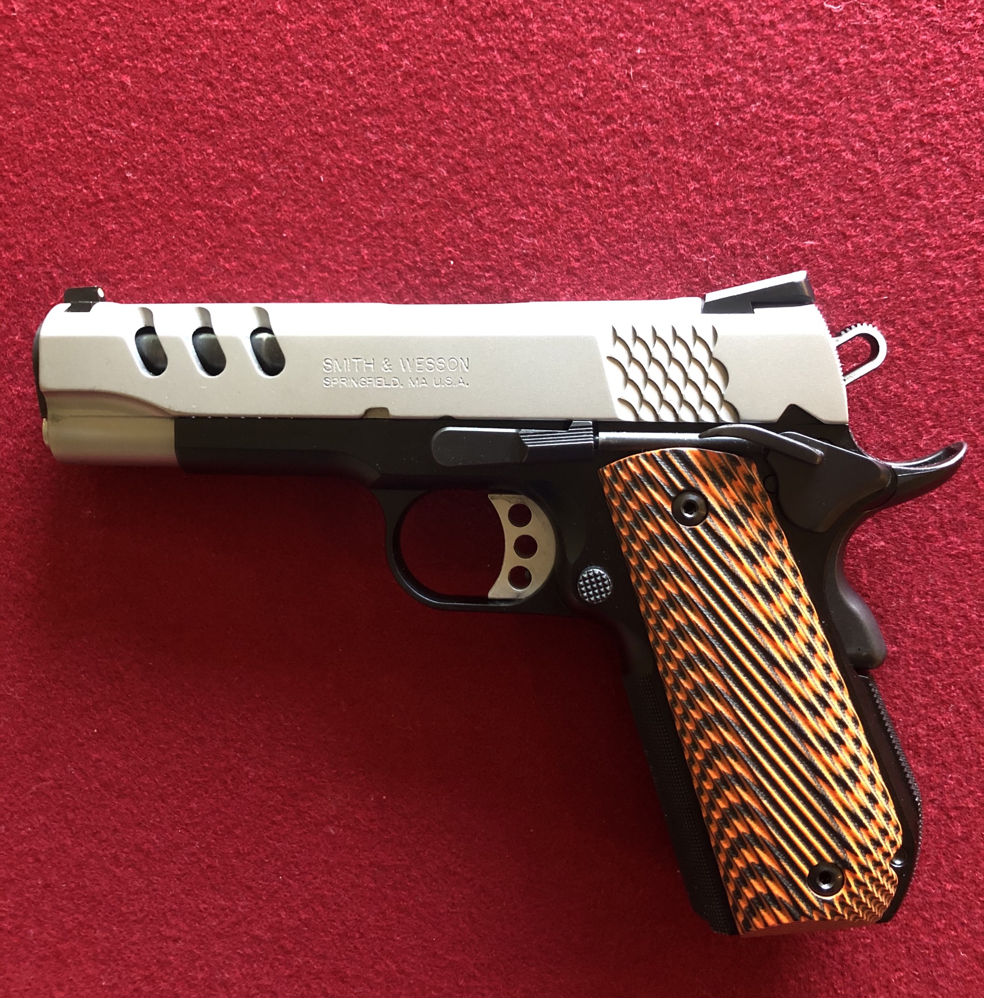

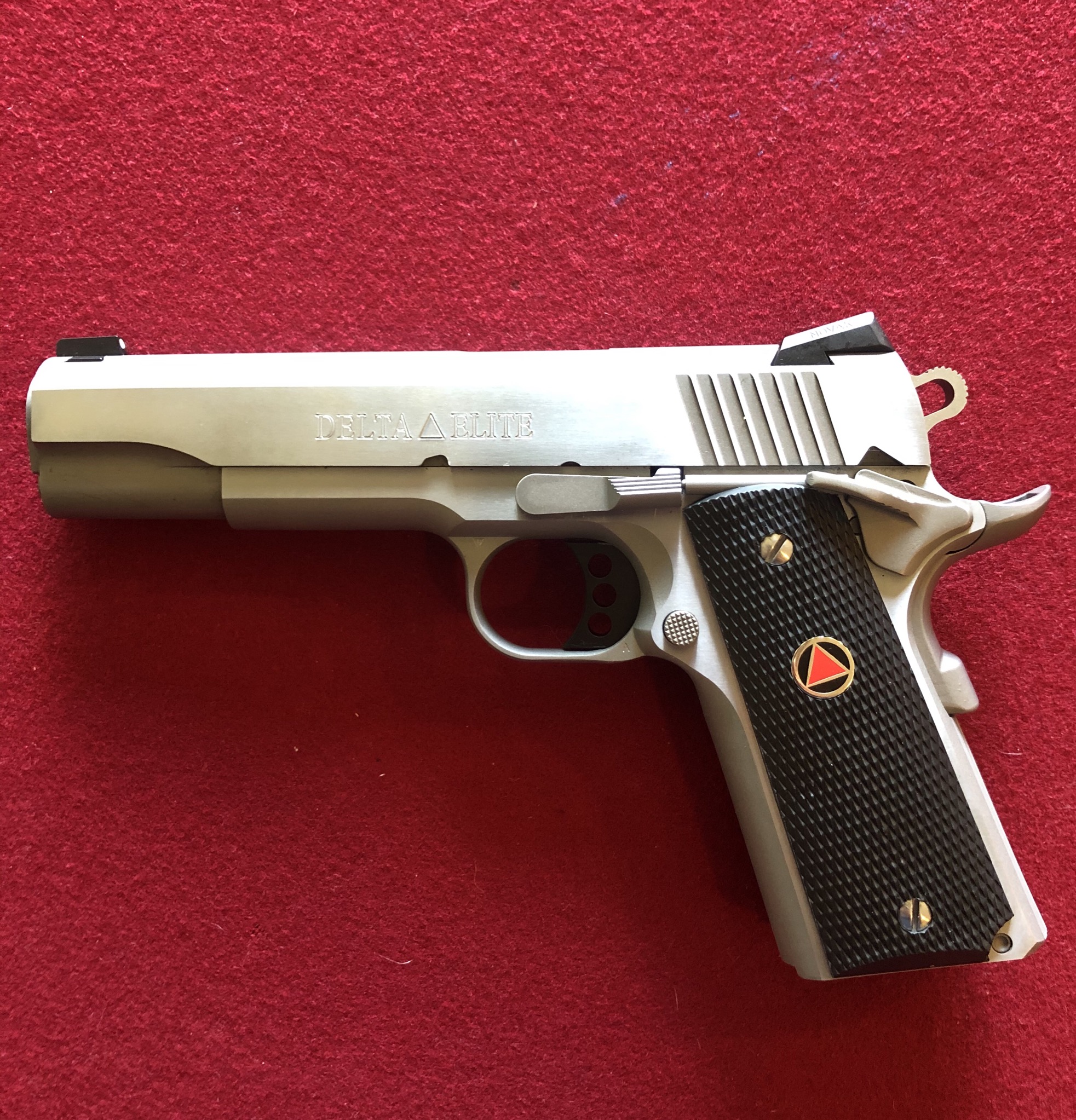

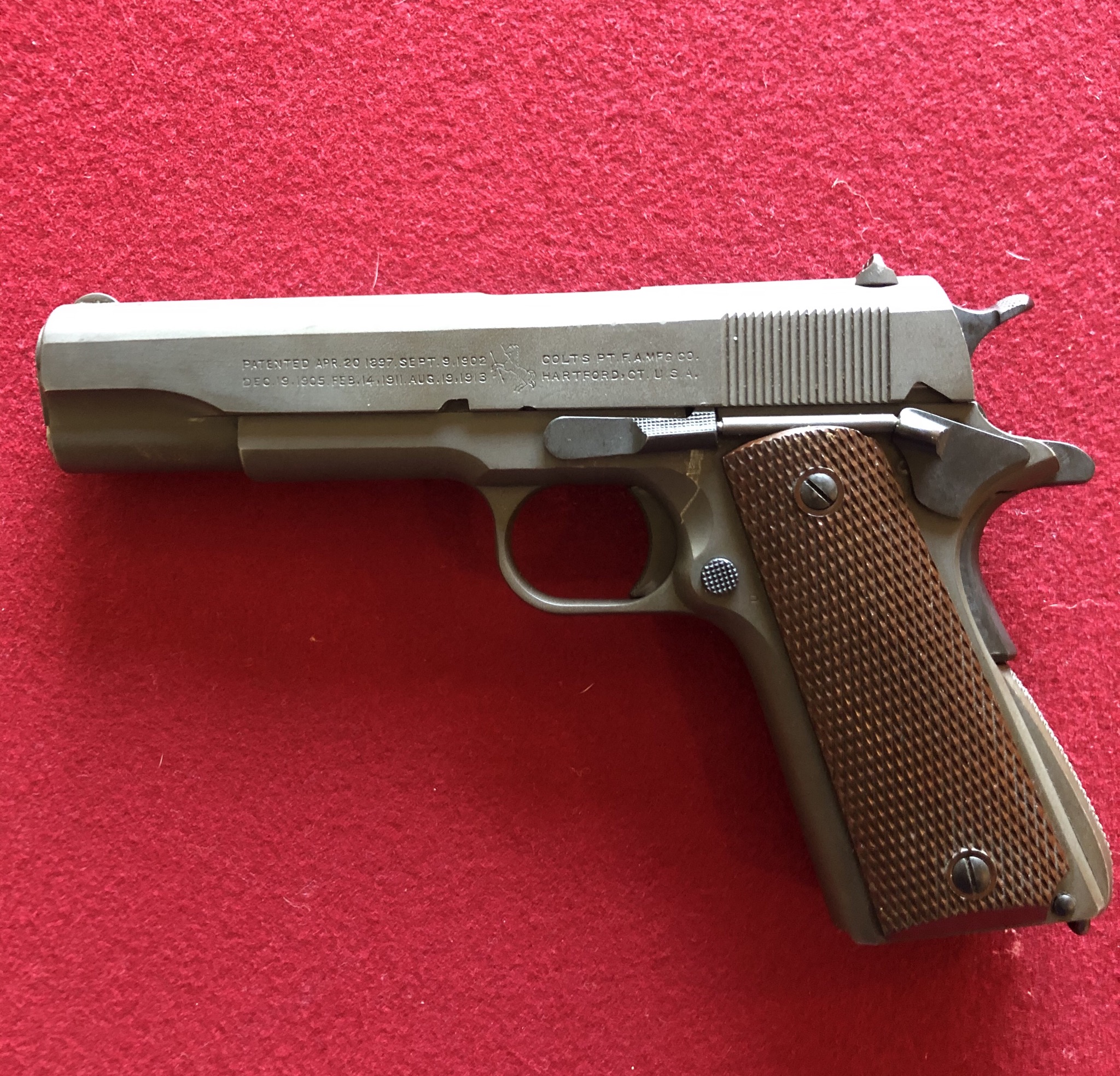

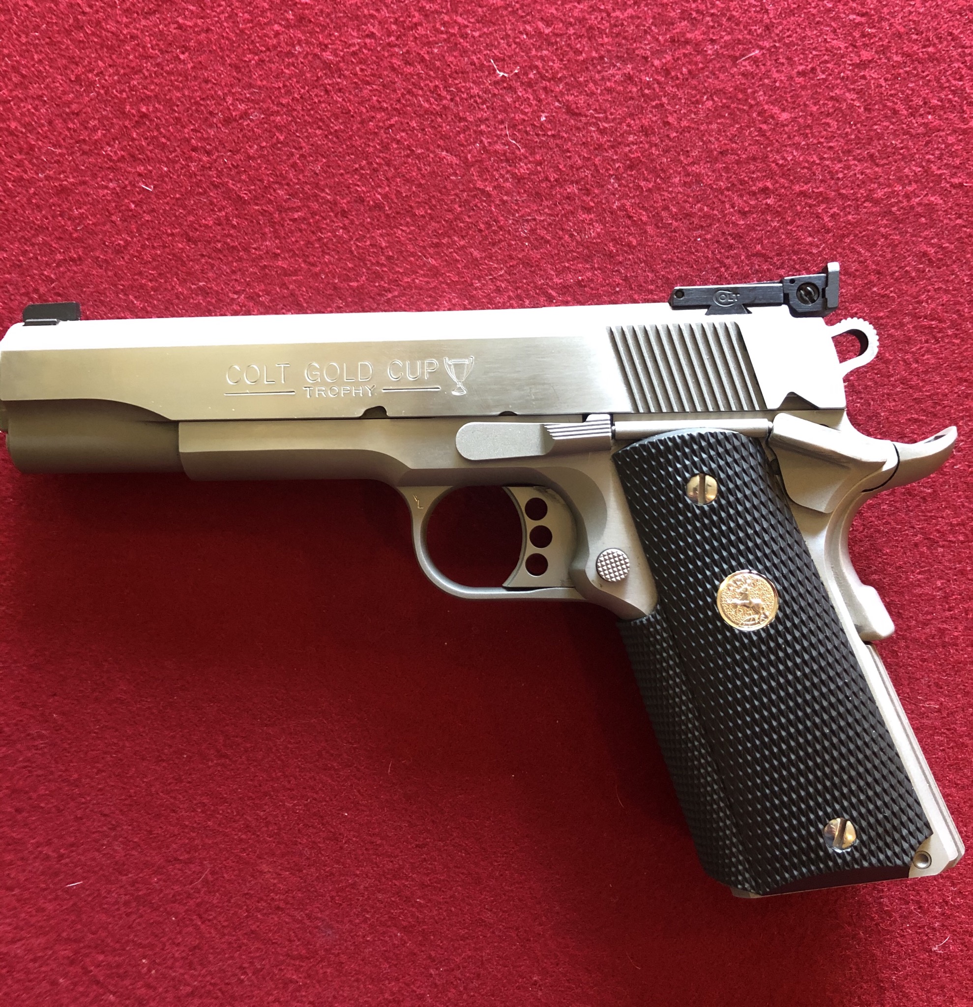

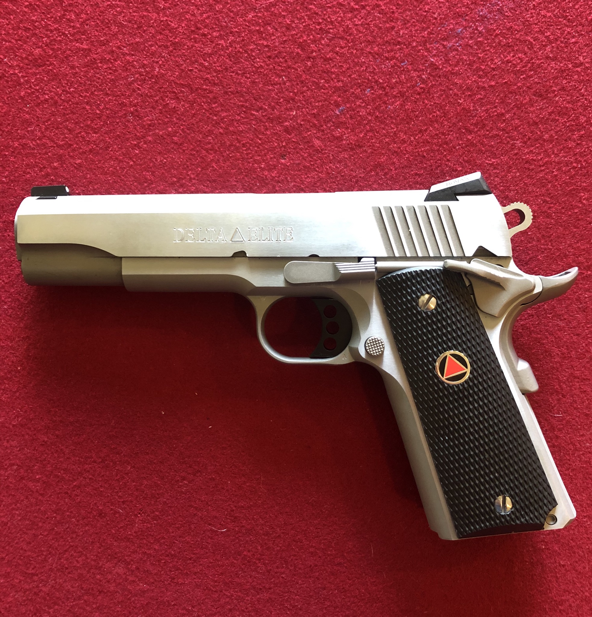

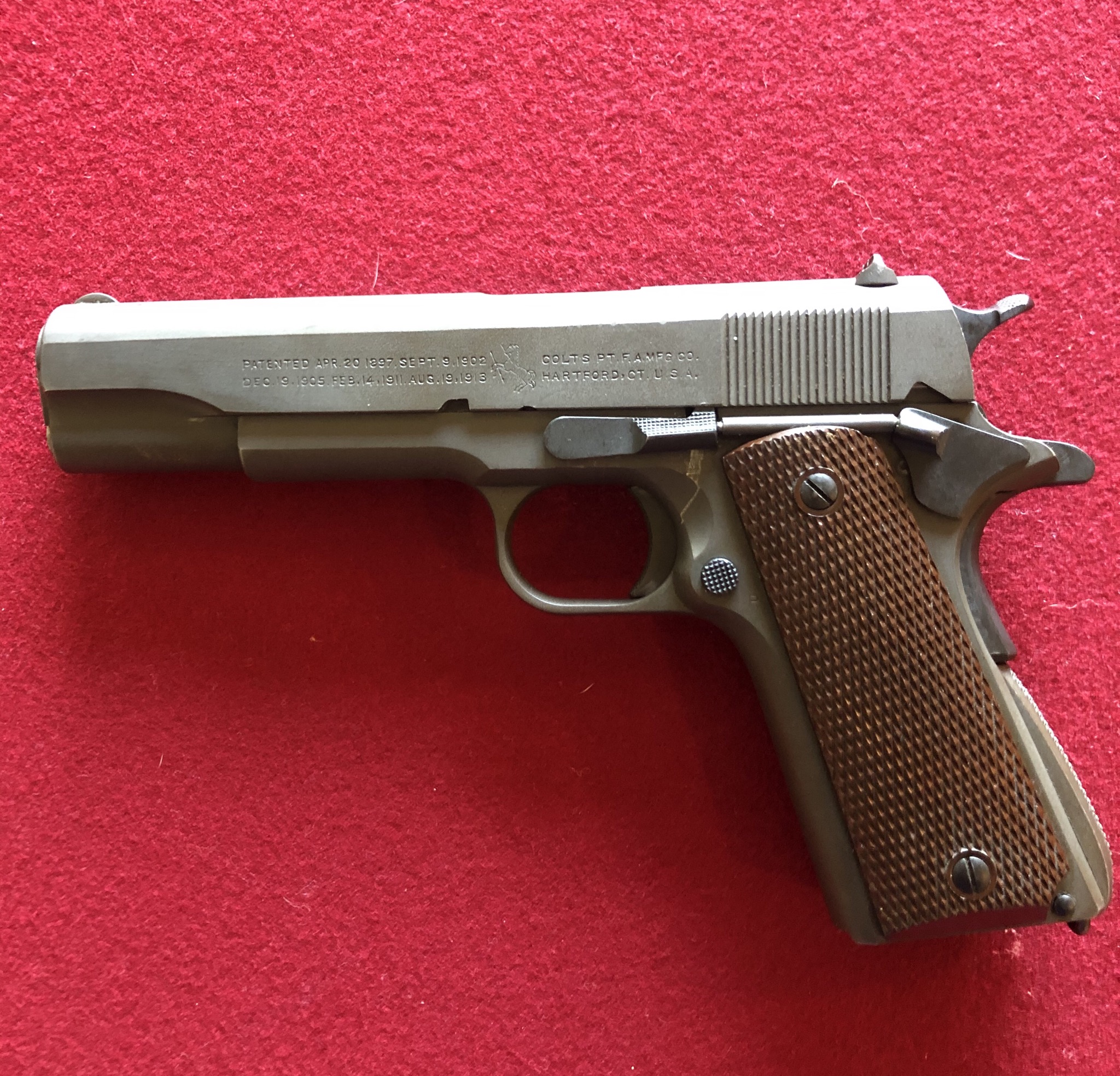

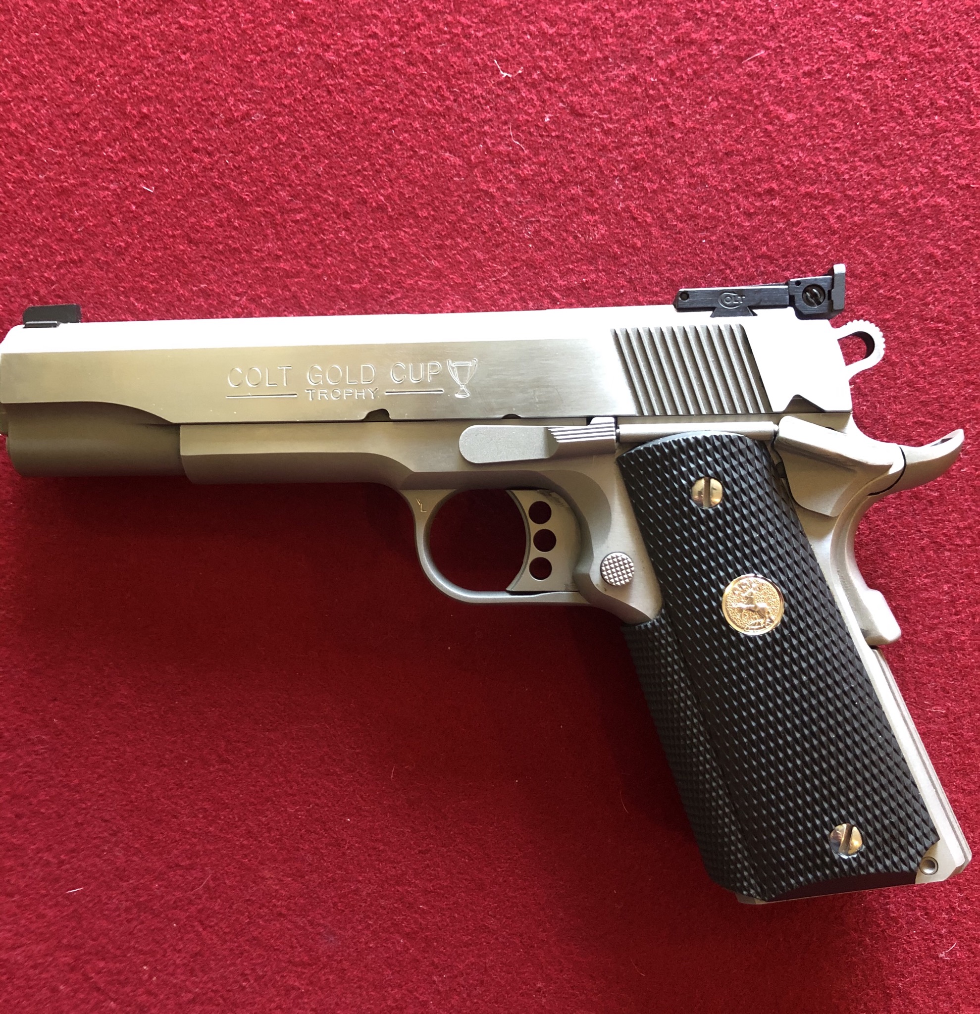

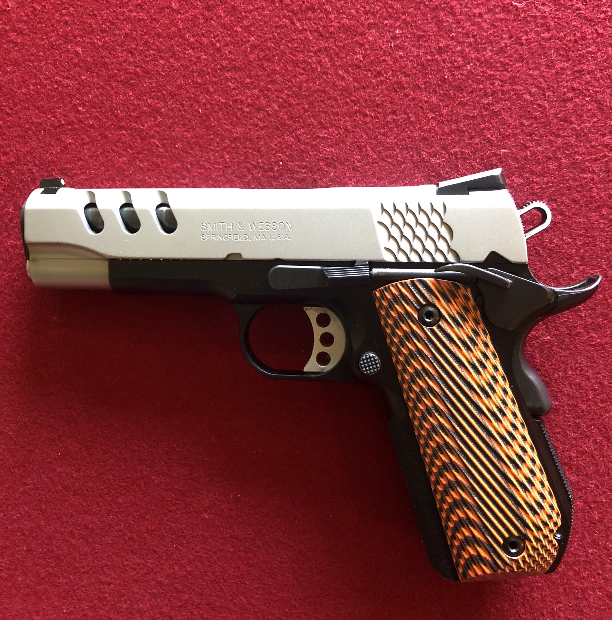

Ok I want to join the party ....from top:
Dads 1911A1 Military- 1941 he carried in WWII as an Army Doctor
The rest are recent purchases in the last 5 years
Colt Gold Cup
Colt Delta Elite 10mm
S&W Performance Series Bobtail....loved the look of the ported slide so had to buy it....shoots great as well

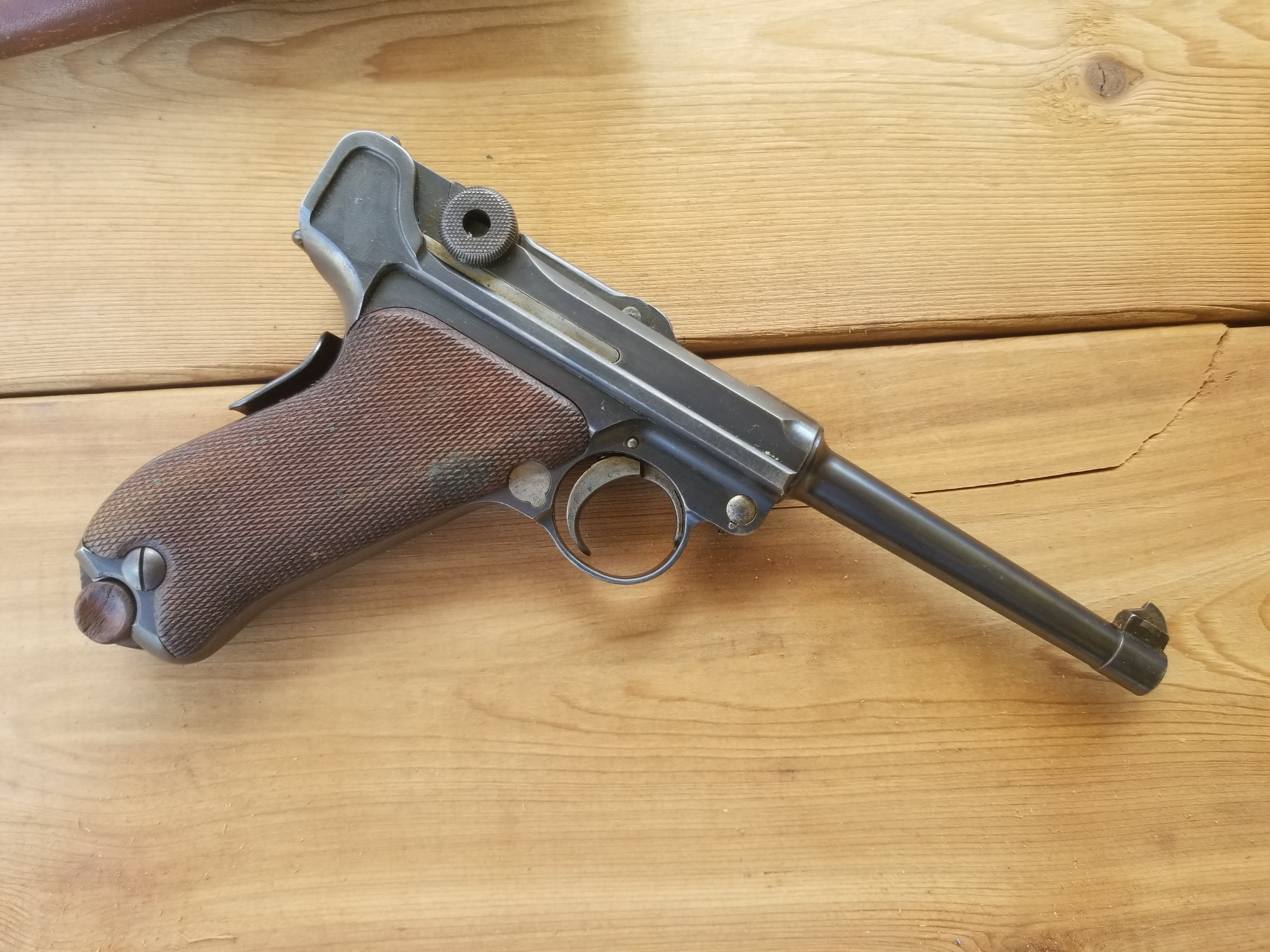

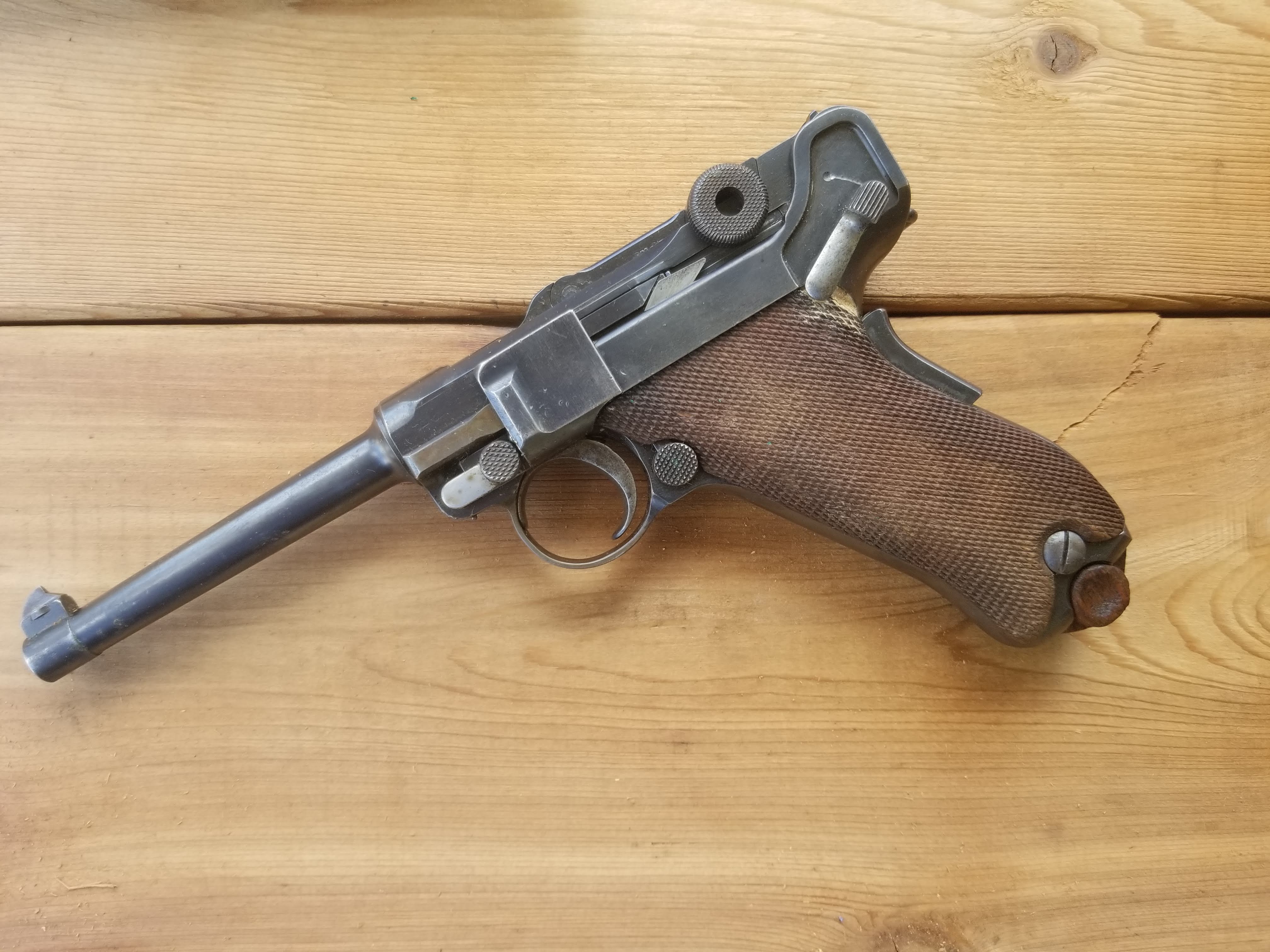

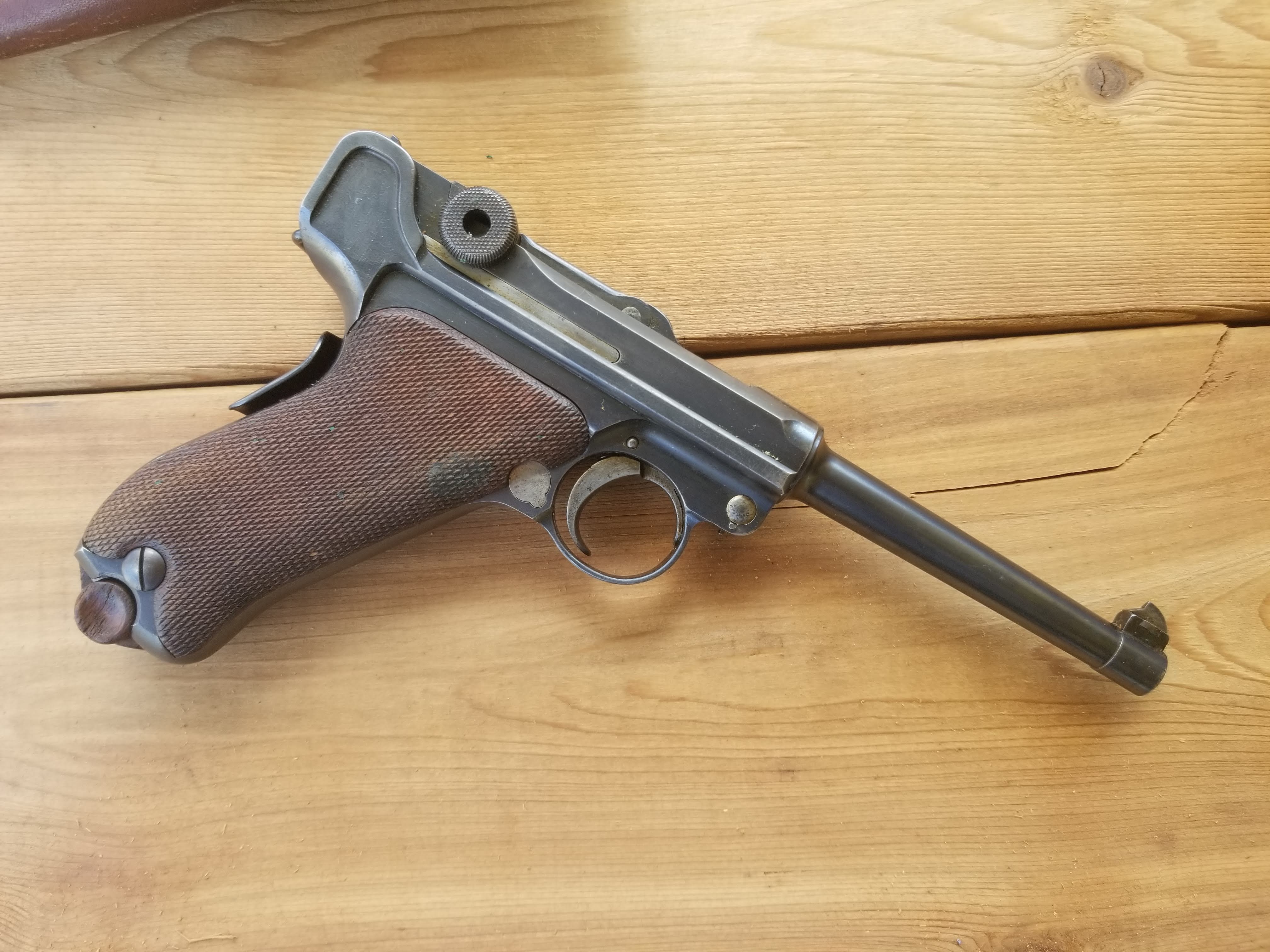

Since Lugers have been brought up, I'll throw my two cents in. Lugers chambered in .30 Luger definitely don't seem to wear as much as one's chambered in 9mm. I think one of the strengths of the 1911 is it's adaptability to different cartridges. I own ones in three different calibers and they all function the way they are intended without excessive wear, even Delta Elite. Granted the DEs had issues with the frame cracking right over the slide release cut out but that was quickly and easily fixed.

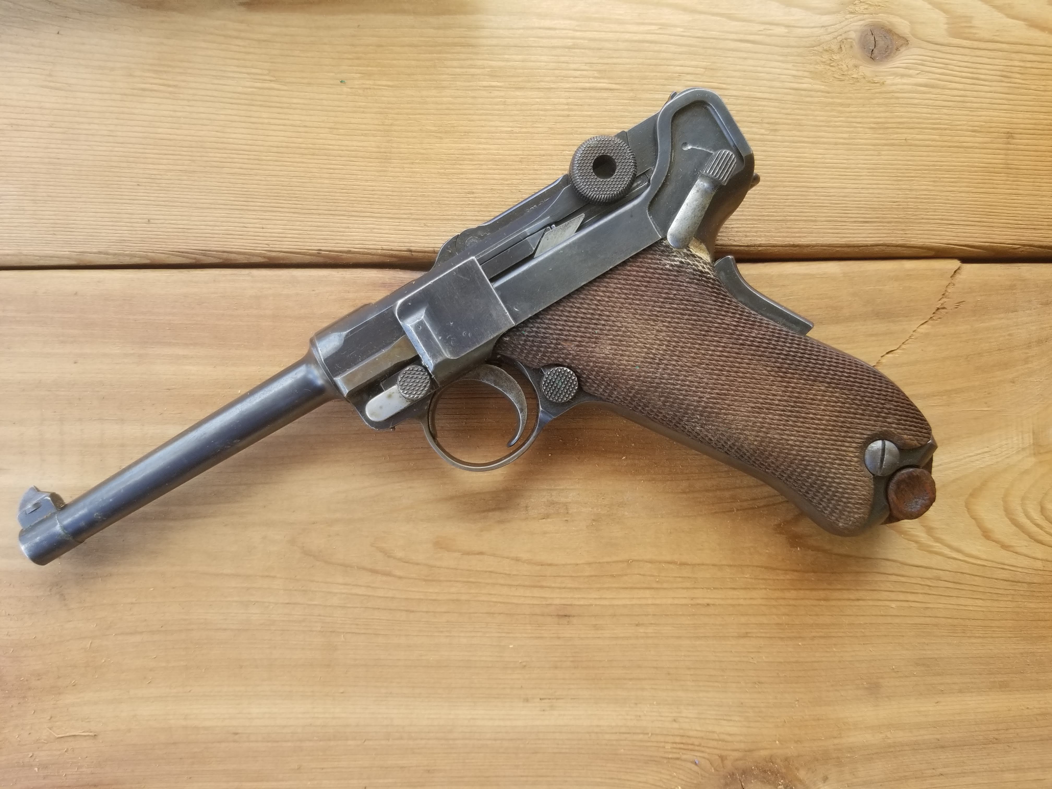

Oh, we should probably post our Lugers now as well. Mine is a DWM model 1906.

Thanks, I wish that it had been stored better before my dad inherited it but I'm happy to own it.

Only a VoPo Luger lives here. Picked up out of a "Shotgun News" ad for $225 back in 1986. The advertiser was selling a batch just imported from who knows where. Kind of a bottom feeder Luger, but it shoots and I got to learn how Lugers function and detail strip on it. Still my favorite way to shoot up 9mm.

Now the Luger...that's something I think I could get into. Rather the yin to Mr. Browning's yang

You'd think so, and they're kinda cool but unlike the 1911 you only need one. You can see why they were an evolutionary dead end when you mess with them.
