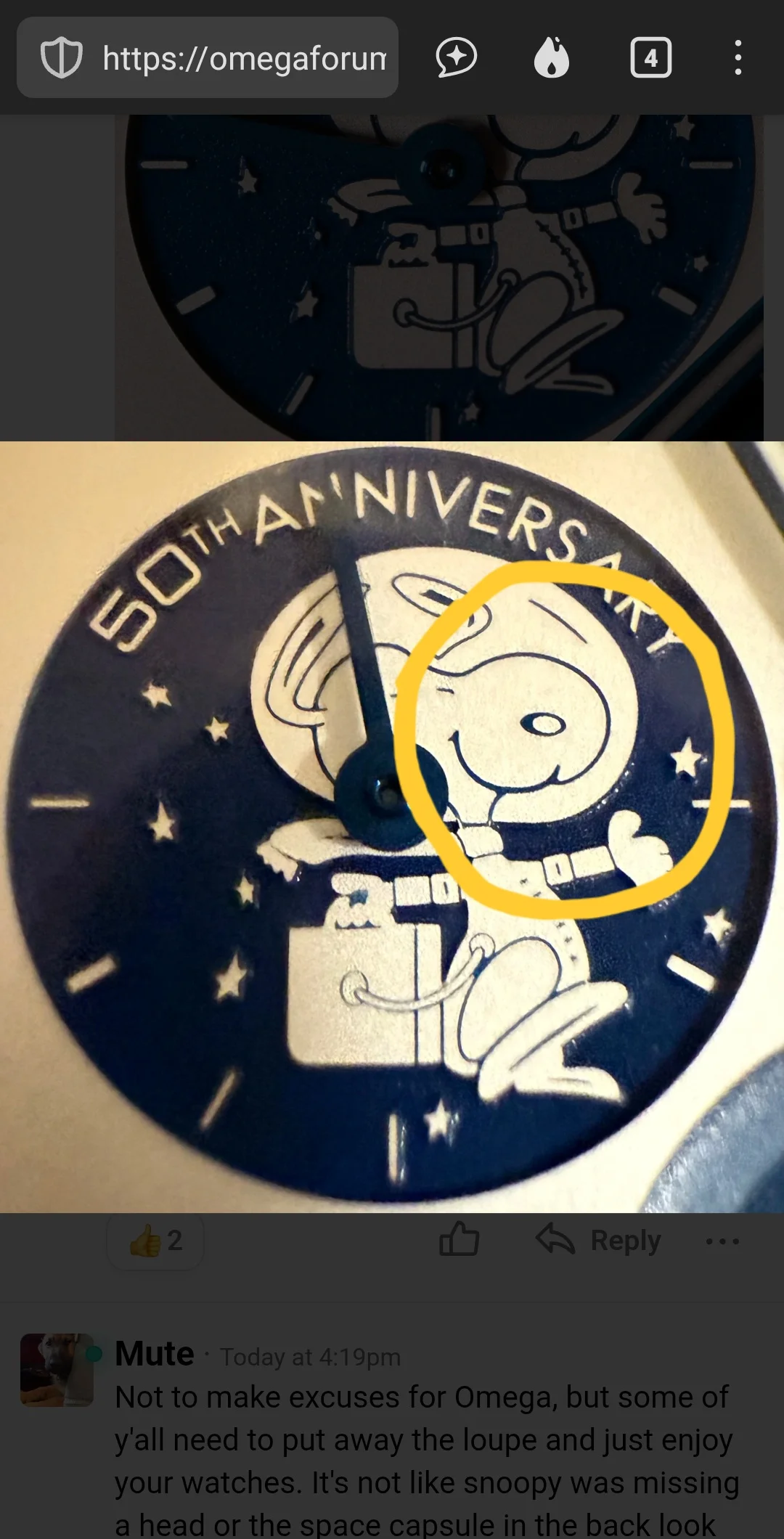

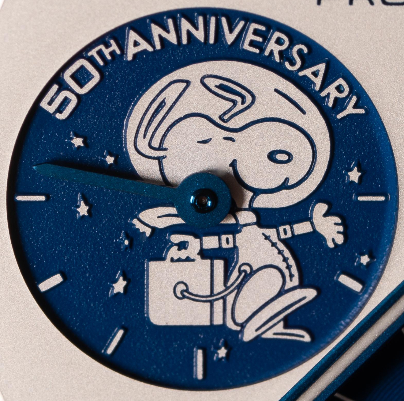

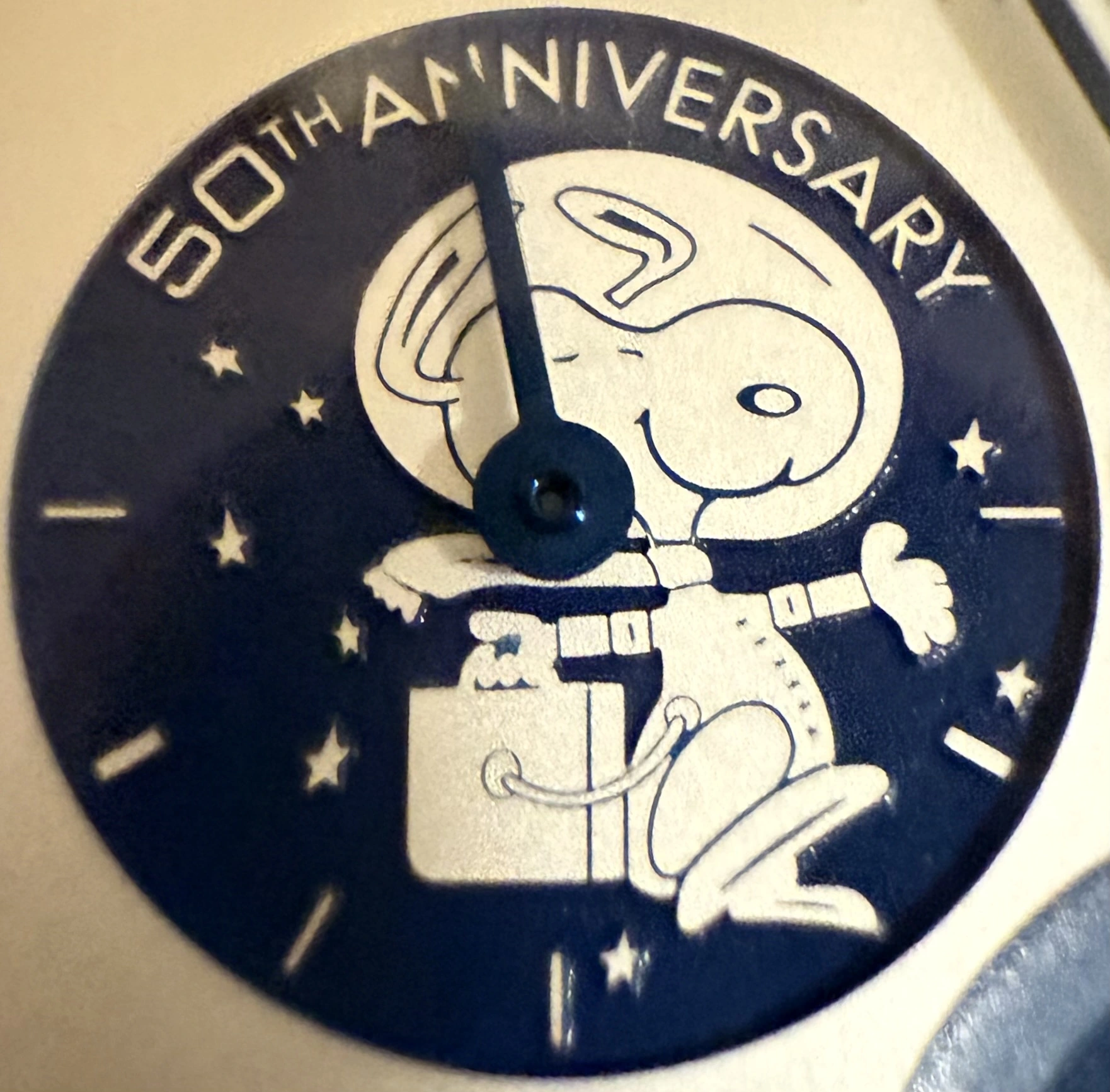

Here’s a much a better photo of the new Snoopy in the same position as the old Snoopy. It’s worth noting that the stars are bigger/contain more visible silver in the new one. Also, the anniversary text being thinner (less silver) whereas Snoopy has thinner blue lines (more silver) lends credence to a new manufacturing process.
These two photos would lead me to believe that the only difference is how much material has been removed from the top surface after the die was struck. If you look closely, the "original" has more depth between the top of the letters and the bottom of the blue surface. The "newer" version has less depth - more material has been ground off, leading to larger stars, and loss of some definition in the zipper.
Is it a "defect"? I doubt it. Will Omega do anything about it? I doubt it. Will people complain? I have zero doubt of that! 😉
I was thinking exactly the same. It simply looks as though more of the blue layer has been removed on the recent examples.

Yeah, that IMO is why the 'worn die' theory holds a lot of water to me. Basically all of the details are 'struck lighter', but the overall depth seems to be the same(edges of dies are what wear, not the overall depth) so this isn't a case where the die isn't hitting as hard/not set as deep.

Sorry, but I don’t see it. If you for example look at the stars on the right side, there has simply been more material taken off the top surface after the die was struck, leading to a larger star appearance. This has also removed more of the zipper. I don’t think worn dies have anything to do with this at all.
I worked in a place that once used large presses to stamp part numbers into solid steel parts (so not just thin sheet metal). Dies lasted for tens of thousands of parts. Dies aren’t going to wear out stamping soft materials like this short of making millions of dials…
Ah, I see exactly what you’re saying, and it seems to make sense to me. The only thing I’m unclear about is the anniversary text—that seems to suggest a different stamp was used, as there’s much more blue around the lettering, no?
Ah, hrmph... I didn't see the stars, that is interesting. There are explanations that could cause it (rework etc, but without seeing 'middle' watches, I couldn't be sure), but it makes me less confident.
As far as die wearing: with something this small, even hardened dies in soft material can show some pretty significant wear with only a few strikes. Number-strikes are way different because they have 'flatter' sides. As dies wear, they get 'pointier' as the sides wear, so part number dies tend to be pretty immune to wear.
Additionally, the die material is going to be different for a watch than something in a harder material. Something with fine details can't use a hardened die without losing some of the details, so you'd probably choose to do no treatment, particularly if you were only going with a few thousand units. If you were going for something with a 'low' item count + really fine details, you'd probably optimize for ease-of-die manufacturing, so you might even go with a softer material.
For example, I worked near a project that only had to do ~20k units in precious metals (silicon manufacturing) so they used a brass die, as it was much easier to laser-engrave without distortion. Die life was 1750 units, so they made 20 dies.
All that to say, hardened steel dies designed to work for a million units with high tolerance for variation on large details are a WAY different than small details, low units, no/low tolerance for variation.
