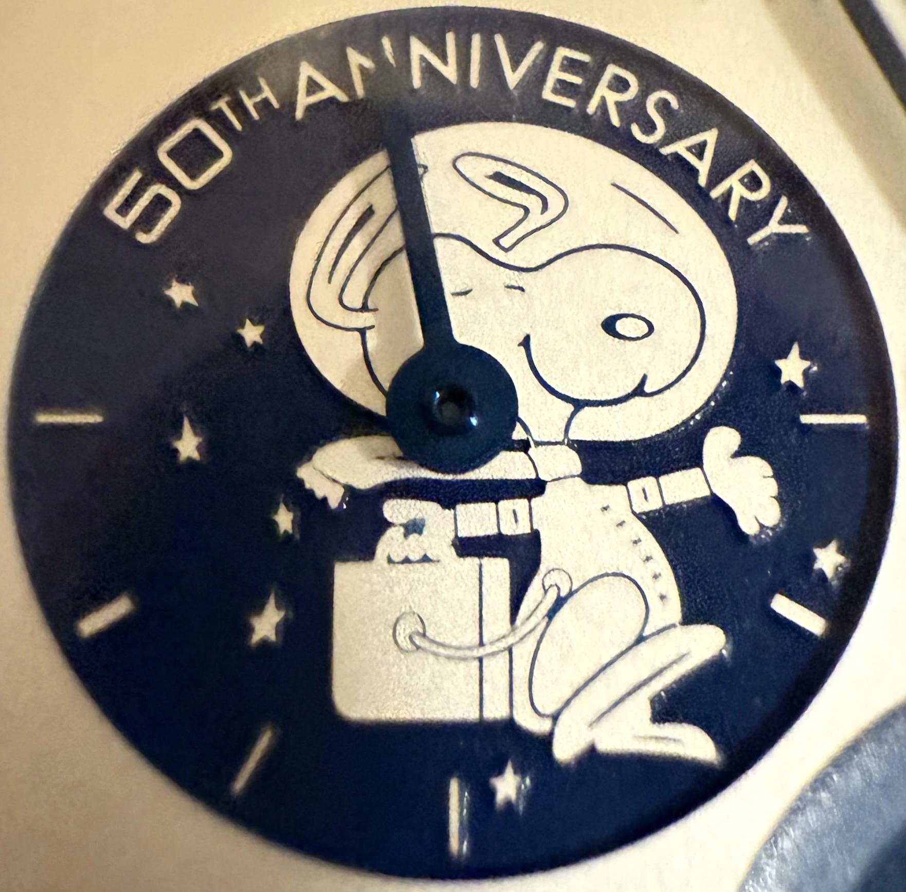

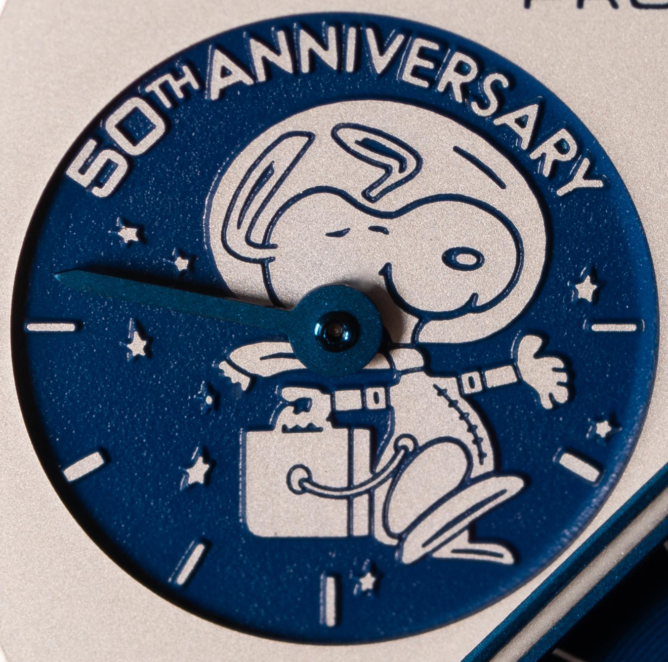

Hi, please see the attached photos comparing an older and newer Snoopy dial.
Inspected under a loupe a few things seem to be the case:
  • The zipper is through the “buttons” on Snoopy is completely missing
  • Snoopy has significantly less definition in his paw (though not entirely missing as the original photo I posted to Reddit would suggest)
  • The delineation between Snoopy’s boots is completely missing
  • Overall, Snoopy’s lines seem thinner, as does the “50th Anniversary” text
This watch was purchased at a Japanese AD in 2025. Master Chronometer matches the serial and checks out online. Sharing here for awareness, and ultimately hoping to hear back from Omega on whether this is considered in spec. It would appear to be a somewhat widespread production flaw.
Note: I’ve removed the Reddit post because it has bad, unrepresentative photos (iPhone AI reconstruction) and that subreddit does not allow edits. I was getting too many irrelevant DMs as a result. All future updates will be isolated to this thread, where I’ve updated the OP with significantly cleaner photos of the subdial variants.

There’s no way that’s not a replica - but who knows.
Replicas aren’t this good. They don’t have correct subdial spacing, pusher protrusion, thickness, accuracy (+2 seconds per day in my case), and in most cases won’t even have a fully working chronograph across all subdials.
So either ADs and OBs are now selling the best replicas ever made, or something is going on with Omega’s production.

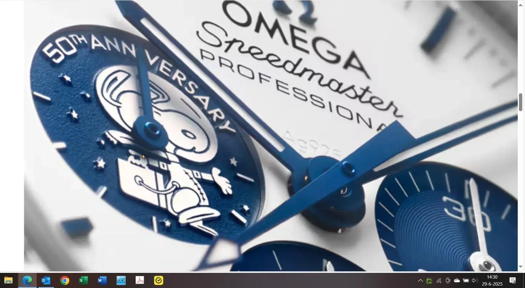

here is a picture from today`s Omega site, if yours doesnt look as good as it take the watch back

Hi, I’m posting something that was also shared on Reddit here:
Please note that the second image is suffering from heavy iPhone camera artifacting, but inspected under a loupe a few things seem to be the case:
  • Snoopy has significantly less definition in his paw (though not entirely missing as the photo would suggest)
This watch was purchased in May at the AD Matsuya Ginza. Master Chronometer matches the serial and checks out online. Sharing here for awareness, and ultimately hoping to hear back from Omega on what’s going by on here. It would appear to be a somewhat widespread production flaw, or less likely, a crazy high quality fake job that has infiltrated the market and snuck into ADs and apparently also Boutiques, as some of the Redditors with these discrepancies say they got theirs at OBs.
