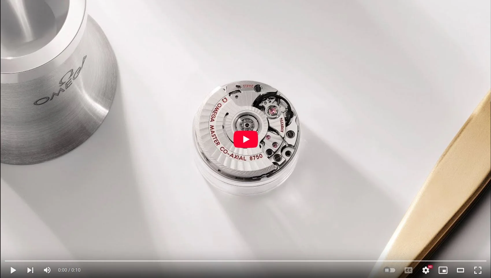

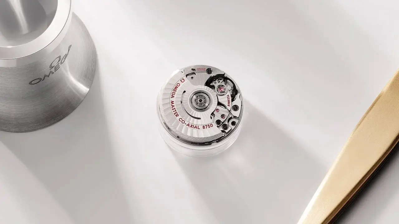

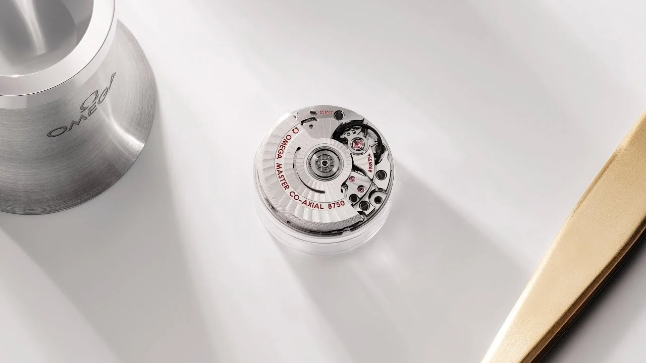

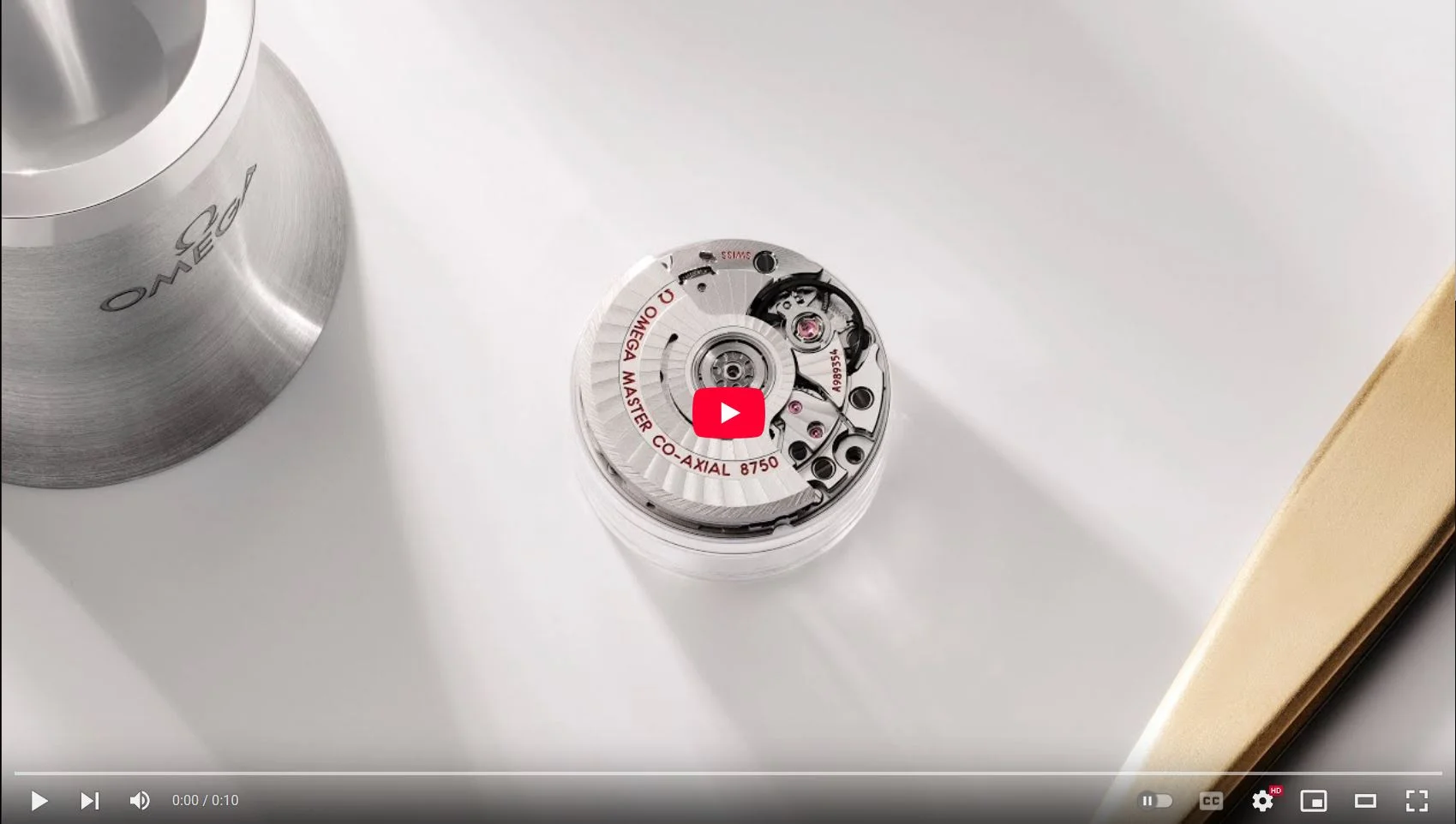

Cal 8750. They cover the movement with a hand in the video so it remains mysterious, but the YouTube thumbnail reveals it all lol
EDIT: Thumbnail without the YouTube play button:
