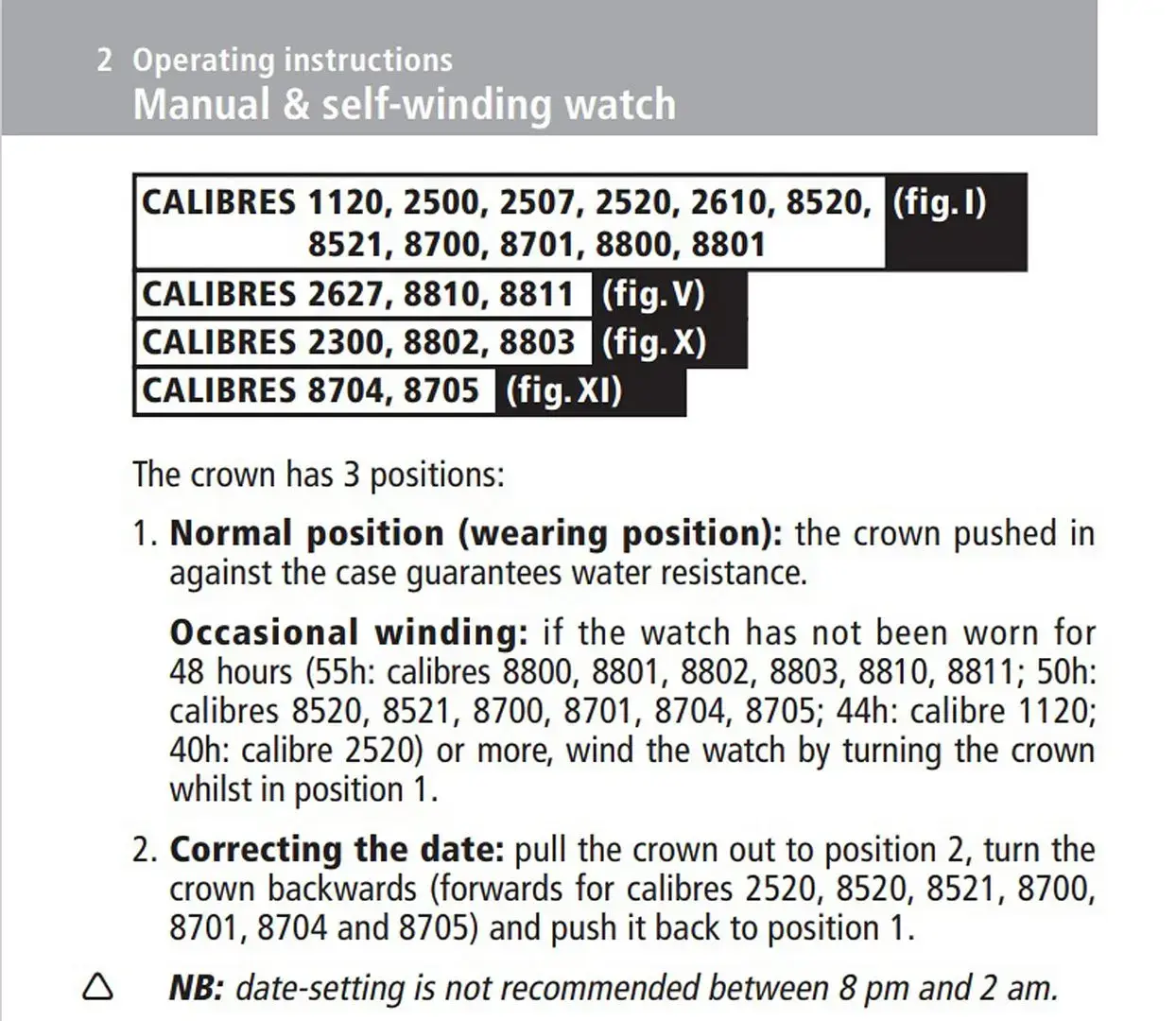

I always give my watches a full wind when I start wearing them after they stop running. Why wouldn't you?
Correct, it even says so in the manual:
62
24
Correct. I knew this information. Dou you have any idea for test of automatic system. Thanks!
