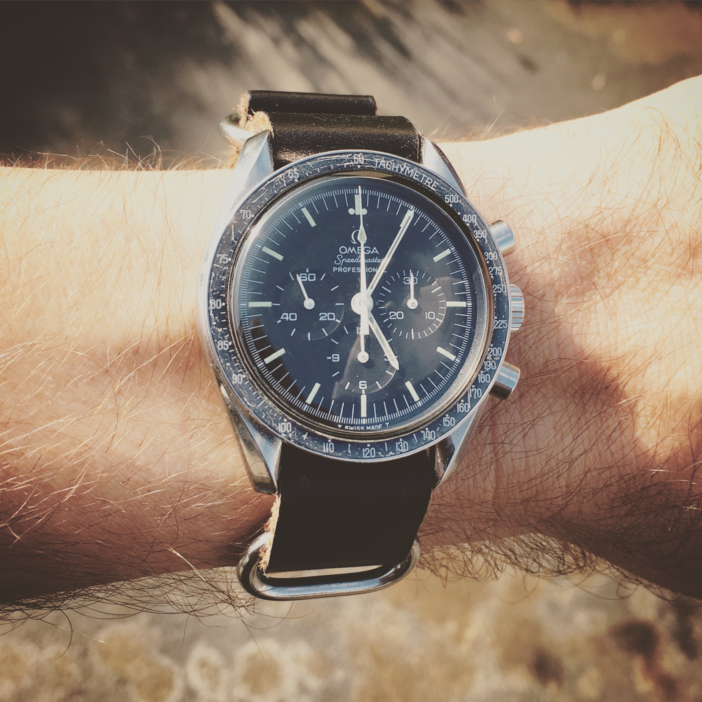

This is a missprint of my moon to Mars.. I didn't buy it new so I have to live with it
Looks like there was something on the dial or on the tampon when the printing was done. Even though you bought it second hand, I would at least ask them to replace the dial under warranty when you send it in to Omega for service, as this is clearly a defect from the factory - worth a try anyway.
